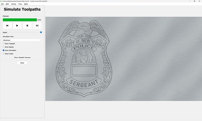

I’m trying to make a beer flight template for a friend of mine who is a retired sergeant. I downloaded an svg of the badge, uploaded to carbide create and am trying to create tool paths. When running a simulation, I get X’s and Crosses in random places. Does anyone know why this is happening?
Here’s the file and a screen capture of the simulation. Only thing missing from this and the one I’ll use is his badge number.

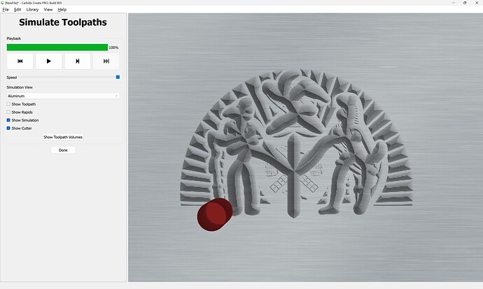

One potential issue is that there is doubled up geometry:
However, exporting the geometry, re-working and simplifying it, and then trying to only cut a small subset:
actually made matters worse:
Working to see if some smaller subset will cut okay — once we arrive at that we can move up to see exactly where things break and work out how to handle it.
I’ve filed a bug report on this.
The image elements:
Seem to cut fine:
I’ve isolated the arch elements:
and am looking into the specific difficulties.
The geometry itself seems okay, since selecting just the innermost and outermost elements:
Cut as expected:
Looking at it more closely, I believe the problem is at the bottom of the shield:
Hang on, going to re-draw that…
Which fixed it:
Attached as a v8 file.
Sample Flight_v8.c2d (1.9 MB)
