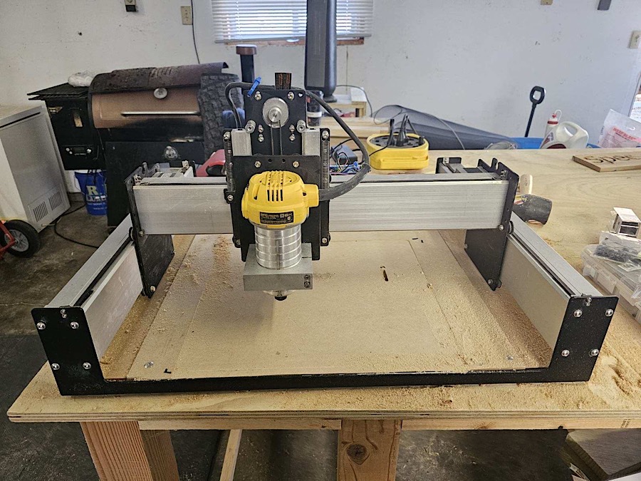

Finally got a chance to see my friends used Shapeoko 3 he purchased recently. I am not familiar with the machine, we did manage to connect to it using Version 3 of Carbide Motion., board has Grbl .9 and currently no limit/homing switches, with small Dewalt Router.

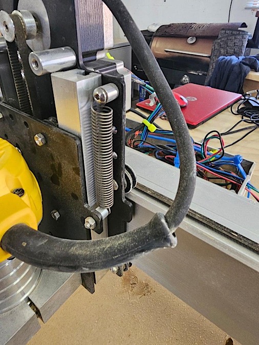

The issue is that I use the Jog function in program to raise Z axis to highest point. When I turn the cnc power off, the plate with the router drops down until it hits mechanical stop. If I hold the router housing while turning power off it will remain in the up position.

At a guess, this is a belt-drive Z-axis — could you post a photo?
There should be a pair of springs:
2.25in to 6.25in Extension Spring
which will keep it from dropping precipitously — are they missing?

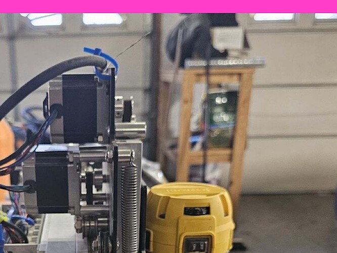

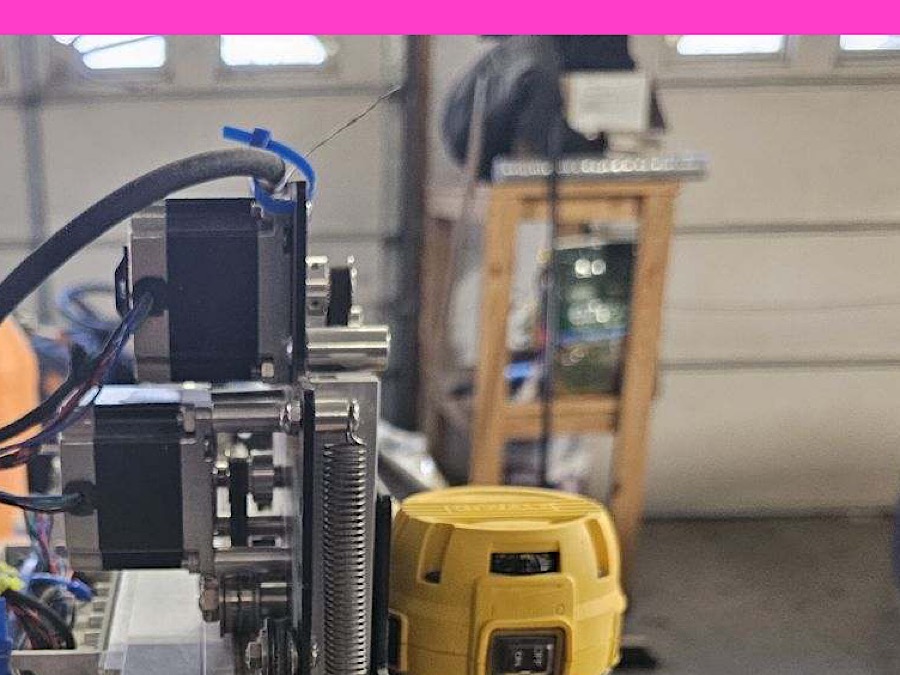

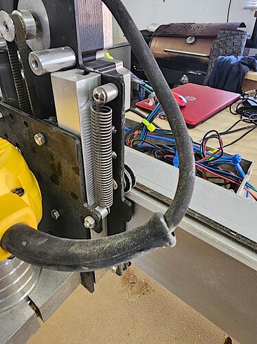

Here are the photos you requested, both springs appear to be connected and not broken.
The springs are something of a balancing act — so long as they don’t allow the mechanism to drop so that it snaps of a delicate endmill, they should be fine.
