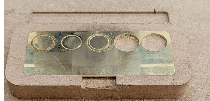

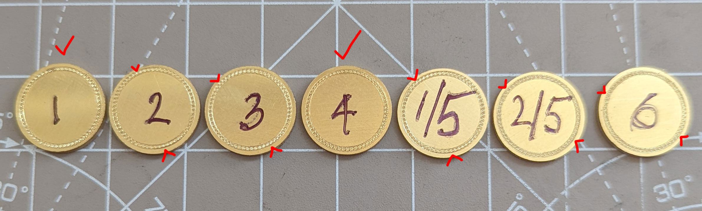

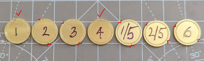

In case this helps, I checked the variance in diameter of the cut outs on various numbered tests:
[https://photos.google.com/share/AF1QipPdCNs8arzbo0QauIKK8A4-BEhB-6E0iv_Lcf4oBXNsCR0JrR7YJculTkzubiaWJQ?key=TFNLZXFsc09yUVNvTmVwYjhud2c1UHFRQXk3cjZn](https://photos.google.com/share/AF1QipPdCNs8arzbo0QauIKK8A4-BEhB-6E0iv_Lcf4oBXNsCR0JrR7YJculTkzubiaWJQ?key=TFNLZXFsc09yUVNvTmVwYjhud2c1UHFRQXk3cjZn)
Please do let me know if you need any additional info.

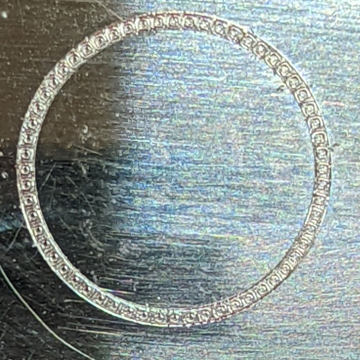

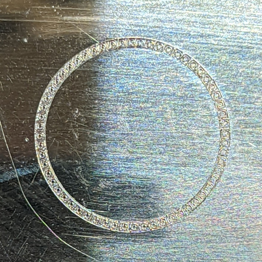

I reduced the pressure on the back of MC Etcher and ran the etch twice:
First etch:
Second etch:
I’m on the Nomad 3, how would I measure the runout?
I tried to measure the (runout?) cut outs in previous testing here:
Gunter
Did you run the cutout toolpath again?

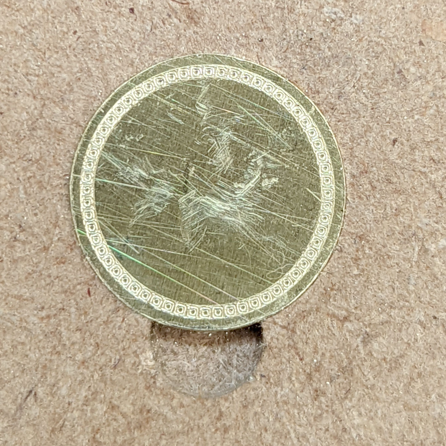

Not on the one in my previous message but just ran one again now:
It’s not concentric.

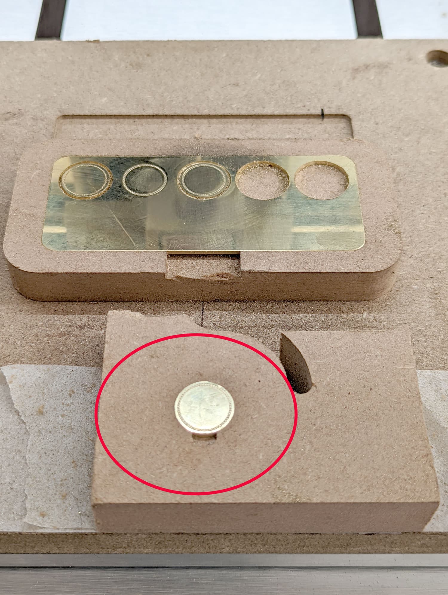

I spent the weekend on a last ditch effort to try one last method to test this. I decided to create a second
jig down from the centre line for only 1 pc, rather than 10. In the original jig, I cut out one disc.
With the disc firmly in the 2nd jig, I ran the pattern file with MC Etcher and results are good.
I repeated this twice to make sure it wasn’t a fluke, and the second one was as good as the first.
After 2 months at this, I’m relieved that my Nomad 3 CAN produce this result. However, I need to produce small batches of these discs and doing them individually one by one is going to take too long.
So, all we need to do is repeat this in the 10pc jig so I can bang them out.

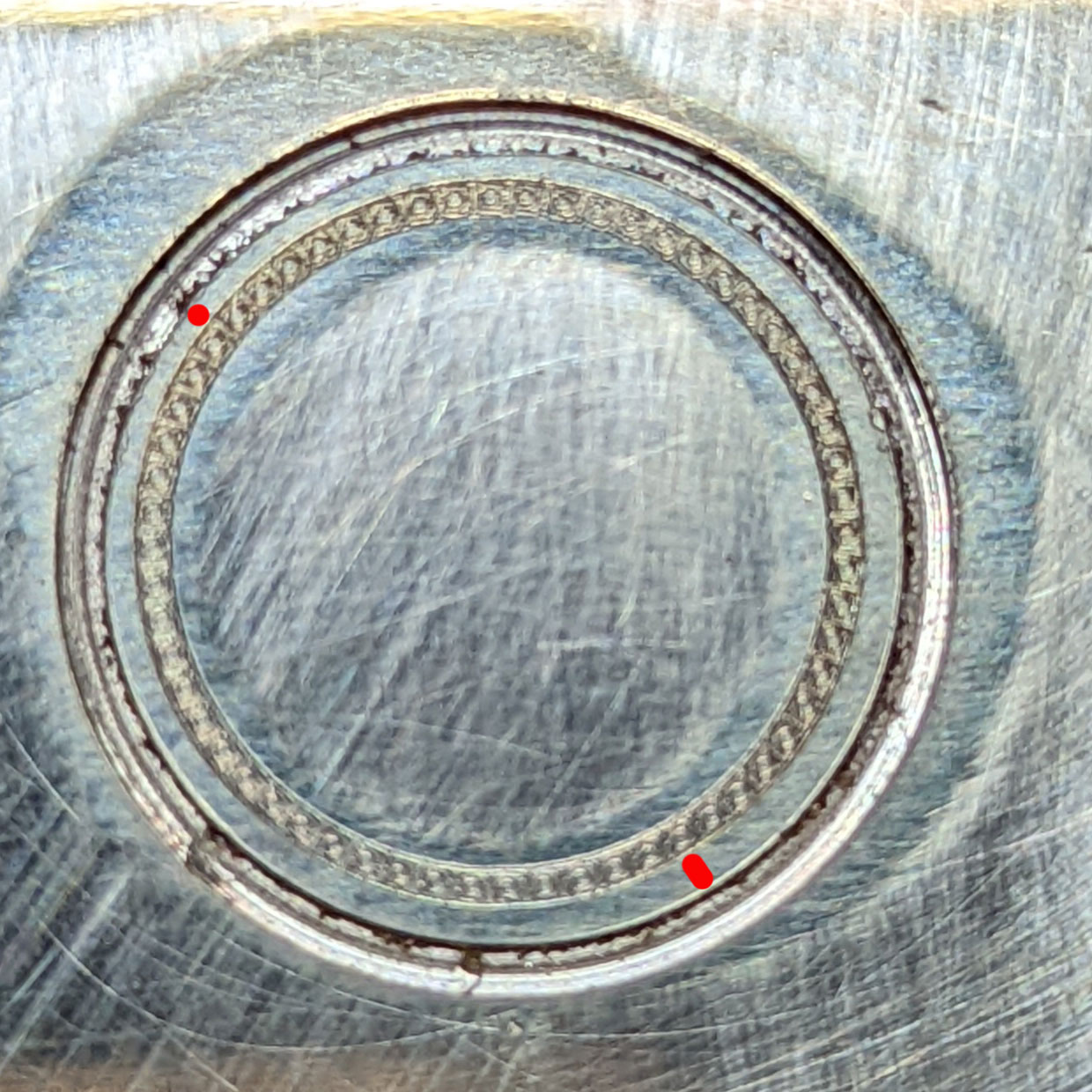

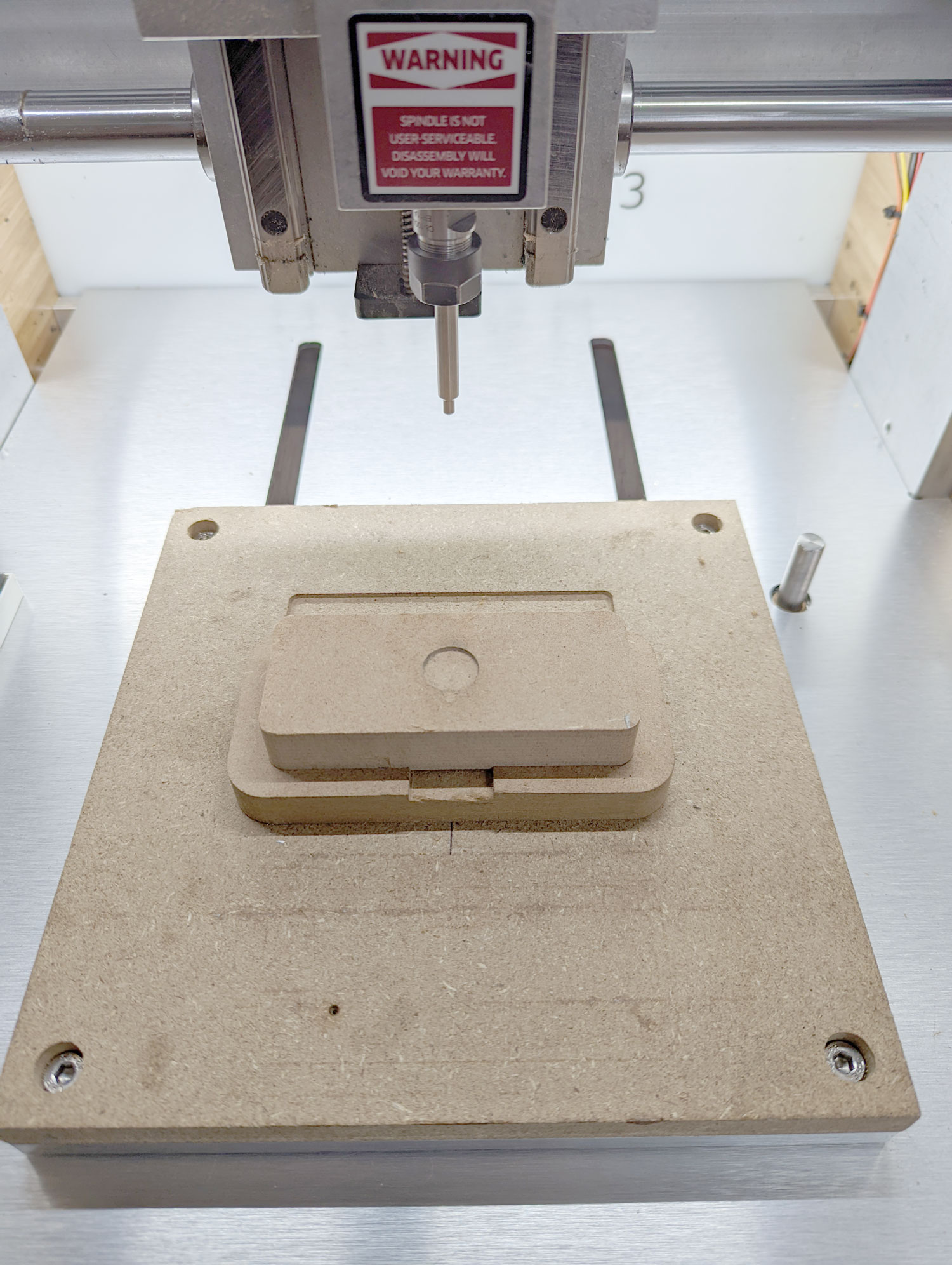

To create a cleaner workspace I made the single piece recess in mdf again, this time at 0,0:
Now, I’m getting the same non-concentric etch again :frowning:

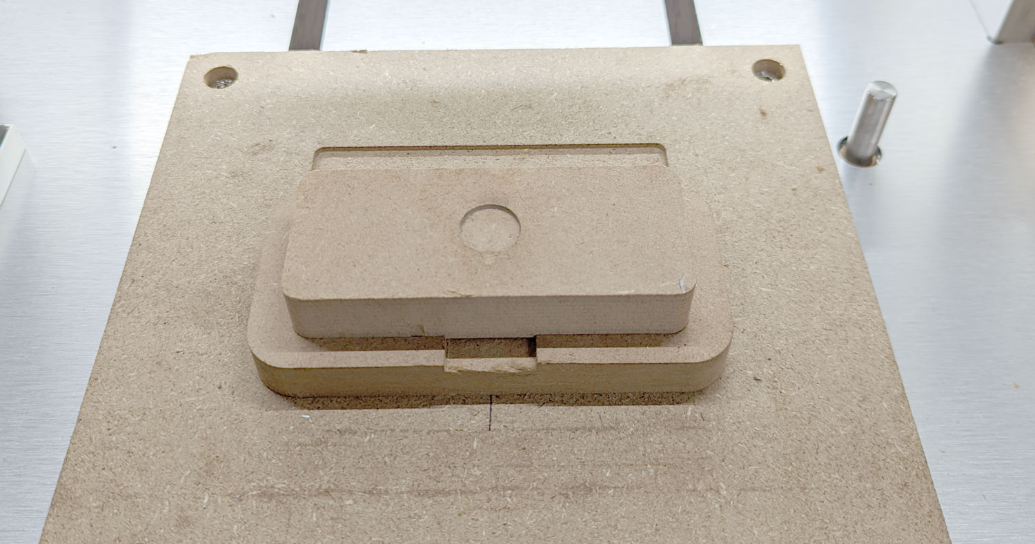

Will, I use a new blank each time in the recess.

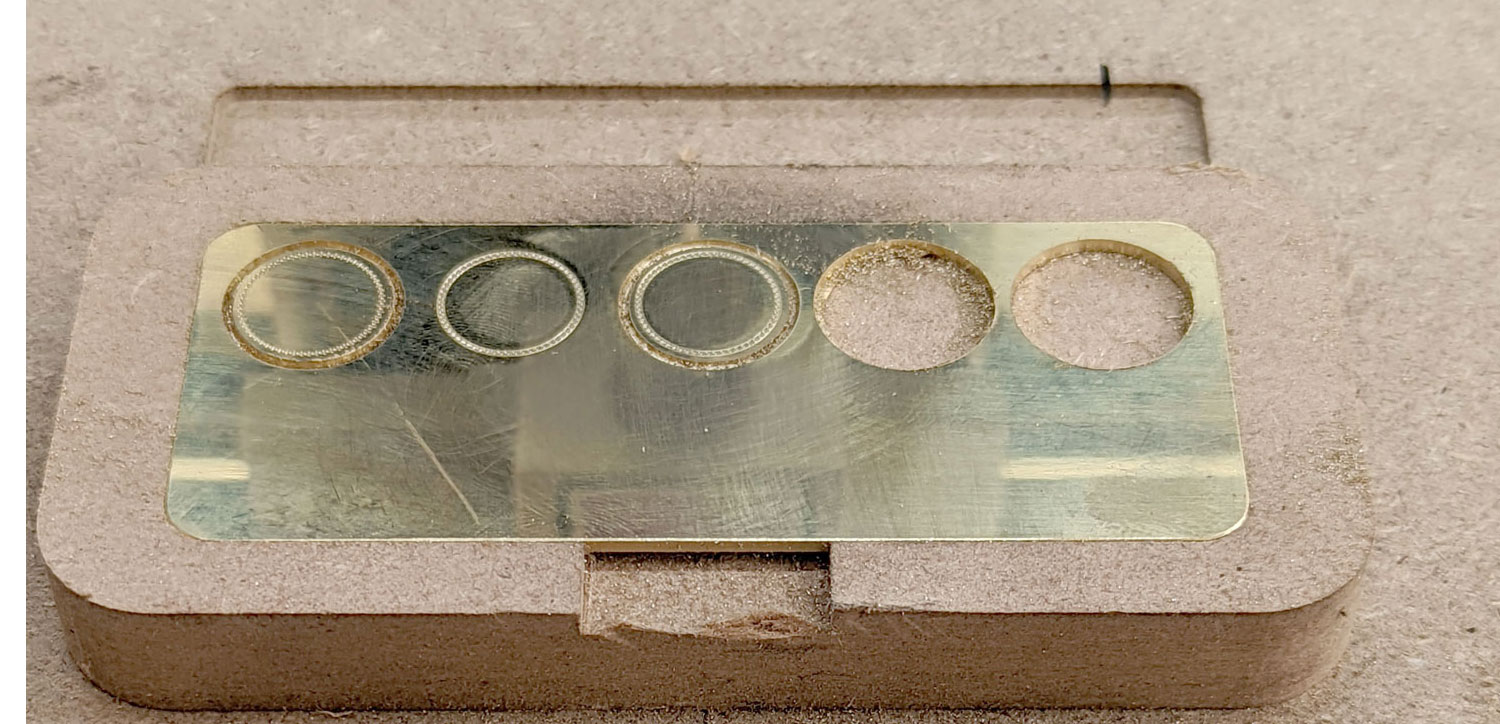

The original recess was designed to cut 10 pieces:
I then created another mdf jig that would fit within the recess for the 10pc plate to try etching one at a time:
I’m afraid, I don’t understand your other 2 questions.
