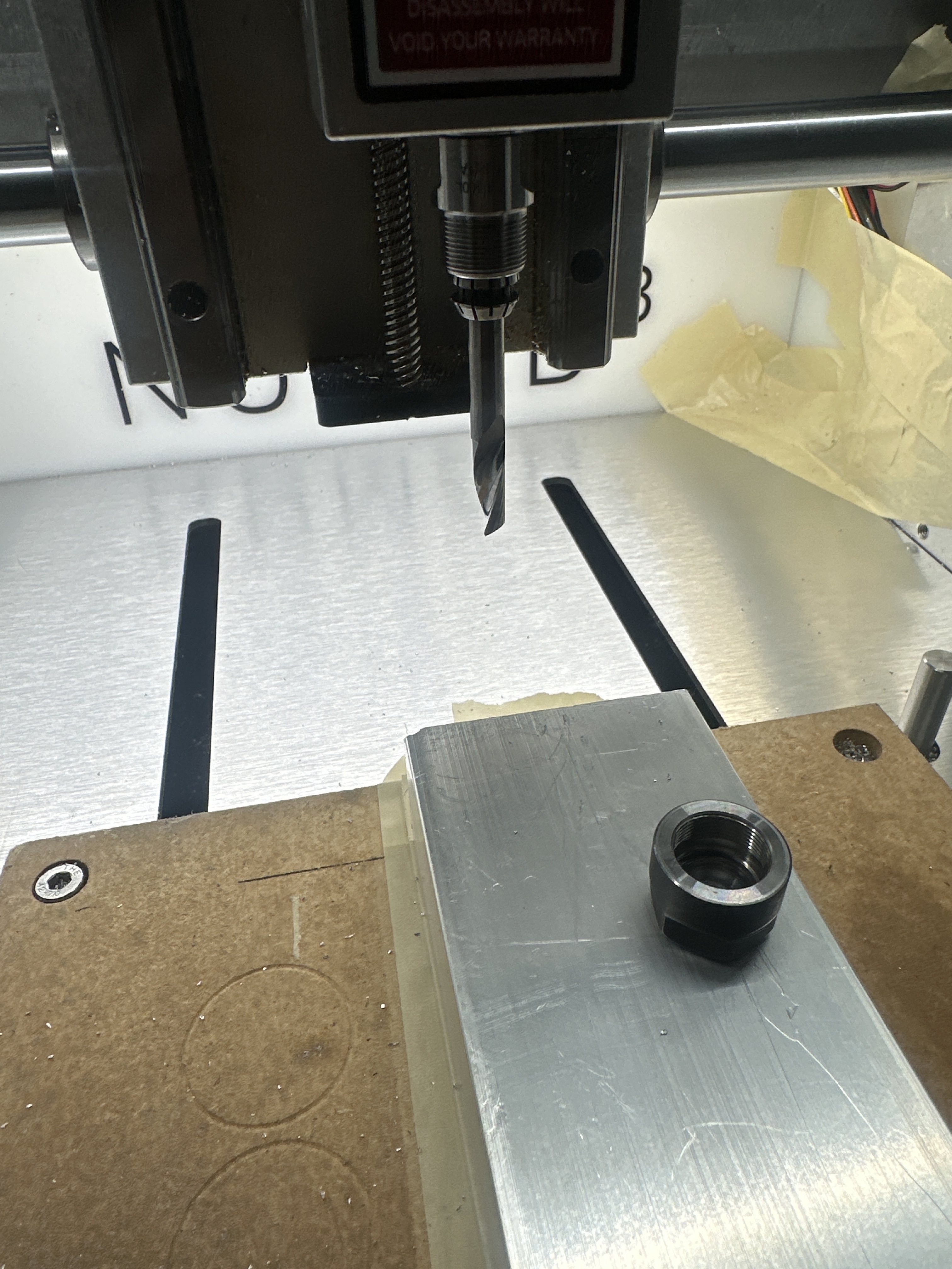

Jammed spindle collet nut
Mostly likely I tightened my spindle too tight. Collet nut is stuck with the spindle but the clamp nut got out with no issue. Should I use an adjustable wrench as a solution? I’ll need to go buy one
The ER-11 collet is supposed to be snapped onto the nut which then draws the collet out as it is unthreaded.
I would put a non-marring pair of pliers on the shaft of the tool and then gently leverage the tool out, at which point the collet should come out.
You could also try to put the nut back loosely and then tap (not beat) on the nut to see if the spring action of the collet will let the bit come loose. If you decide to grip with pliers I would grip the bit and not the collet. Both are replaceable but the bit is easier to replace.
As Will said most likely the collet wasn’t snapped into the nut. If it was you need to check the eccentric extractor ring in the nut. They very rarely will fail.
To get the collet and bit out. Move the spindle where you can put something soft under the bit and lower it to less than an inch of clearance. The old rubber mouse pads work great for this. Then take a slotted screwdriver and insert it into the groove in the collet as deep as you can go. Tap the back of the screwdriver with a mallet / hammer while walking the screwdriver around the groove in the collet. It should eventually drop out.
After you get it out check the spindle and collet for grooves or damage. If you aren’t sure on something post a picture and I can at least give my opinion. You can see the damage that can be caused by not snapping the collet in here (Link).
