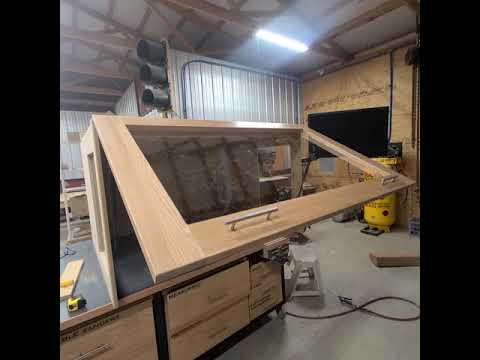

I was able to hang the front door and attach the gas struts to the enclosure this morning. It doesn’t open quite as far as I wanted, but it opens enough for me with about 3 inches of headroom. I could re-arrange the mounting points, but the struts are performing how i want them to as far as ease of opening and lifting the door.
I also inserted a 2 1/2" vacuum hose coupler in the top of the enclosure. It has a 5 1/2 ft anti static hose that will attach to sweepy. I’ll hang some of the slack using mini bungee cords suspended from the top. I got my hoses from Oneida Air Systems along with an anti static dust deputy that will be in line between the enclosure and my Festool CT36, which completes the dust collection.
Here’s a video of the top operating:

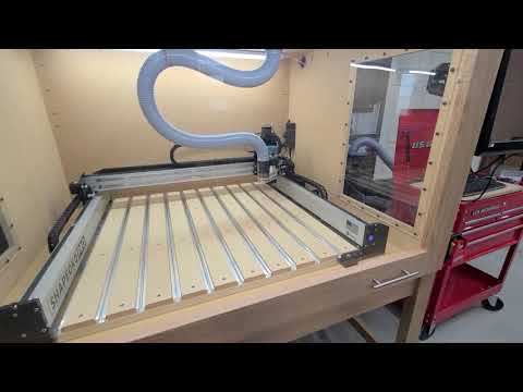

Completed the build on the enclosure and the Shapeoko Pro XXL today. Fired up the machine and jogged it around the table to check clearance for the dust collection hose. Made a quick video for those on my Facebook that have never seen a CNC. I won’t be cutting my first job for a while, I’ll be out of town on business the next week or so. Something to look forward to when I return. Here’s the video:
Do you think the MDF sill eventually sag in the middle of the top if no support is added? Perhaps a lateral cross brace could be added? I know MDF tends to sag in places it is not supported
