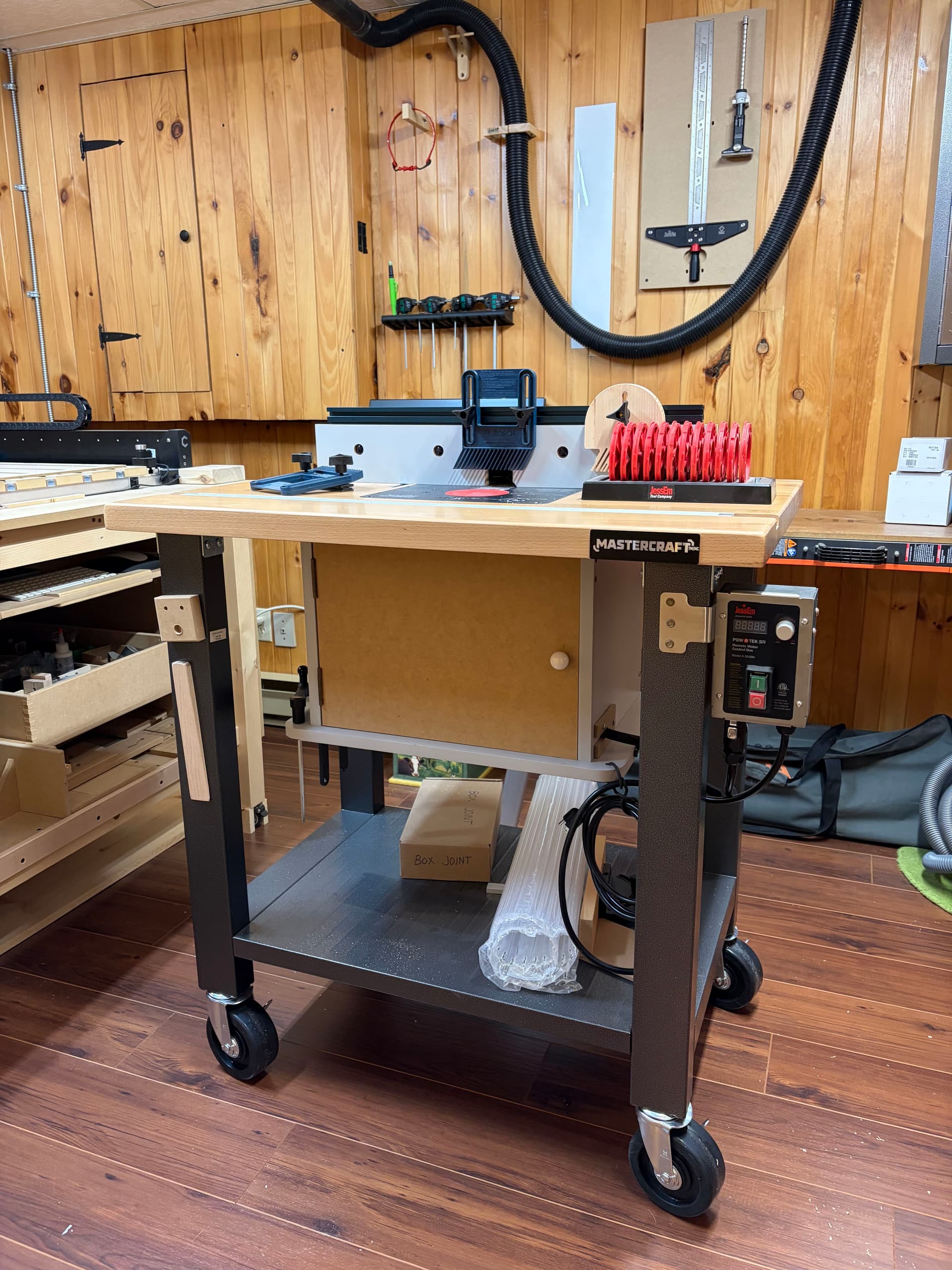

About a year ago, I built my own router table using a JessEm Mast‑R‑Lift and a JessEm router. Against all the rules, the top layer is a 1 3/4" solid oak top—and it hasn’t moved a single thousandth of an inch. I also reused an old Bosch router table as the router box.
It’s basically a Frankenstein setup, but it works great. Here is the cutout file for the top.
Hopefully this could help.
Table Router Mastercraft.c2d (76 KB)

Good looking router table!
