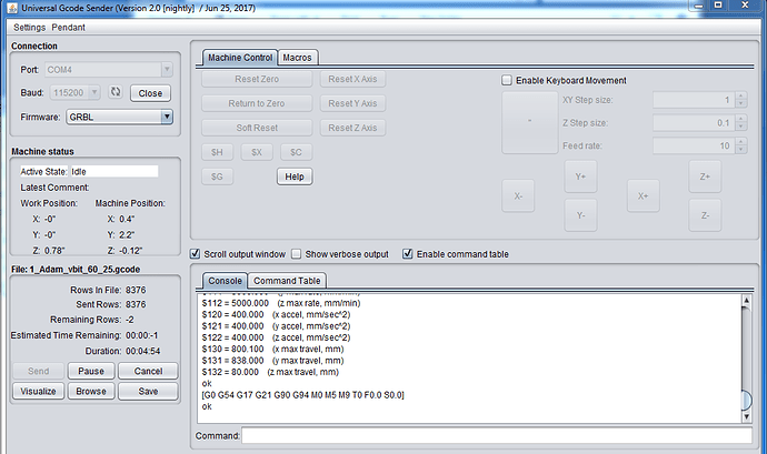

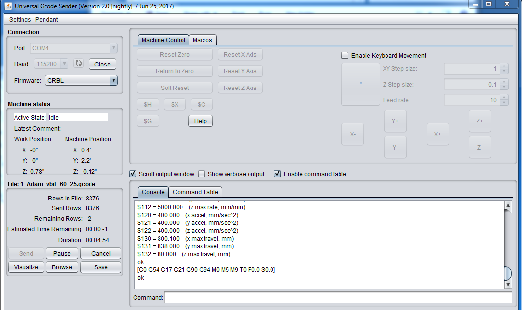

I moved to UGS 2.0 and I believe the issue with changing to mm at the end of a job may be fixed, but now when a job ends, all of my machine controls are grayed out. The job ends fine, spindle goes back to job zero location, popup say job has completed. But now I can’t jog at all. I have to restart UGS, which then requires a rehome befre I can change the bit. And the last time I did this it lost my job zero settings. See screenshot.
I don’t know why it is throwing a G21 in that last line. Where is that coming from? I have UGS set to inches and $13=1.
I fixed that bug recently and neglected to update the stable build to include it. If you update to the July 28 stable build the disabled controls should be fixed.
That last line is GRBLs current internal state, it’s being displayed because after a soft reset UGS sends $$ and $G. That might have happened if you tried to stop/cancel the job after the controls remained disabled. GRBL is still honoring $13=1 since the machine location is in inches. UGS temporarily changes the units to your preference, then switches it back to avoid altering the internal state. So it is normal to see G21 here.
Would that be the 2.0 Somewhat Stable Build or the 1.0.9 Stable build?
The 2.0 Somewhat Stable™ build
