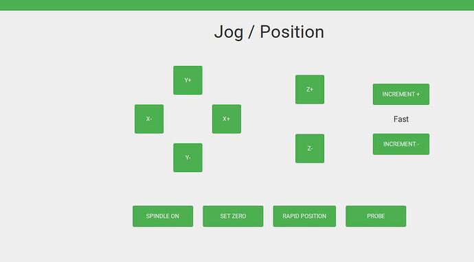

Have you seen the https://my.carbide3d.com/ site ? It has a bunch of tutorial/getting started videos, there’s one for jogging and zeroing: https://my.carbide3d.com/gswso/06/

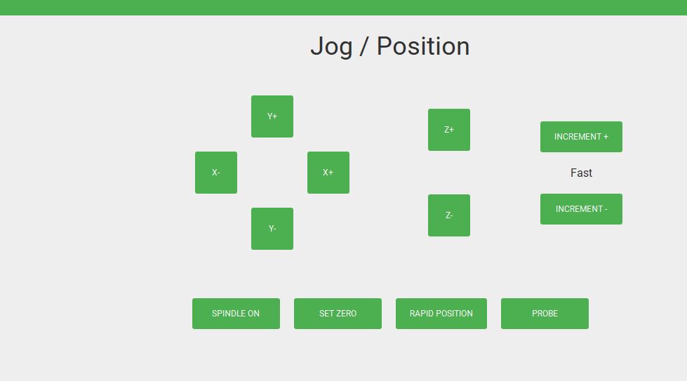

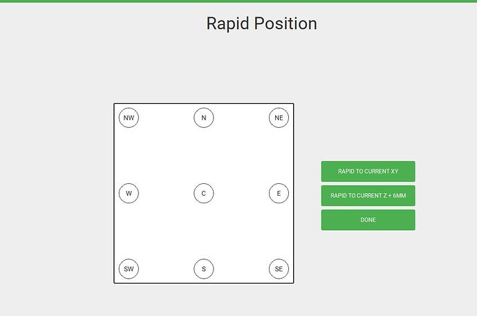

In Carbide Motion, once you have loaded a file, you can go to the Jog Tab. Once there you can jog. The rapid jog tab will move the machine rapidly to the position you click.

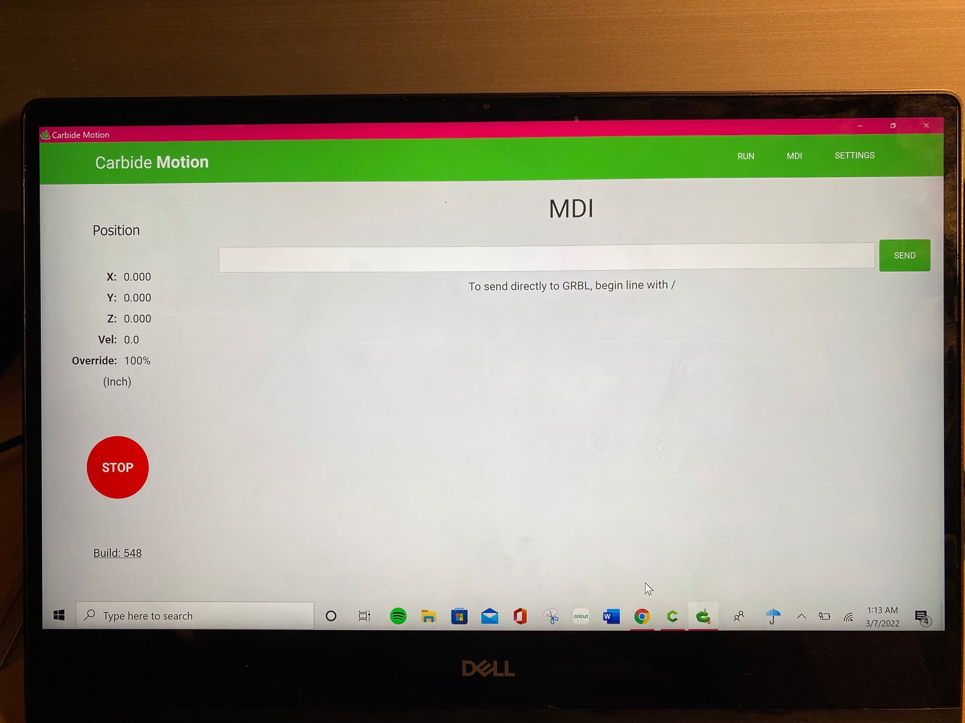

This is what shows on my screen
Sorry but I don’t have the “jog” option on my screen. Not sure what I am doing wrong and I have not seen any links to help. All videos show how to Jog, not how to find it.
Hi Rodrigo,
When you go the “Run” section, what do you see ?
Did you successfully “Initialize Machine”? The Jog menu will only appear after the machine has been initialized
Thank you so much. What happened was I almost broke it the first time I tried it (user error) and thought I was doing it wrong again. Was able to get my first cut tonight thanks to y’all’s help.
