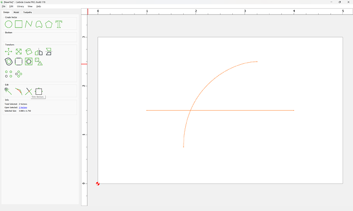

Join a straight and curved line
For those familiar w/Andy Bird’s pumpkin catch tray I’m trying to modify it as per my wife’s request. Essentially I’m looking to creat two pockets with a raised middle that a grandchild can put a hand print on; I basically want to flow a curve of the stem into a rectangle that runs the length of the pumpkin and flows back in at the bottom
Post a marked up screen grab showing what you are trying to do as well as the file you are working on?

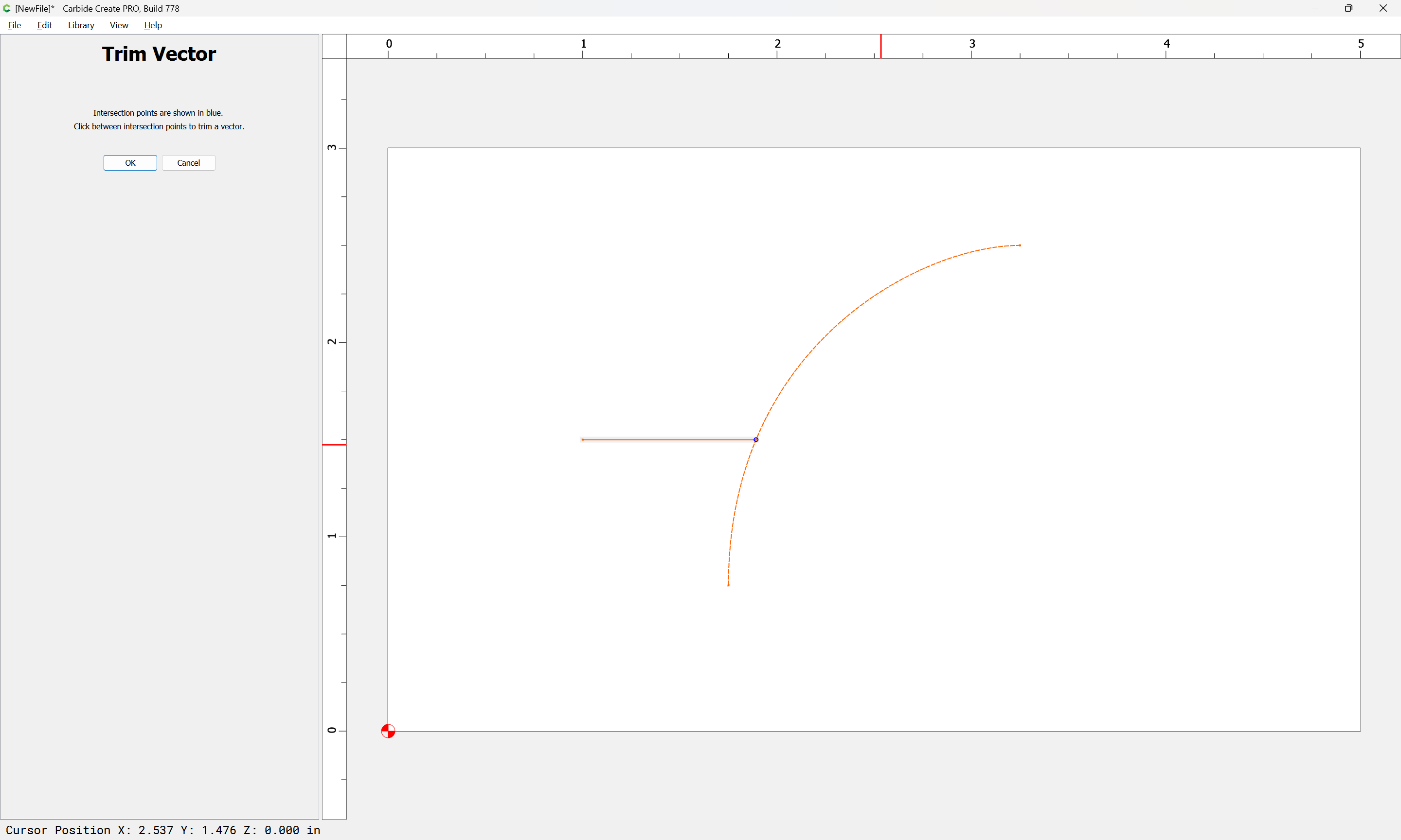

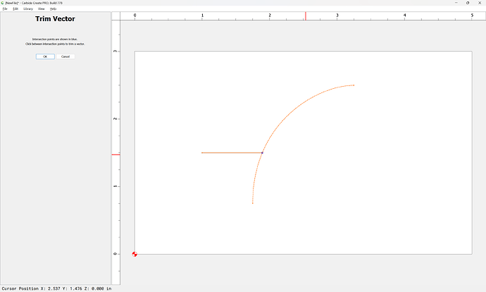

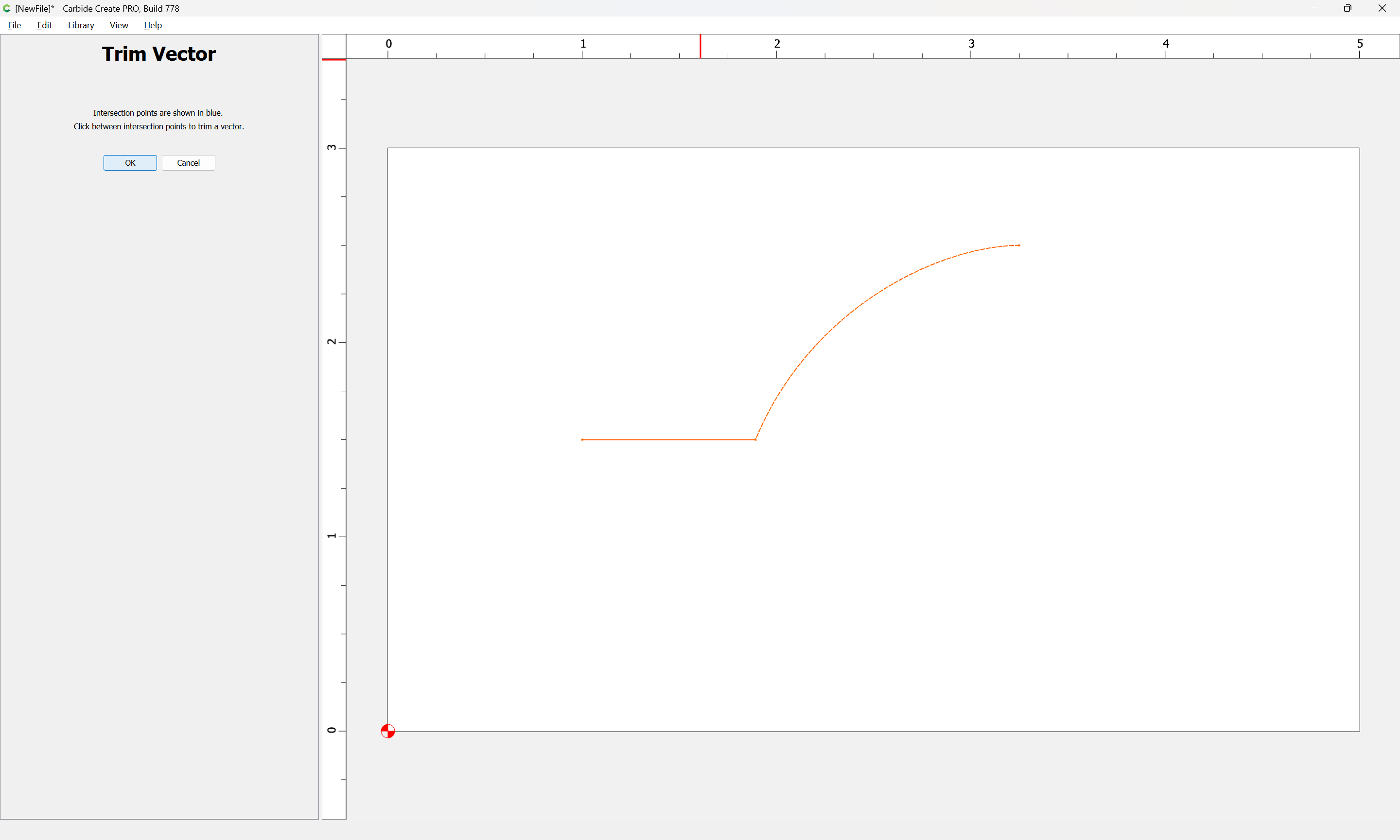

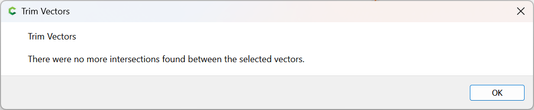

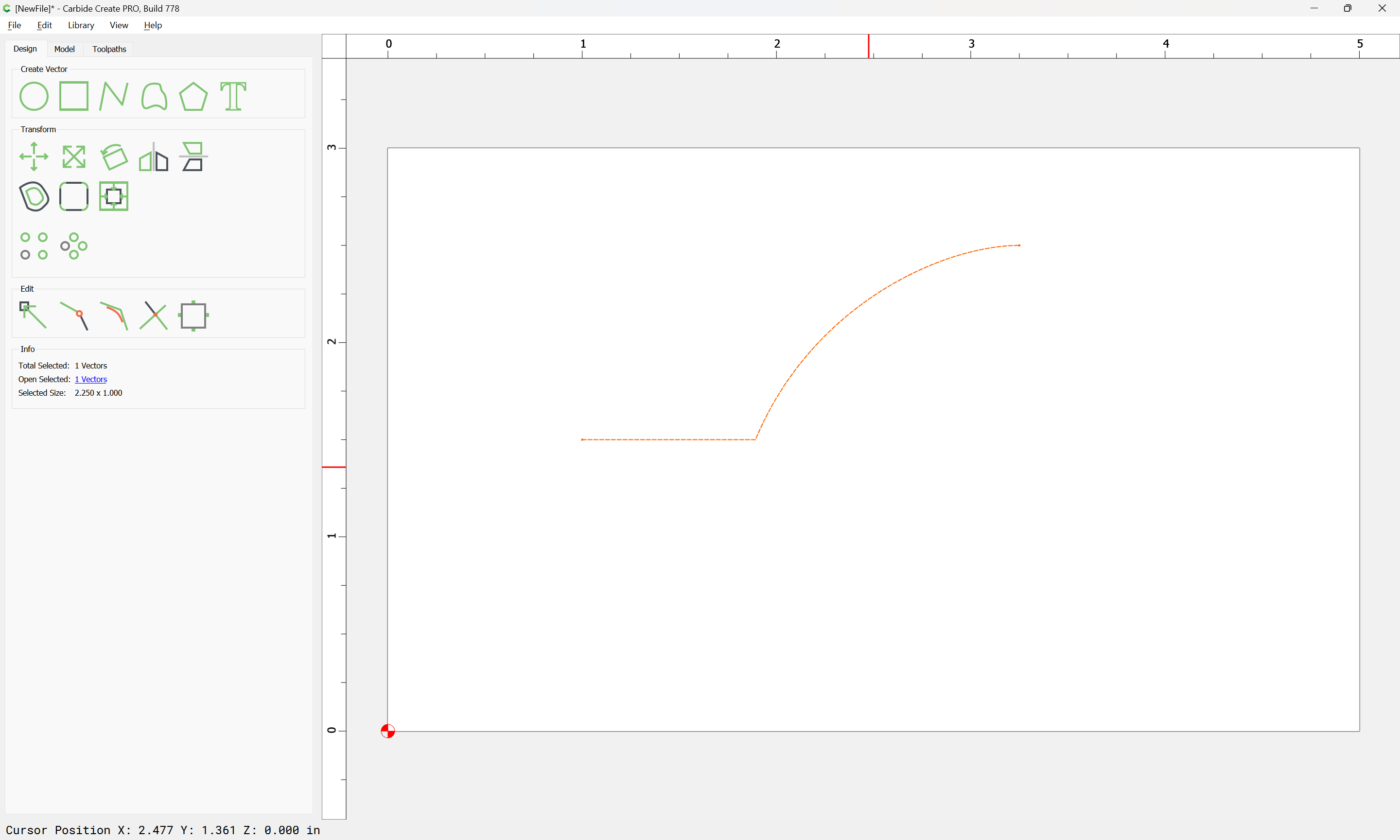

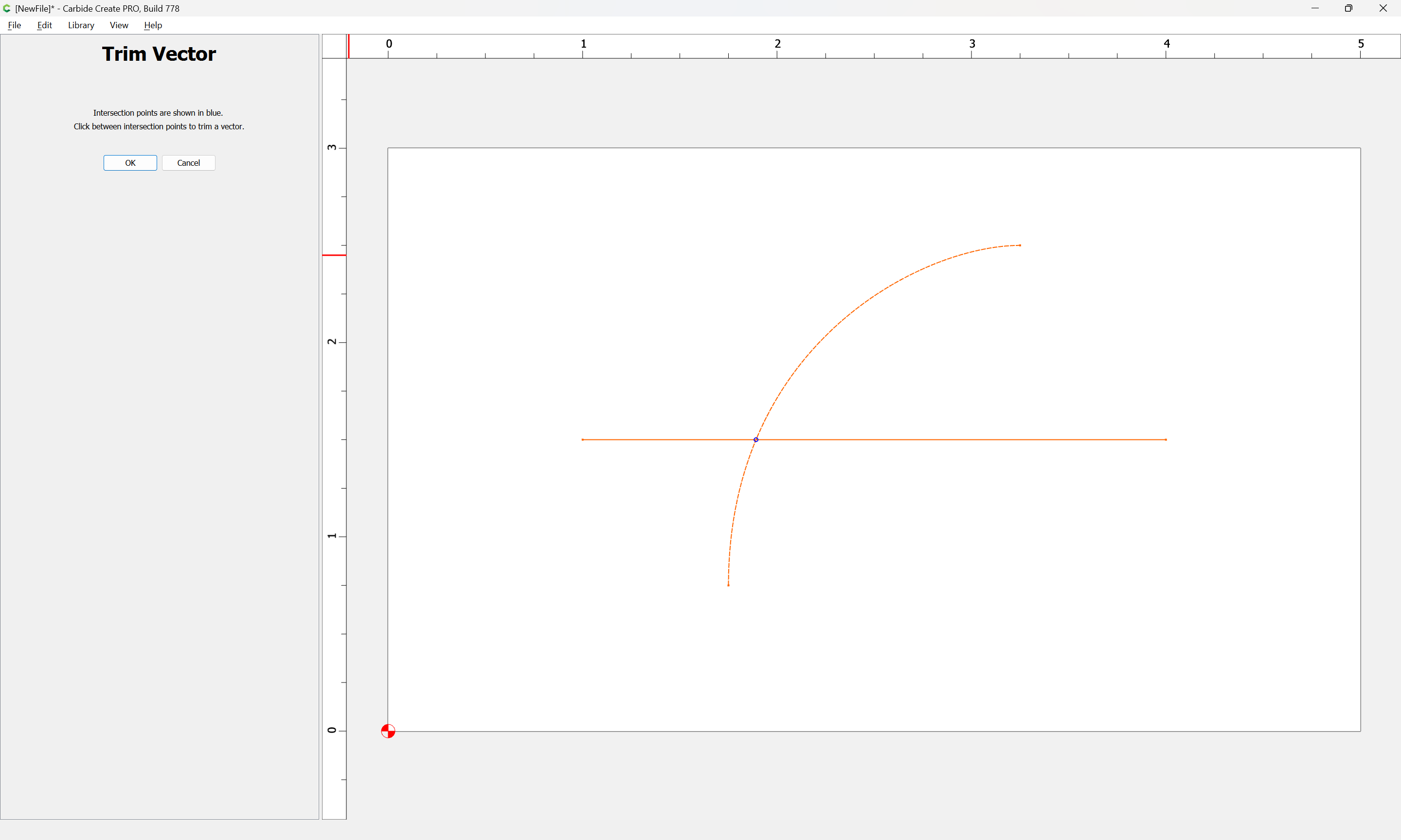

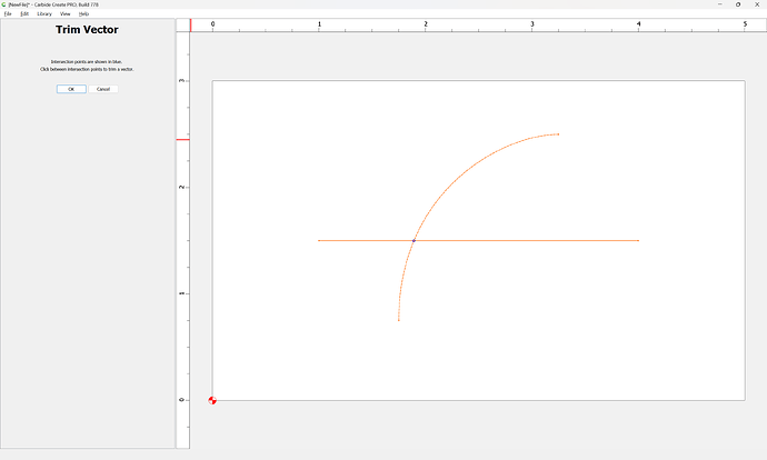

Have you tried the Trim Vectors tool?
For example:
Trim Vectors

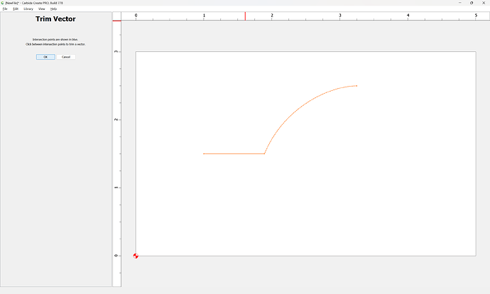

Click on what is not wanted to remove it:
OK
OK

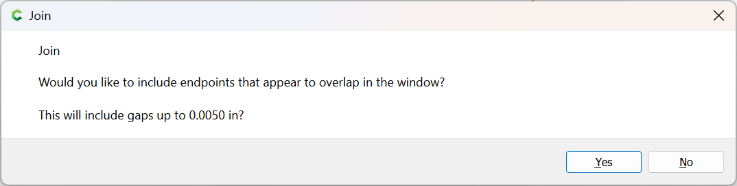

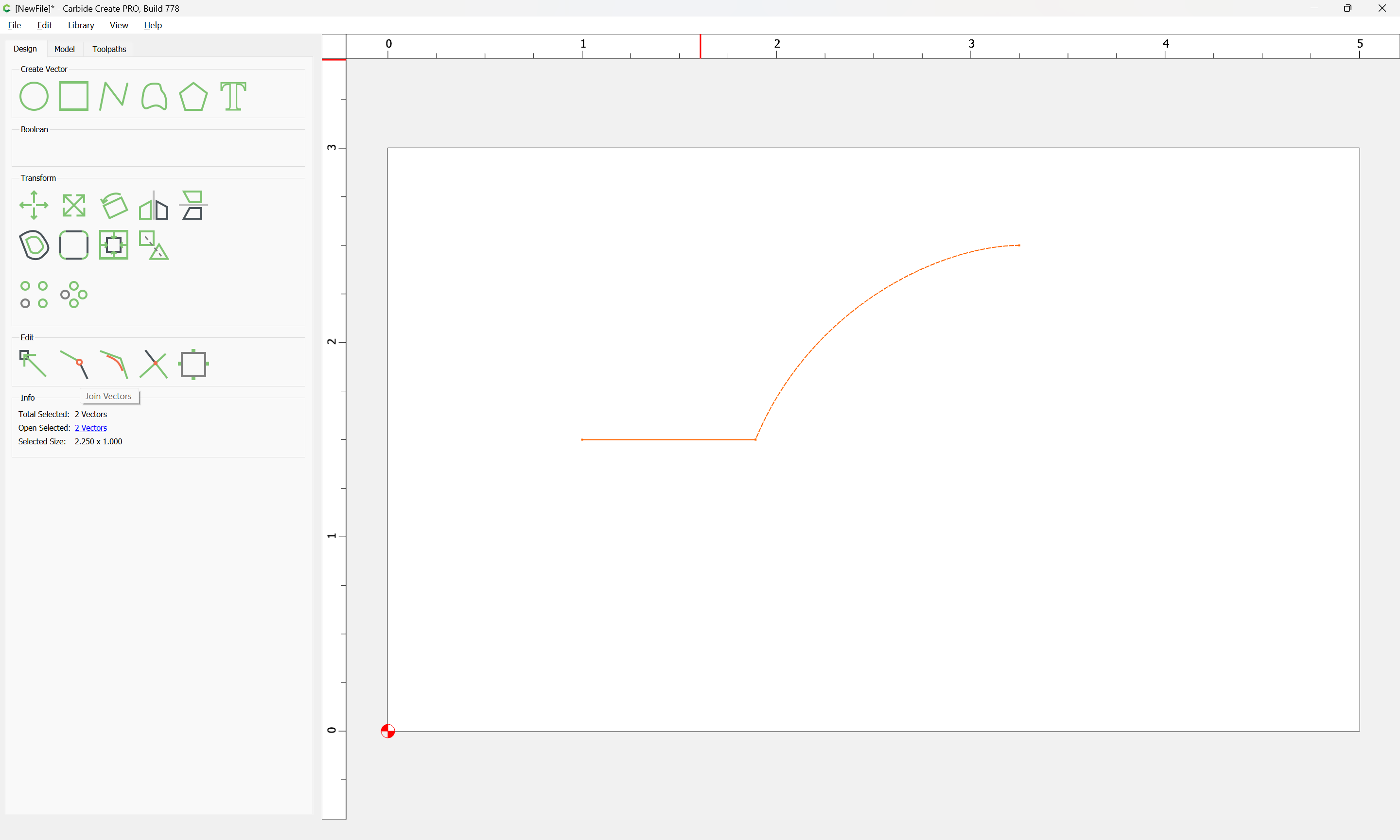

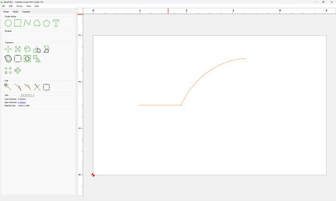

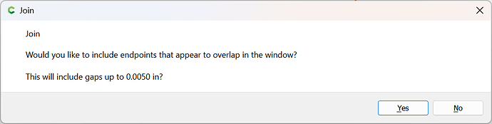

Join Vectors
Yes
