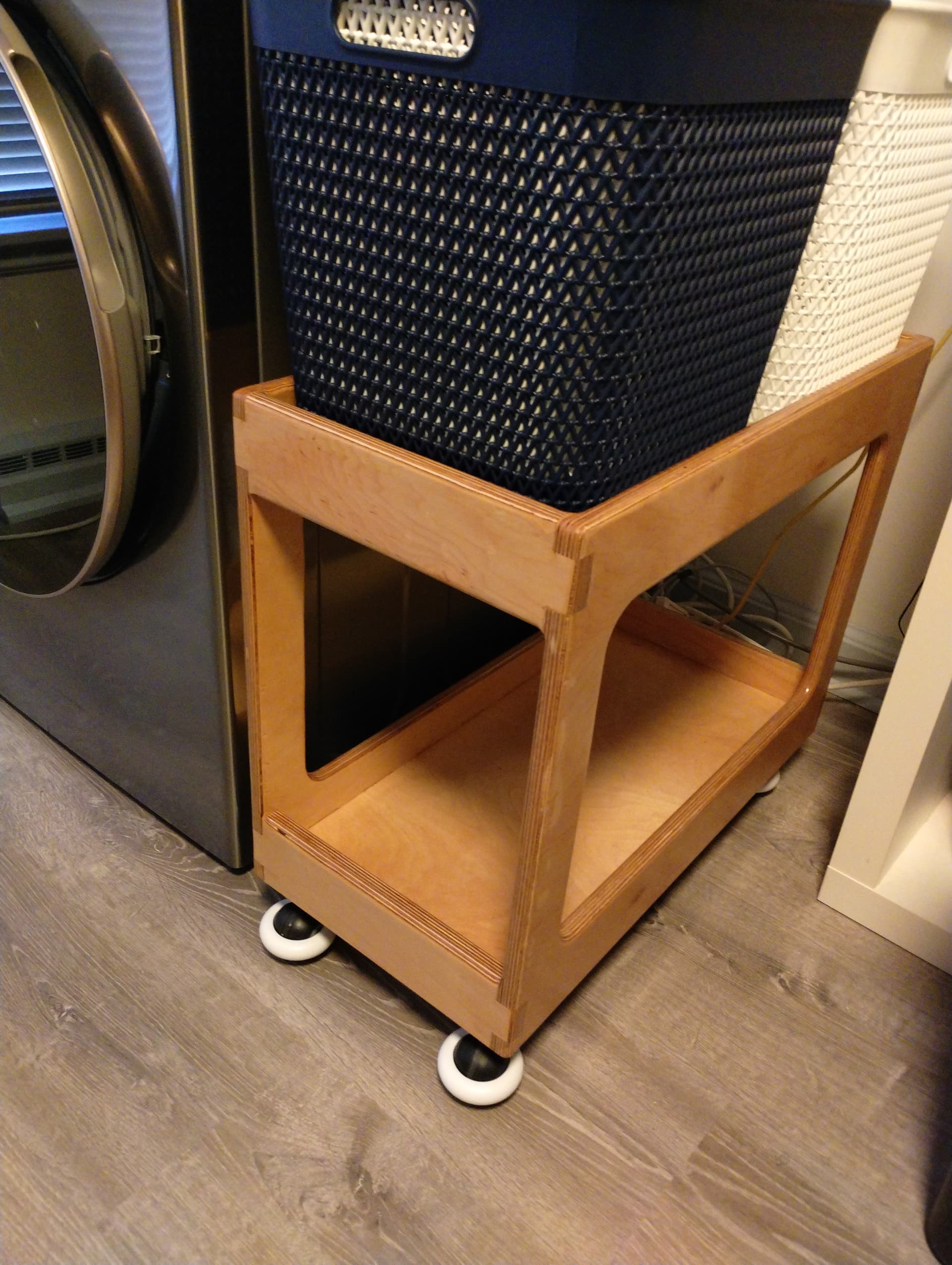

Yes, the armchair that Kevin presented a while ago is on my agenda. Not on top, but eventually. I also intend to transfer it to the “flat” joints, I just do not trust the joints to carry my weight, and friends I make that stuff for should be safe too. The woodie stool I uploaded here serves in my urology office in upstate NY, was intended to be there for purses or bags. You would be surprised how many and how heavy people decide to sit on such a furniture.
FWIW, I did look at mortise and tenon joinery at:
Will, yes, TY! These 90deg-joints I use often, however it took a while to understand how dogbones work, and how deep to cut the mortise to be kept hidden etc, worked well with this one IMO:
no screws or any metal connectors, just mortise/tennon and wooden dowels.

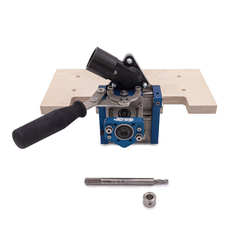

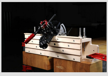

I have a Jessem Pocket Mill Pro with the workstation to make loose tenons that use the Festool Domino tenons. The Jessem version can make dowels with their doweling kit. The Jessem versions are not cheap but work well. Jessem worked with Kreg and have a cheaper version of the Pocket Mill Pro.
Kreg Version
Jessem Version

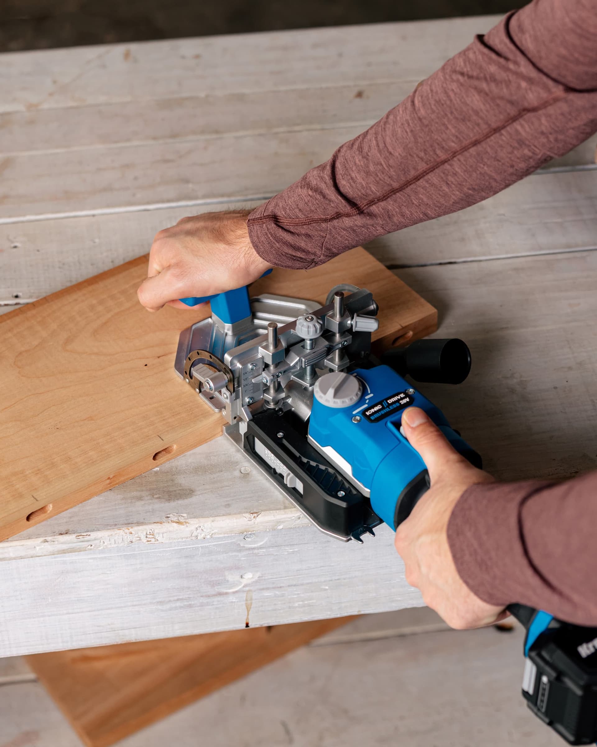

I just saw an advertisement that Kreg is going to have a domino like machine.
Kreg has really stepped up their product offerings.
Yeah, implied the Kreg’s existence in my post above — there’s been some lengthy discussion of it over on the Festool Owner’s Group forum.
