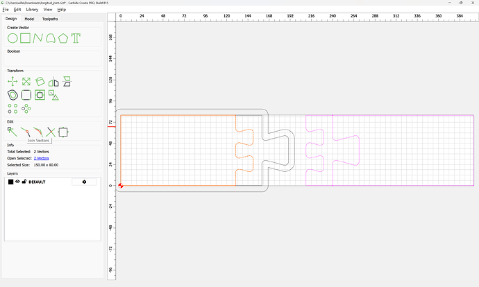

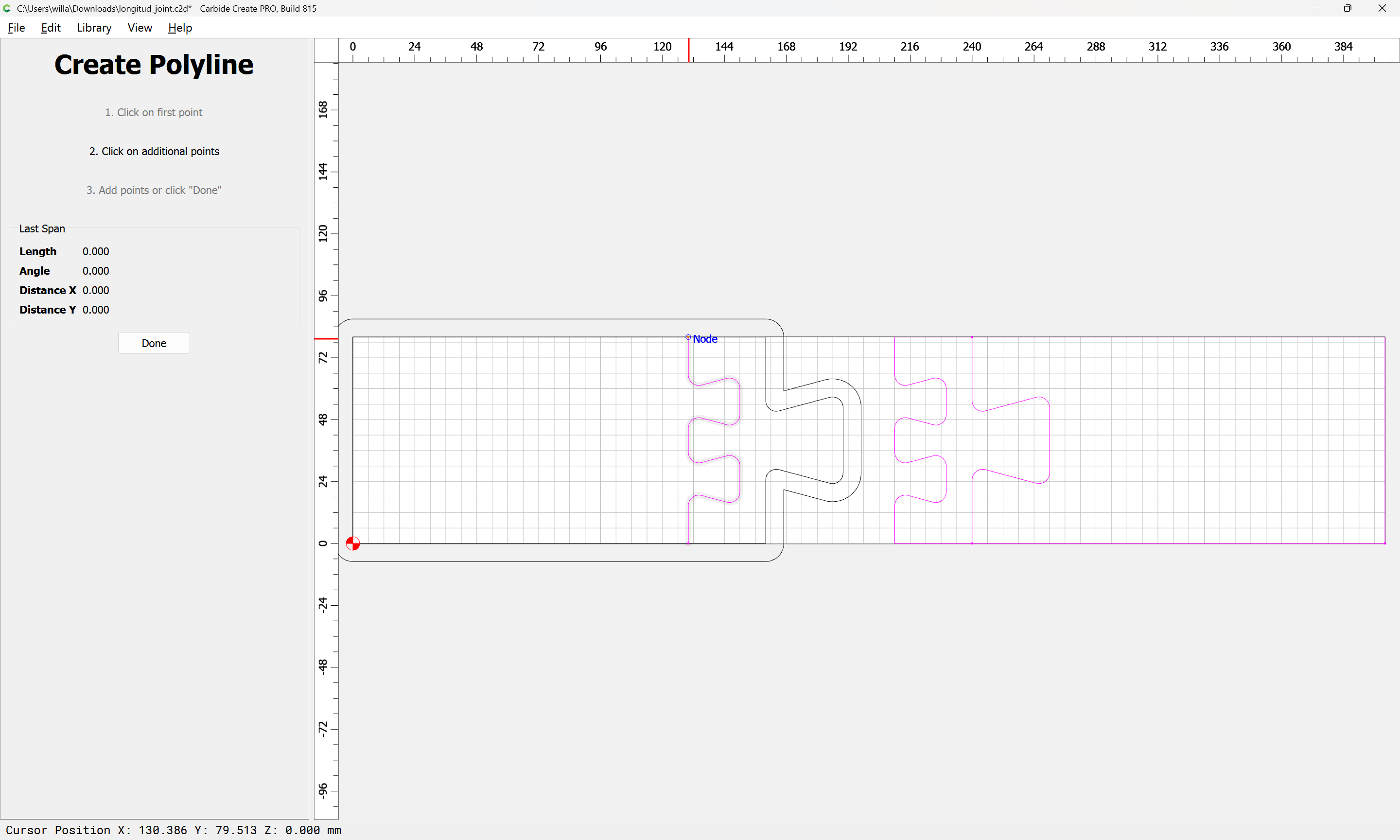

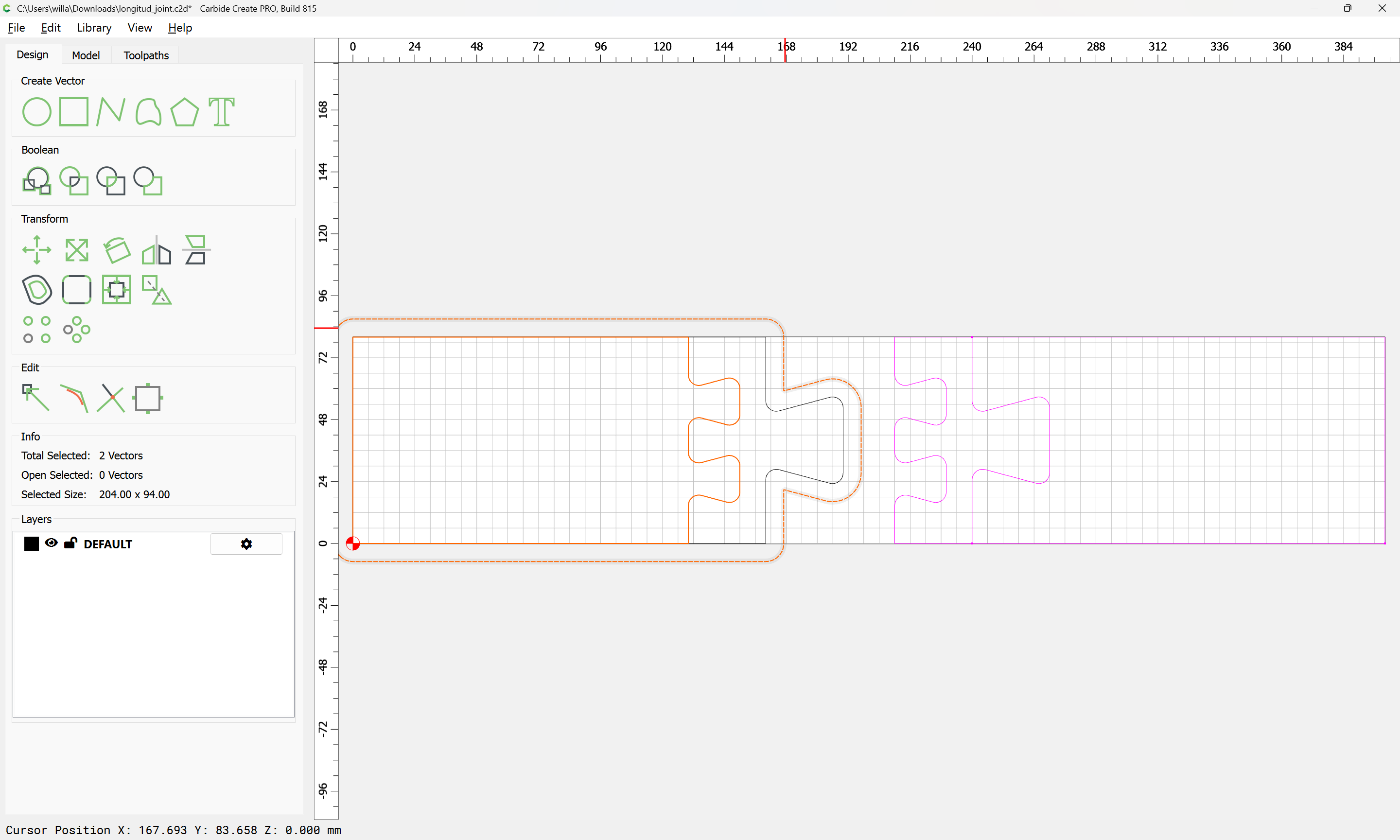

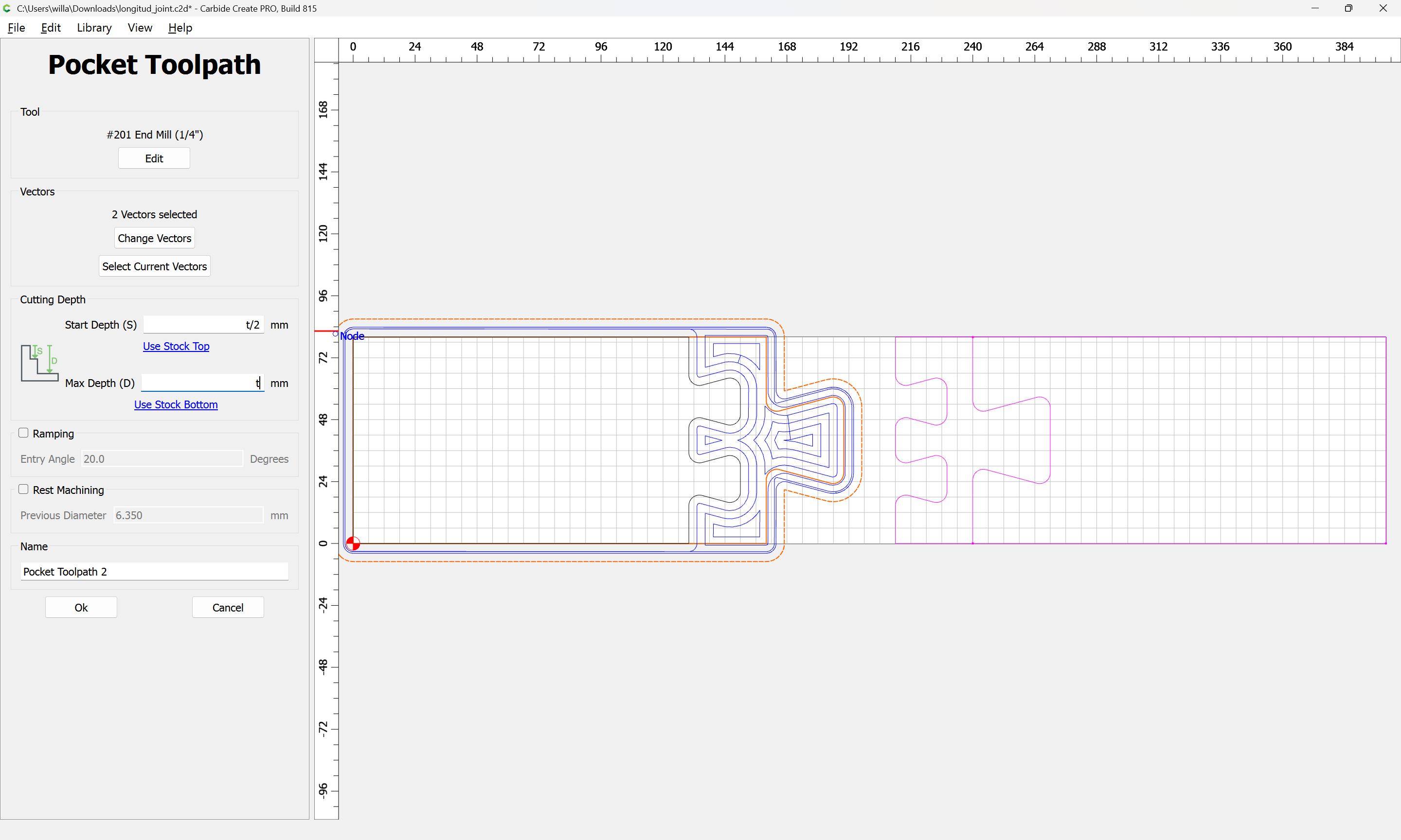

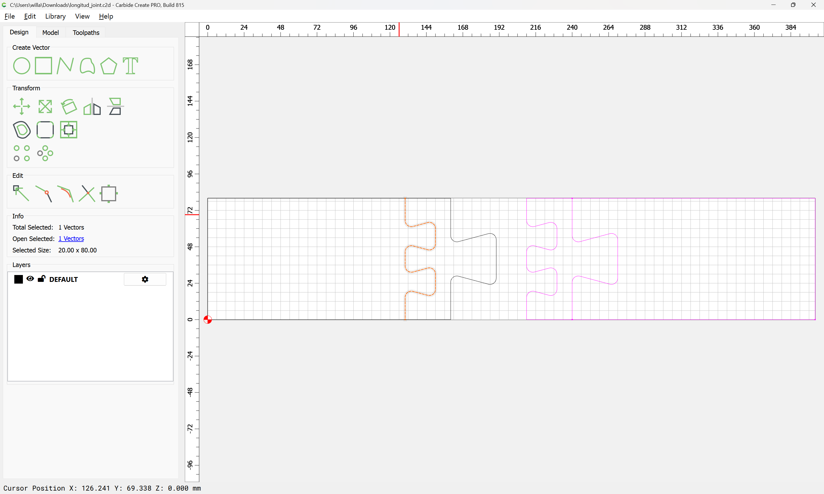

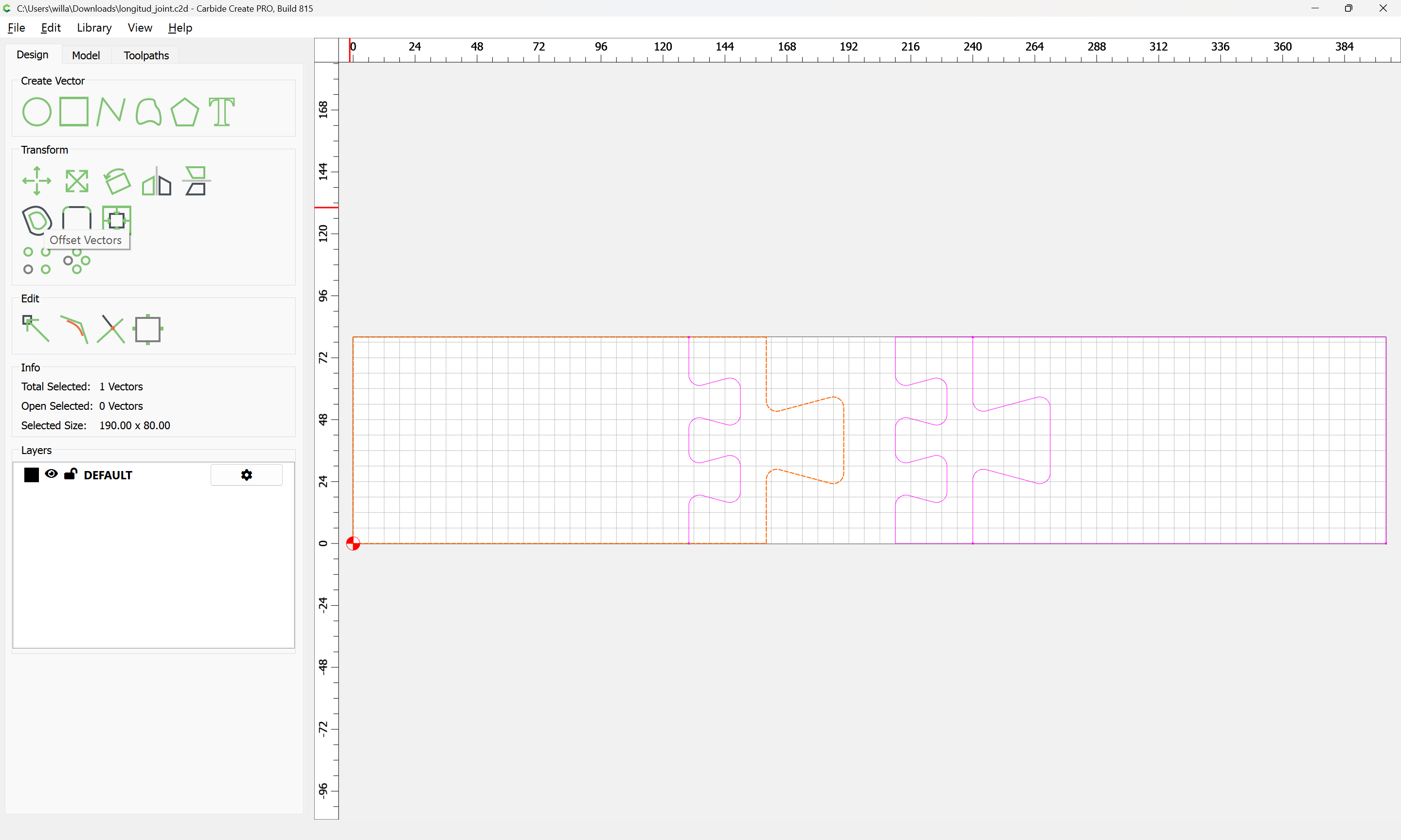

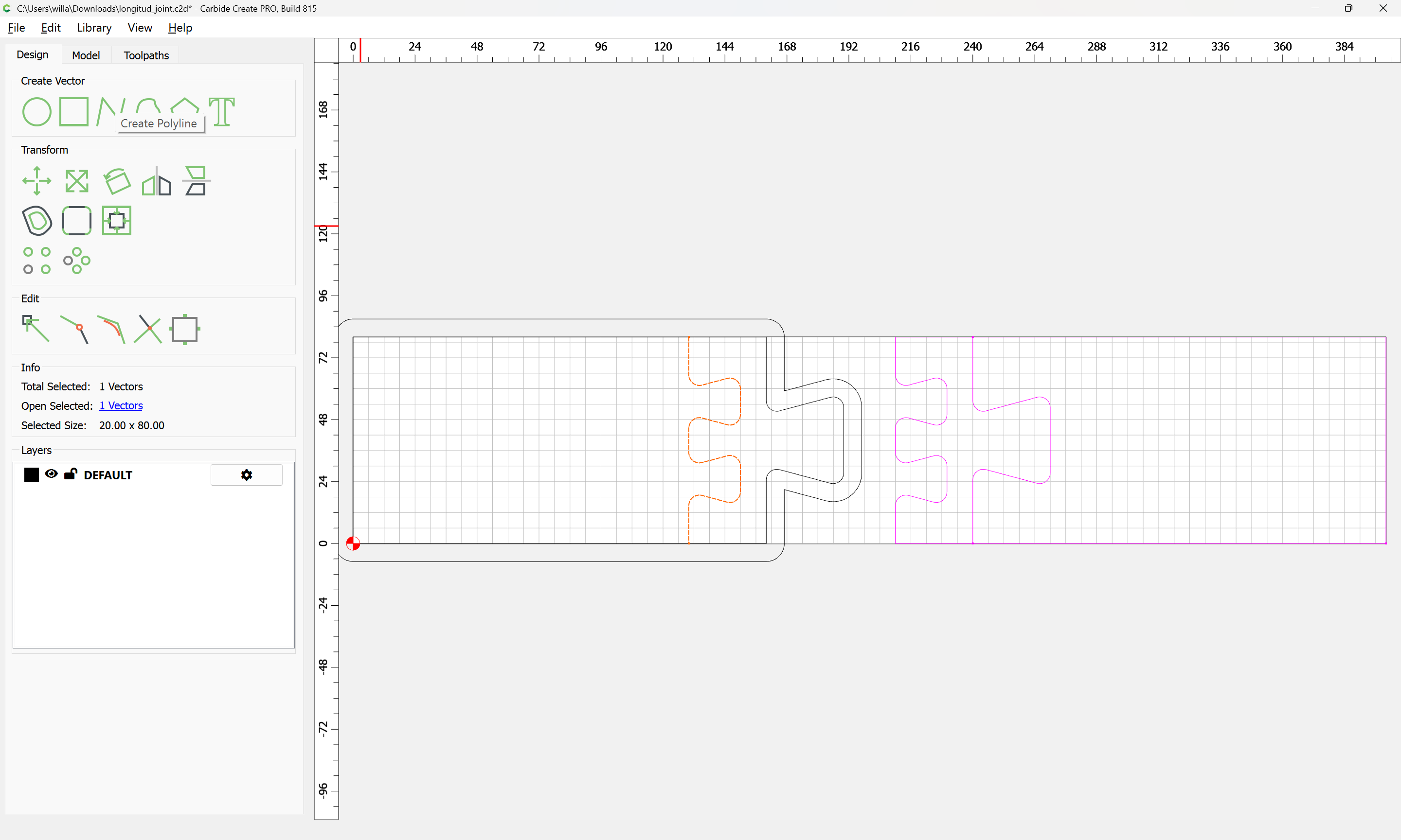

Hi, try to develop joints like these,
came to that kind of project
longitud_joint.c2d (60 KB)
and failed to proceed with a toolpath. The both pieces should be identical. Could never get rid of loose ends. No rush, but if I continue cutting projects from plywood instead of connecting boards I get crammed with all the leftover cutouts.

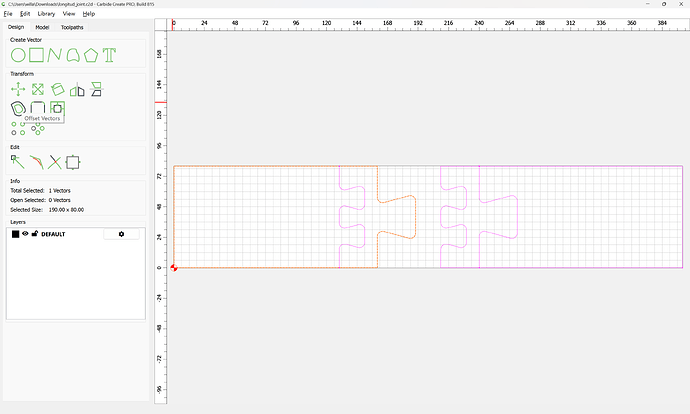

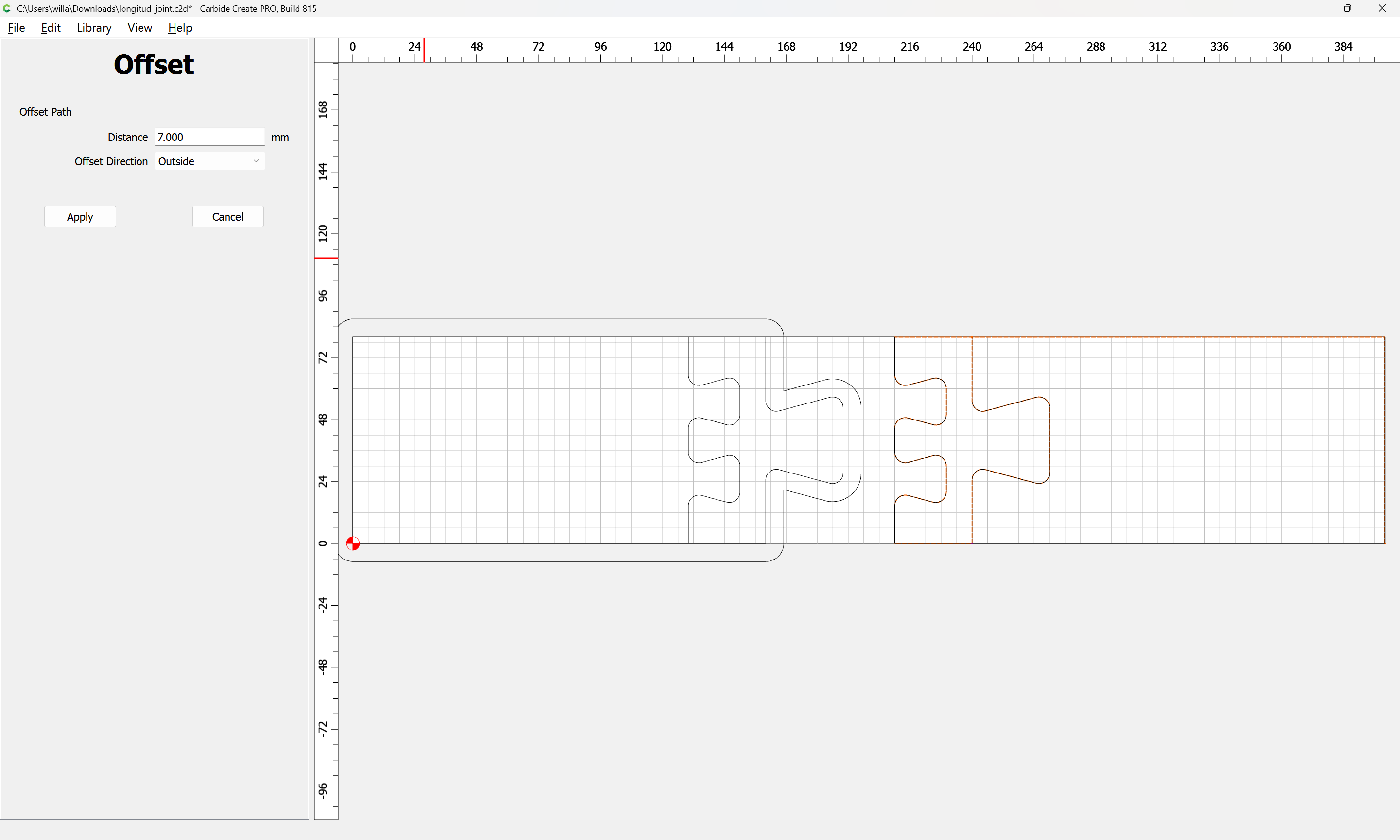

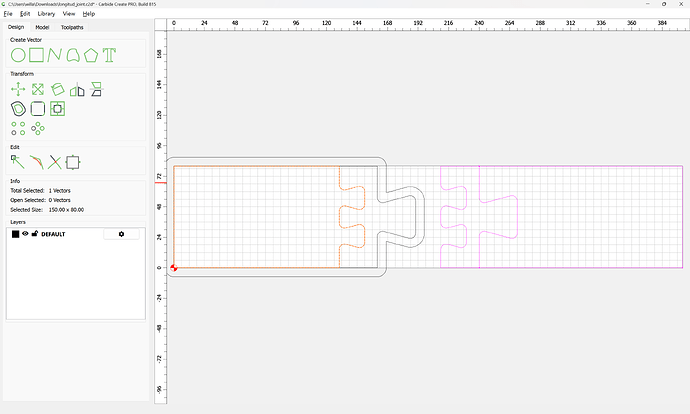

You need to define regions for the toolpaths in question:

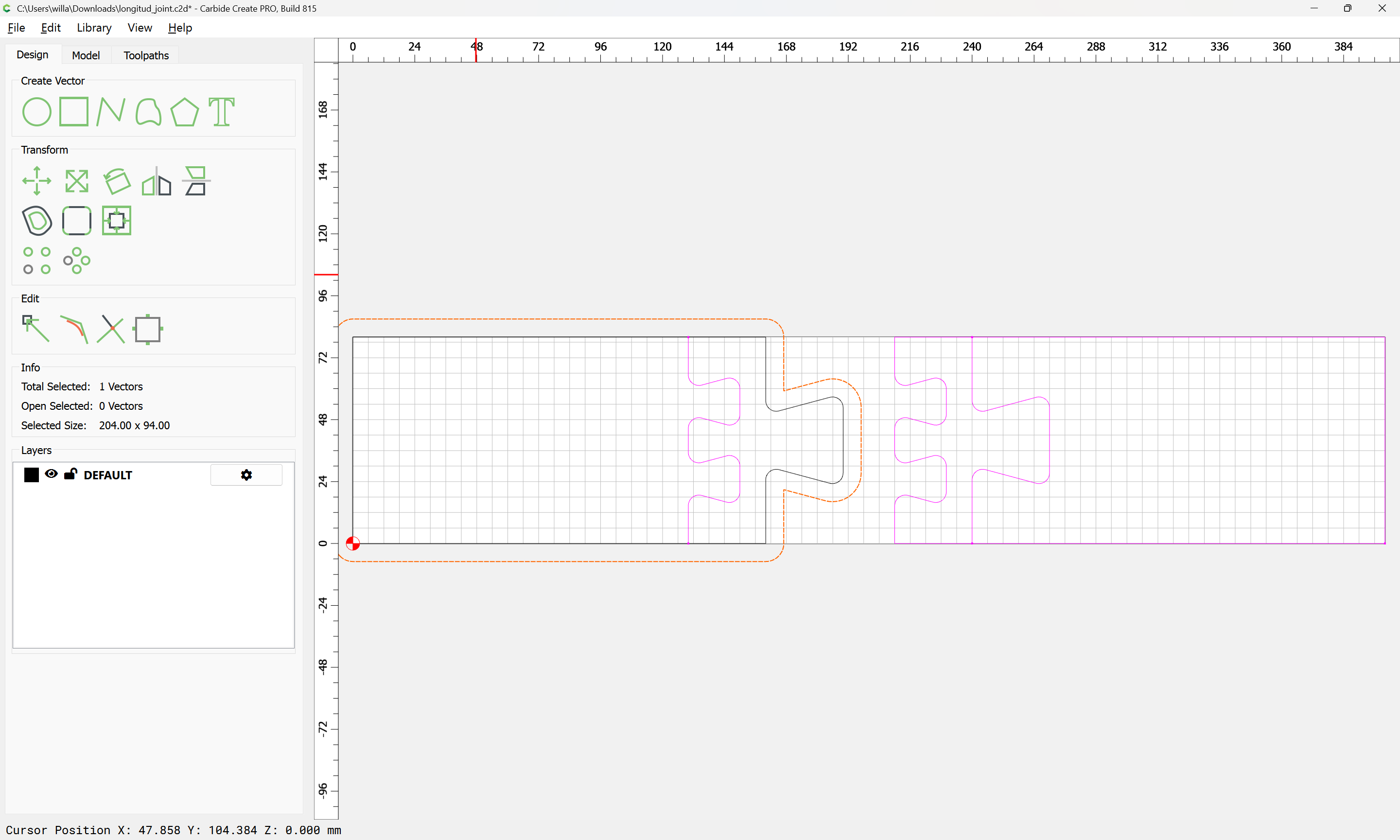

in two layers — start with the region of greatest extension:

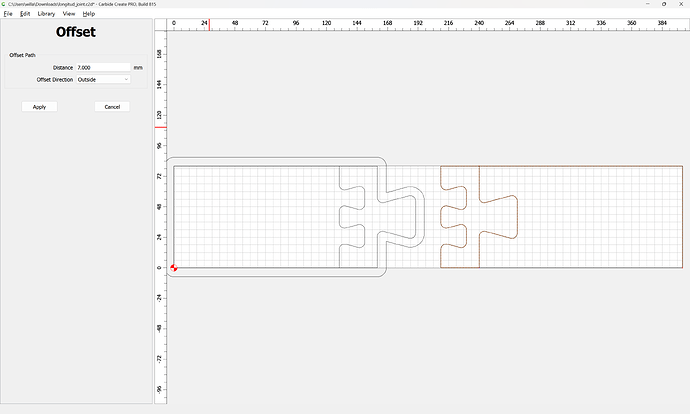

offset by tool diameter plus 10% or so:

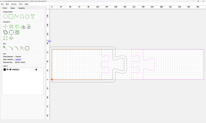

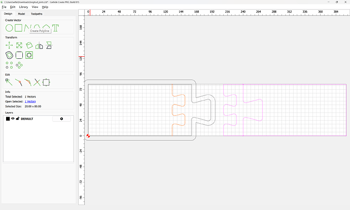

(assuming a 6.35mm tool)

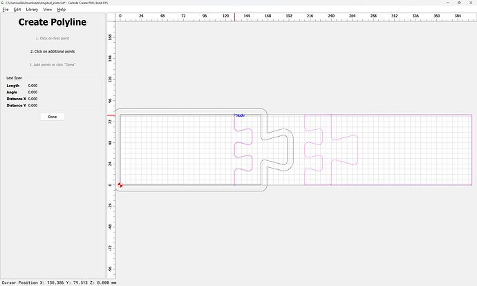

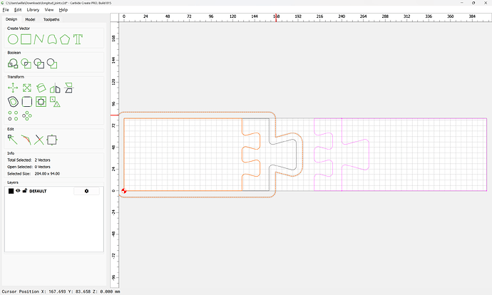

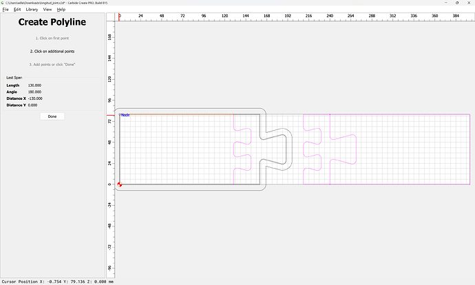

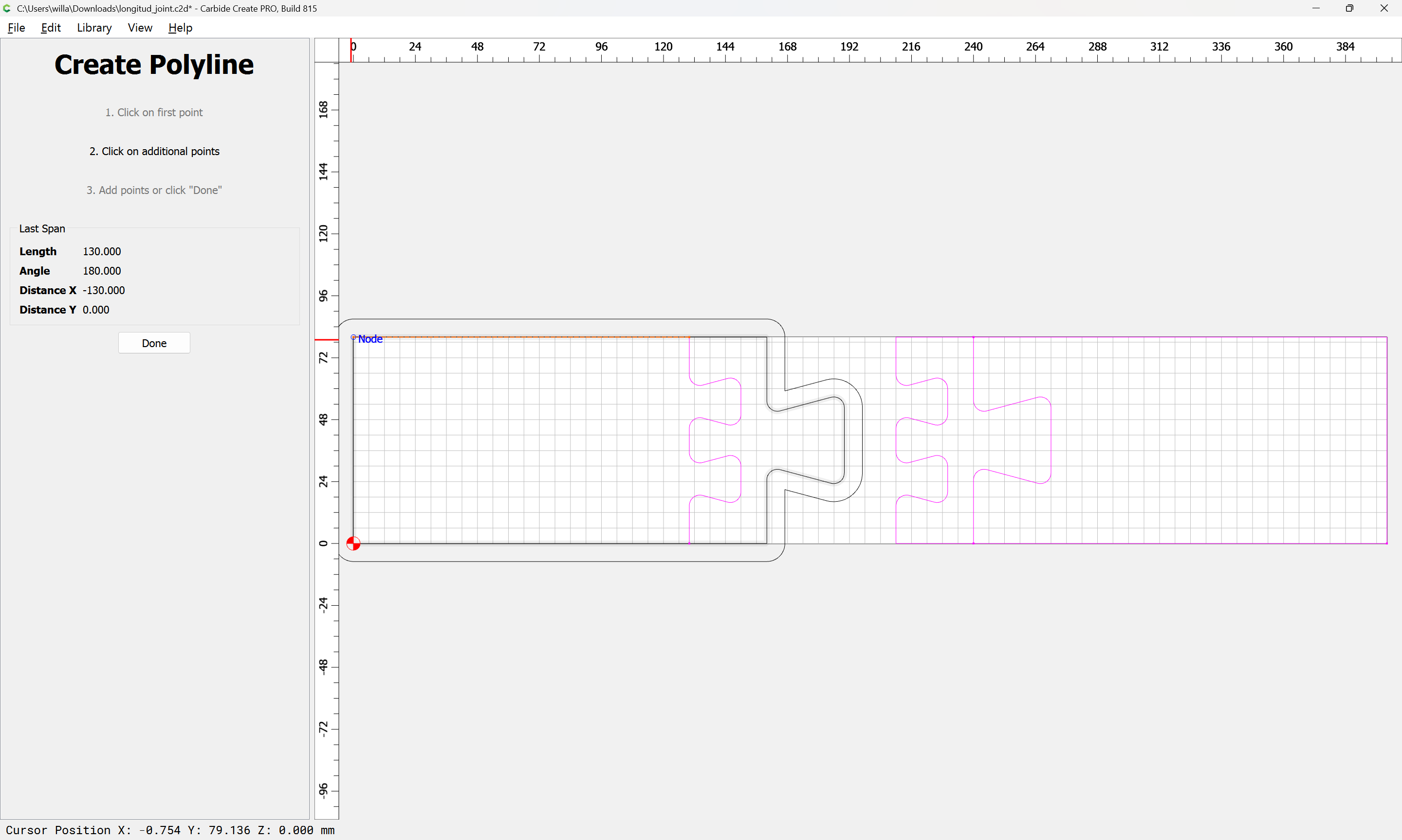

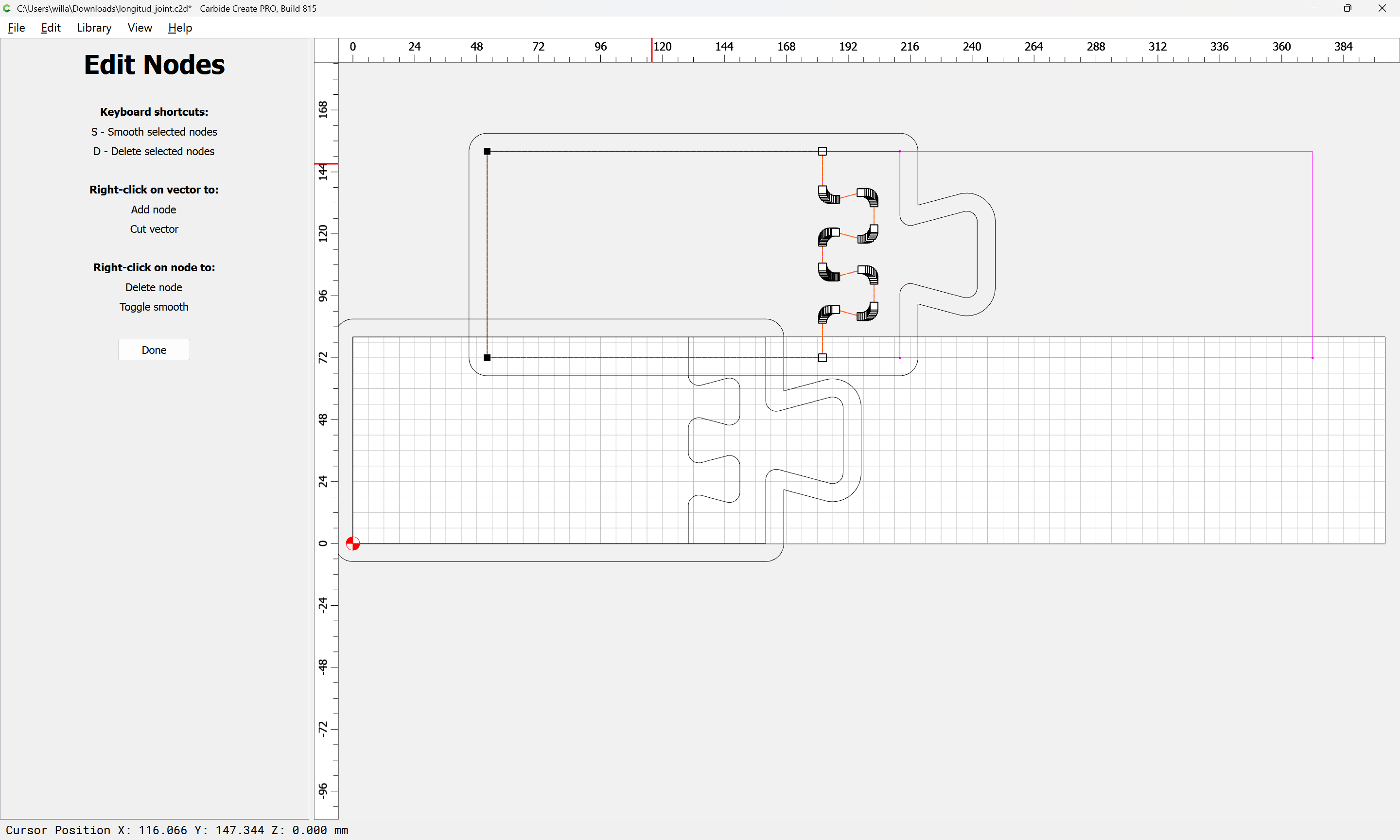

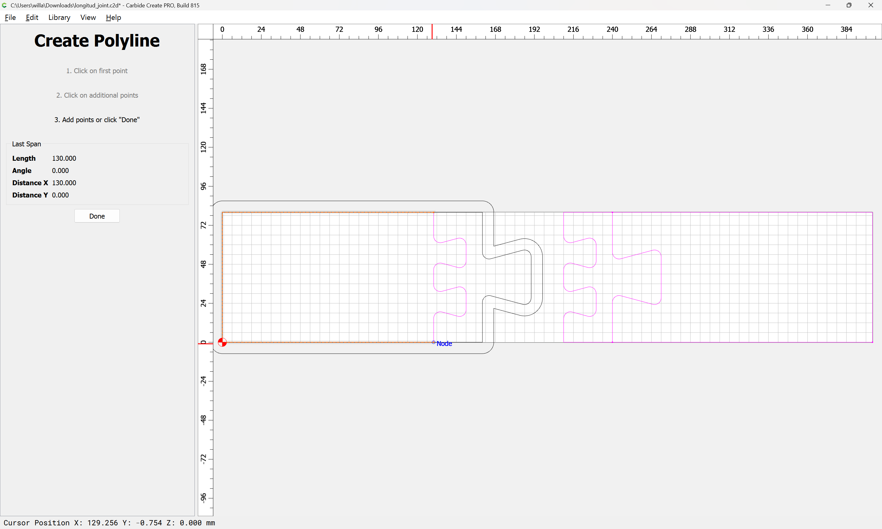

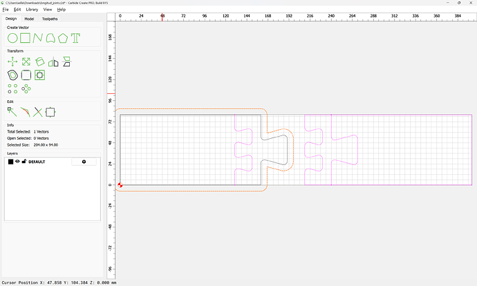

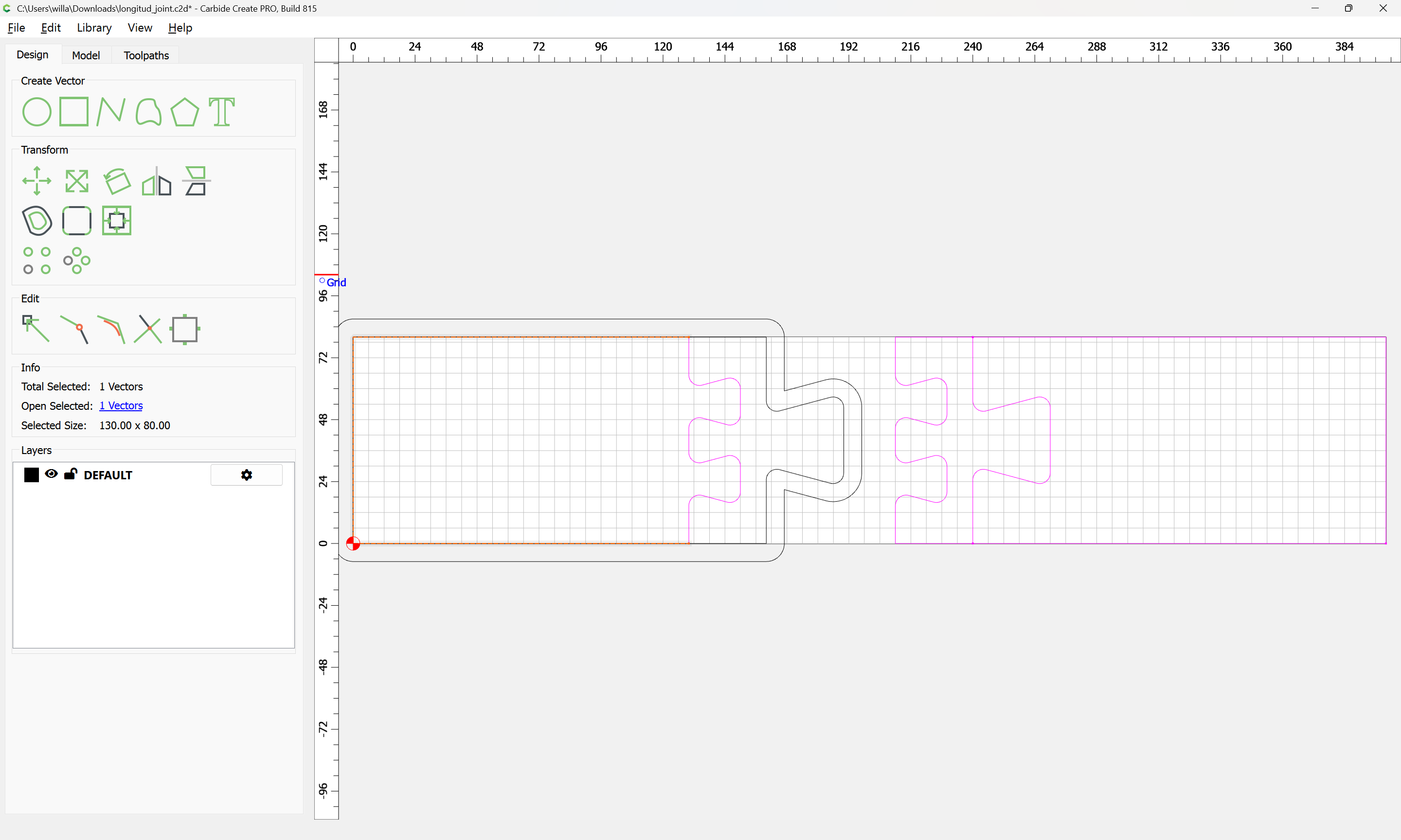

Then you need to create the shorter-upper region — draw in the missing geometry for it:
Done

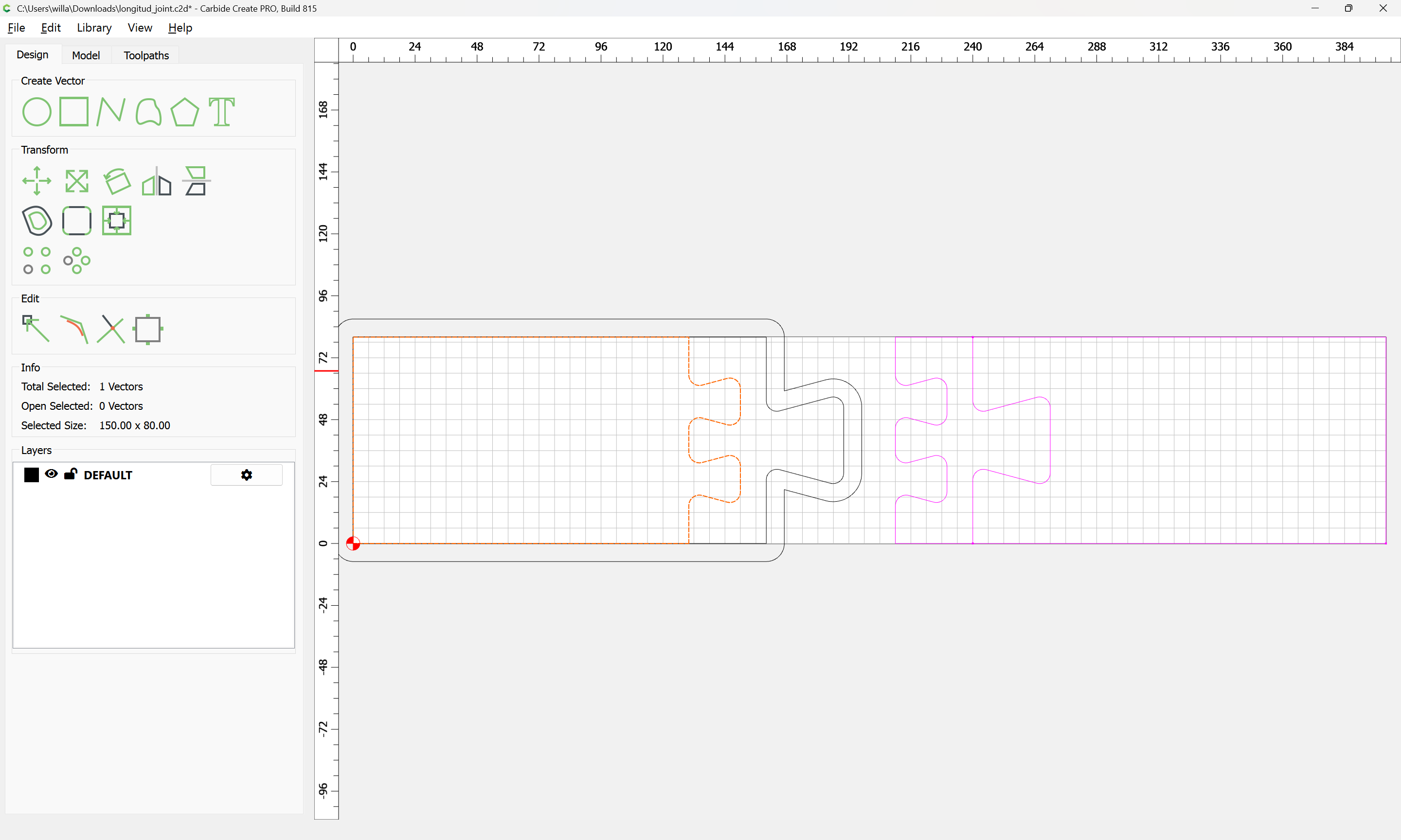

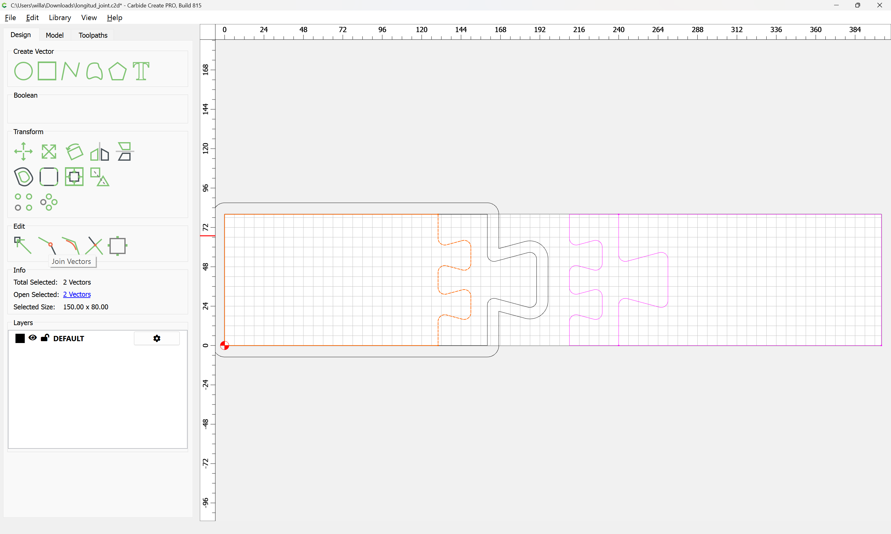

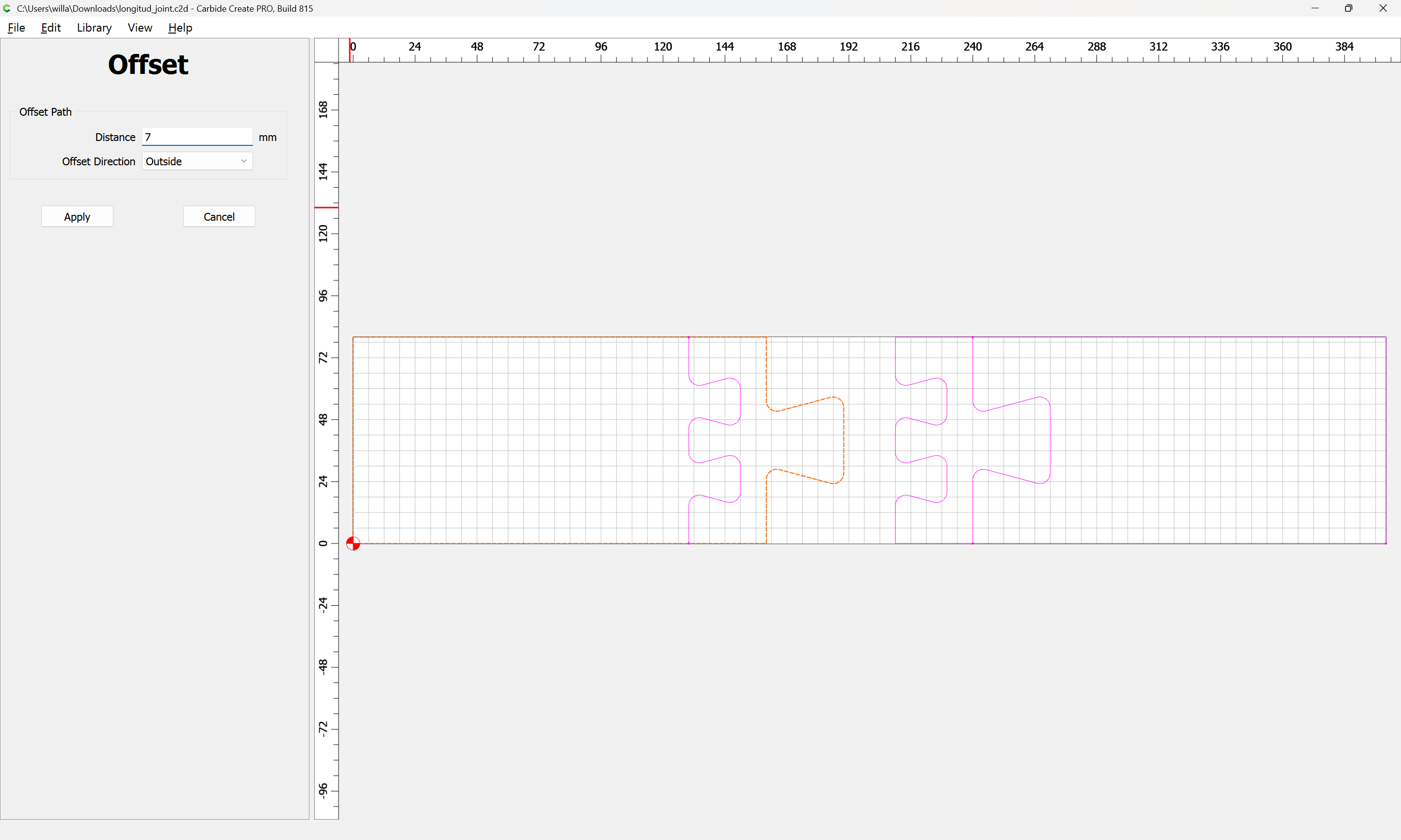

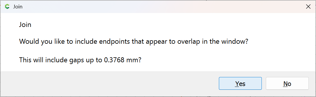

and select everything and join:
Yes

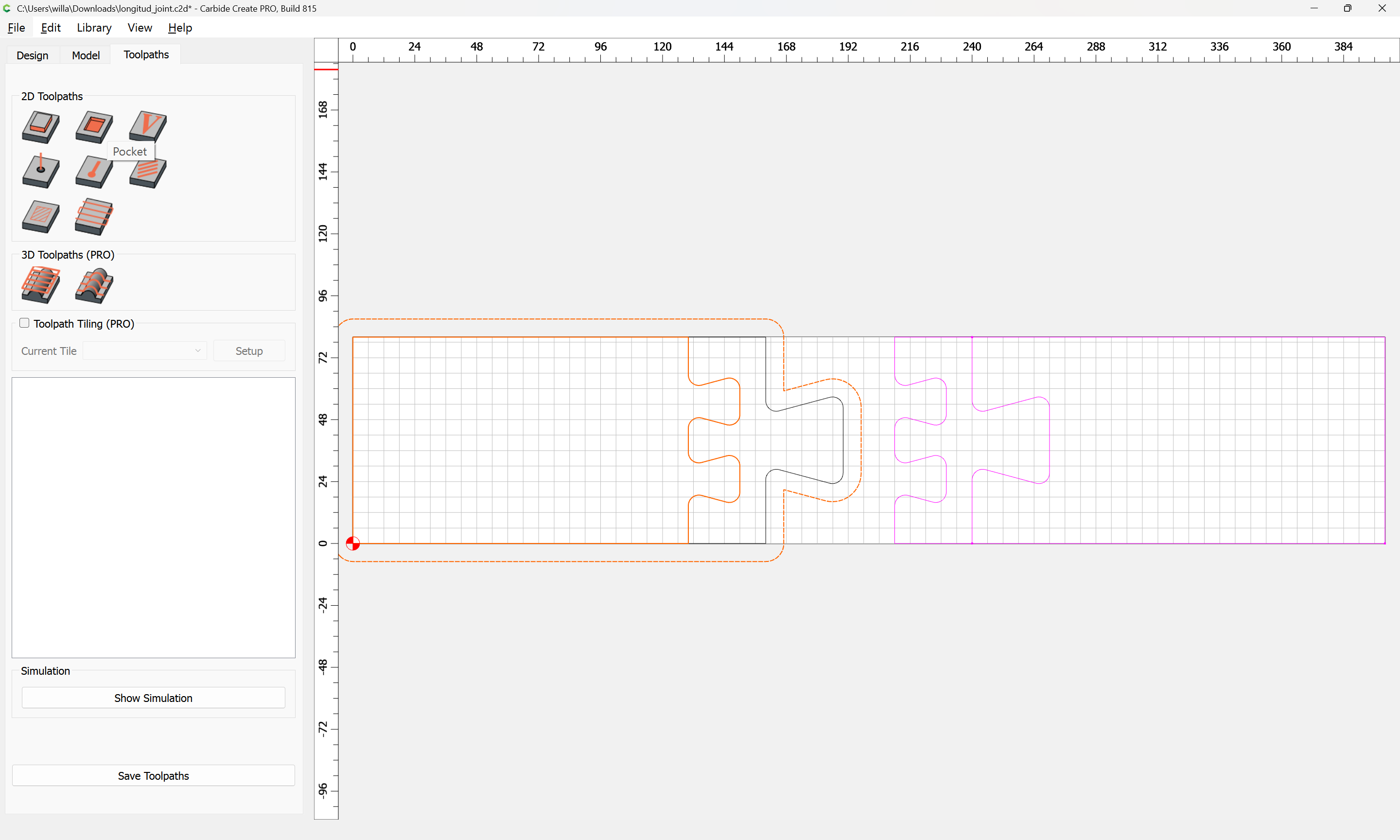

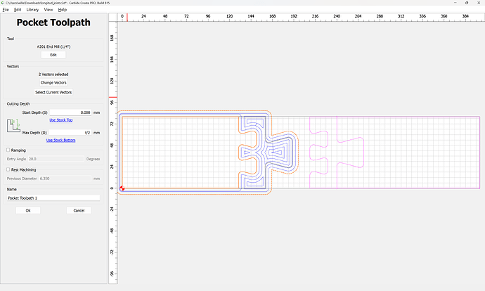

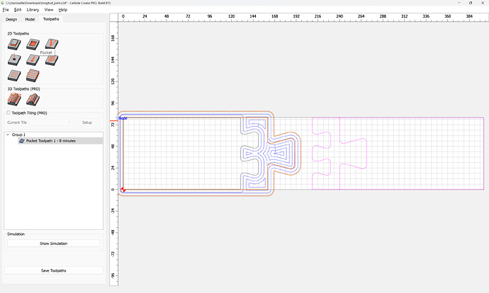

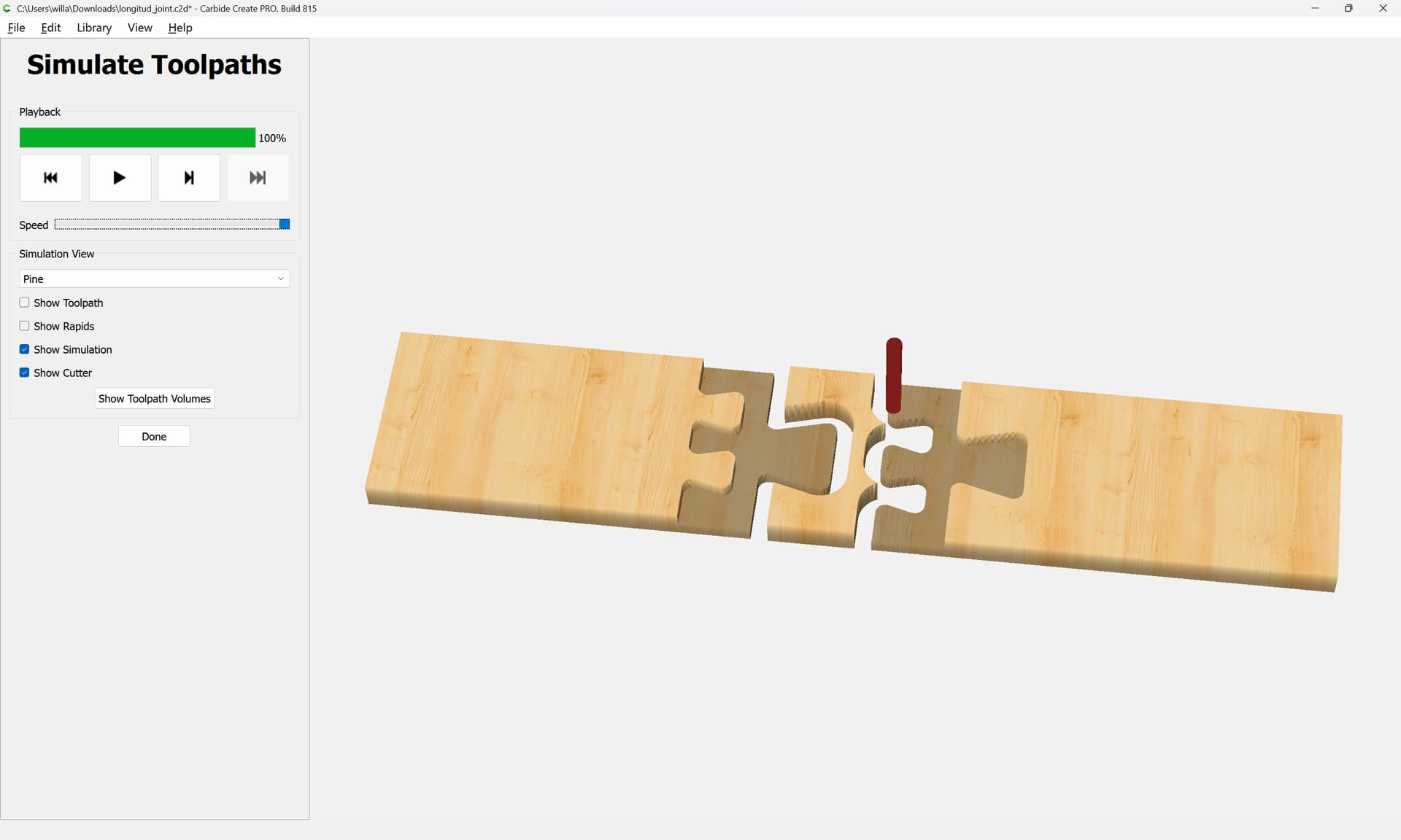

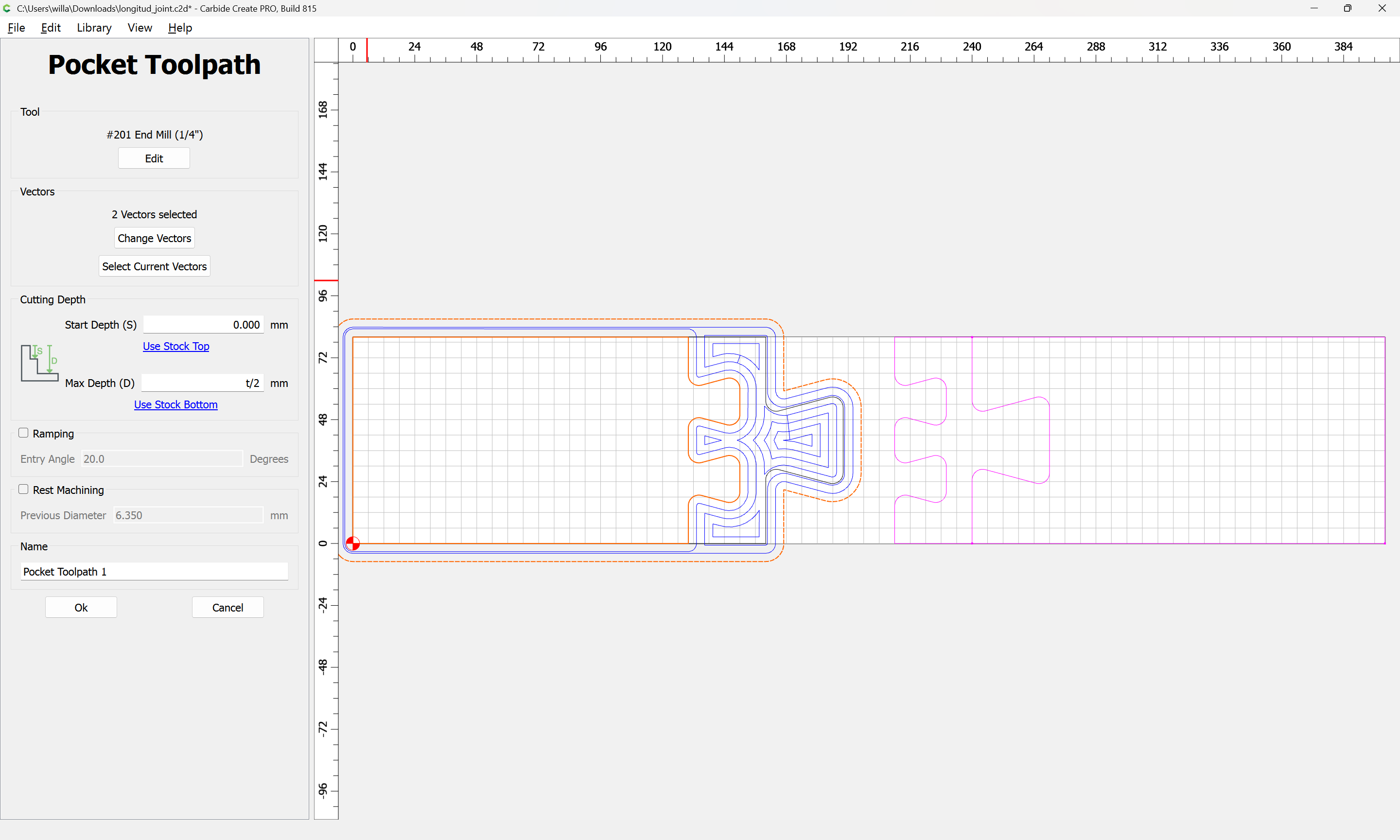

Then, assign toolpaths — cut the first half of the thickness:

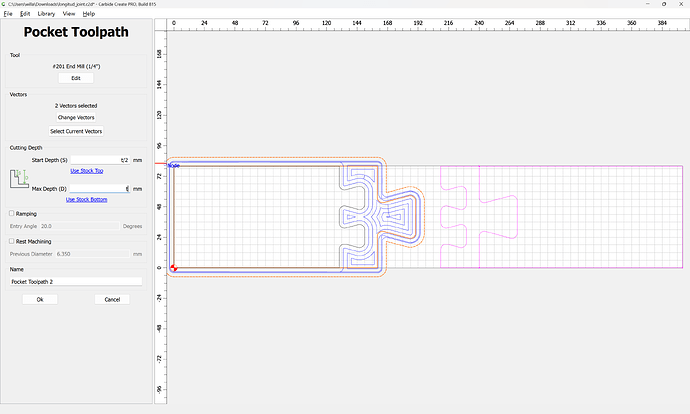

Then create a toolpath to cut the balance:
starting where one left off:

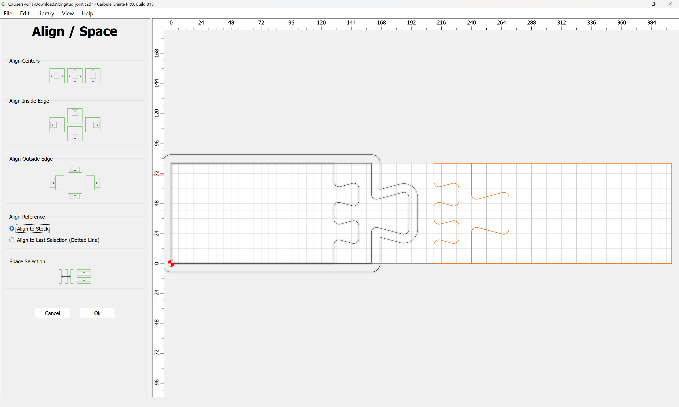

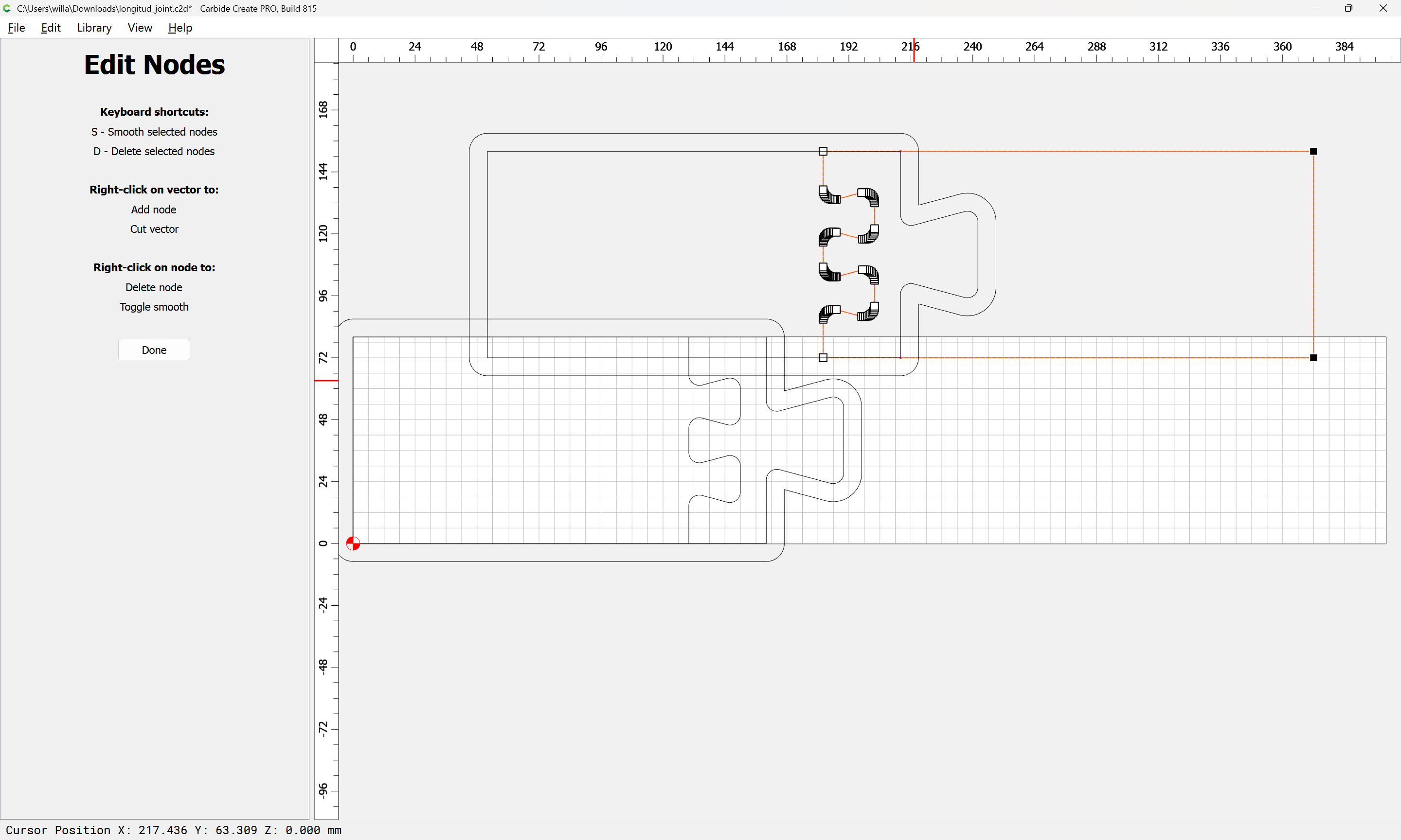

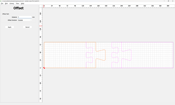

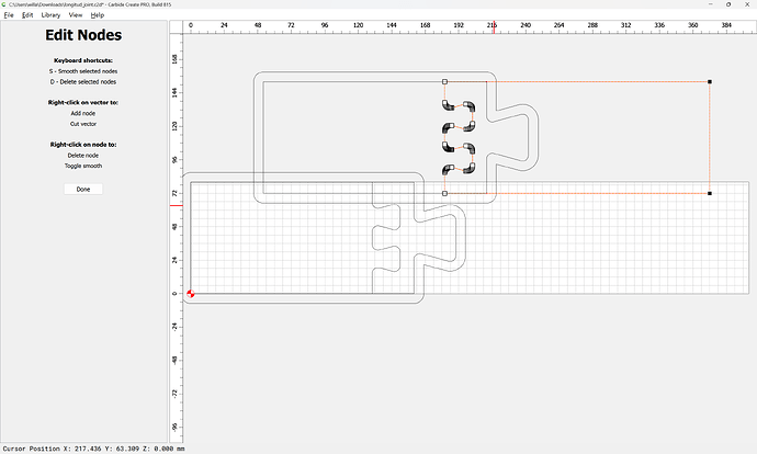

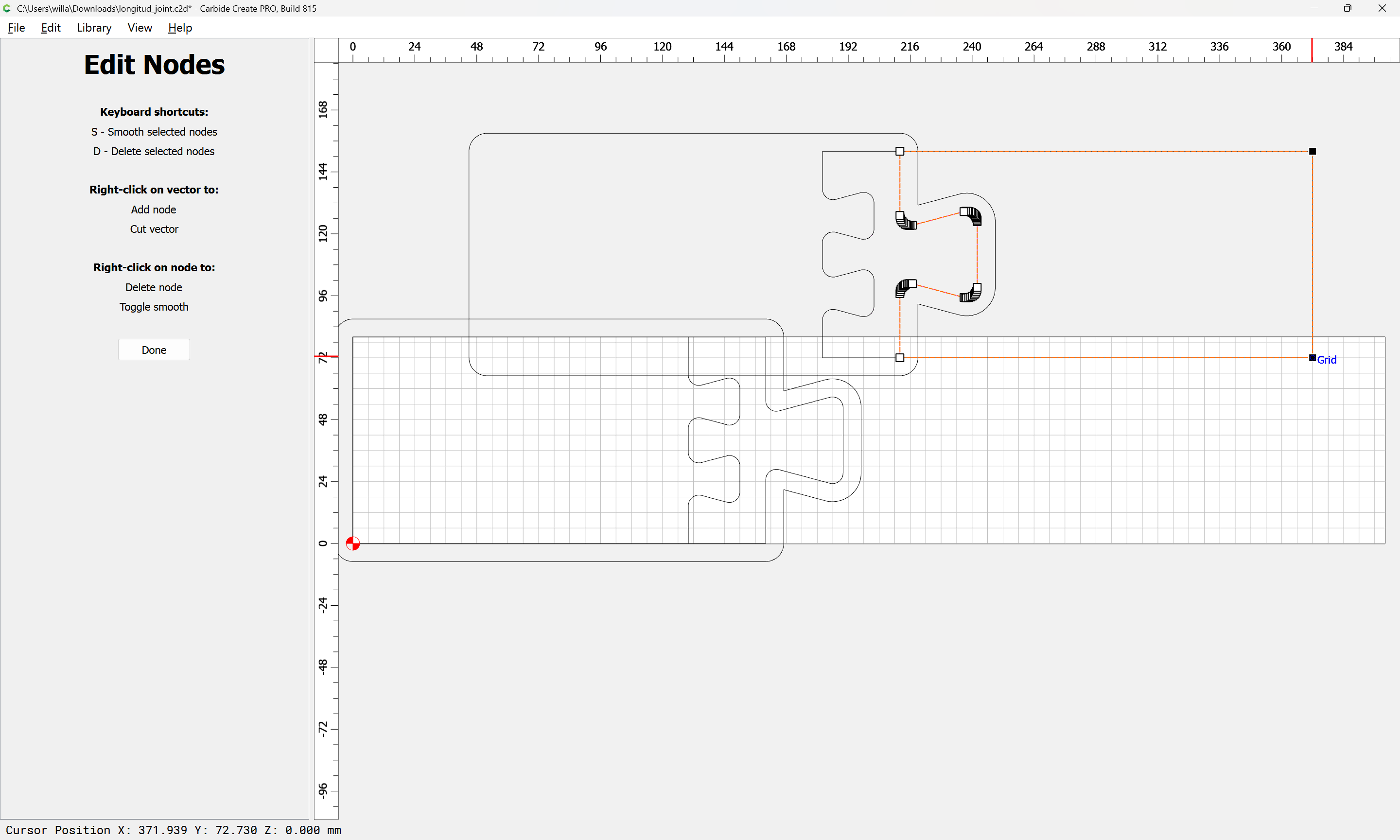

Repeat for the other side, but it’s probably simplest to just copy and then align nodes and drag things around to grid intersection and node edit and re-create the offset and re-assign toolpaths:
to arrive at:
Attached as a v8 file.
longitud_joint_v8.c2d (104 KB)
Wow! Thank you! It looks so easy and logic when you do it. Will take me some days just to comprehend and some more days to understand.

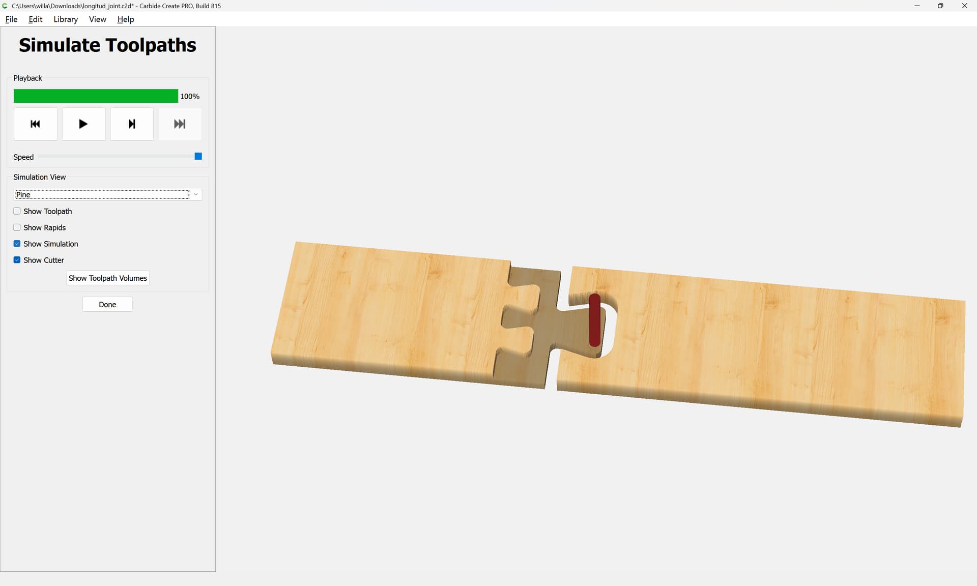

Still Carbide Create has it’s pitholes… however for me with little overview appears to be the best so far. What I missed for a while -the toolpath simulation- is now included. :+1:
