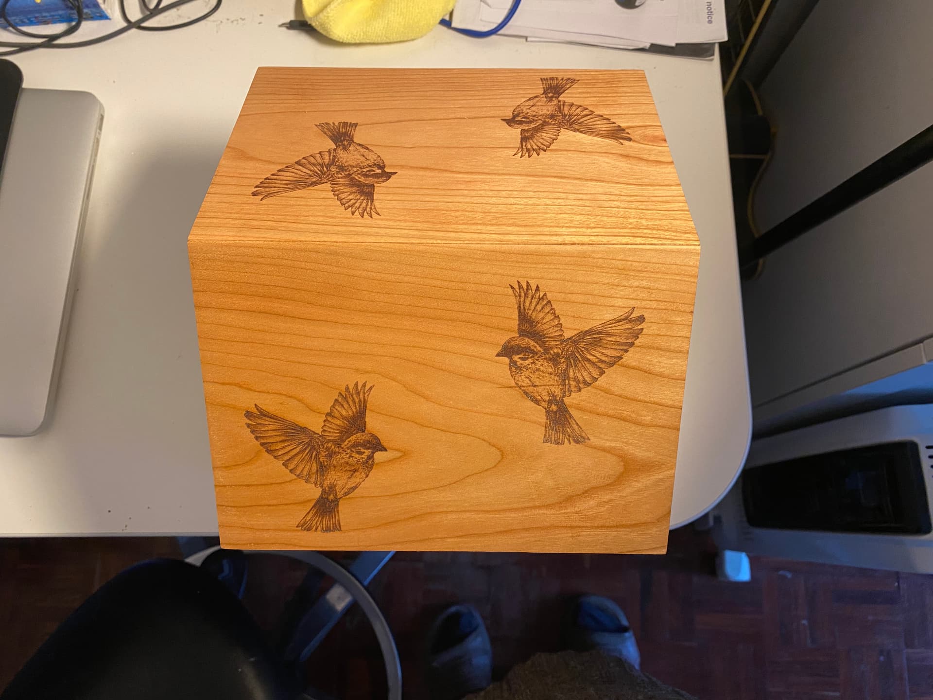

The crucial questions for you will not be resolved until you decide on what you need to engrave, process or image. With my 4.2Watt JTech laser I can manage to cut 3mm plywood with two passes. More power will permit deeper cuts in a single pass. I have attached a few images that show what careful work with a low powered laser will provide. The method to getting good results is to understand the software limitations imposed by the controller and the laser software.

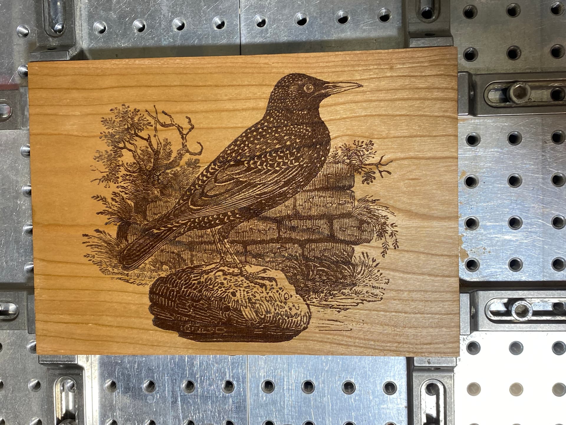

Hey Jeff…not for nothin’ but that’s beautiful stuff :slight_smile: I’d love to pick your brain on your settings to get that kind of resolution from images. My results are mixed.
I appreciate your kind comment, Gary. Picking my brain is a lost cause these days. :joy: How and ever…

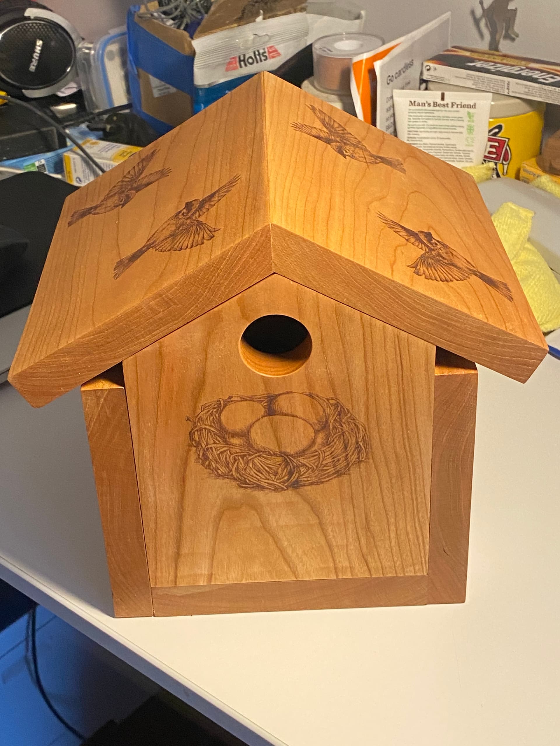

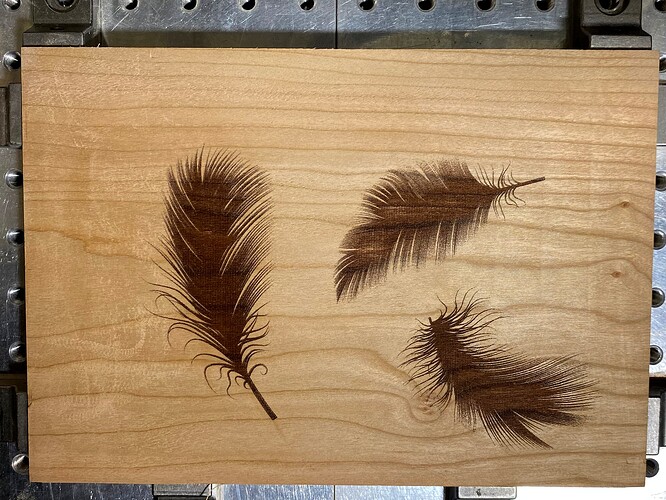

When I first got the laser, I wanted to see where its use boundaries were and I tested a lot of different materials. The one thing I noticed with hard wood is that if the laser beam was held in position for too long, the wood was marked but the edges of the burn were indistinct (not quite as sharp as wood engraved for the perfect time). It may seem like this should be obvious but I was more concerned with speed and contrast of the image. I had fallen into burning with faster speeds and upping the laser power then sanding the surface to remove a lot of the edge charring. The heavily burnt images on wood just did not look very sharp right at the edges. Of course, I was using the laser as if it required maximum power possible for each job.
Better results came when I started to look at delicate detail and how I could hold it in the engraving. You wont be surprised to find that the bird feathers (this was an isolated test engraving that caused me to create the birds nesting box) were carved at 500mm/min and a power setting of 15%. The power was just enough to make a mark on the wood if the laser was not moving too quickly.
If you could look closely at the image of the feathers, you will not see charred edges to the image. That piece of wood has had no sanding but that is just how it came off the laser. This is evidenced by the slight machining marks from inaccurately set tramming and the marks are visible to the right of the feathers and the left of the two knots.
Testing materials is useful when you want to do any particular job and I buy a little more than the job requires so I have some material to test. My initial mistake when I was very inexperienced was to mark the wood deeply and quickly. The feathers had me trying for the point at which I could not mark it with the laser and then I found lowering the traversal speed and upping the power setting until the surface just received and held the mark. I created quite a few patch tests to assess power and traversal speed but they don’t serve every purpose well. The feathers was an image that I had decided needed the lightest of touches. I hope that is useful information.
