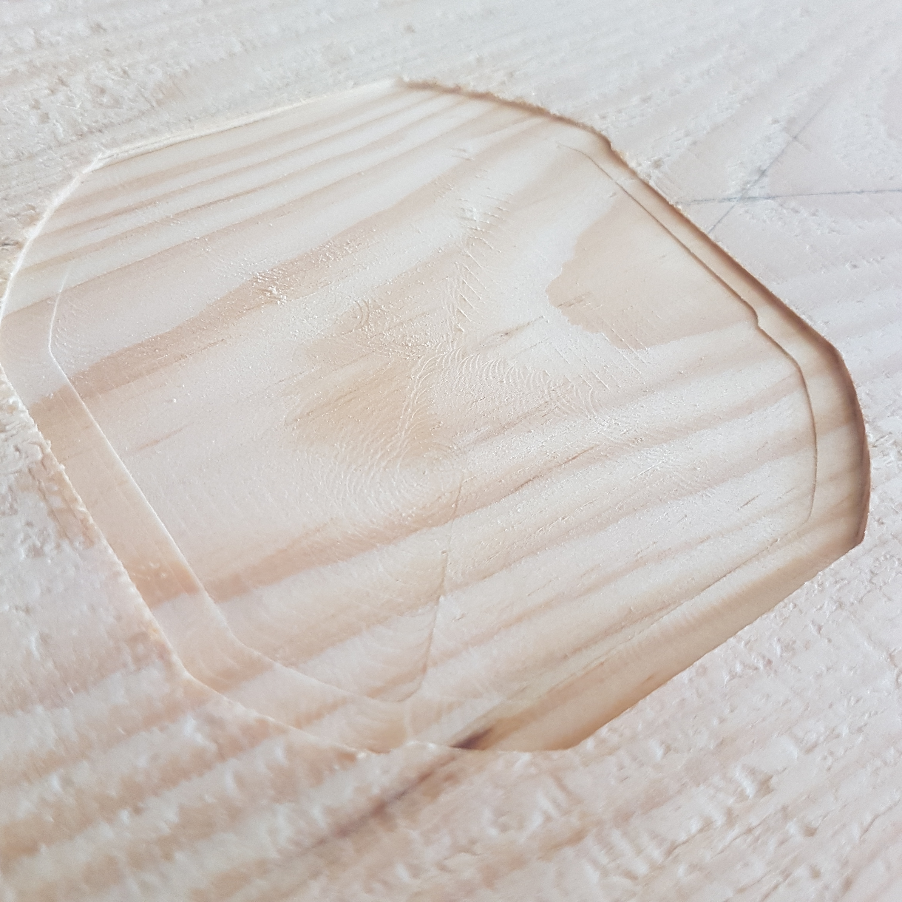

Hey! Just put together my shapeoko and im trying to get all the belts and everything perfect. Right now im running a little job i made up of a coaster to see if things needed tweaks. It seems like in the bottom left and top right of the coaster, as its pocketing down, it shifts about 1/16" So i know something isnt quite right. I did a walk around and it looks like one of the x rail wheels isnt making a connection with the y1 rail. Its the wheel right on the other side of the black plate. It rides along the top of the y1 rail and its right on the opposite side of the stepper motor. It doesnt have an eccentric nut (the wheels on the underside do) so im not sure what i need to do to fix it. Id assume that means the eccentric nut needs to be tightened on the bottom to bring the whole thing tighter around the y1 rail. Heres some pics of the issue and a pic of the wheel that isnt spinning! Think that one wheel is the guy causing thst issue?
If you loosen off (just enough) the four bolts holding the X rail to Y plate at each end of the X rail then you should be able to get the four upper V wheels to all sit flat together.

They are, and theres no gaps anywhere. I made a coaster and it worked perfectly. But then i tried to make the inlay from the file for the carbide corner square. It dug a hole too deep so the corner square os flush with the wasteboard. I can just toss some washers in there but something might be up. Also, when it went to cut the holes for the threaded nuts, it cut them a half inch high on the z axis. So it just cut air, it cut not nearly deep enough. But it cut the shape out too deep. Weird. Then i tried sticking a 1/16" bit in there to try something else (i bought some cheaper bits to learn on). I set a toolpath to do .5mm per pass and it stuck into the wood and instantly snapped off. I took the broken piece and measured the hole it made and it was approximately 7mm deep. No kidding it snapped lmao. So either somethings up with my machine or im truly misunderstanding things. Odd part is the coaster cut out absolutely perfectly.

I did get in touch, they recommended I try adding an additional wasteboard because maybe my Z axis was bottoming out and losing track of where the zero was. I don’t know how low it can go before it loses track though. When jogging and finding zero, does the Z value need to stay positive? Because right now with the added wasteboard, if I lower my bit to the wasteboard the value for Z is -0.6

Okay so I just stuck a wasteboard on top of the base one. It’s only 3/4" but I think that might be enough.
I stuck a test piece of wood on top of that wasteboard and ran the carbide corner square test on it. It worked good.
Then I took that piece off, lowered the zero down to my new wasteboard and tried to run it again. The router went over to the right spot but tried to cut way too high, so it was cutting air. (it was cutting around 0 z height on Carbide Motion) I’m assuming this means I need to put a third board on top? The weird part is that when I did the test piece on top of the wasteboard, it routed out the screw holes in it and it dropped below z 0 to make those, but now it won’t go below z 0 for this part. And before I put the wasteboard on, I cut out some coasters just fine and those must have been way below z 0.

As for the co-ordinates. When the machine initialises it homes top back right and that becomes the machine zero, it now knows where it has stepped to from the point where it triggered the home switches.
You then have the workpiece co-ordinates where you jog the machine around or use the probe to set your working co-ordinates which is what CC shows you as X, Y, Z. The machine remembers the difference between that (0, 0, 0) and it’s internal (0, 0, 0).
The reason for all that was that, yes, your working position can easily be negative in all three without causing an issue;
There’s mine just forward, left and down from the rapid “Center” position where I said “Set Zero”.
What causes an issue is if you move outside of the physical range the machine can move to, the motors will try to turn, make a nasty cogging grinding sound because they can’t step and the machine will lose it’s place because it believes that it has moved but the motors couldn’t.

Let me know if this is an operator error. I open Carbide motion, initialize machine, then I load up a file. I click jog and jog the machine over to the zero point in carbide create. (In this case, it’s the bottom left of the carbide square wasteboard cutout)
I jog down the Z axis and have it sit jusssst above the material (material is the wasteboard here)
Now the bit is touching the material and its right where I want the job to begin. I click Zero all and all the numbers set to 0. I click start job, it goes to the middle front, asks me to put in the bit (its already in), I click resume, it auomatically goes over and taps the bitsetter, comes back, asks me to turn on the spindle, i do, and i hit ok, and it goes.

To check if you’ve exceeded the travel range you can go back to zero and visually inspect to see if your co-ordinate zero is still where you set it;
  • jog the Z height up so your bit will clear whatever is on the machine
  • go to jog / rapid position / rapid to current XY
  • set your step to 1mm and jog Z down until it is at the zero point you set
  • read what CC now says your Z height is
If your Z is now negative with the bit in the same position you set “Zero All” in then either bitsetter got it’s offsets confused or you ran out of Z travel. I would expect you to hear and notice the nasty grinding missed steps noise though.
I’m just getting used to all the steps so I assume I was doing something wrong because I just followed the steps I wrote out myself and set the job and it just routed out the carbide square slot perfectly. There’s a good chance I put the bit at the right height, then forgot to hit set zero! Lol.
