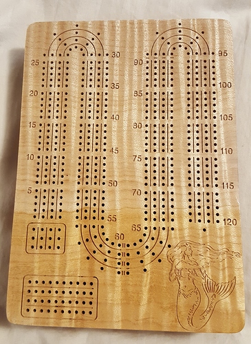

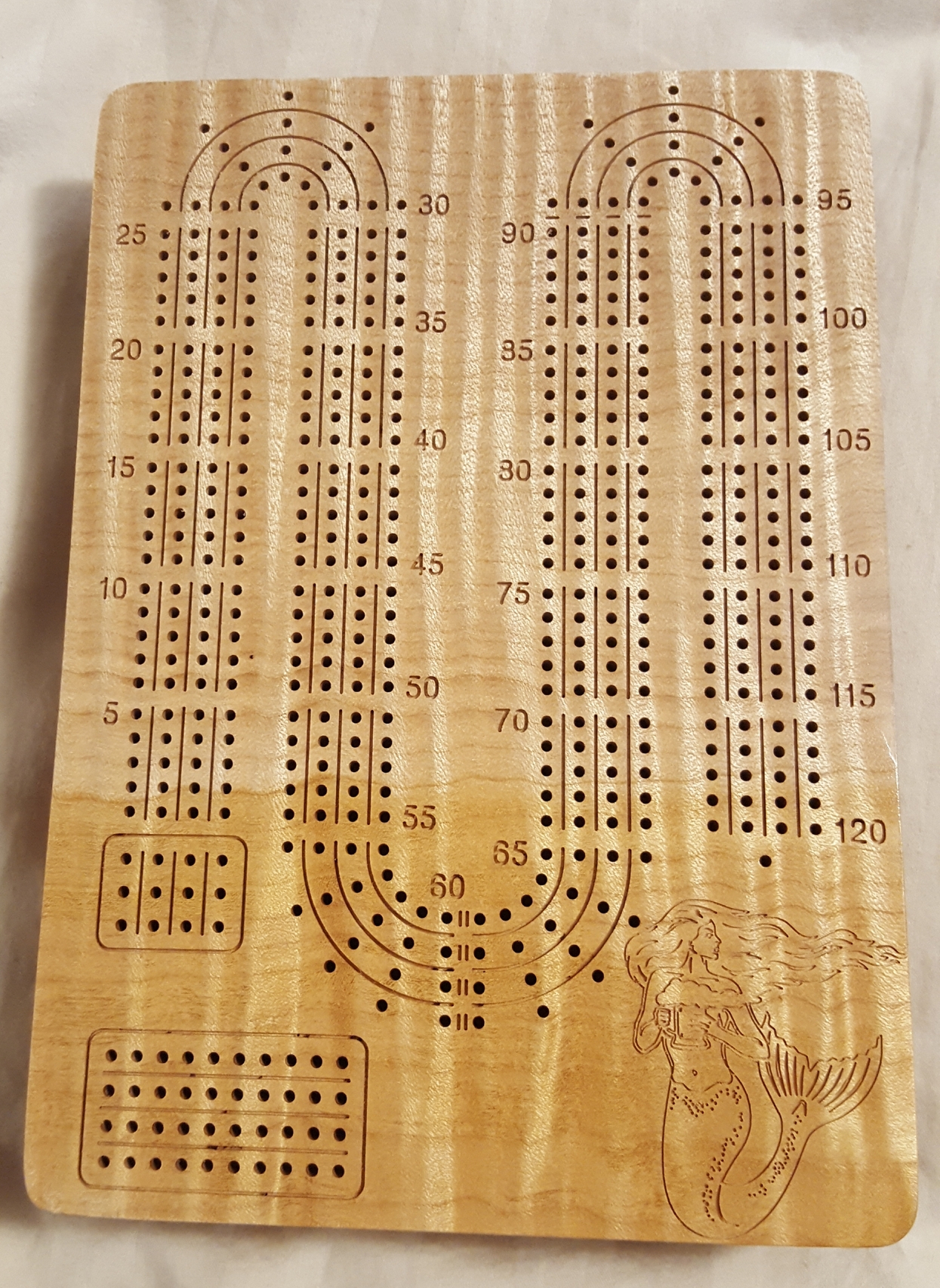

I use bits down to 0.0090" in hardwoods at 20 to 30 IPM feed and 15-20 IPM plunge speeds and 22-24,000 RPM.
Here is a video of me cutting a mermaid in a curly maple cribbage board with a 0.0120" 2 flute end mill. For your ears’ sake , just turn off the volume. I believe it was at 20 IPM feed and 15 IPM plunge at ~24,000 RPM
EDIT: It was an 0.0100" bit, and here’s the finished mermaid.
