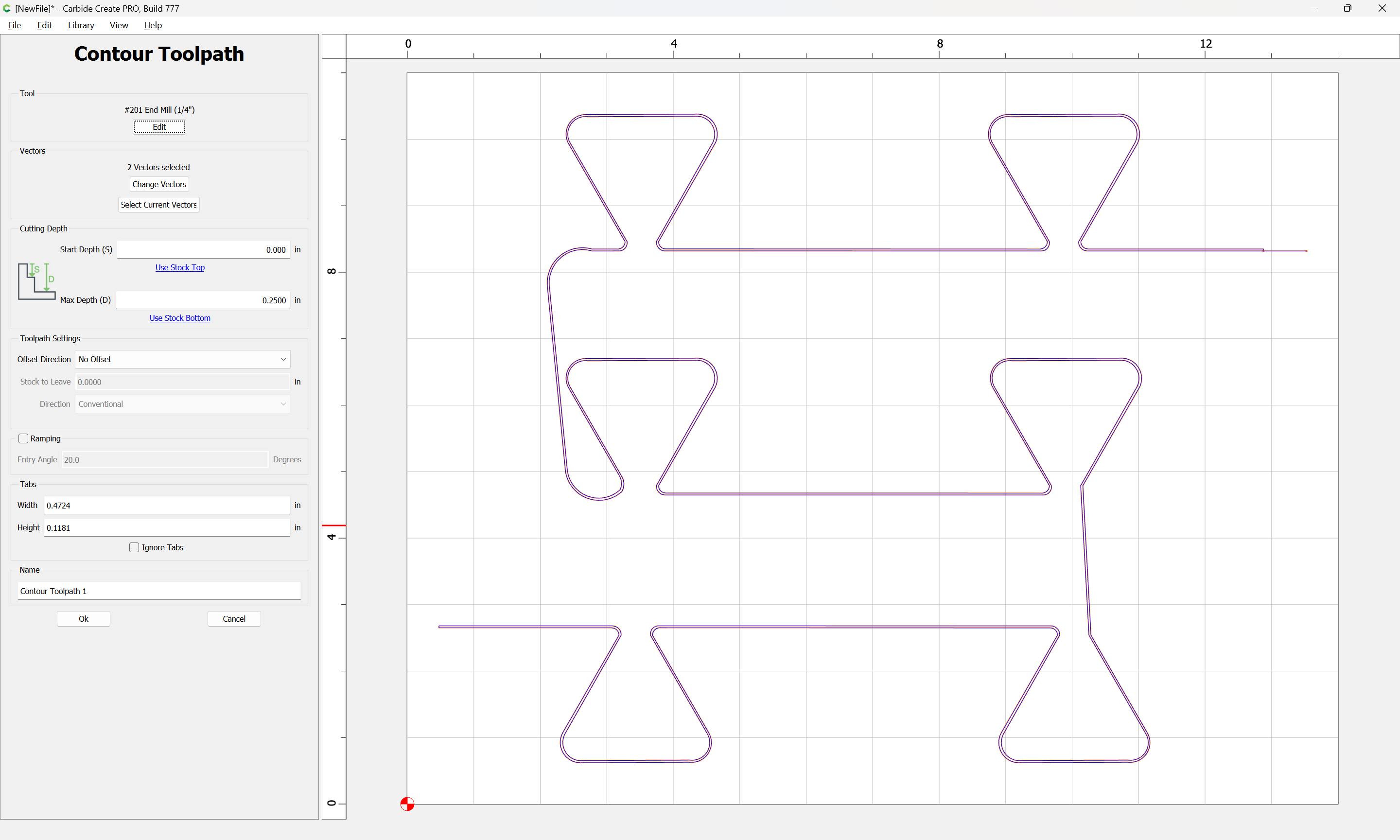

Hello,
I am trying to create a toolpath for this design and i keep getting an empty toolpath, I have tried every suggestion i could find online but am still struggling. Any suggestions would be amazing!
Try 100

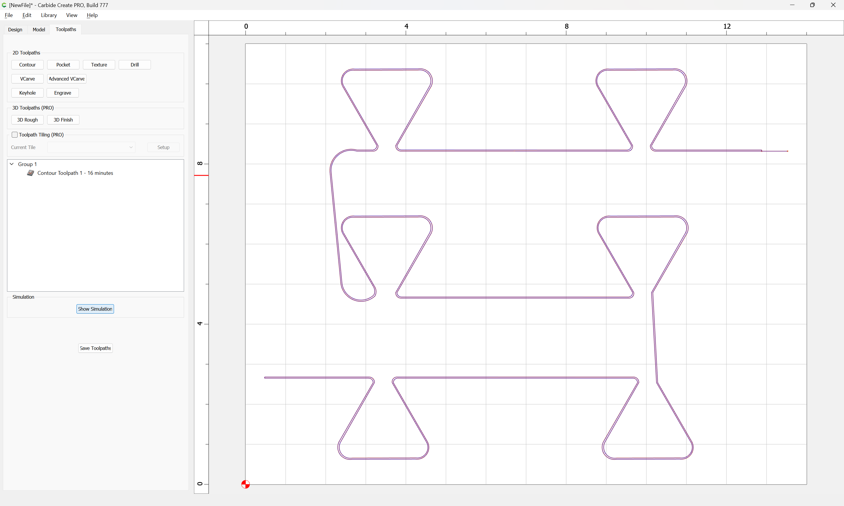

This geometry is open:
(indicated by being magenta)

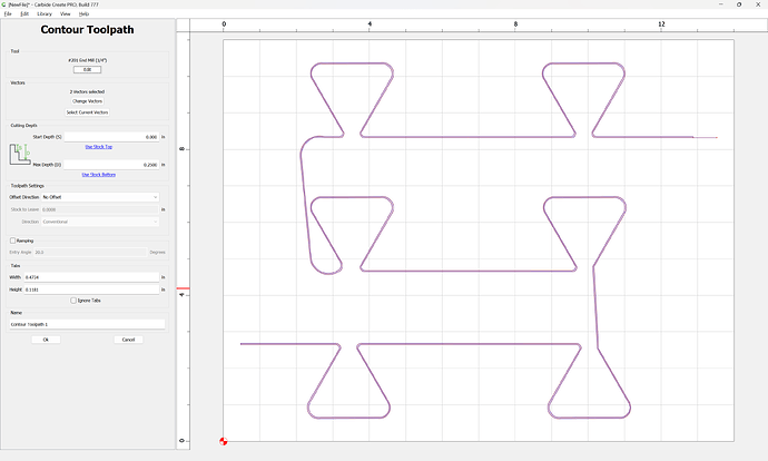

Have you tried a “No Offset” Contour toolpath?
Attached as a v7 file.
no_offset_contour_v7.c2d (1020 KB)

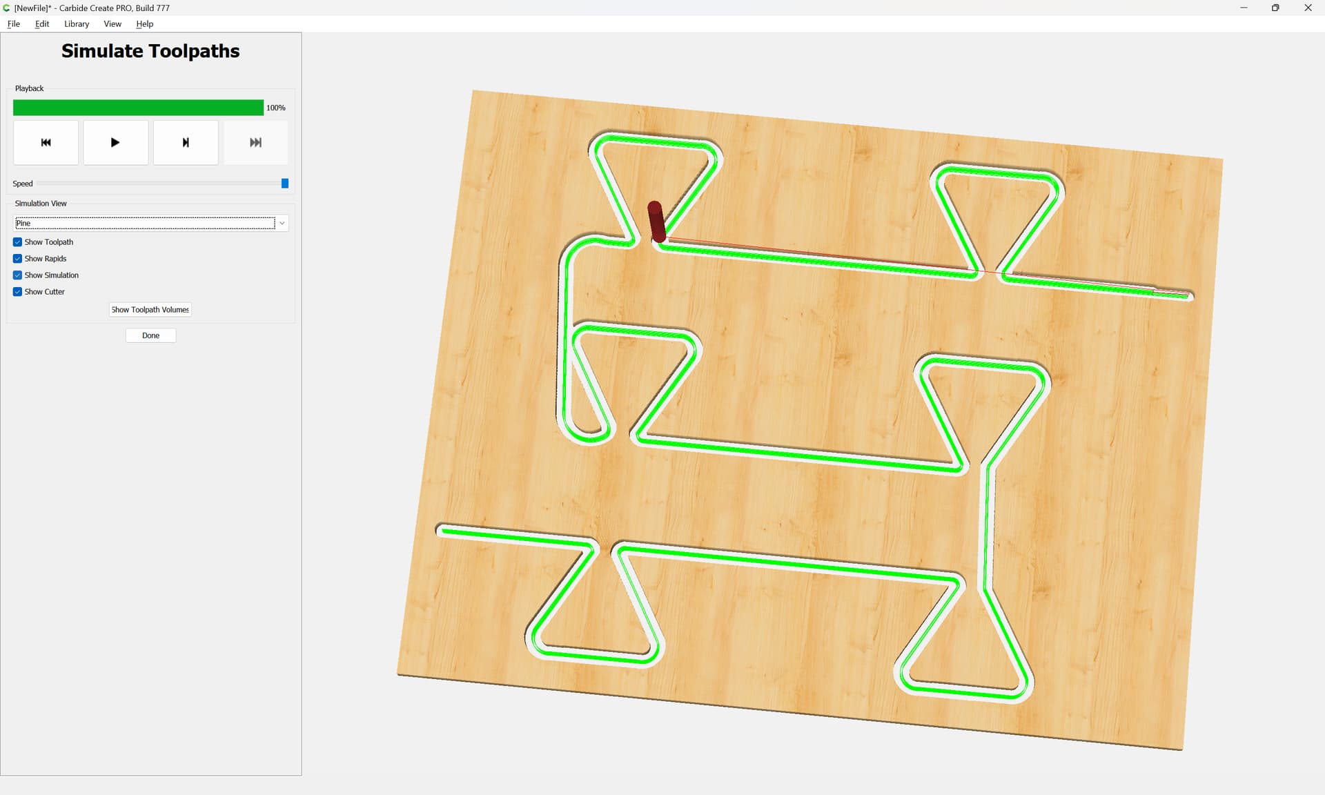

Thank you any advice why mymachine keeps saying Project will hit the right of the machine? It only lets me zero to the left and not the right?
This is a warning, see:
If you still have difficulties, let us know step-by-step how you are securing your stock and setting zero relative to it and managing all tool changes and send us a photo showing the machine at the origin relative to the stock (or a specified offset from that position) and the .c2d file.
