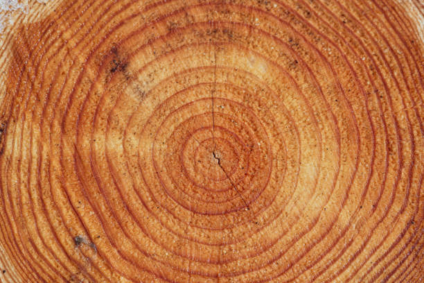

Here is a picture of a pine log. You can see the wide lighter color rings and the darker smaller rings. So during the growing season the wood grows fast and is soft. During the winter the tree still grows but very slowly so the dark rings are harder.
pine_rinmgs
You can see that the rings at the center are wider and as the rings go out they get thinner. The tree grows very fast in early life. However the out rings are thinner but bigger so they get smaller. The pine trees grow at about the same rate each year but because the rings bet bigger you see they get smaller but if you add up the volume of each ring they are close to the same. So depending where your board is cut out of the tree you can get harder pine on the outside of a flat sawn board and much softer when cut out of the center. It is a crap shoot when you get a pine board but when ever possible look for rift sawn boards because they will be more stable than the flat sawn boards from the outer edges of the tree. The out areas tend to cup and warp more. Rift sawn means the grain in the end of a board is from 45-90 degrees to the face grain of the board.
