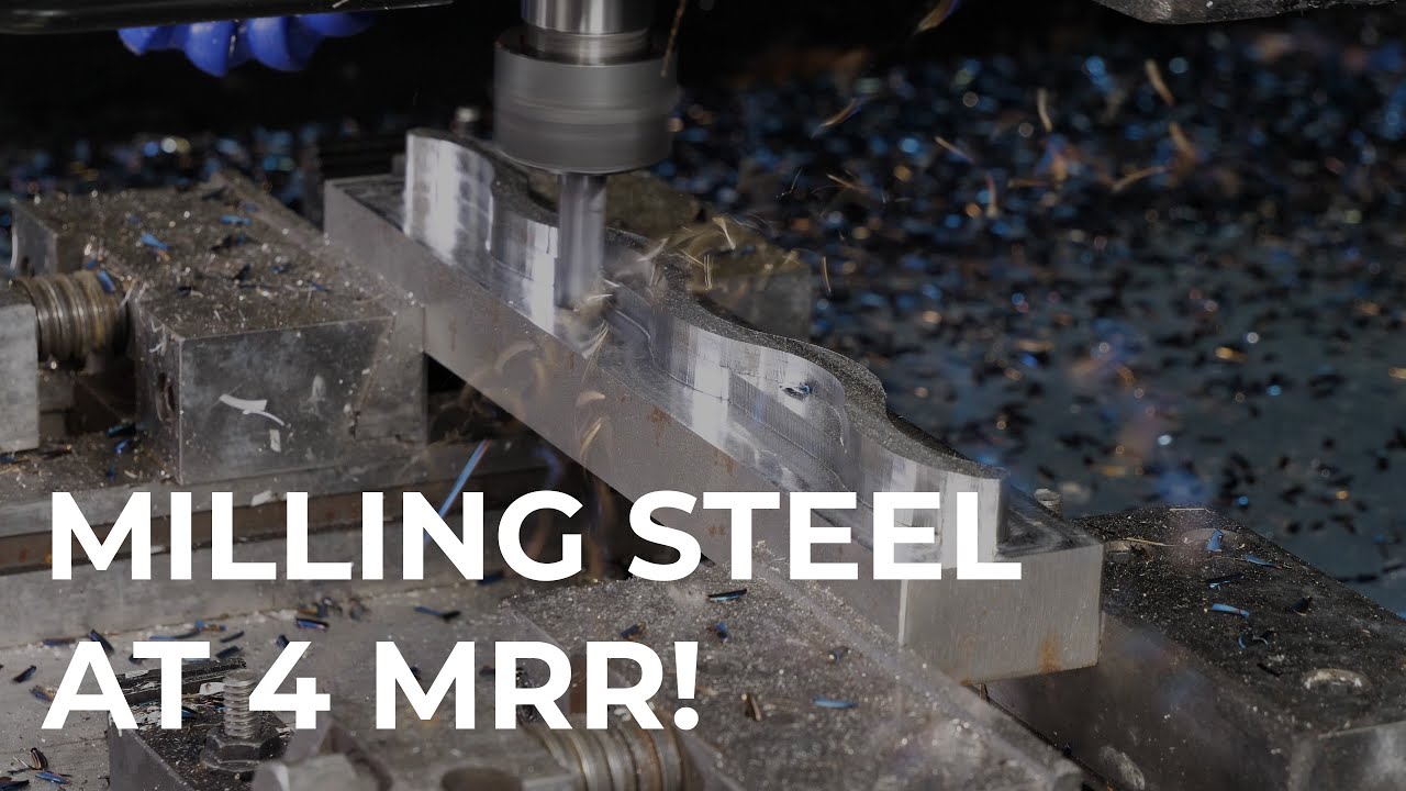

For steel…it seems ok. Videos and surface finish indicate chatter.

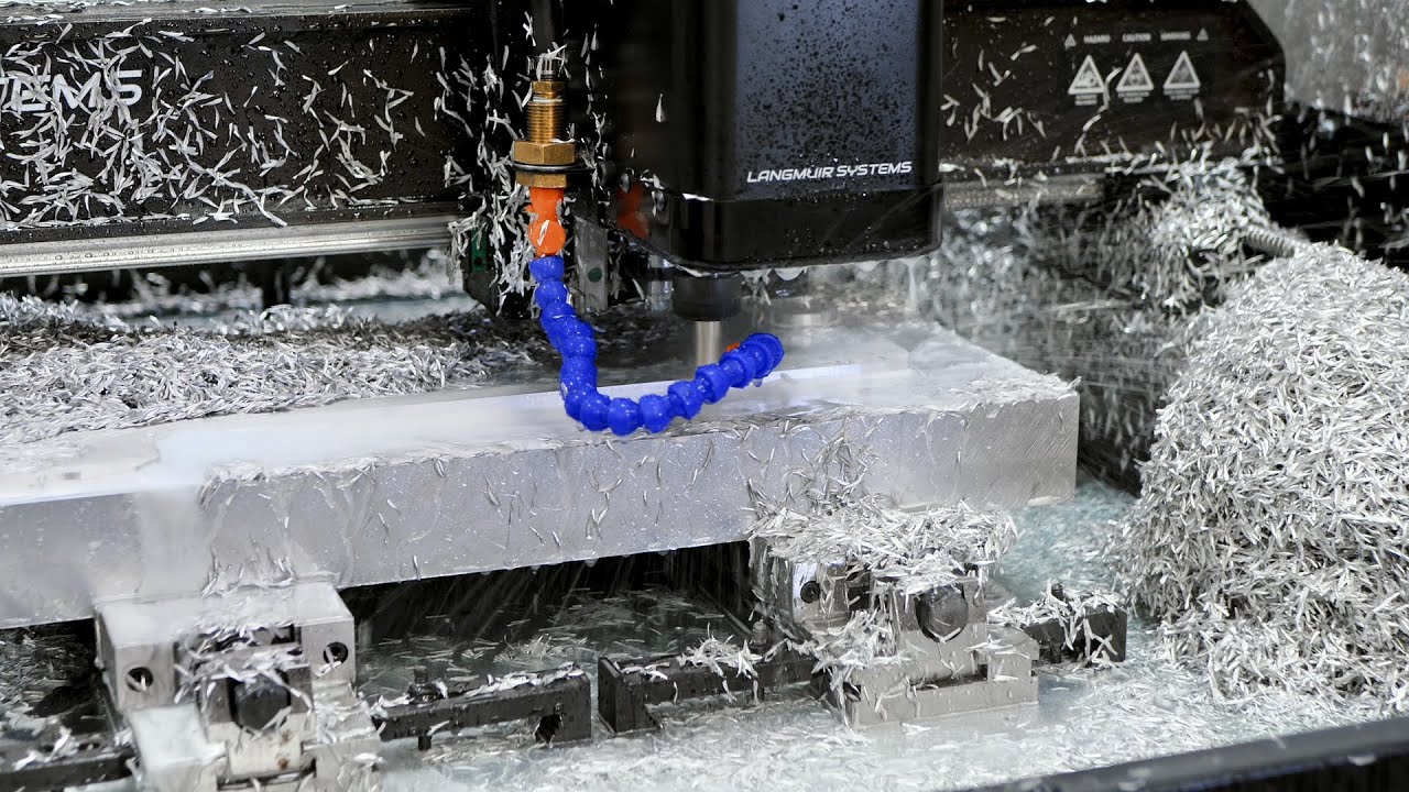

For aluminum, especially with small details or tools, it’s gonna be slow. 100ipm max and 8krpm.
I noticed the chatter marks. I think Youtube’s compression hides it pretty well.

am i crazy or is this making cuts that i don’t think a Tormach can even make? on their youtube channel I saw 6 mrr machining aluminum and 2 mrr in steel which seems like big numbers for a machine like this. the limited z envelope makes this machine too limited for me (i’d rather have a Grizzly G0704 conversion), but you cant deny the cuts this thing is making. also i’m seeing pretty decent surface finishes on these parts…certainly good enough for a garage mill i’d say. i also think the price point is a little bit of a gotcha. sure the machine starts at 3995 but to really be ready to cut you’re probably closer to 6k.

Didn’t seem like the videos were really showing off finishing but more on maxing throughput/roughing - to point to being questionably a bit too much ![]()

Tormach spindles top out at 1.5kW, while this machine has a 2.5kW variant. I’m guessing that’s what they’re using to show off MRR, as MRR is proportional to spindle power.
However there’s a gotcha there: Tormach only makes 110V machines, while the 2.5kW variant of this machine requires 220V AC. The machine also comes in a 110V variant which is limited to 1.5kW just like a Tormach.
