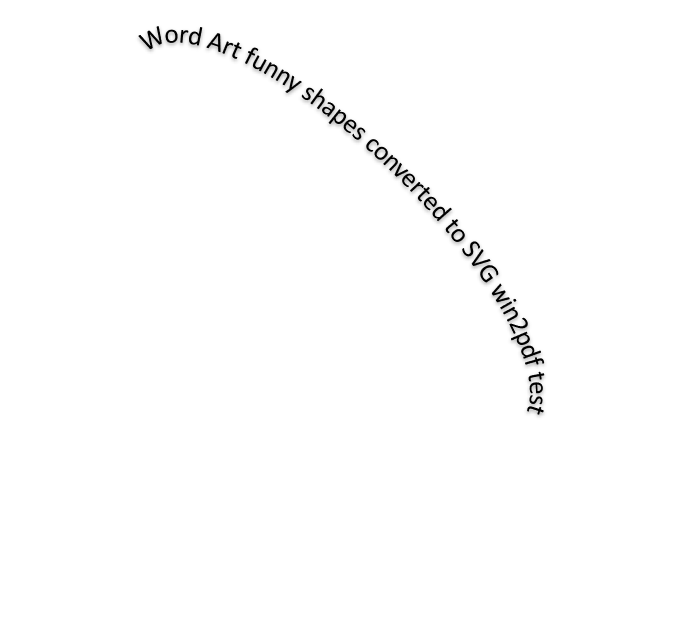

Additionally, you can suggest that your associate use How to create a SVG file using Win2PDF in Windows 10
They should be able to install this on their PC. They can use their word processor to type up their engraving and use Win2PDF to print directly to an SVG format, which can be imported into CC.
It’s not perfect, but it should do the trick.
test file for win2pdf graphic
