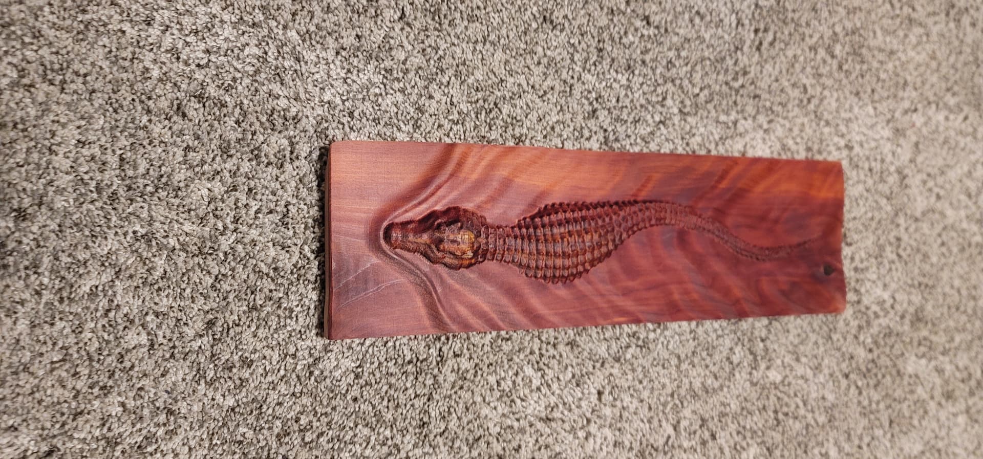

This is the project. I ran a scaled down test to see how it did.
S&F and DOC… if i remeber correctly, DOC is .250", I’ll have to check when i go out to the shop tomorrow for feed rate.

Thank you! I haven’t found this video. It’s actually a very similar project. I want to do an alligator table.

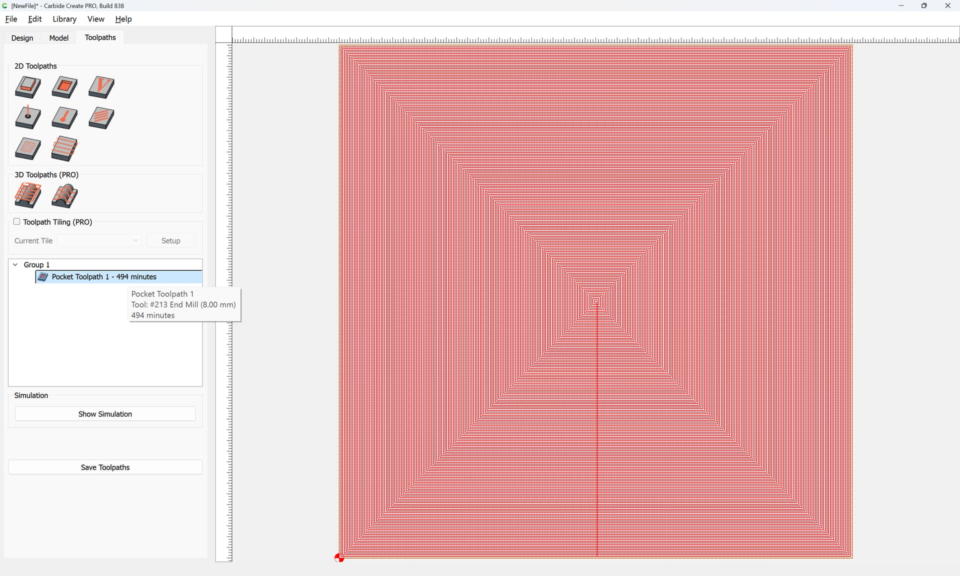

Feeds and Speeds. I take the depth I want to go and do some serious math to calculate the number of passes I want to make. You could make multiple jobs for each pass. Key is you can’t remove your piece from the working surface, I almost never use the default settings. And I do the same thing gdon_2003 does above.
Just using some quick estimation, Opie’s (Kevin’s) job ran about 18 hours, and it’s about 4x bigger than yours. Using his parameters & tooling, you should be able to cut yours in about 4.5 hours.
Total time = Distance / Feedrate
Distance for a given volume is affected by DOC, Stepover, and non-cut motion (Rapids, retracts, ramping)
A good rule of thumb for 3D is to use the largest diameter ball mill you need to get the detail you want. Find the smallest detail (concave area) on the model & use a tool that just fits.
Another one is, don’t use 3D to cut 2D (flat, prismatic) shapes. Use boundaries to limit your 3D toolpath to the area that needs 3D.
If you want to share the .c2d file, and tool parameters for any custom tools, I bet we can get your time down to something reasonable.
