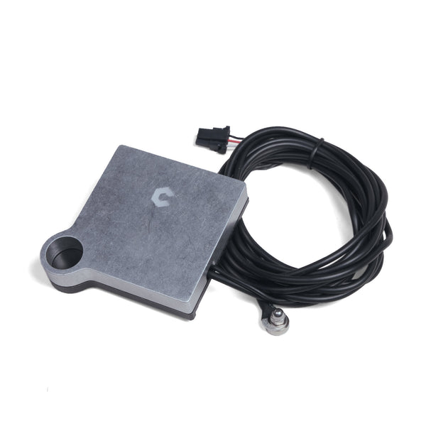

(But honestly…just get some kind of bitsetter like @Woodcrafter mentioned. Quickest and easiest way to save time and avoid silly mistakes while you learn the ropes :yum:)

I have a large L bracket on my spoilboard. I use that about 90% of the time. Once you set your X Y and Z zeros they are remembered over power cycles. The X and Y are always remembered but the Z is remembered after the router/spindle goes to the BitSetter. That was a change made a couple of versions back. Although remembered it has to have its memory jogged to remember the Z.
