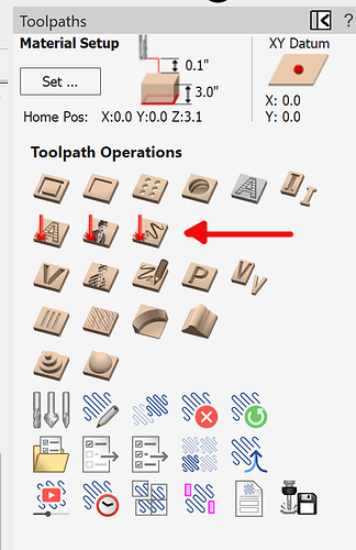

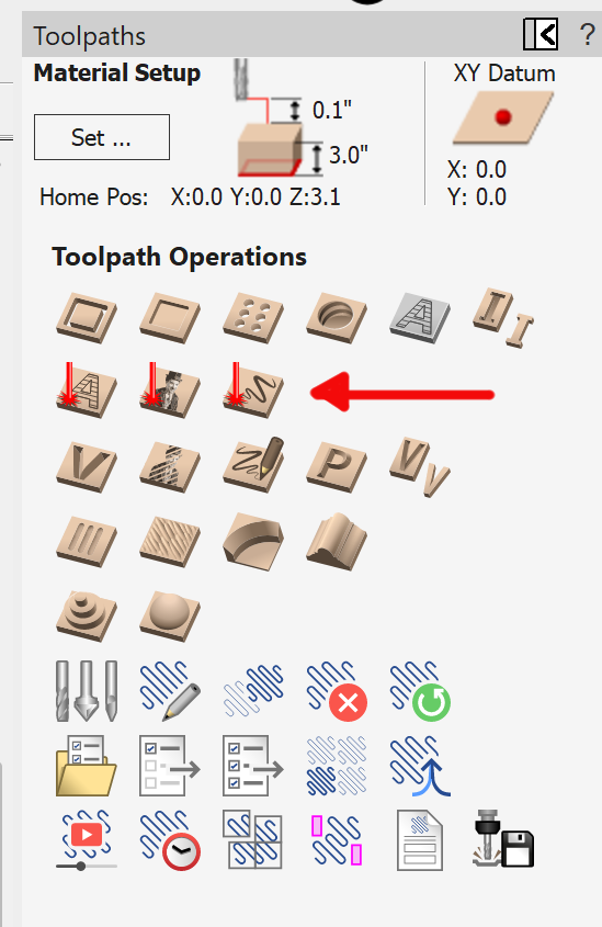

Vectric has had a laser function for years. It costs about $50 as an add-on. I don’t use mine very often but I have…and it works. No Z movement, the power and speed of the laser is supposedly variable in a hybrid 3d relief job.

Yeah I was thinking about how the vectric add on might work with no z movement. Seems like it’s most likely for flat engraving and photo stuffs.
I have the Vectric add on and I haven’t seen where changing speeds and power work all that well for a height map project. That being said I haven’t messed around with it very much. I keep an eye on the Vectric forums and haven’t seen any talk regarding it there either. I also have Lightburn that might be able to adjust the Z. But I haven’t really tried it.
