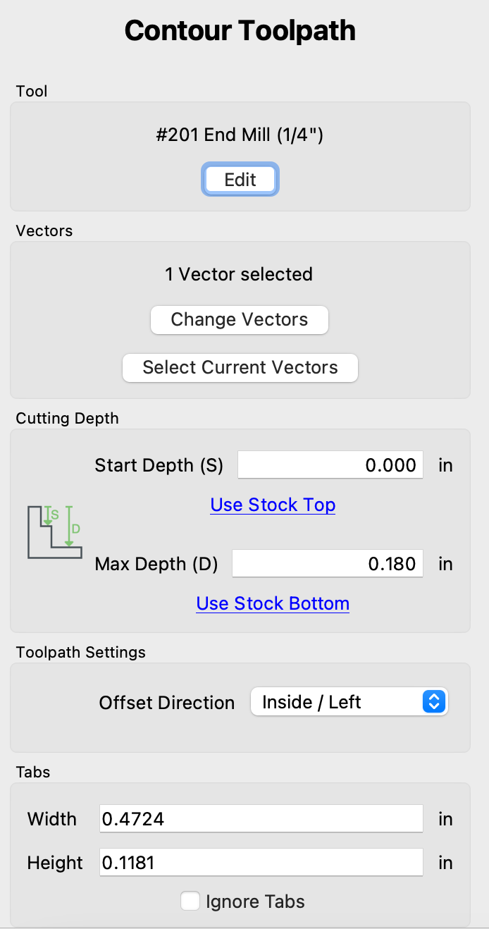

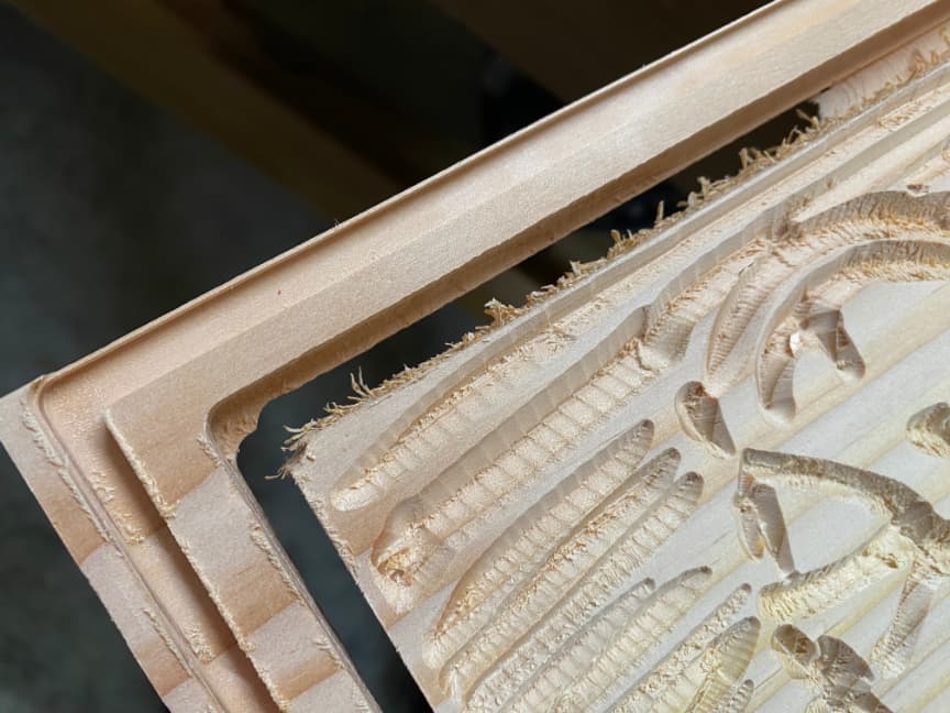

Hi Guys.
Was practicing a shop sign on an old piece of scrap pine. 98% of job went fine. On the last border cut the router descended so far it went into my waste board and almost got the aluminum rails. Any ideas? The board was 0.68 inches deep and the last cut was only set to 0.18 inches deep. Insites? I’m new at this so not sure what the heck went wrong.

Were you cutting a slot just as narrow as the tool? Where possible, avoid that — cut as a pocket down to tab height or the penultimate pass.
Yes, I was just cutting a slot equal to the width of the cutter. Avoid that? I will cut as a pocket. Thanks!

It’s possible the high engagement pulled the bit downward from the collet. The machine didn’t cut too deep, the bit got longer.
Mmm… Very interesting. I’ve been using just the locking button on the router to tighten the bit. Maybe I need to use both wrenches instead to really make sure to bit is locked in. Thanks.

I have an SO3 with HDZ and the Dewalt 611 Router. Today I was cutting a pocket that was 8.5" x11" and .125" deep. I was sitting in front of the machine and looking at my phone. I heard the router start making a loud noise. I stopped the job and instead of cutting a doc of of 0.040" the cut was about a 1/4" deep. I always look at my bit when inserted into the collet and had just cleaned the router shaft and router collet with brake cleaner. The bit was a #251 1/4" down cut bit. The bit had come loose and dropped down. Luckily the deep pass was in the middle of the pocket and will covered over with a 1/8" piece of baltic birch that has been lasered. So no loss. I took the collet off and replaced it with a spare one I had. So after that I paused every 10 minutes to check the tightness of the collet and it never came loose. So I suspect I have a bad 1/4" collet. I put it in a plastic bag and marked it BAD?.
