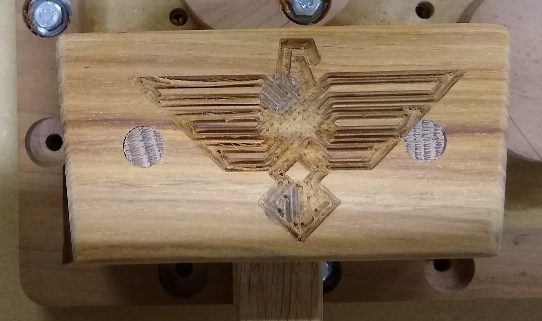

Almost forgot before the finishing I will vcarve this design on the mallet. The mallet reminds me of Thor’s hammer slightly so I found this Viking style Thunderbird. My username is gdon_2003 in reference to my 2003 Thunderbird. I plan on using a 15 degree vee bit. I tried a 60 degree but the simulation was so light that it was not worth doing. The 15 degree looked good and I will paint it with acrylic paint before the Watco.
My vcarve did not turn out too well. The drawing was just too busy. The simulation looked great but in practice it had broken lines. So I went back to the CC file and did an offset on the outside and then removed some of the inside lines of the drawing (svg). Then performed the offset to the inside and that simplified the drawing. I then did an advanced vcarve with a #102 and the 60 Degree Downcut Groovee Jenny. It came out pretty good considering it was a salvage. I mixed up the MAS Table Top Epoxy with Transtint Red dye. I filled the first side and let it set and then flipped the mallet and filled the second side.
The image was just too complicated and had tear out and was just not suitable for this wood. Live and Learn.

I got my mallet all sanded and cleaned up. I got a single coat of Watco Danish Natural Oil on it. I will let it dry overnight and apply a second coat. The Thunderbird came out ok but not what I thought I was going to get. I was able to salvage a bad situation and that is what is important. I think I made the red epoxy a little too dark. I wanted an opaque color but it again is not what I expected. I should have made the epoxy more translucent with a red tint. Overall I am happy and think it turned out good. Now on to whacking things with it. Bonk Bonk on the head.
