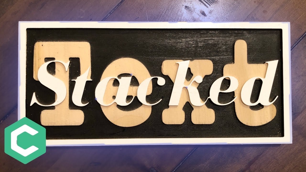

Thought I’de try out my first Layered Text Sign as a mothers day present.
Pretty happy with the results but next time I will cut a little deeper and see if
I can make the letters stand out more.
Maybe see if i can figure out how to paint the text layers different colors.
Used a small piece of Mahogany I had laying around.

so you can get the top layer to be a different color very easily by painting the stock before you start cutting… no precision required :slight_smile:
You can also take a small thin tip brush and brush on some White Stain to the MOM.
And/or you can sand off the stain from the top layer.

Nice. I did a video a while back to try and simplify it.
When I’m positioning i always use Align to Center. First on the Lower Text. Then on the Upper text. That way when i over lay the top text with the Bolean Union top and bottom text it ends up in exactly the right position and i dont have to worry about entering X and Y axis location.
… and another thing! :smiley: Always make the top text about 1/3 or less the height of the bottom text.
The finished sign is much more readable.

Here’s what i did
  1. Did the outline box and the bottom text. Set box and bottom text to center of project
  2. Did the top text and set to center of project.
    3 Made a copy of top text and moved off grid
    4 Group bottom and top text and merge
    5 Selected merge text and create pocket cut toolpath inside of box
  3. Move top text that i had outside of grid back to center of project
  4. This should align perfectly with bottom and top merge text
  5. Select top text and box and create pocket cut
  6. When creating tool paths i have bottom cut set to twice the depth of the top text cut
    10 Run file
