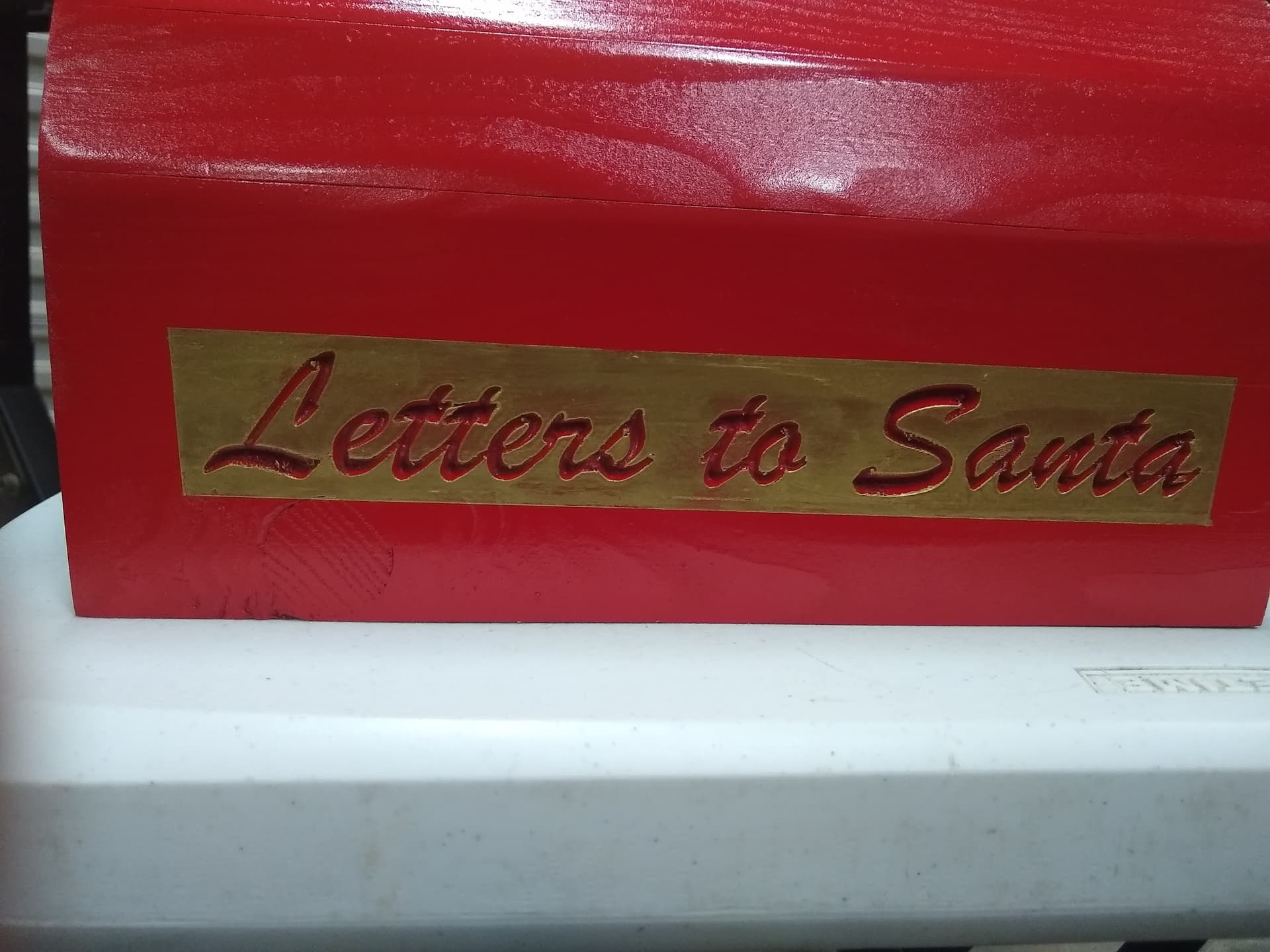

As @mhotchin suggested the GrooVee Jenny bits work extremely well. I did a Santa’s Mailbox a few years ago in pine which is terrible for carving with a GrooVee Jenny 60 degree bit and it was almost perfect.
This was a plaque for our WWCETX 2x4 Contest and was made from 2x4’s which are very soft and prone to chip out.
