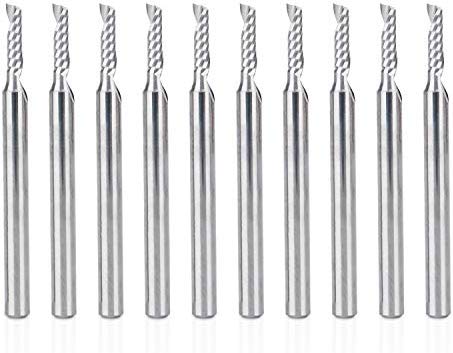

I bought these (2mm dia, 1/8 shank, single flute upcut):
… to make my first wooden thing - a sign for a Christmas gift. I masked the top with Oracal and the upcut flute pulled up the Oracal, making it useless. I’m now looking for some inexpensive single flute downcut bits in about the same cut diameter. Does anybody have any suggestions on where to buy?

https://smile.amazon.com/gp/product/B073TXC45Z is great for finer detail; same manufacturer also has the slightly bigger 1/8th in downcut
Amazon wins. Just ordered - thank you!
fwiw I use a feed rate of 20 to 25 ipm, doc of 0.045 and since it’s a metric bit… 0.078 bit size…
