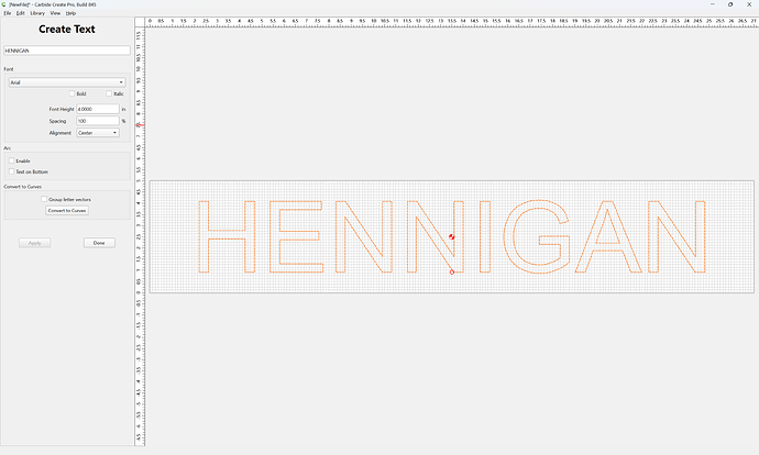

I have been asked to carve the name HENNIGAN in block letters NOT cursive on a 2x8x4 pine board that is one of the back boards of a bench I’m building. I have the 4x4 Shaepoko 5 Pro so working size is no issue. The actual text will probably only be like 3” or 4” tall by 24” long and only about .05 deep. I am going to cut it after I have stained said board so the raw pine underneath pops. Then I will seal the whole thing with polyurethane. My question is can that be done with just an 1/8 flat bottom end mill as just text in carbide create or does it have to be done in v carve no matter the bit. Or do I need to do a flat bottom and then a 60 degree bit the v carve way

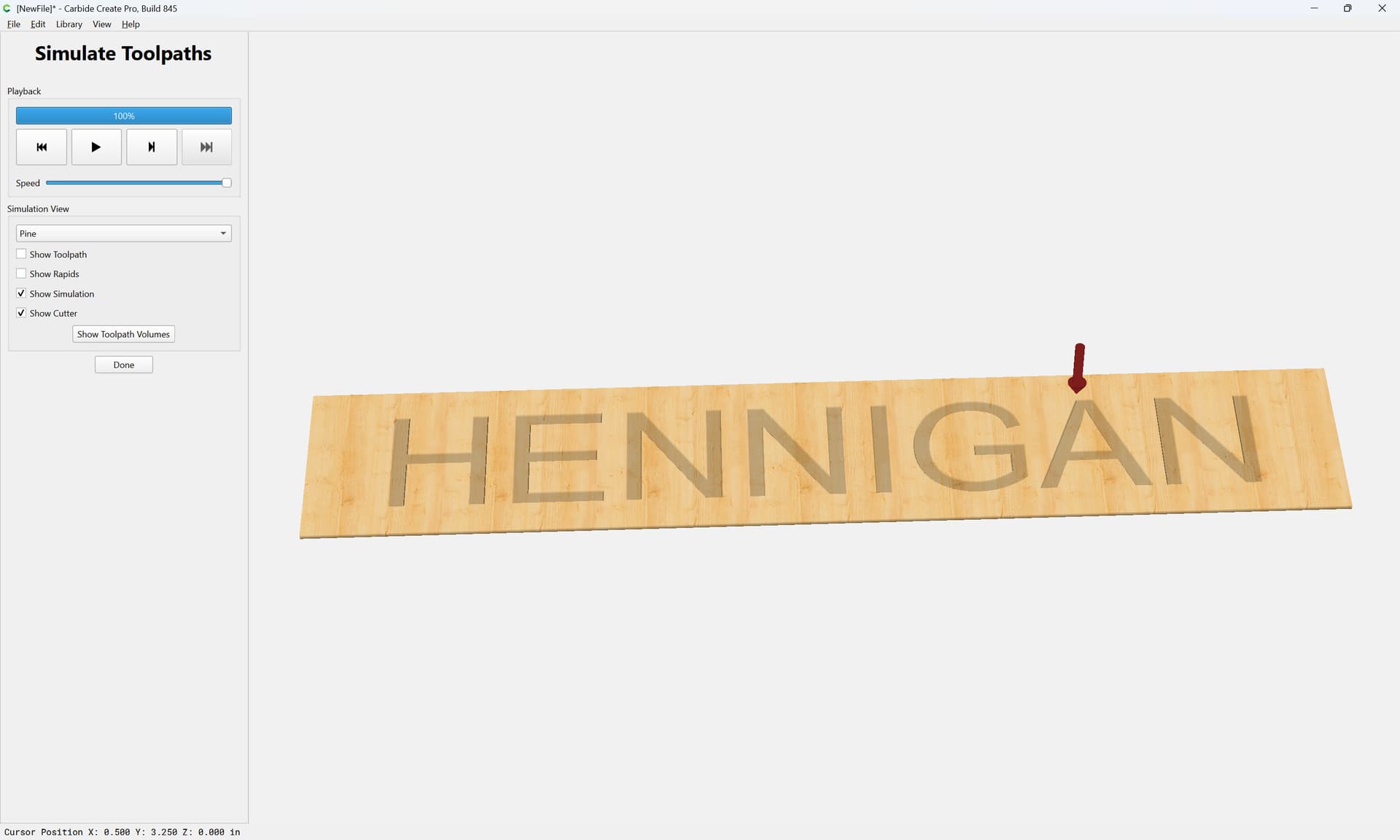

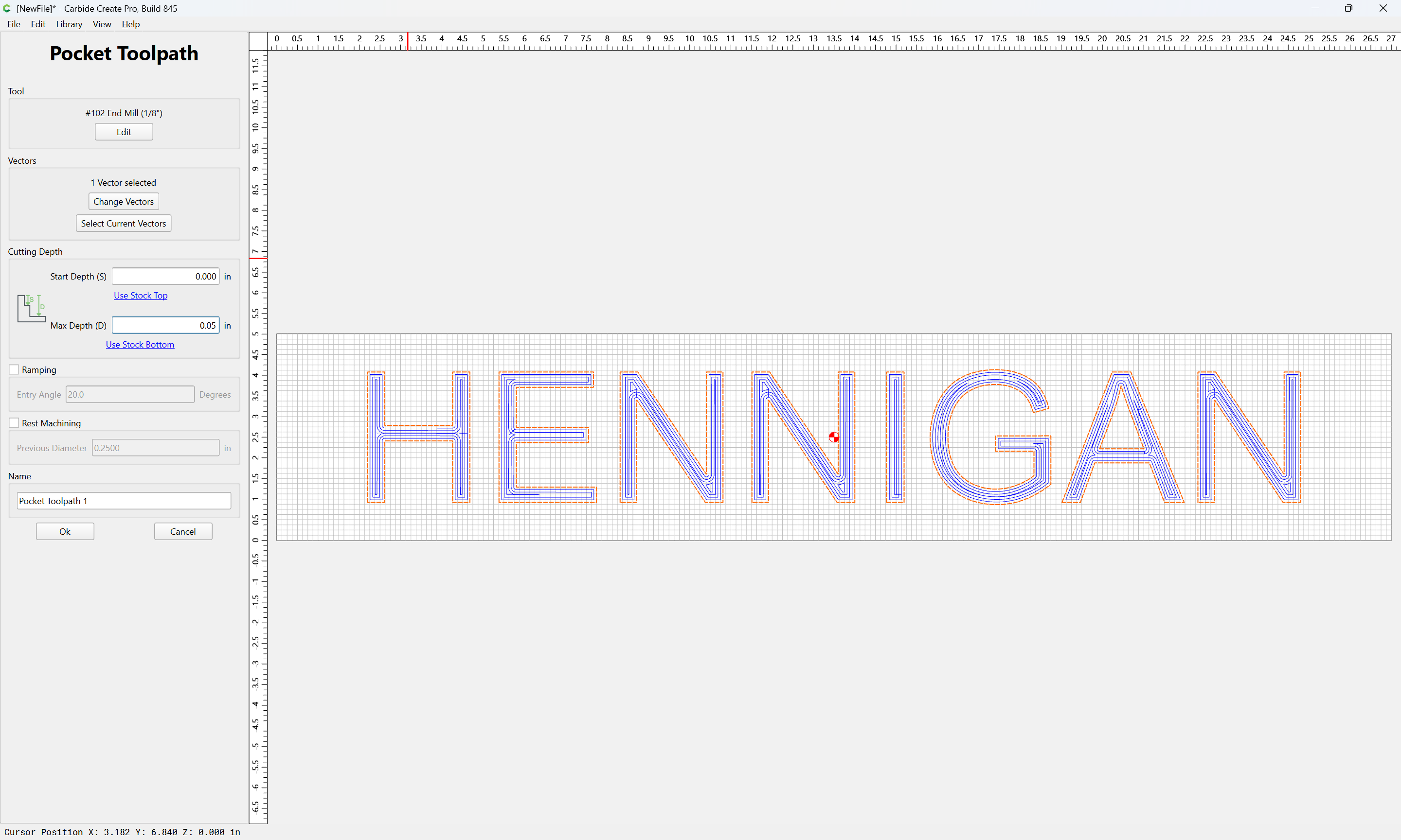

If you use the 1/8" bit and just pocket the letters, they will have 1/16" radius rounded inside corners. If you are fine with that, you can do that.

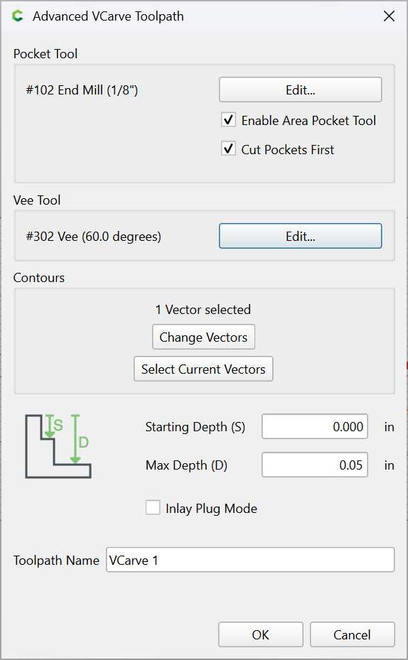

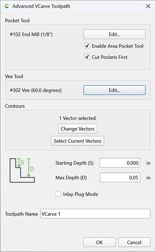

If you do the v-carve with rest machining and remove the majority of the material with the 1/8" bit, then you can use the v-bit and get the sharp inside corners.
It’s up to you - or your customer - as to what look you / they want.

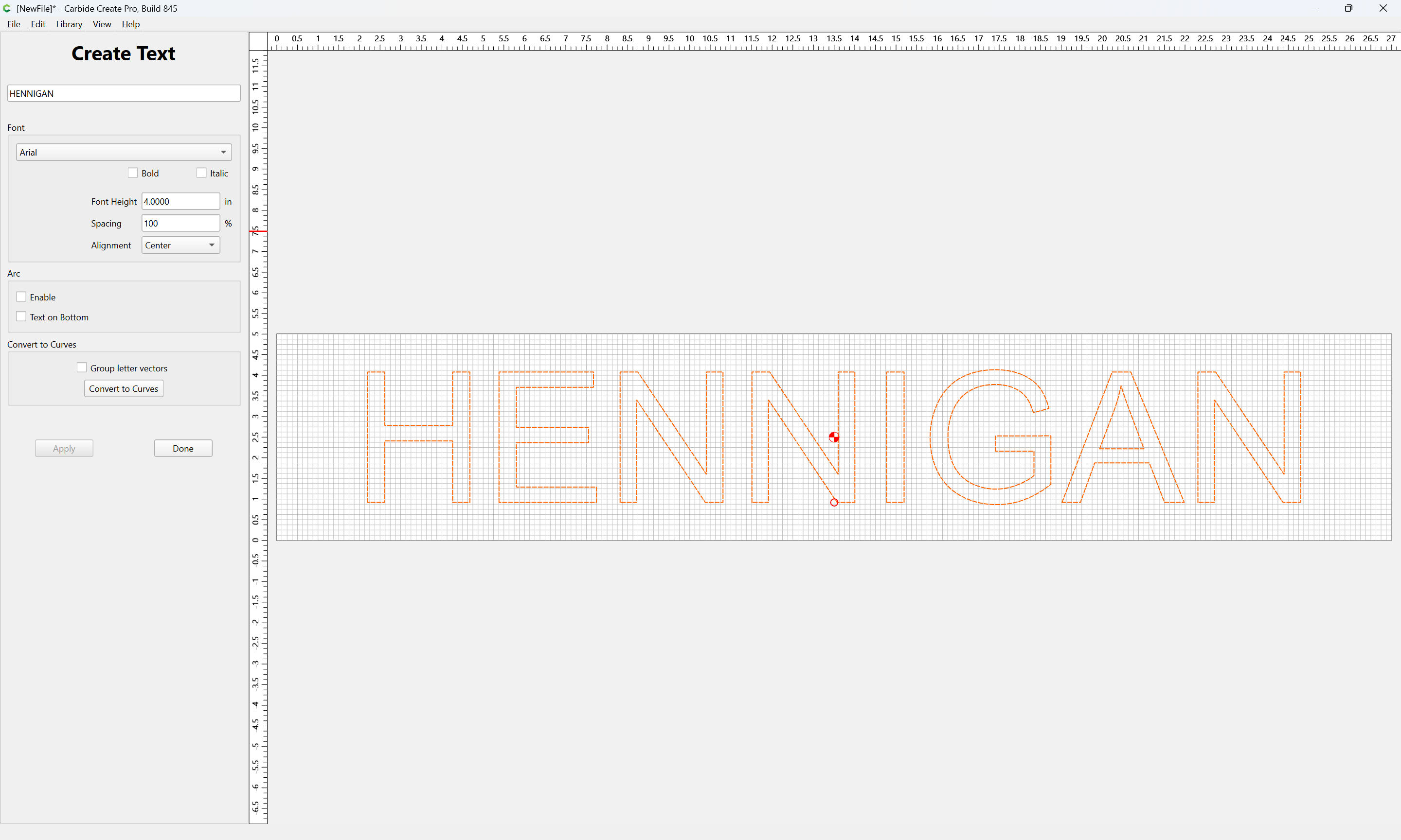

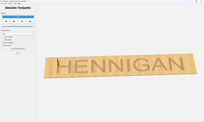

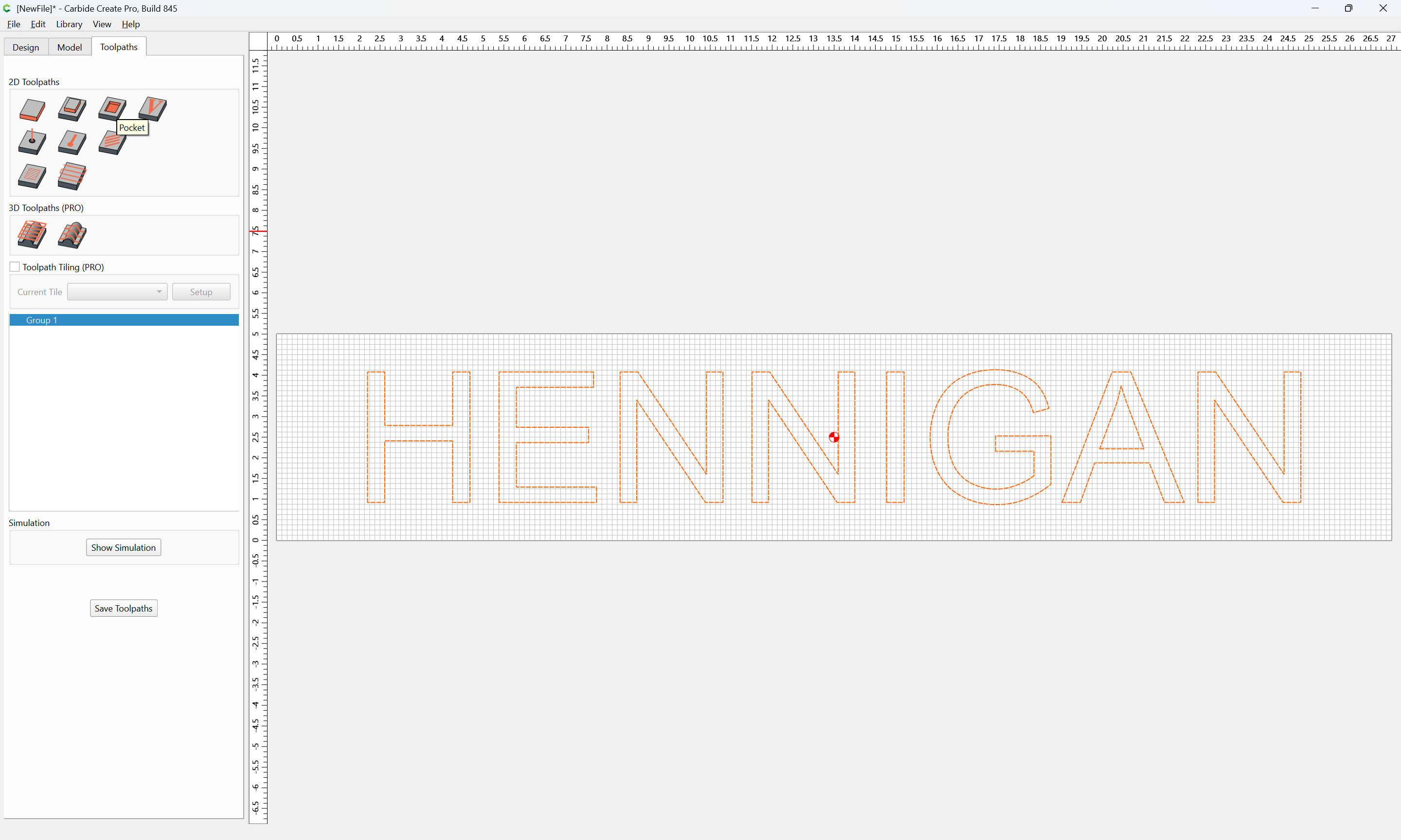

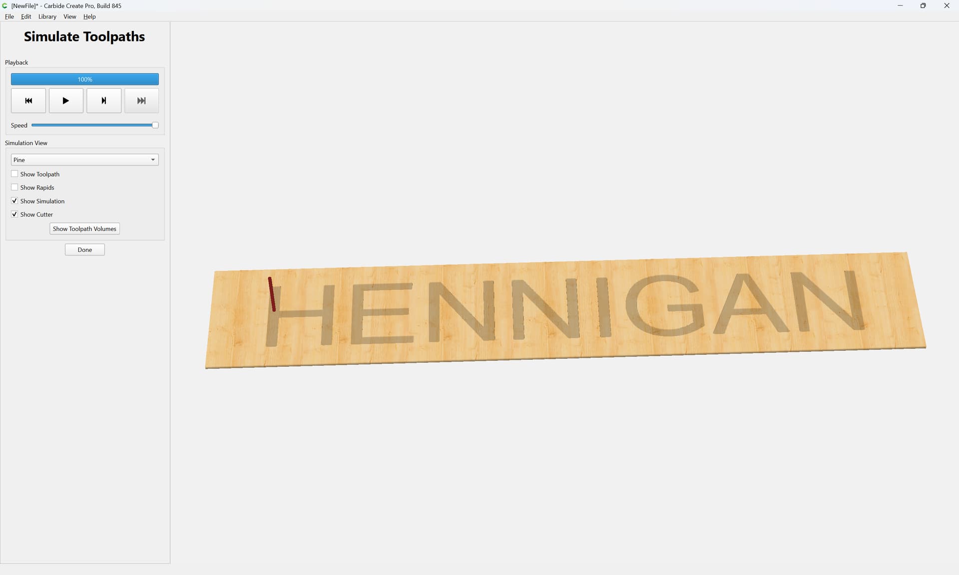

If you’d like to see what it would look like, you can modifiy your text to see what a 1/8" mill would actually cut:
Since you are pocketing, the majority of the text is considered inside cuts.
At those dimensions, just using a 1/8" tool should work fine.
Using a V-carving with pocket-clearing will make the corners a bit crisper at the expense of a slight angle:

There are several ways to achieve what you’re planning to do. Start with a 1/4” bit to run your pockets, and done. This leaves a slightly larger radius on the corners of the letters but at 3-4”x 24” that will suffice. 4” height ratios out better to the length of 24”.
Another is to use the 1/4” as above for the pockets and then run an 1/8” bit to reduce the radius of the corner of the letters for a sharper block letter.
This can all be run in simulation and you cans see the difference for yourself and even show the end user and they can decide which one the want.
