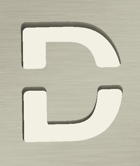

Hey all, digging for some knowledge. I am trying to pocket or contour letters to the bottom of the stock as to leave a cutout. this is so backlight will show writing. i cant seem to find a good way to keep the center of the letters as pictured in attachment. any info will help thanks for the advise in advance.

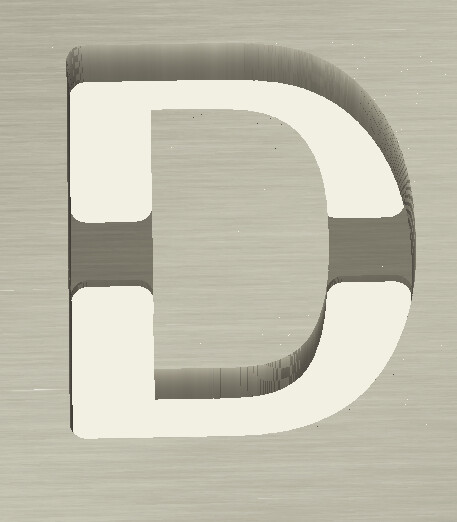

If you want tabs, you need to pocket down to the height of the tab, then do a contour pass from that depth to the bottom. However, as a contour, it wont clear the whole width of the pocket.
I think to get what you want, you will need to draw in the tabs (the entire width of the pocket), then use one pocket operation to get down to the height of the tab, then pocket over multiple areas between the tabs.
If this is what you are shooting for and you need more details, let me know and I can post a step-by-step of what I did to get this.
thats it except maybe for visual thinner tabs and top of stock to bottom so it will show more light and still be strong
If the tabs are top to bottom, then that simplifies things.

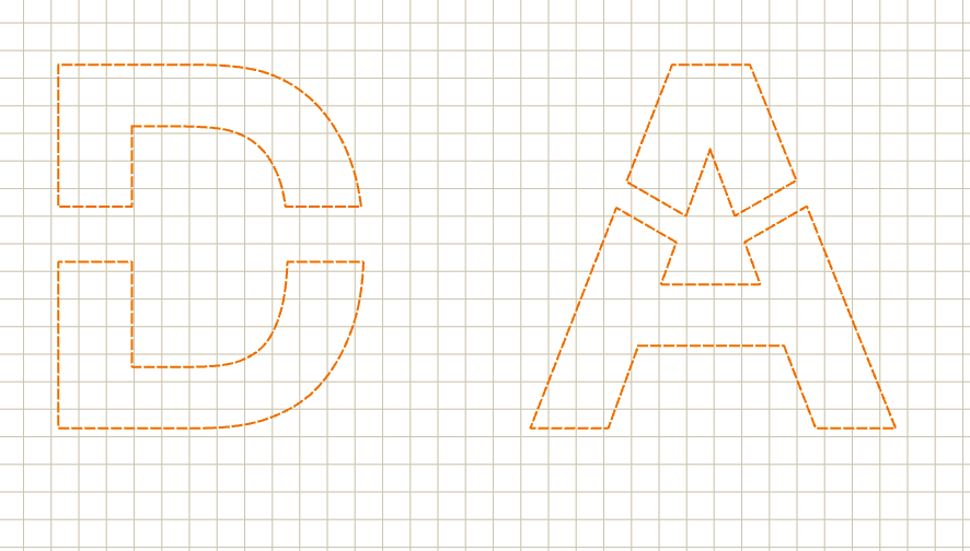

Start with your letter, and draw in geometry to show where the tabs will be. If the tab geometry is more than one vector, group them together:
In this case It could just be one rectangle, but showing using multiple:
Select the letter, then the tab geometry last:
Boolean Subtraction, check “Group Output”, it should look like this - blue is what will be kept:
Hit OK, then assign pocket operations:
yes! exactly sorry for the delay i was figuring that out as well. Thank you so much for the help.
this is way easier then what i was doing lol glad you replied.
