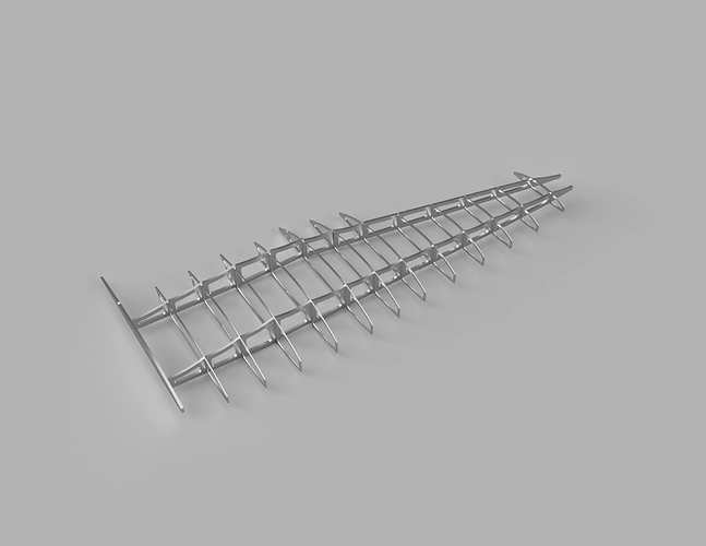

Fusion360 FEA applied to exactly this problem. Probably more work than I want to go through, but someone else might find it useful.
