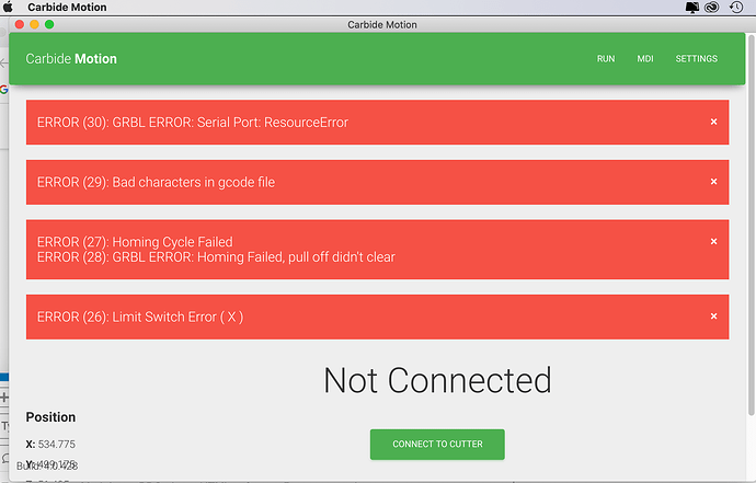

Hi there,
I moved my Shapeoko XXL to another country in a container and when I powered it back in France (via a 110v to 220v transformer) and started the Homing process it consistently gave me a Limit Switch error (X), with a series of errors after that > view photo.
The Limit Switch Error occurs about 5 seconds after the homing cycle begins and I noticed it pops up on my computer screen right after the Z part goes all the way up and touches the limit switch at the top. Wouldn’t that be the Z limit switch at the top of the Z gantry that goes up and down ? Anyway, I checked and tightened all the wheels so that none of them turned loosely as I saw could cause a similar problem but that didn’t change things. What am I missing to check and correct to eliminate this issue? thank you

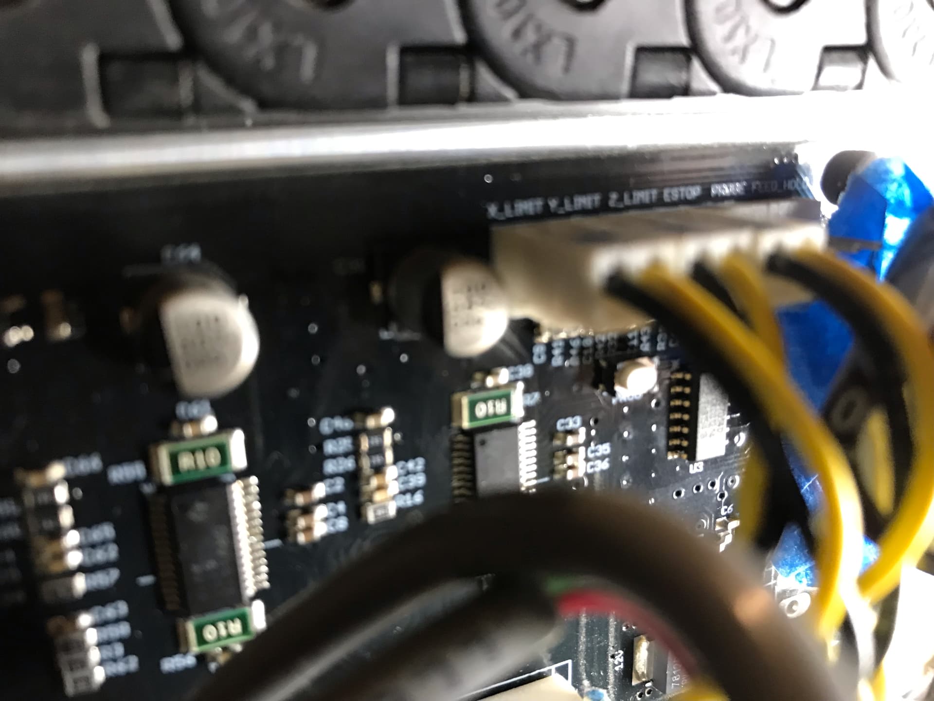

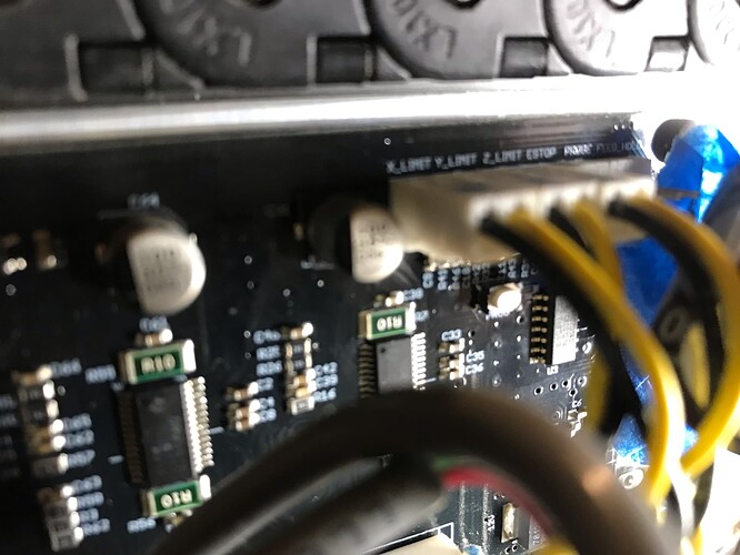

So I just tried to re-initialize my machine through the New Machine Set Up process and when I arrived at the Homing Switch State it looked like the X Limits remained on. I tried to flicker the switch many times and also checked the connection and the wires from the switch to the controller and didn’t notice anything wrong. The other two switches turn on only when I press the switch (although the Y switch sometimes doesn’t turn on and sometimes it does) and the Z switch turns on every time.
Do these switches go bad ?
When I opened the controller box I noticed a reset button underneath the limit switches, would it possibly correct this problem if I pressed it?
