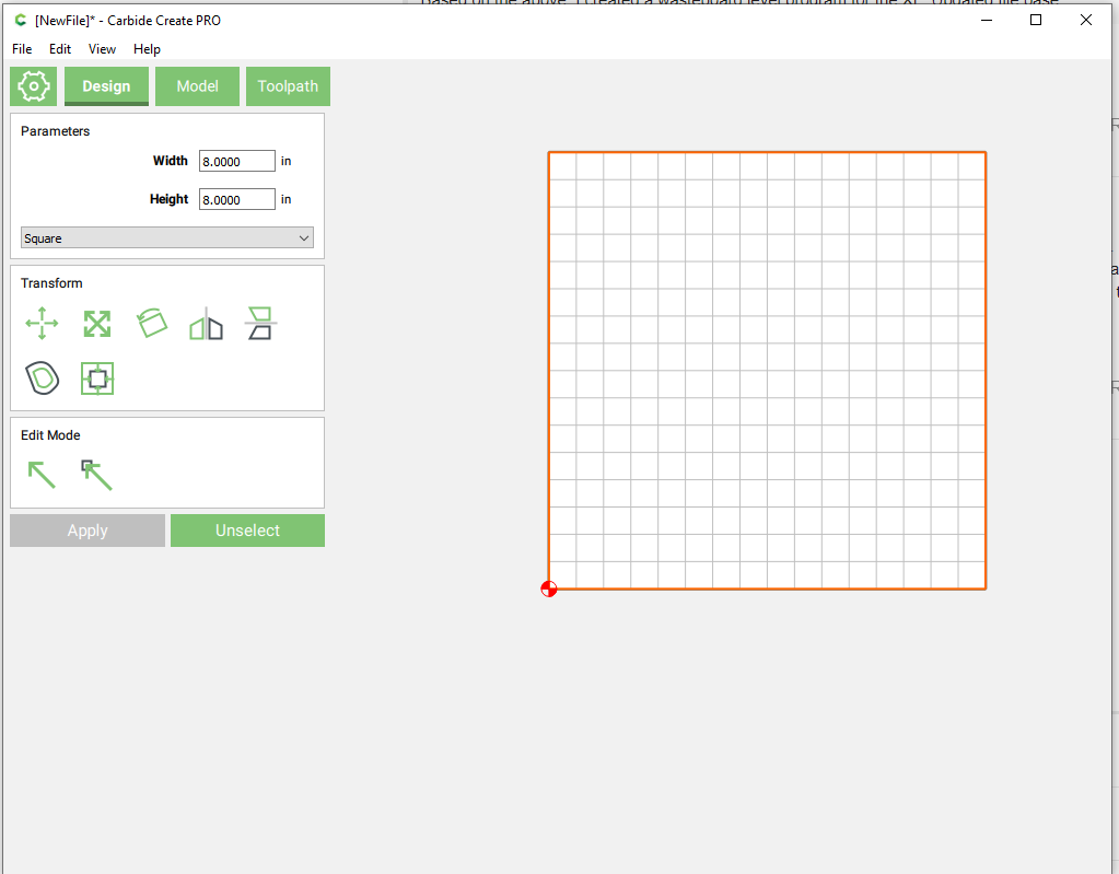

I usually setup spoilboard leveling in carbide create because it’s a heck of a lot easier.
Setup stock size.
Then make an 8x8 inch square and center it in the work area.
Then make 2 toolpaths. First is a pocket:
Second is a no offset toolpath.
Zero the machine at the bottom left corner (I use the rapid position) and then hit go.
Here’s the file:
wasteboard.c2d (7.9 KB)
