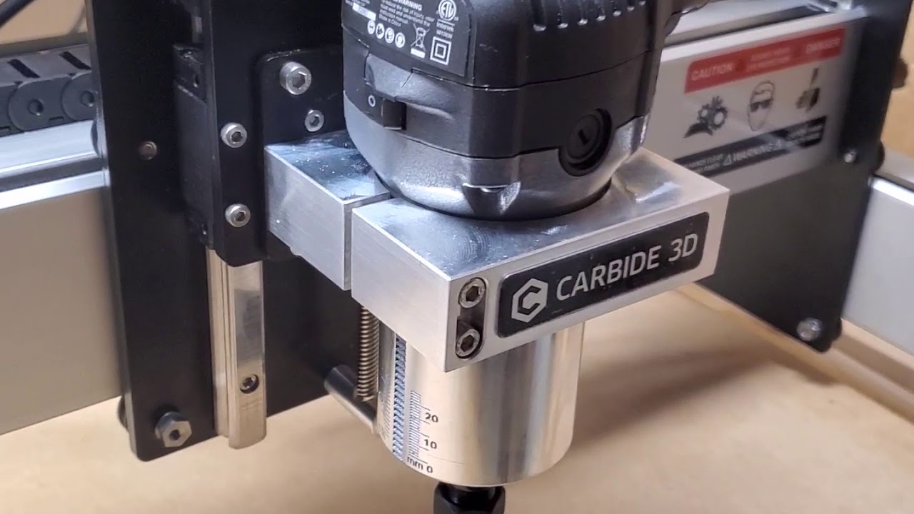

ok when i bring the x beam forward and initialize the maching the z moves down a littlt then up and x and y move back and z just sit in the center making noise and vibrating and if i put metal in front of the limit switch it stops

Can you see the X motor shaft/pulley when this happens? Seems like a pulley with no set screws or a wiring issue on the X.

Looks to me like the X stepper has a wiring fault.

It may get a bit more complicated from here, what I would do is swap the wires between one of the Y motors and the X motor and see which didn’t work.

ok i switched wires every thing worked fine except the z
So, you switched over the X and Z motor wires?

It looks to me like the black wire from the X stepper connector is out of the white housing and dangling on the board instead.
Can you pull that connector off the board and see if all four wires / pins are in it pls?
yes black wire is out how do i fix
With the connector removed from the board it should be possible to push the black pin back into the connector housing.
You’ll need to have the crimped end of the wire the right way up. If you look closely at the bit that is crimped to the wire, at the end of the insulation you’ll see that there’s a pinch where the two sides come together. You want to make sure this is facing the same direction as all the others.
It should clip into the connector.
the wire came out of the crimped connector does not look like it was crimped to begin with

Not really, you generally use a new crimp connector for that, and you need the crimp tool.
You could try removing the crimp but it’s not easy, you have to find the release clip. I’d solder the wire on to the crimp but I’m used to doing wiring.
I’d suggest calling support and asking them to ship you a replacement cable now.
