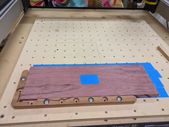

I have an SO3 with a 2" spacing using Tee Nuts. The newer machines with the hybrid tables you can still use an L bracket just locate the holes for your bolts to line up with your L bracket. Below is my long L bracket c2d file. Just modify it for the spacing you want.
long_L_bracket.c2d (296 KB)
When I put the L bracket on the spoilboard I tighten up the bolts lightly and use a bit in the router to line it up perfectly parallel to the router by touching one end with the bit and jogging to the other end and tighten up the bolts and then jog back to the other to make sure it is still lined up. The bracket can move slightly when tightening up the bolts.
Tod(1d) had suggested after getting the L bracket square you drill some dowel holes through the bracket and spoilboard and insert dowel so it is always perfectly lined up when replacing it after removing it.
In the picture above I use the L bracket to square up the material. If I am going to cut near the L bracket after getting the material secured I remove the L bracket.

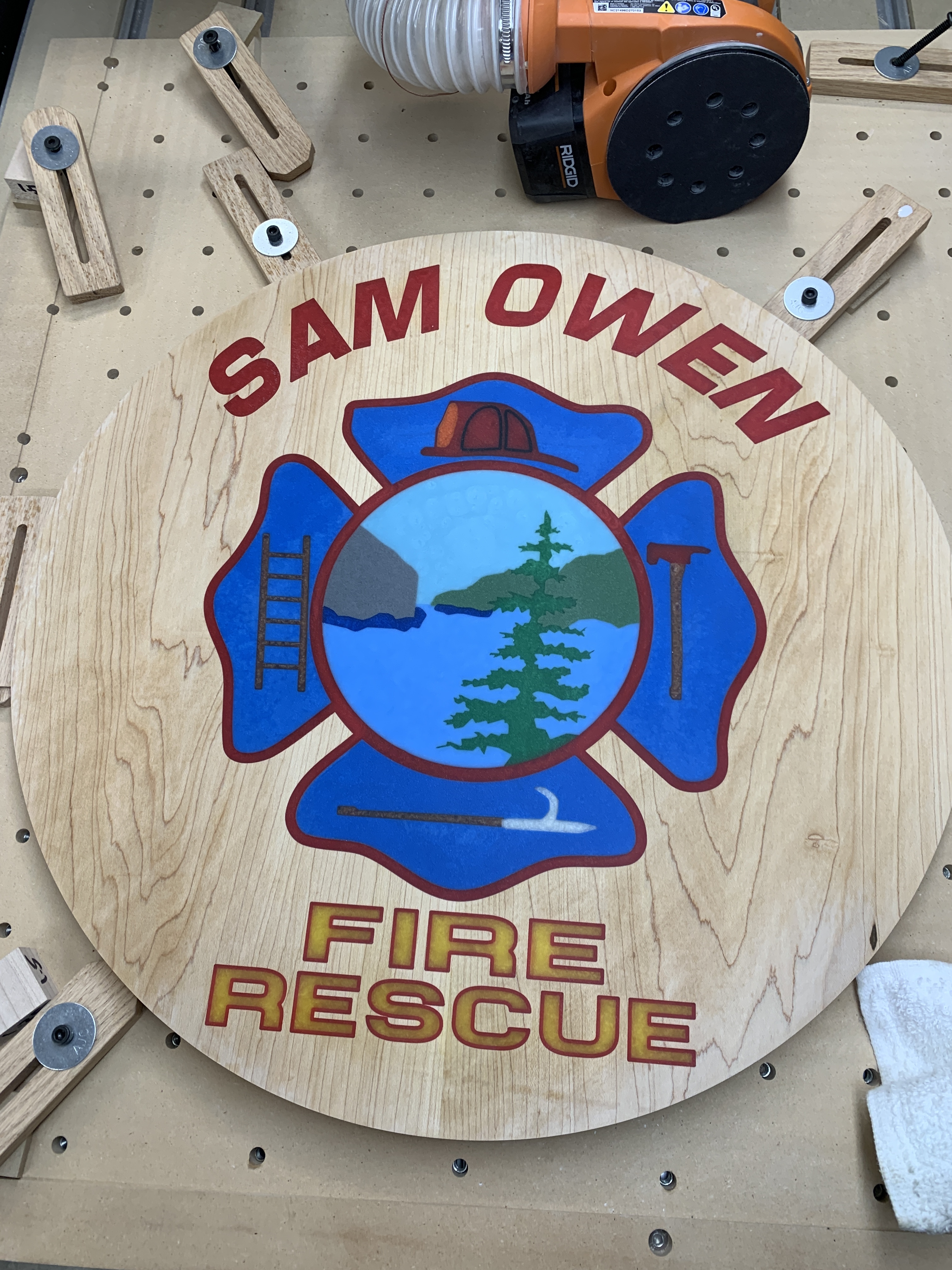

Personally I would never pour acrylic on my Shapoko table. I always pour in a form tray. When I poured the Lake board I made the grave error of running the top and bottom through the joiner to get the board to fit into my pour tray as the board was slightly too big. I only meant to run the top through so as to keep my zero as I had set up a fence. Now my fence was of no use to me. I took measurements from precise locations of the blue lake and changed the size of the board in Create so that my new lower left corner was indeed my new zero and set the board against the existing fence and closed my eyes and hit start. The roads did not cut into the lake anywhere. There is one particular spot that is right next to the lake, but that is exaclty how I drew up the map (this took a long time as there was no good map to pull from, I used a BLM map, it was so pixilated that I spent hours editing nodes). In the end, my measurements and calculations were correct. not only had the machine been shut off, but my laptop had been disconnected. I have never had a problem with returning to zero. I also recommend that anytime you are doing something that is new to you, do a test piece first.

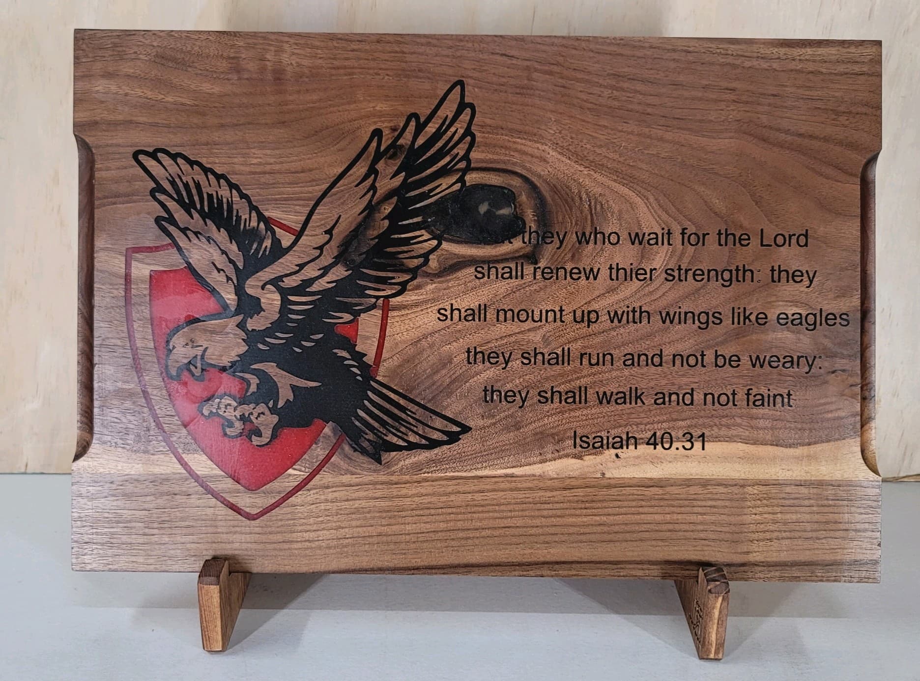

On the second board I learned from my mistake and now make certain that the board fits into the tray before I start cutting, you can see the detail in the eagle and the shield and that neither cuts into the other. I cut and poured the eagle first, then the shield.
