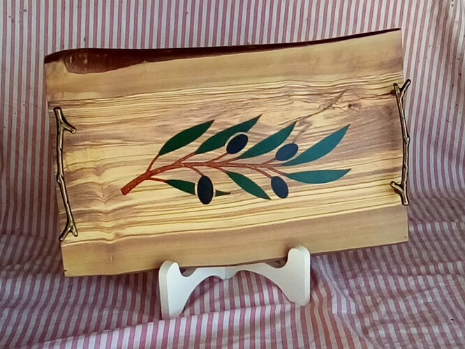

Live Edge Olive Wood Charcuterie with Epoxy Inlay
I believe this speaks for itself.
Nicely done! I really like the handles as they match perfectly. Did you epoxy in 1 shot or in separate pours?
Thanks! Yes, separate pours. I used a hot glue gun to damn up each color, allowed epoxy to set and then removed the glue and poured the next. Had to fuss a little with the cured glue removal but it worked.

Here’s just one more…
356439009_6242876015829672_4629740696809910815_n
Thanks for sharing! I will have to try the hot glue dam. Normally, I just cut a section out, pour epoxy and then cut the next section. With live edge, it’s always tough to line it up exact again so your way would remove that issue.
