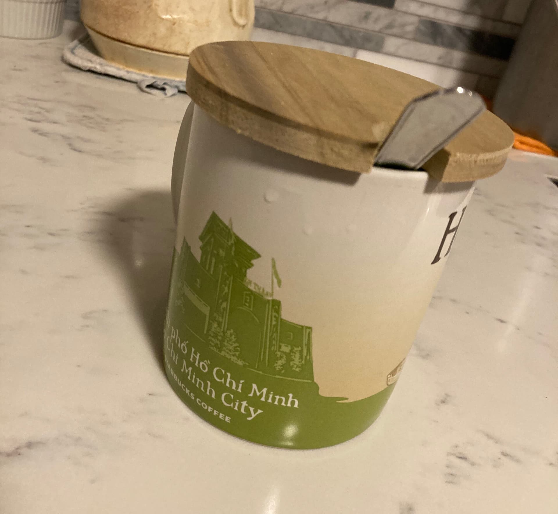

I planed the surface and carved a rim on the lid.
Improvisation
I took the lid out of the key and tested the fit on my mug and guess what… It didn’t fit… The nice thing is with the key and the SO4 still centered on the key. I could pop the lid back in and carve a larger rim.
Took it out again and tested it. It fit, but… now the spoon opening wasn’t big enough. So redesign and put it back in.
Since I didn’t want to cut into the key because I was going to use it on a second lid, I left about .15" of the opening which I cleaned up with a flush trim router bit on a router table.
Here is the end result
