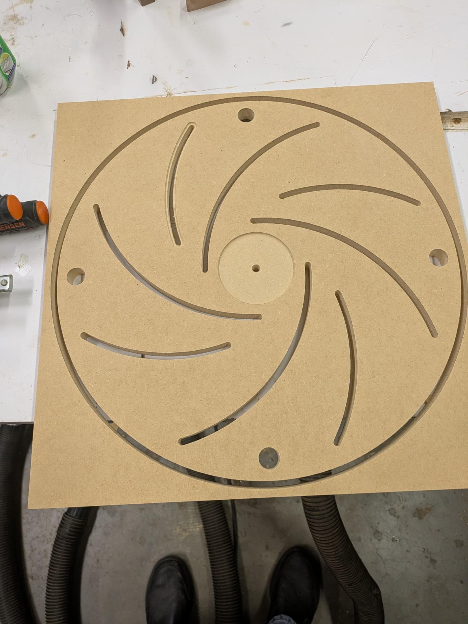

I am going to make a Longworth turning chuck for some friends on my SO3. I found a good svg on Woodworkers Journal for a 12" and 16". The problem is the 12" one is fine but the 16" just seems like someone simply increased the size and the slots were made bigger. My question is how to reduce the slots from 3/8" down to 1/4". I tried to create the Longworth chuck from scratch but had problem getting my boolean working. A Longworth chuck is simply a series of 8 circles. However they are only partial circles of a specific size.
Here is an example of the 12" longworth chuck.
In the above example the slots are about 1/4" wide. The 16" version they are about 3/8" wide which is too wide. They need to be 1/4" (or less) wide to work with the hardware.
So how do I reduce the 16" version or draw one from scratch.

Yes that is how to manually lay out a Longworth Chuck. I want to get it either drawn in CC or get an SVG to create it on my SO3. I have made them manually in the past but want to cut them on my CNC. Any suggestions on laying out the grooves. In the post they draw the partial circles with a compass. If I could just get the partial circles in CC I could just do a contour with no offset or make the grooves 1/4" wide. Since I have a CNC I would like to make several of these and make replacements for the future.
Can you use the ‘expanded’ size, and for each grove, just do an Offset to the inside?
I took the original, expanded to 16x16, then did an Offset inside by 1/16.

The design @jtclose worked for the 16" Longworth Chuck. I had to keep doing an offset on the curved parts until a .25" bit fit inside. This is the back plate. I will try to cut the front plate later today or tomorrow. After the 16" one is done I need to make a 12" one. These are for some of my fellow Wood Workers of East Texas Club.
Need to cut the tabs off the outside but that wont take long.

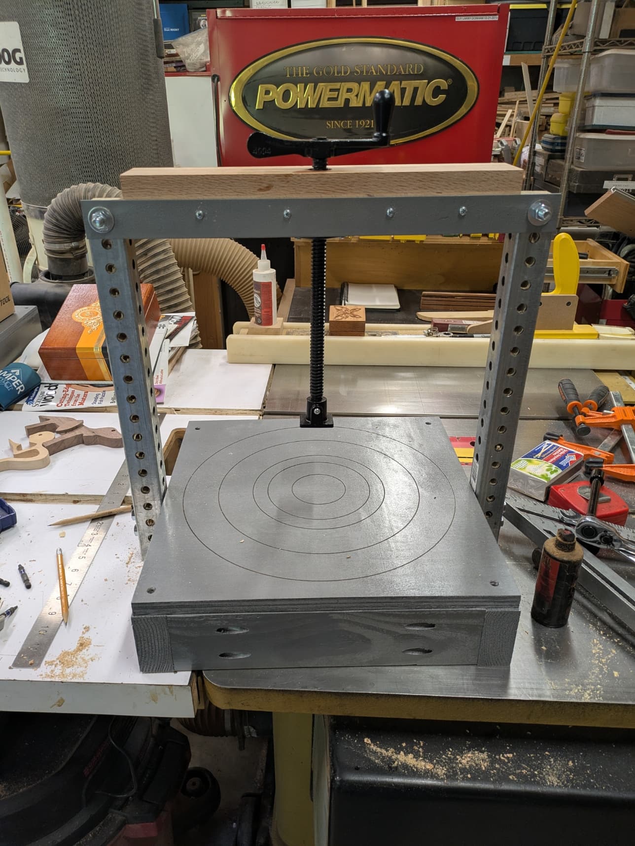

As a companion to the Longworth Chuck is a press. This is to aid in gluing up segmented bowl turning.
I made two of these to go along with the Longworth chuck. Previously on my SO3 I had made two Wedgie Sleds to cut the segments on a tablesaw. I designed the Wedgies in CC and cut them from 1/4" plywood.
