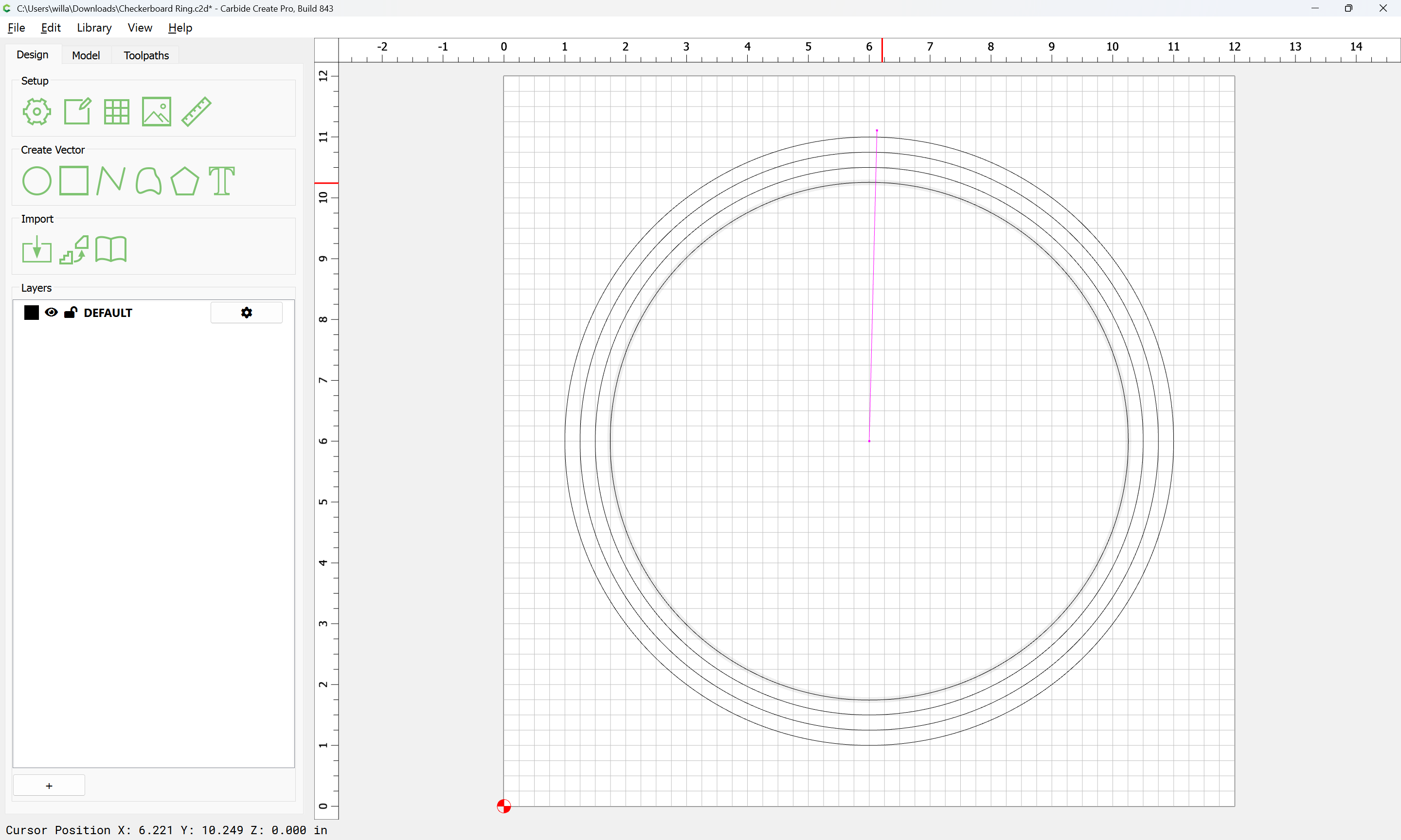

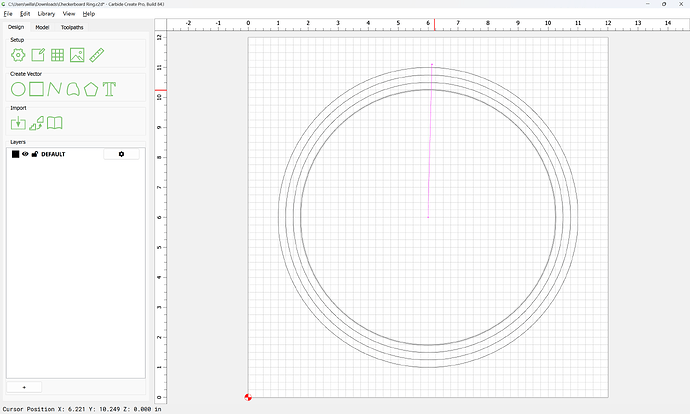

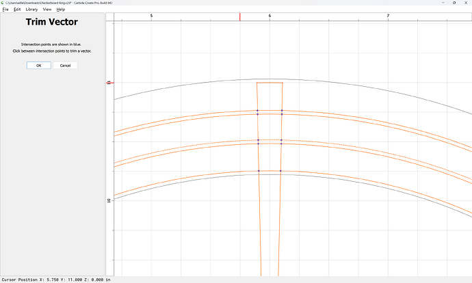

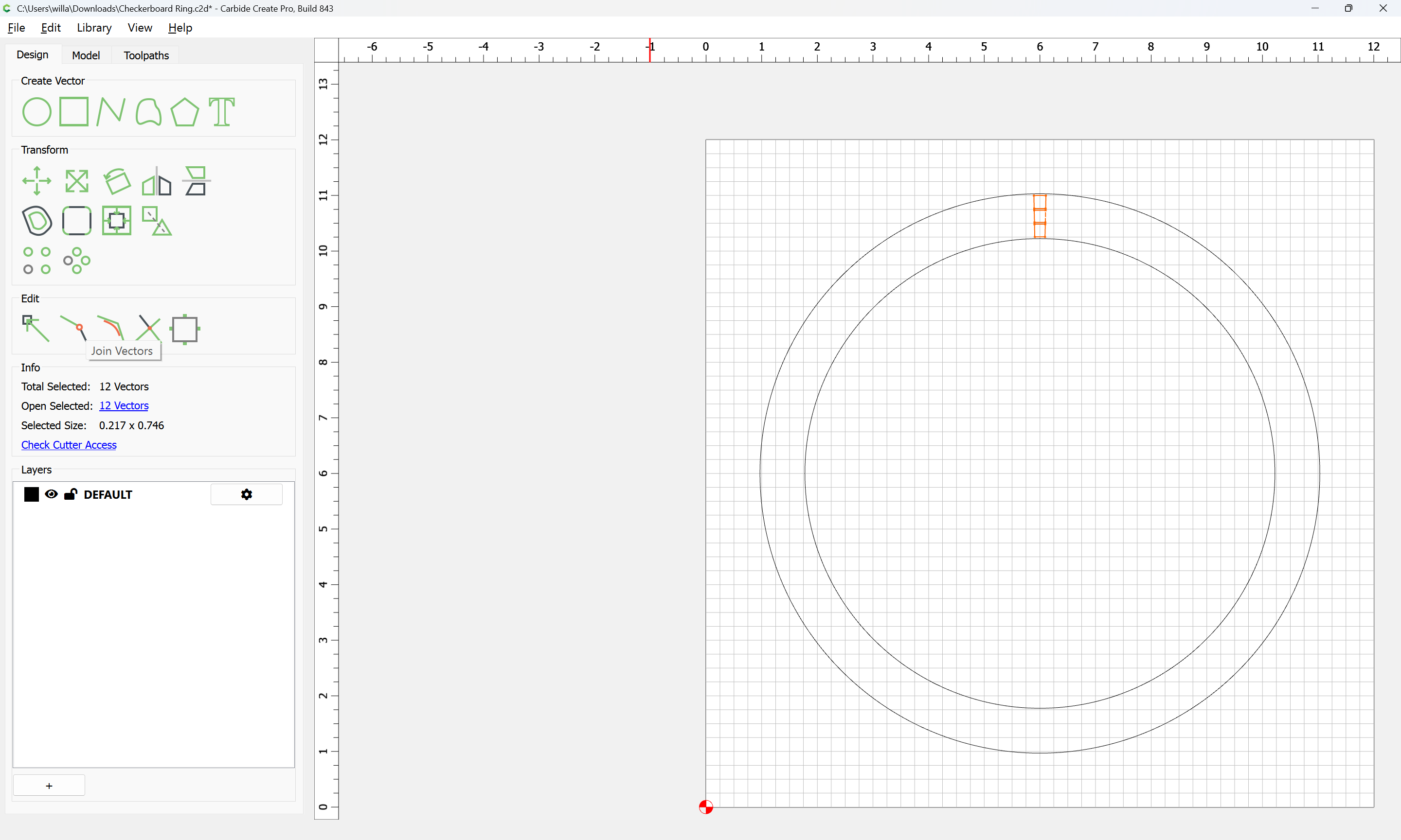

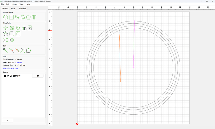

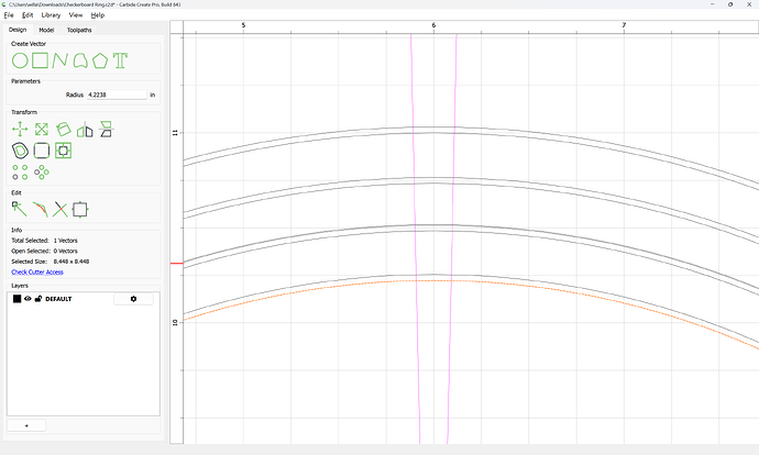

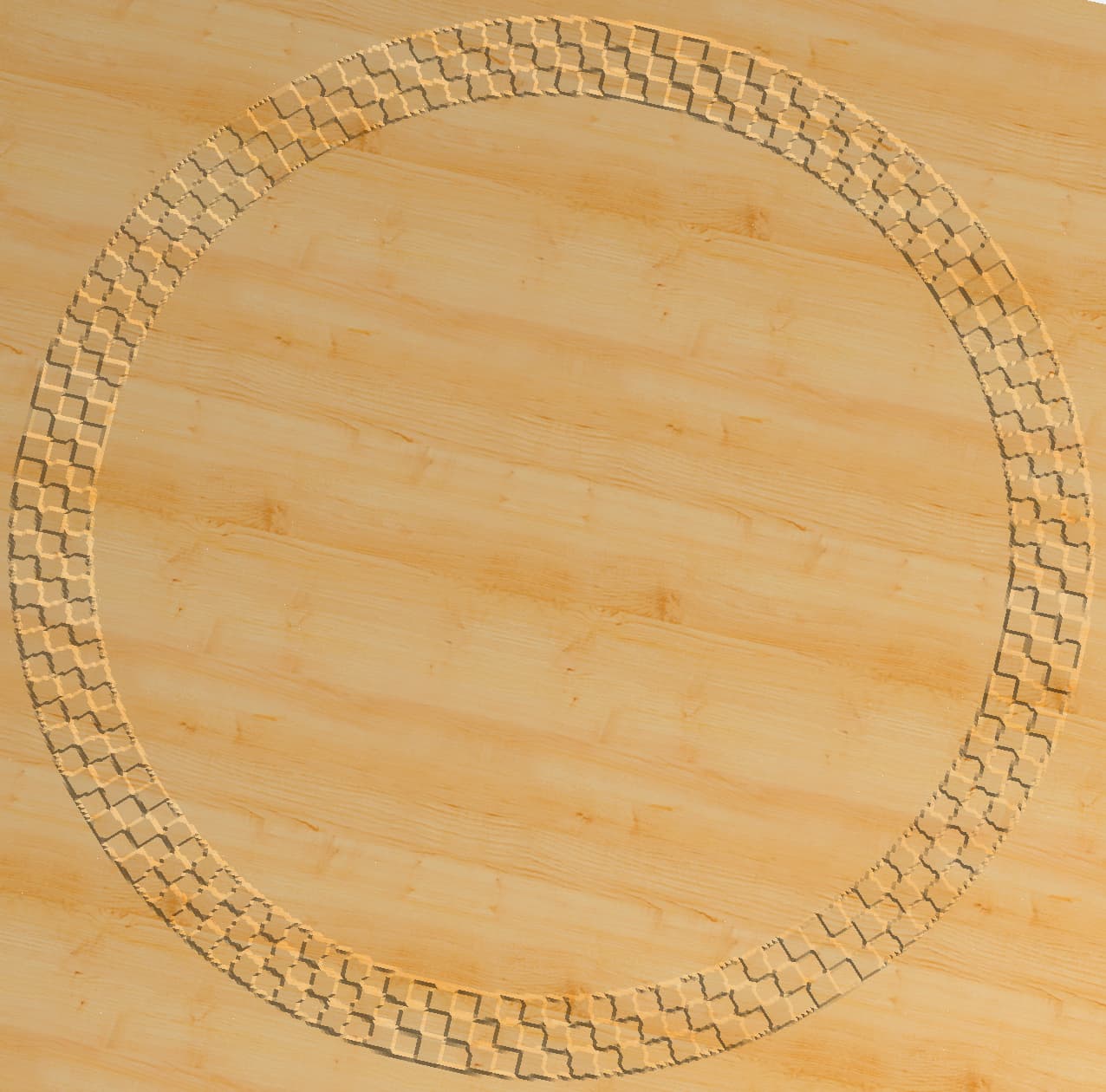

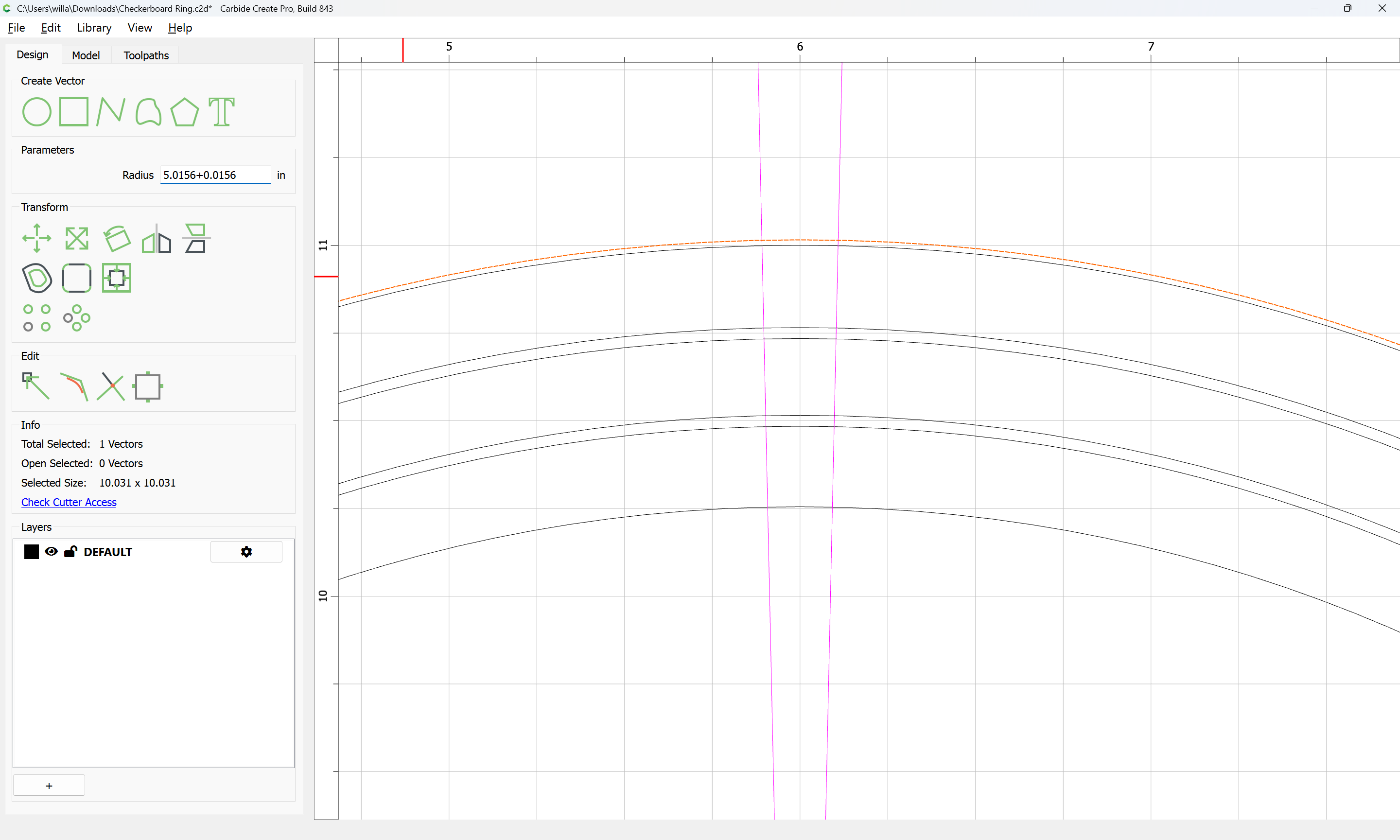

I’m attempting to create a checkerboard ring and looking for an easier solution than what I think I’m going to have to do to create the alternating sets of ‘squares’.

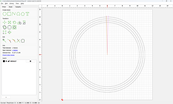

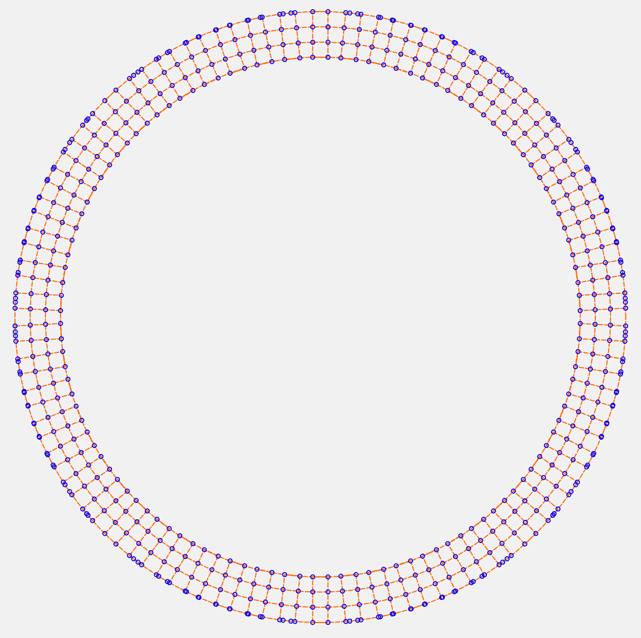

I’ve created 4 circles, each offset by 1/4" and 58 1/4" x 3/4" rectangles in a circular array which gave me the pattern I wanted. Next I want to create individual boxes, grouped into alternating sets, so I can carve the pattern. Really I need only one set, the alternate group will form naturally when the first is carved.
Does anyone have any suggestions to shortcut the process of trimming vectors on a couple hundred squares in the shape of a ring? :face_with_spiral_eyes:
I’ve attached the file if anyone is inclined to get into the weeds on this one.
Thanks!
Checkerboard Ring.c2d (192 KB)

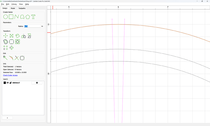

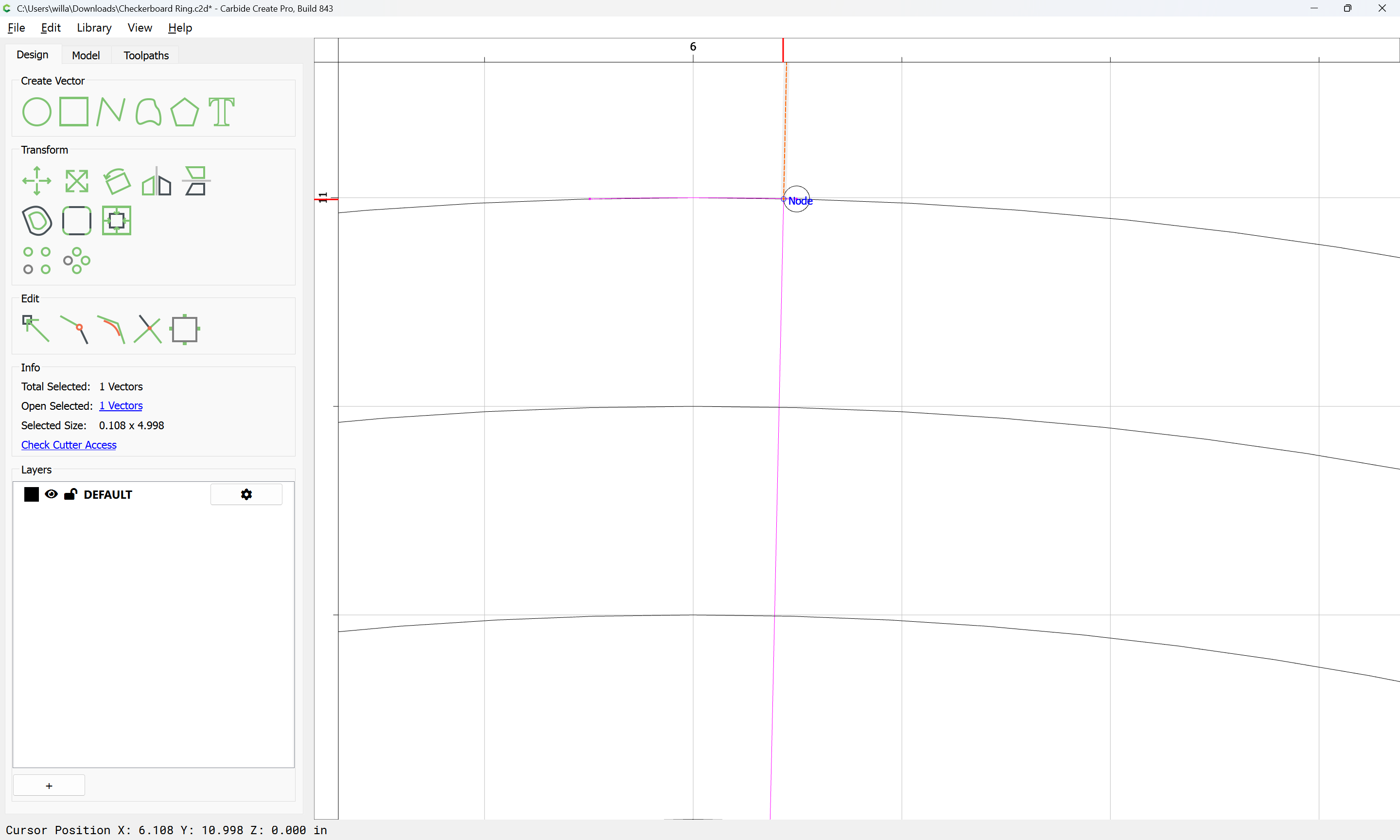

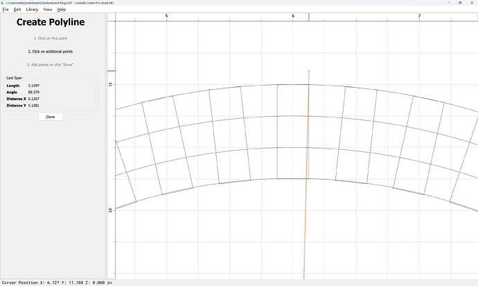

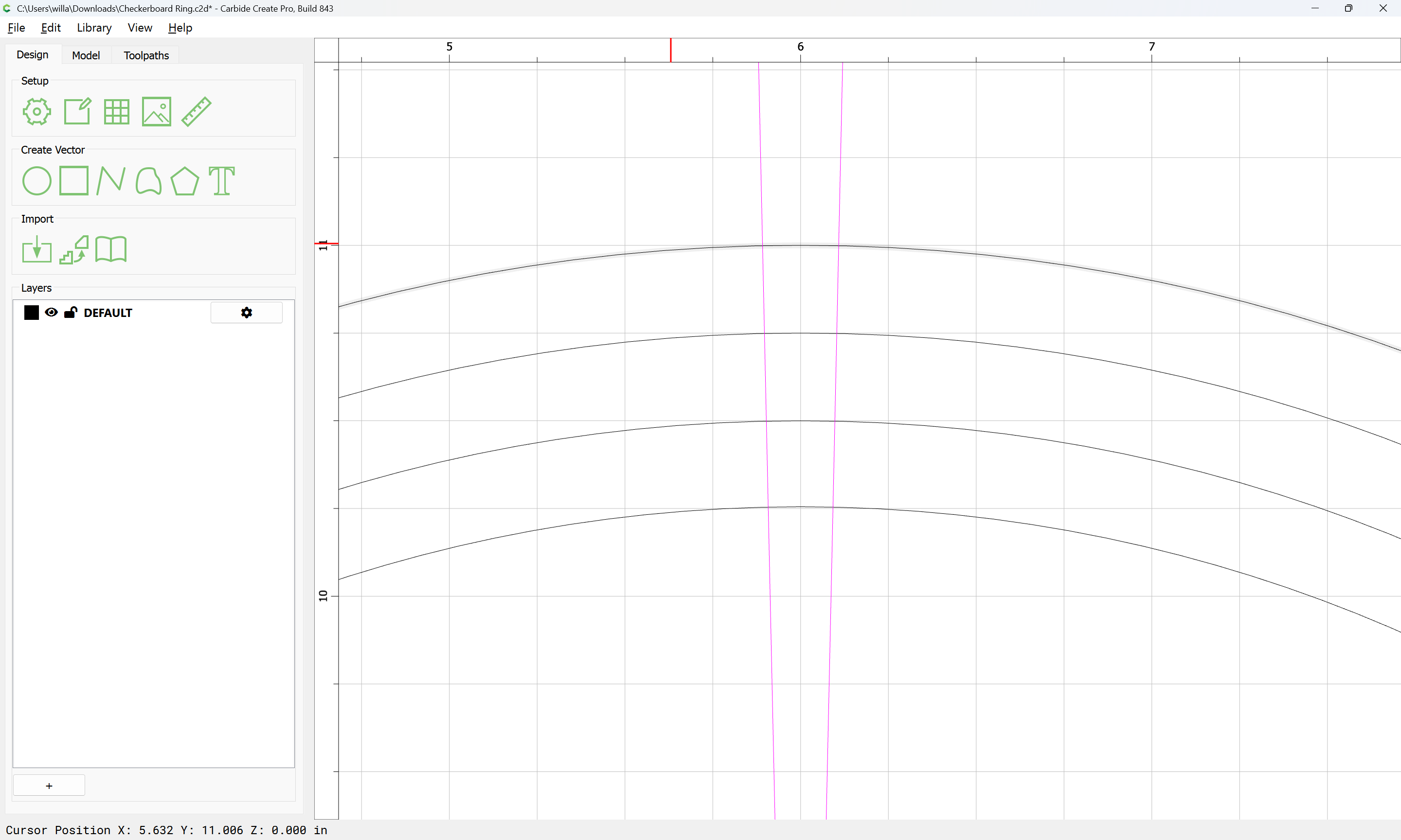

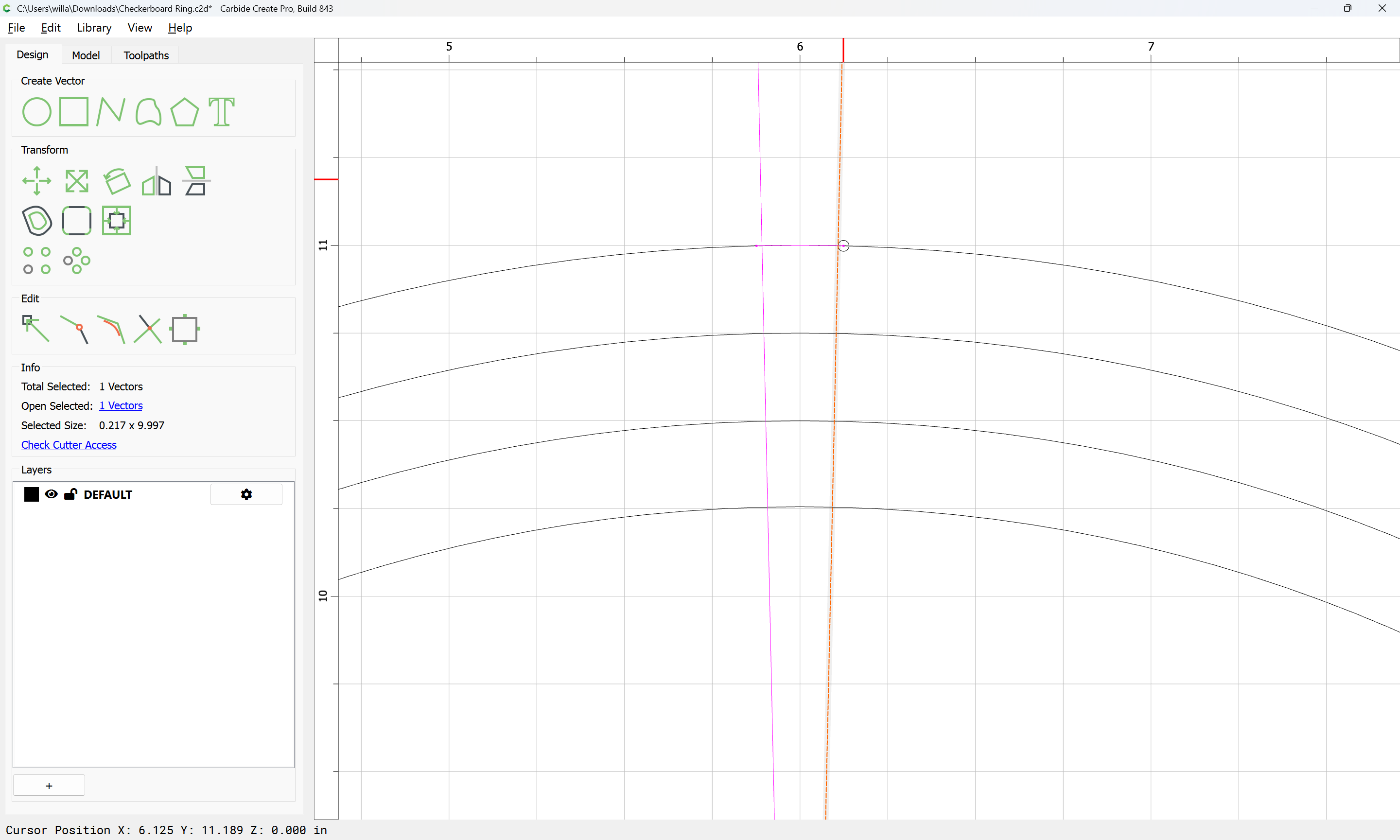

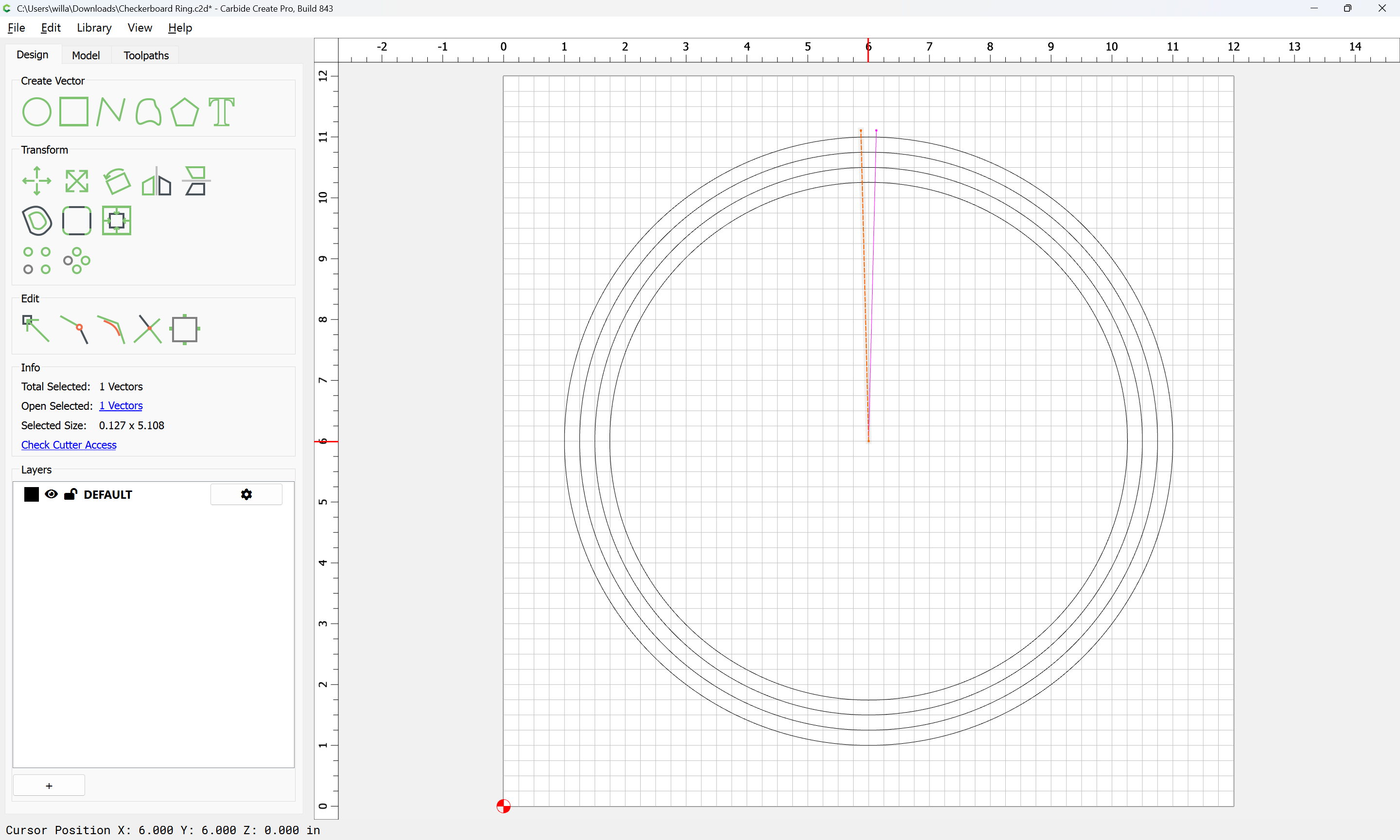

Just draw one set:
and delete what is not wanted

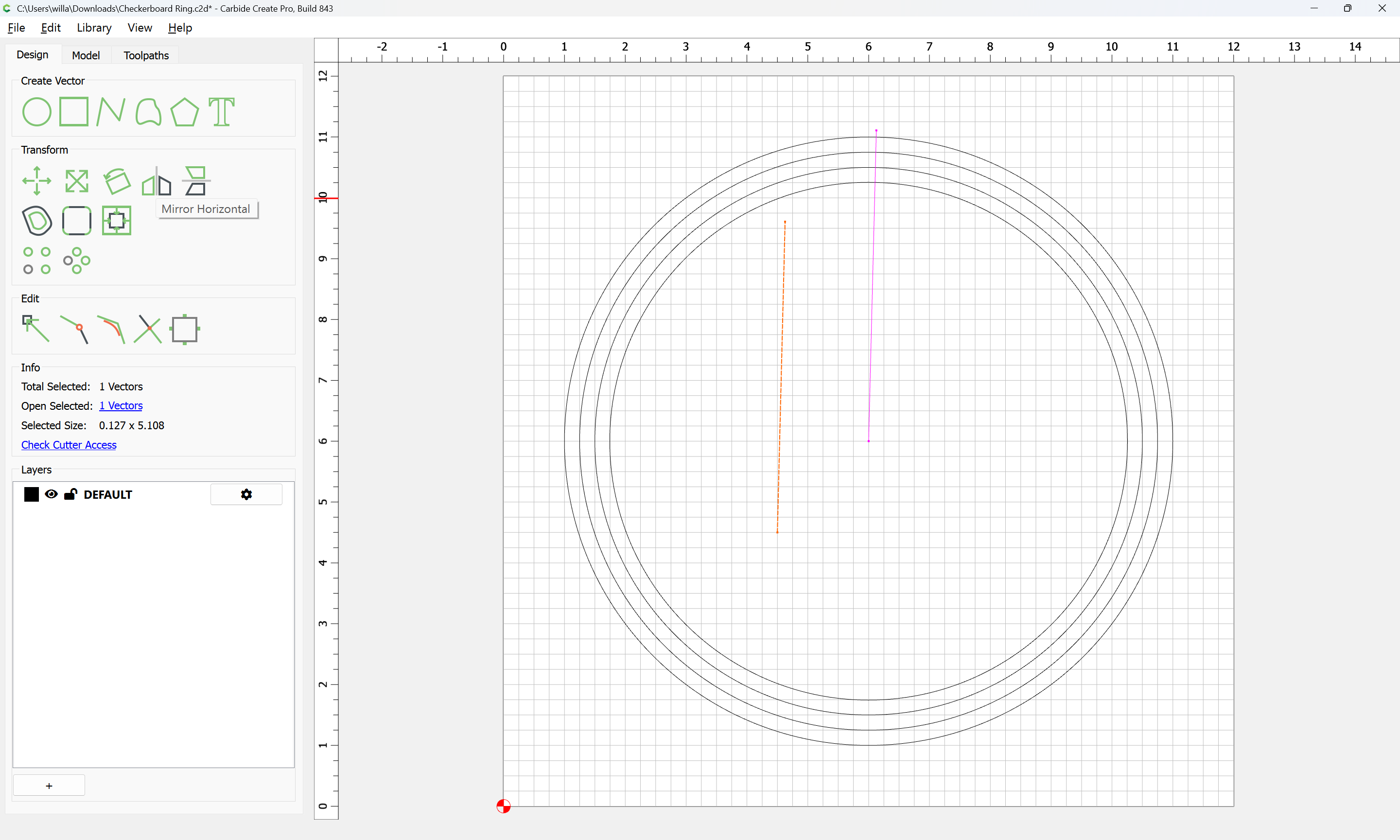

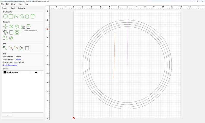

Then duplicate the line:
and flip it:
and drag into registration:

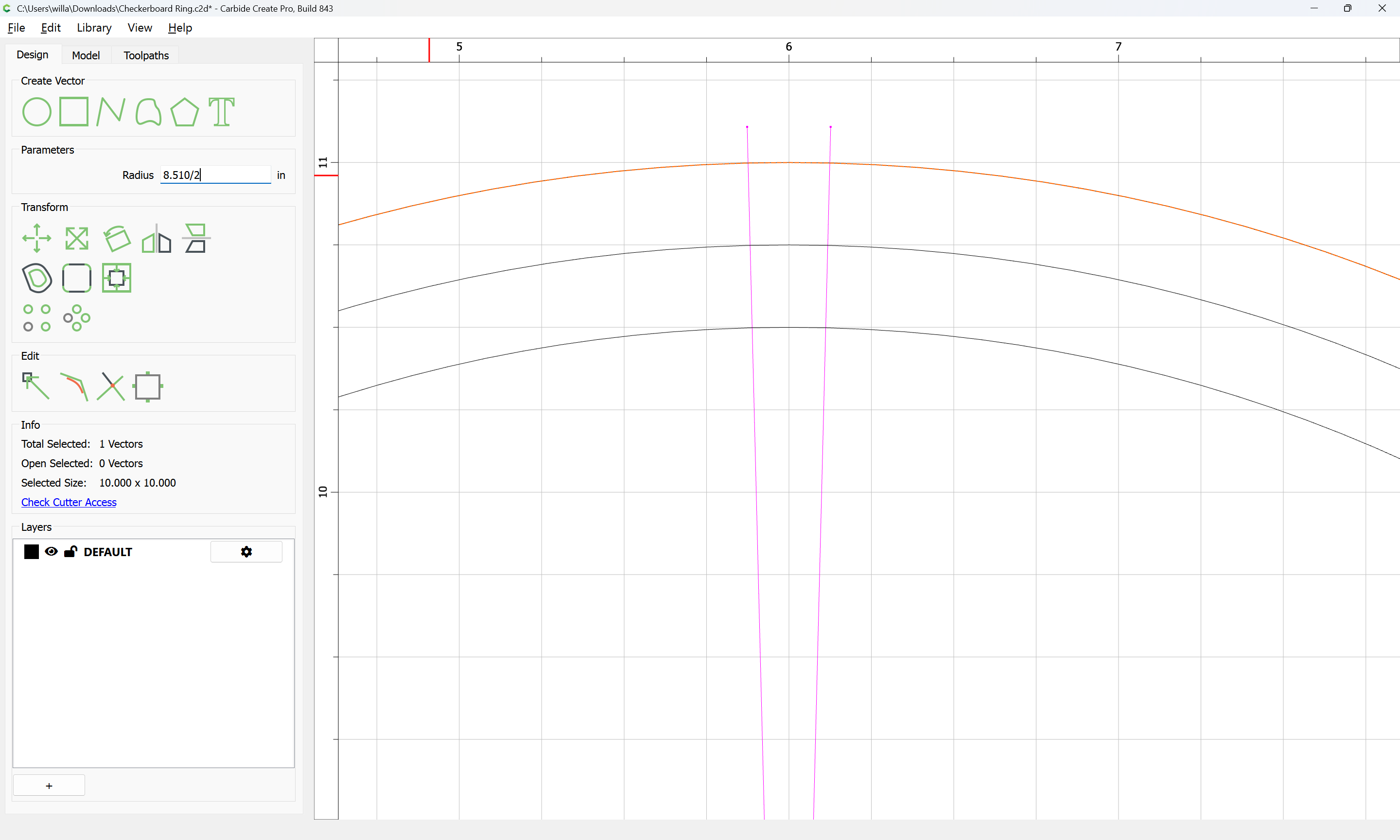

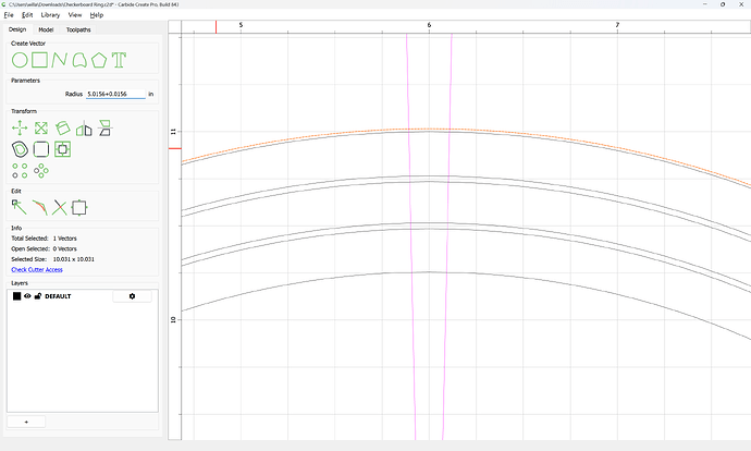

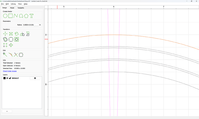

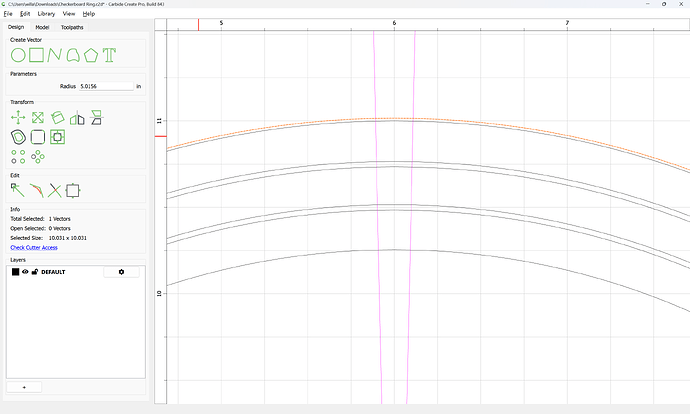

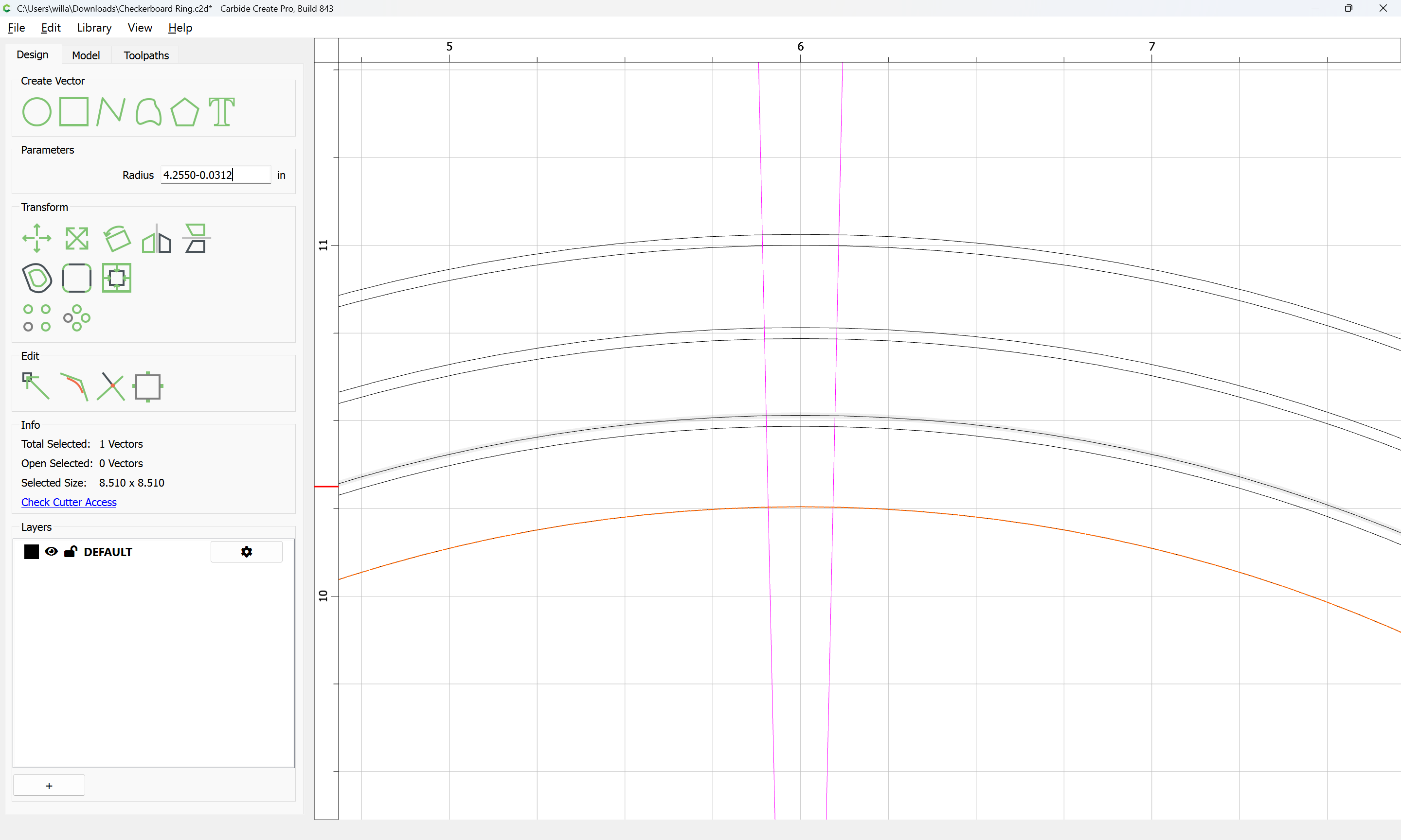

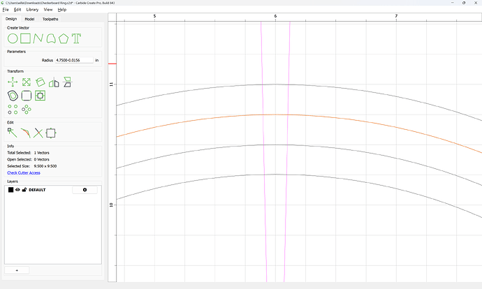

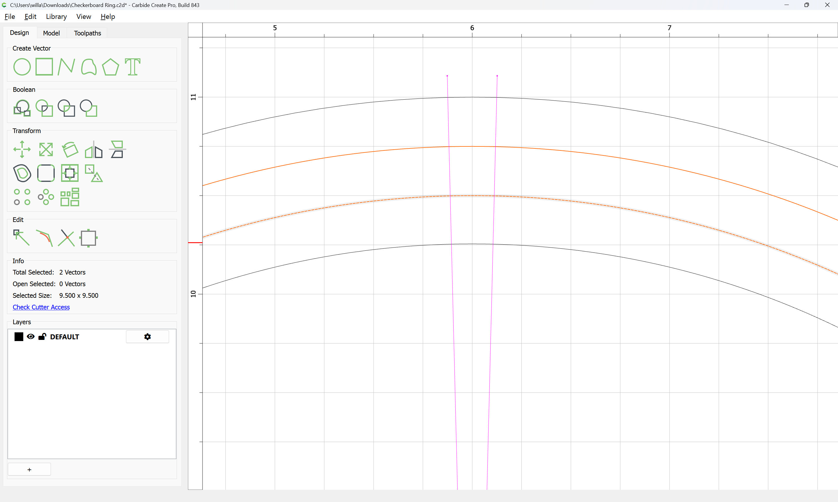

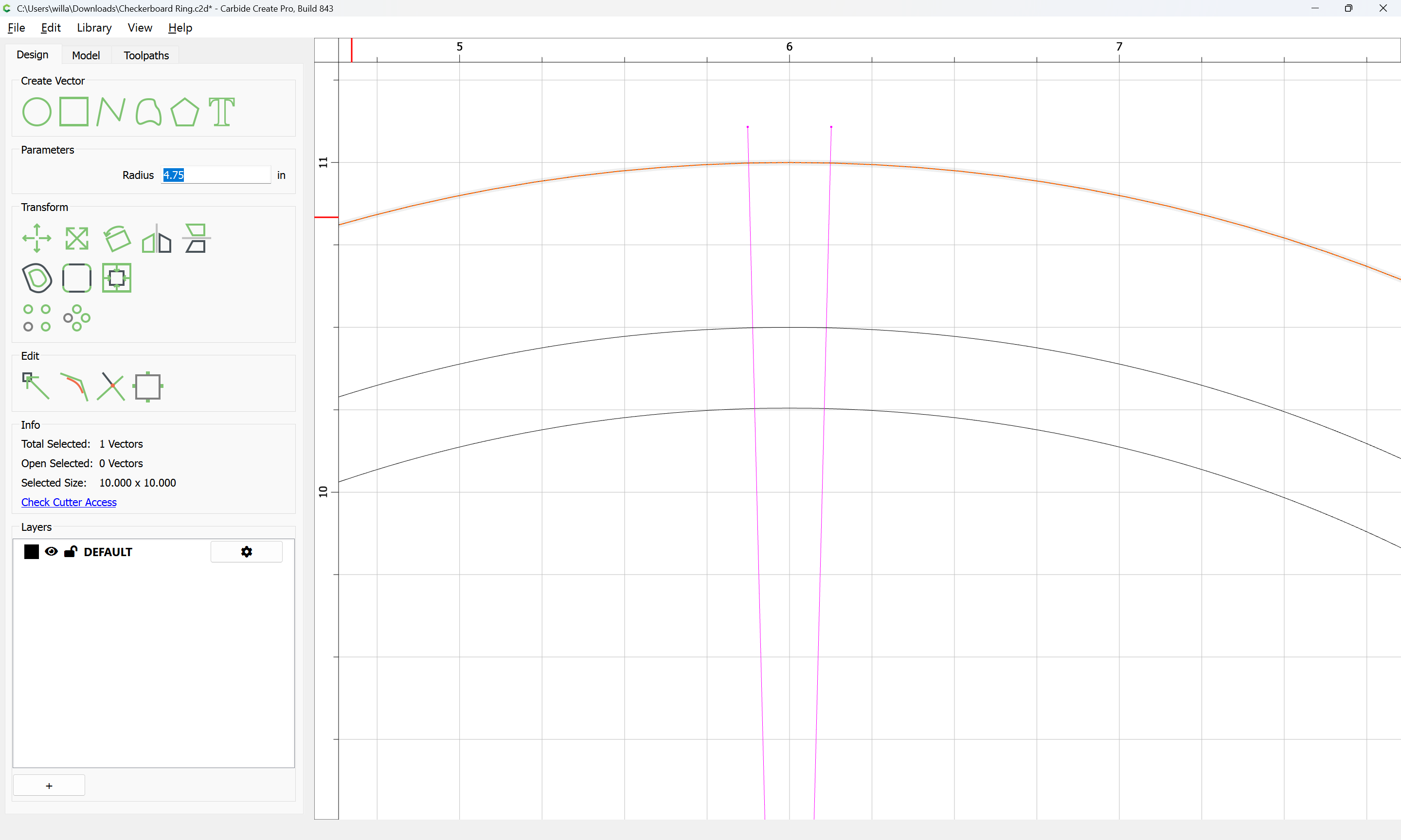

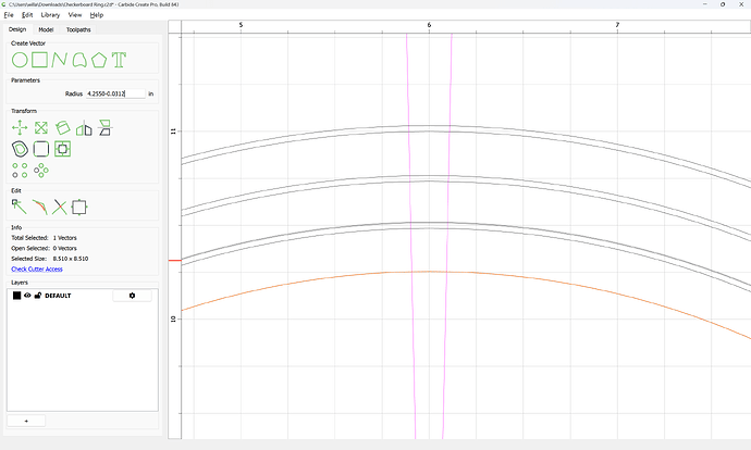

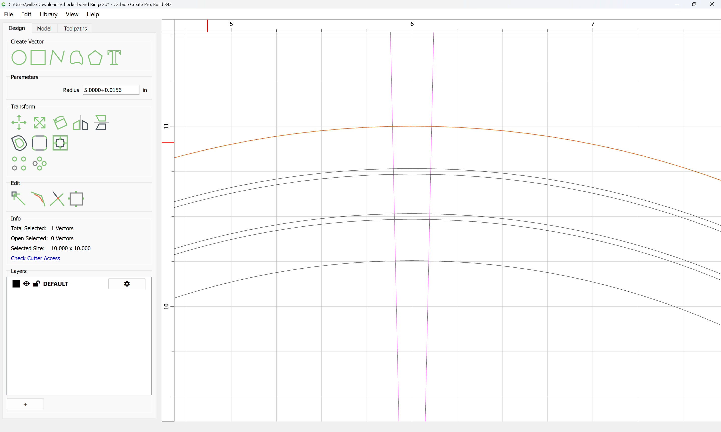

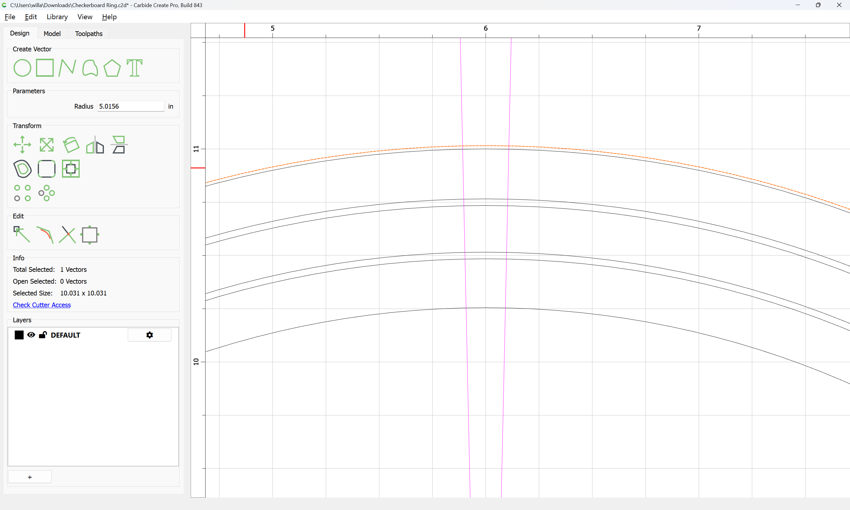

You’ll want to slightly double up the interior lines (I’m assuming you’ll want to do some sort of V carving to make the shapes, so will want closed regions):

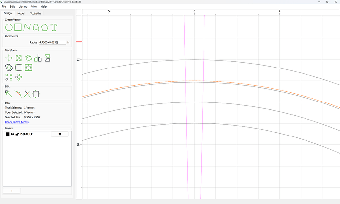

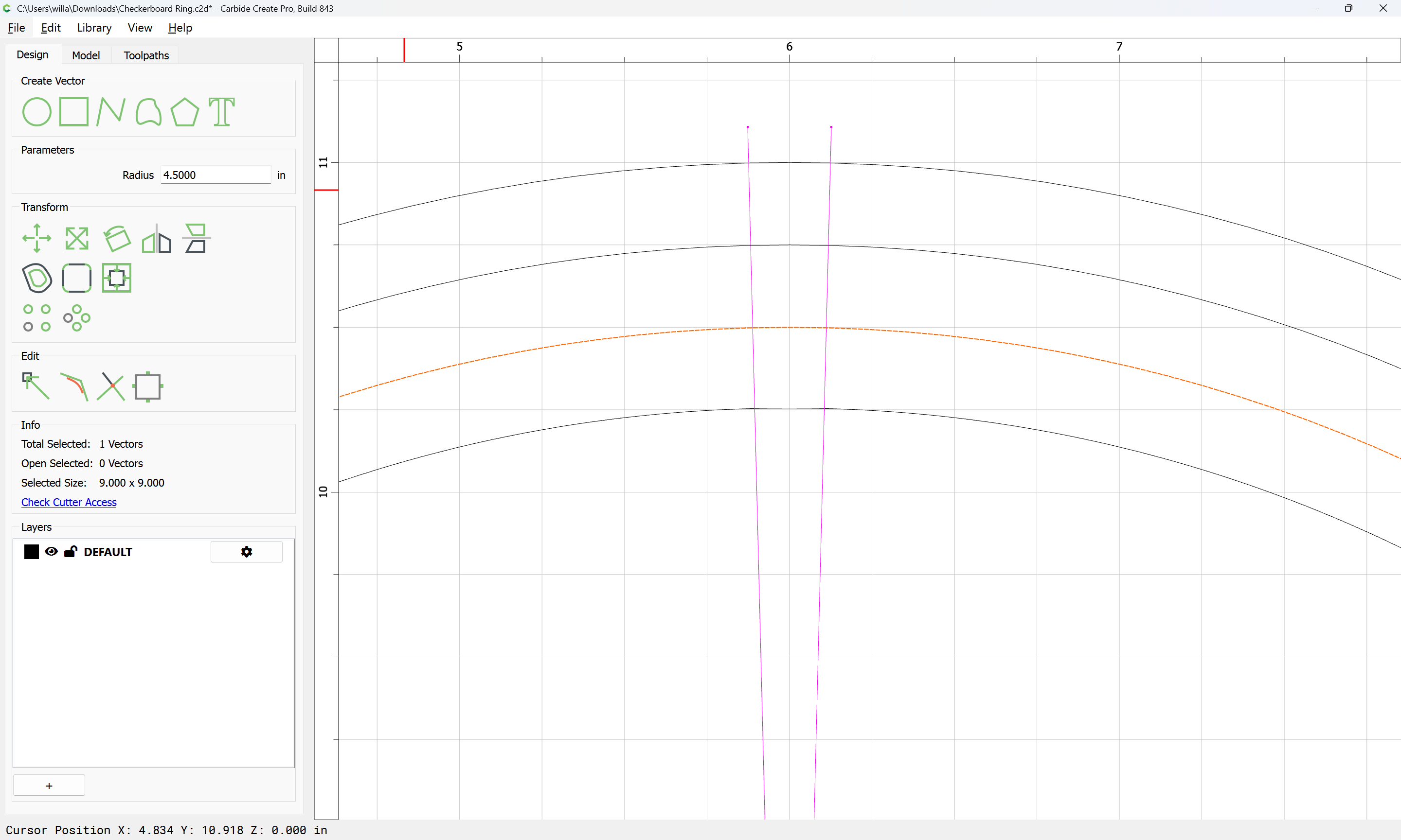

and you’ll also want to replace offset geometry w/ drawn circles…

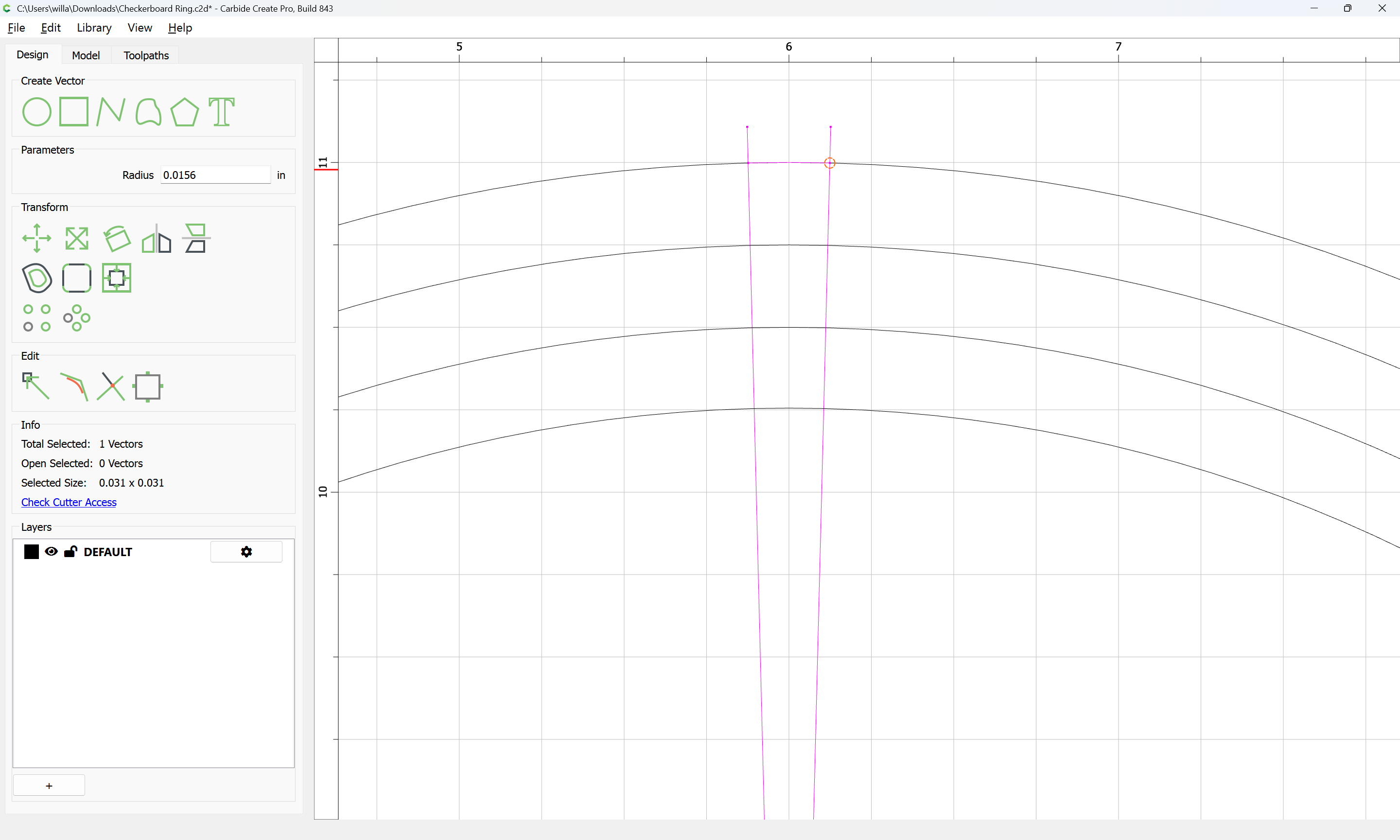

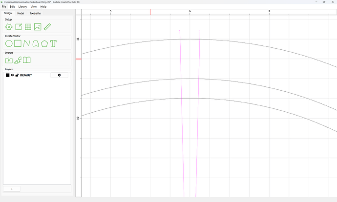

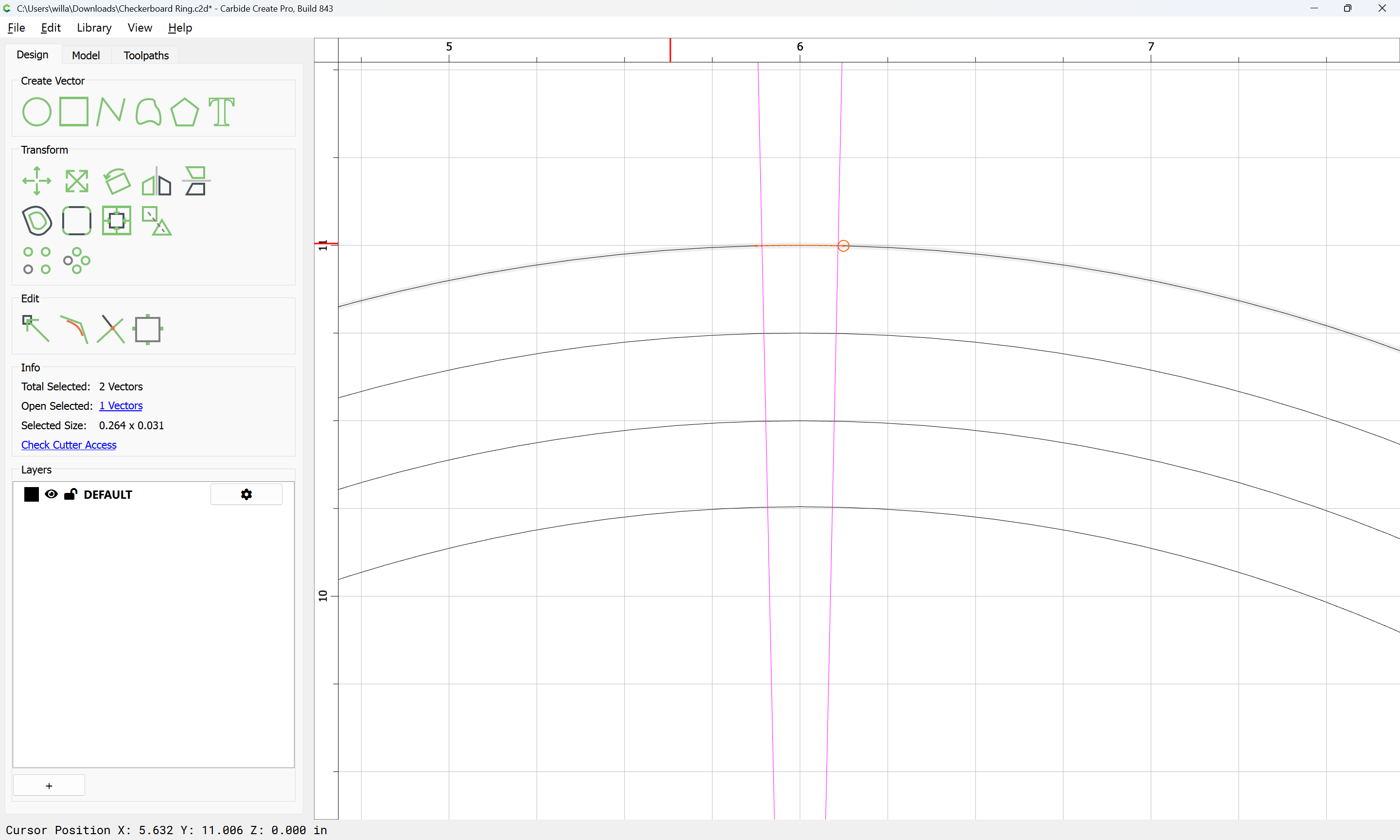

Probably the lines need to be a bit more angled — doing that can be used to set the gap:

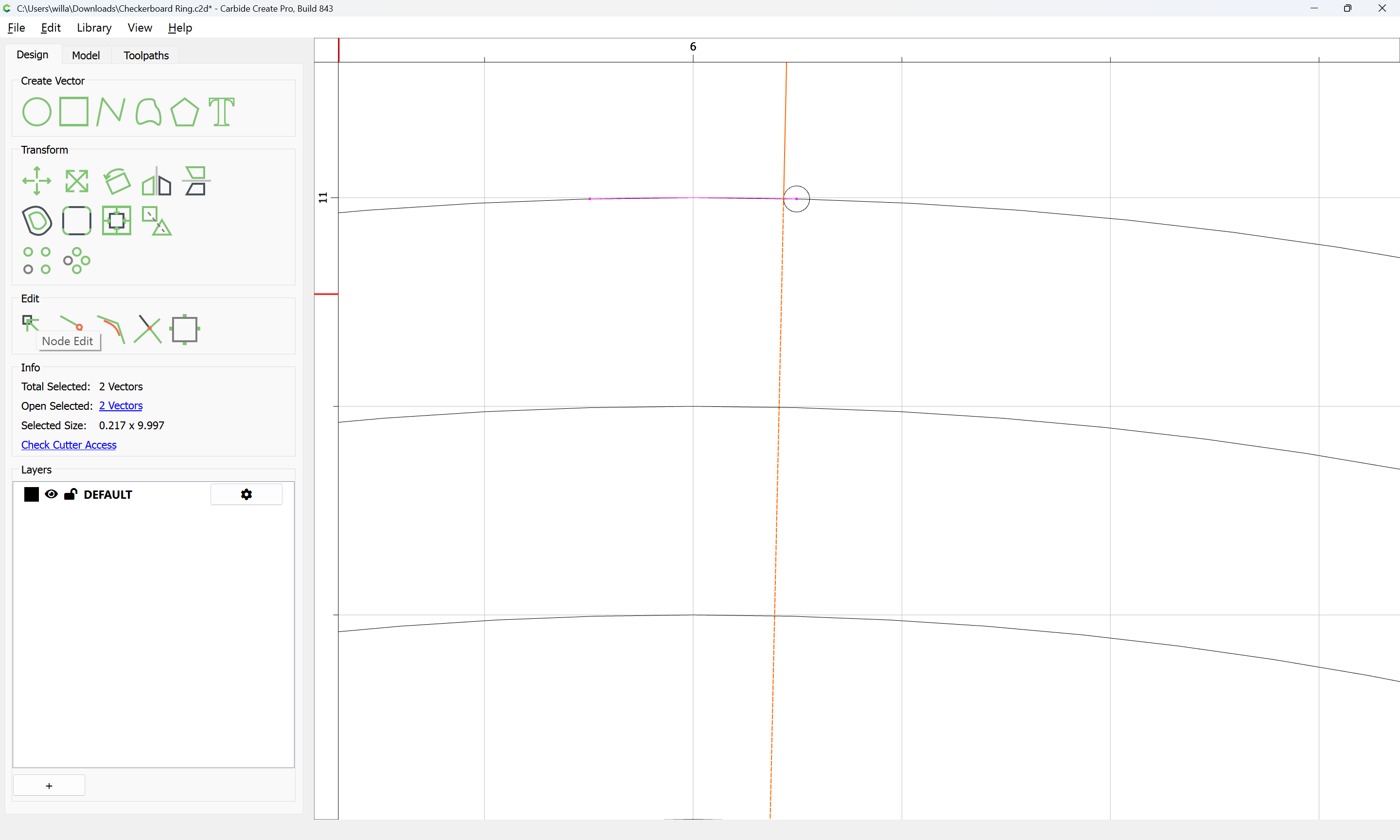

Duplicate the line and drag into registration w/ the original:

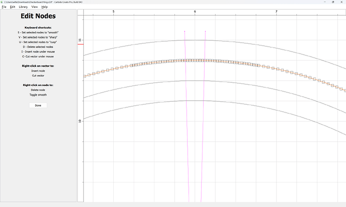

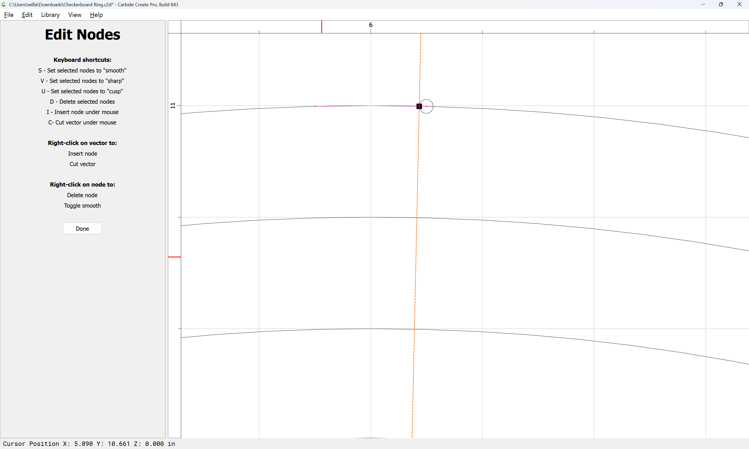

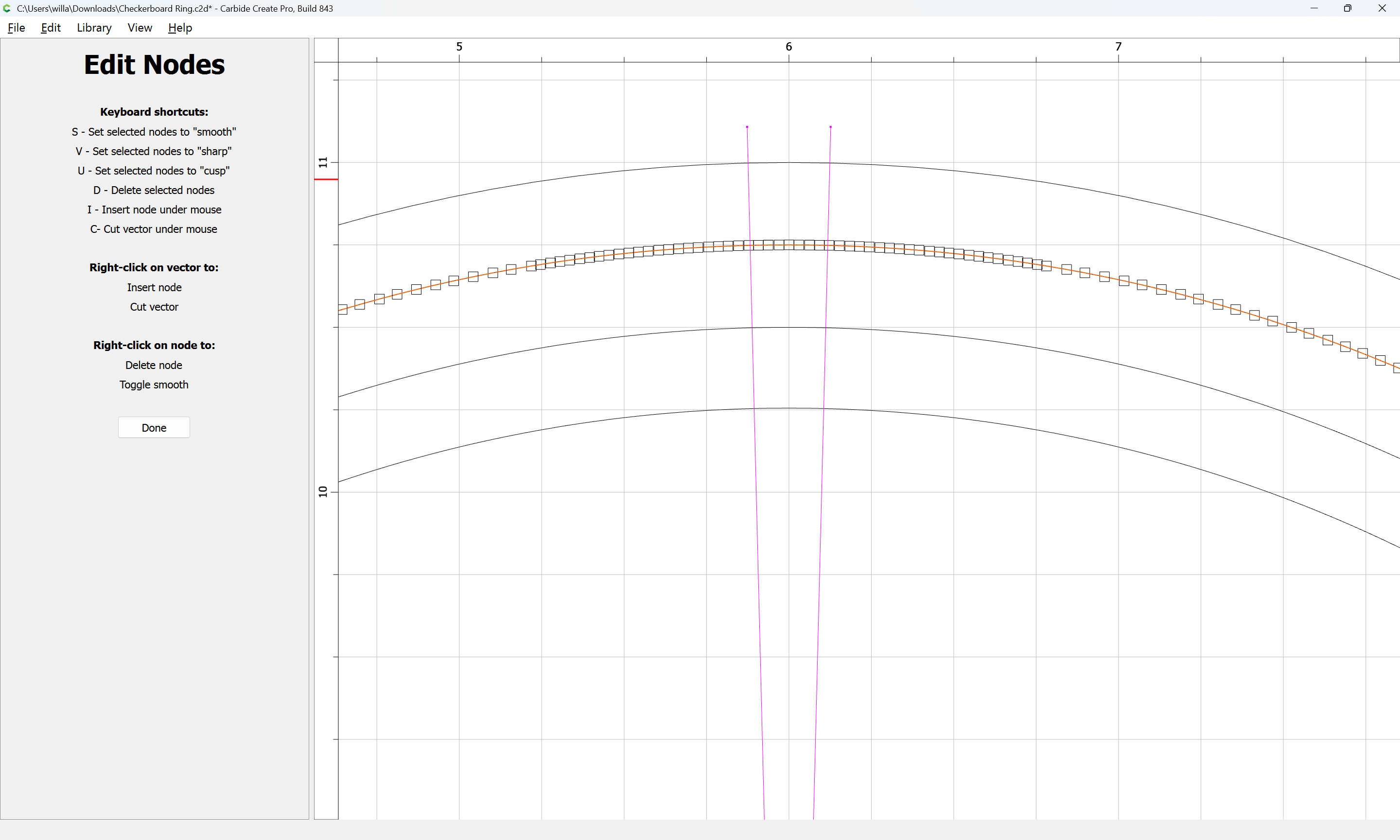

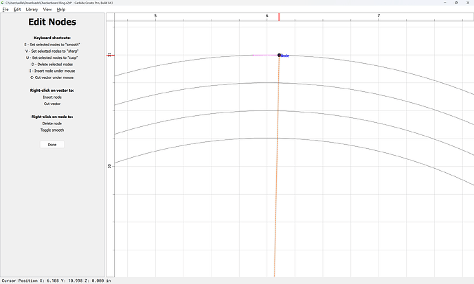

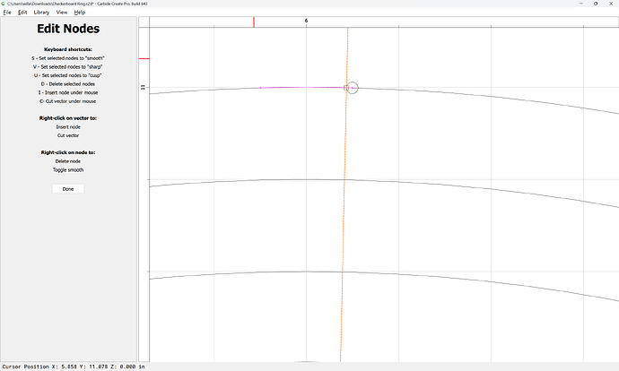

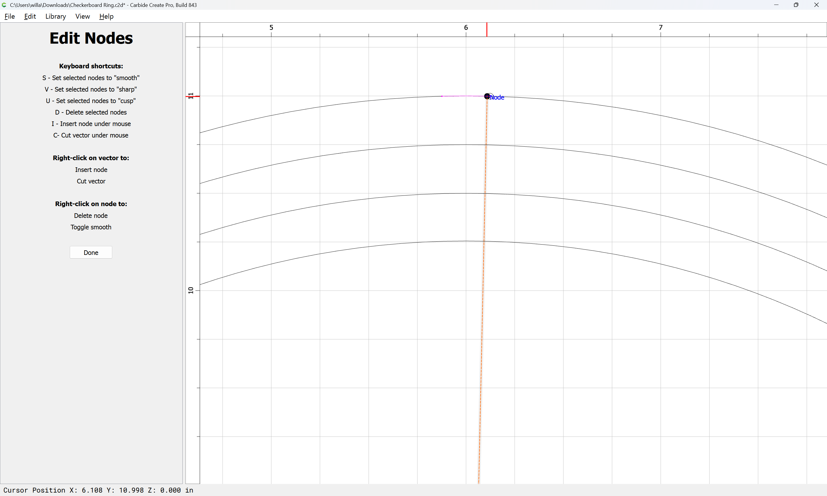

and Join Vectors:

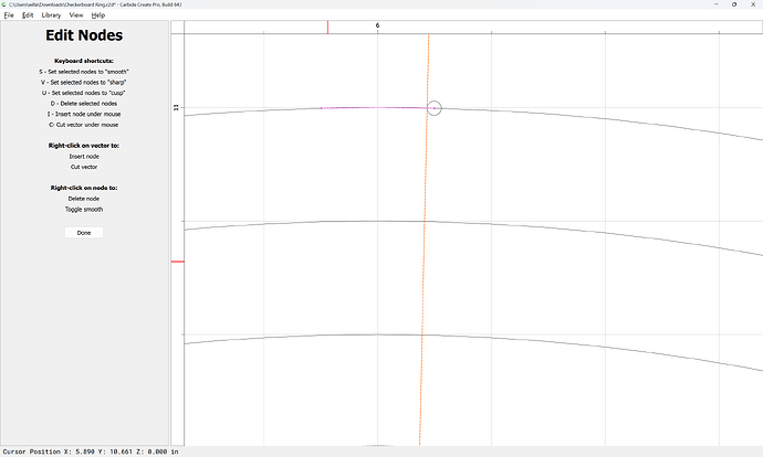

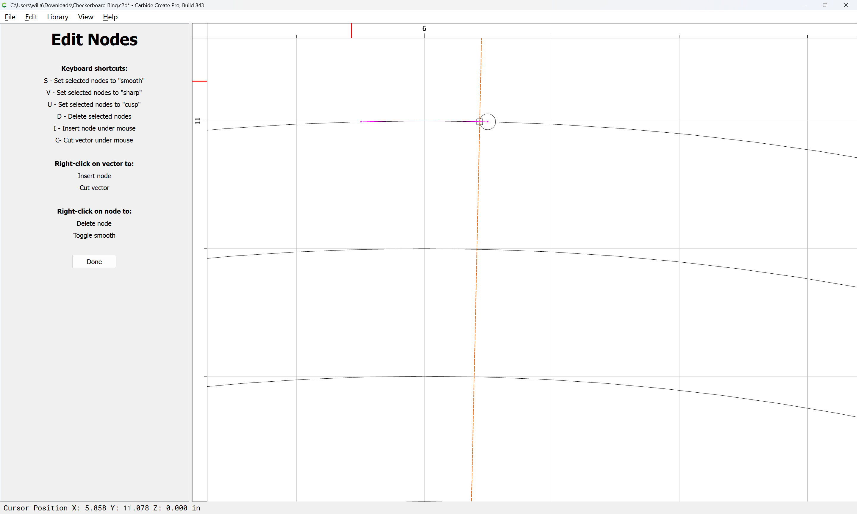

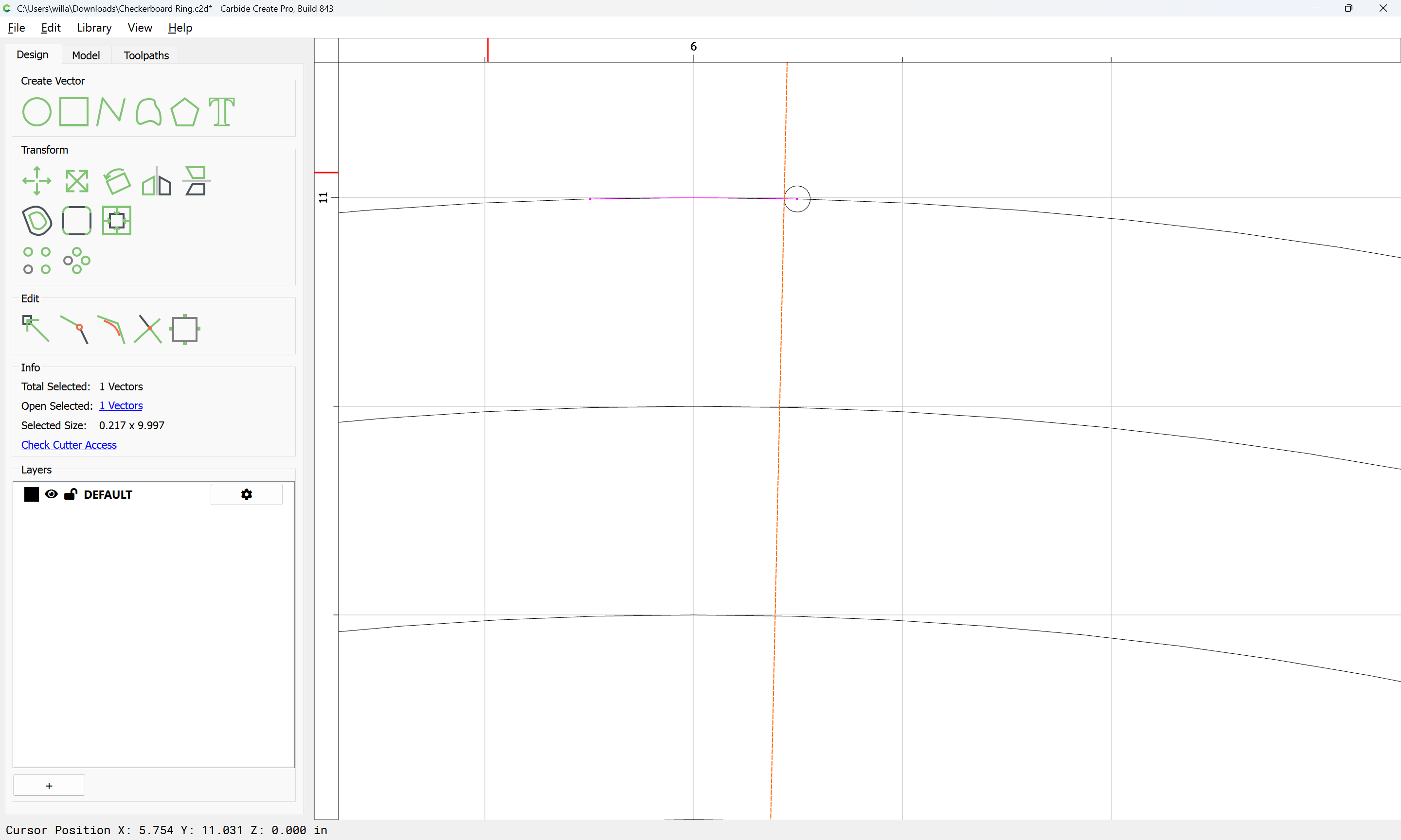

Then Node Edit to remove the extraneous node:
d
Done

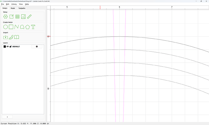

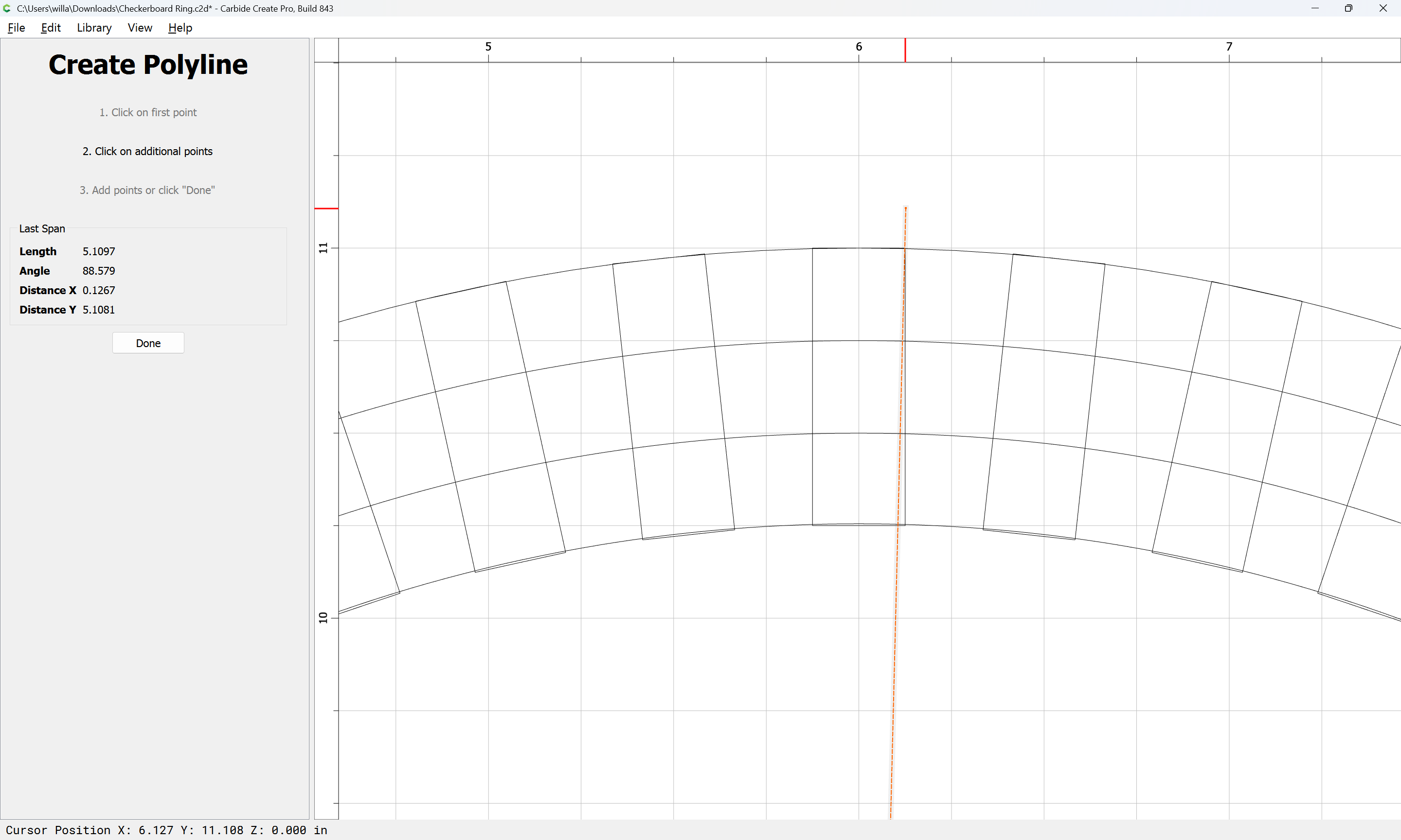

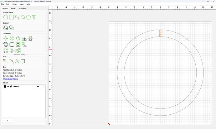

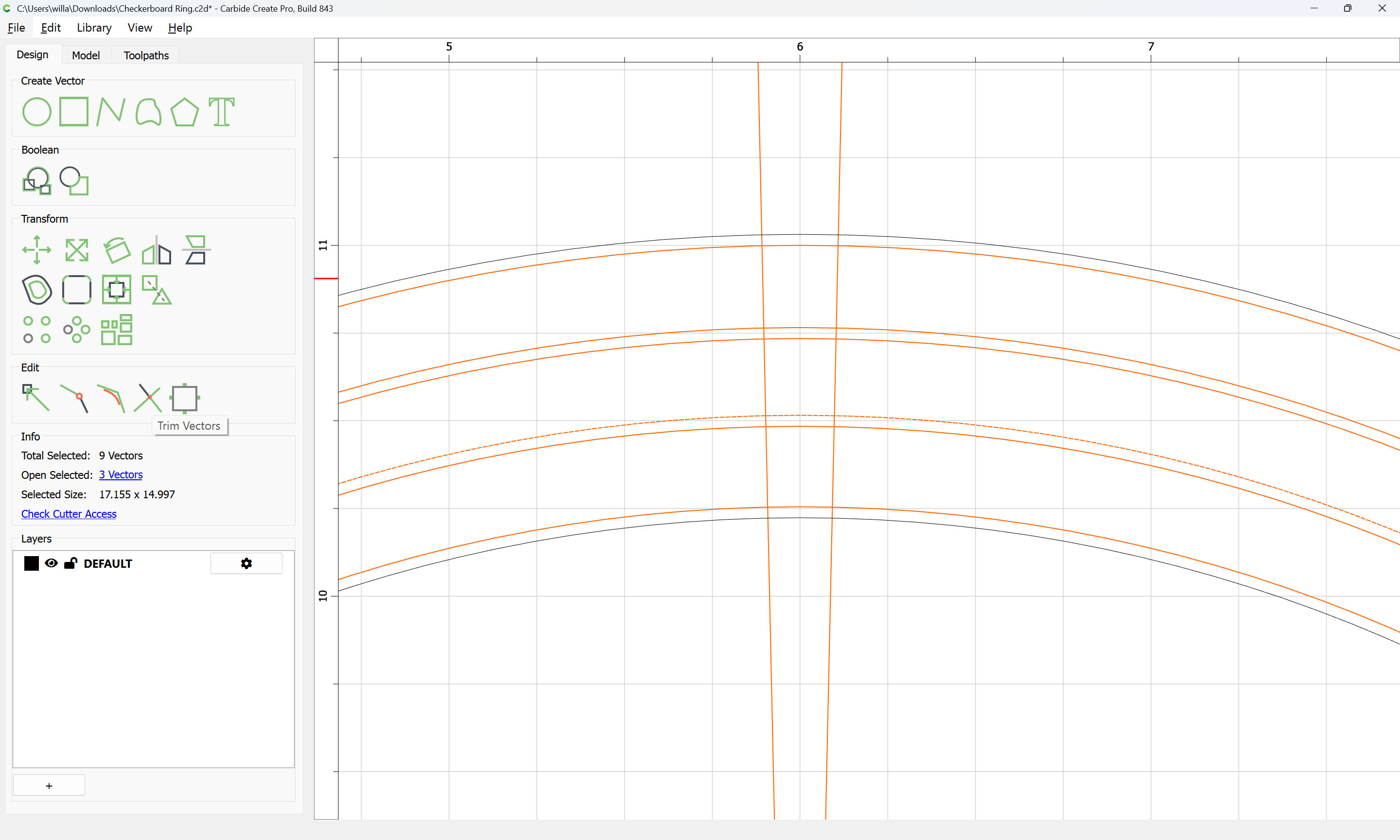

Duplicate/Delete what is not wanted as necessary:

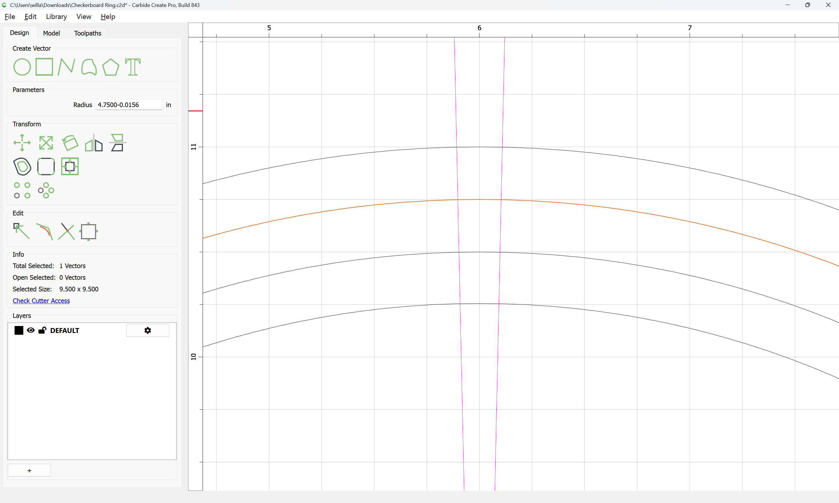

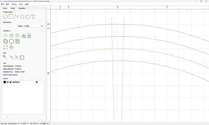

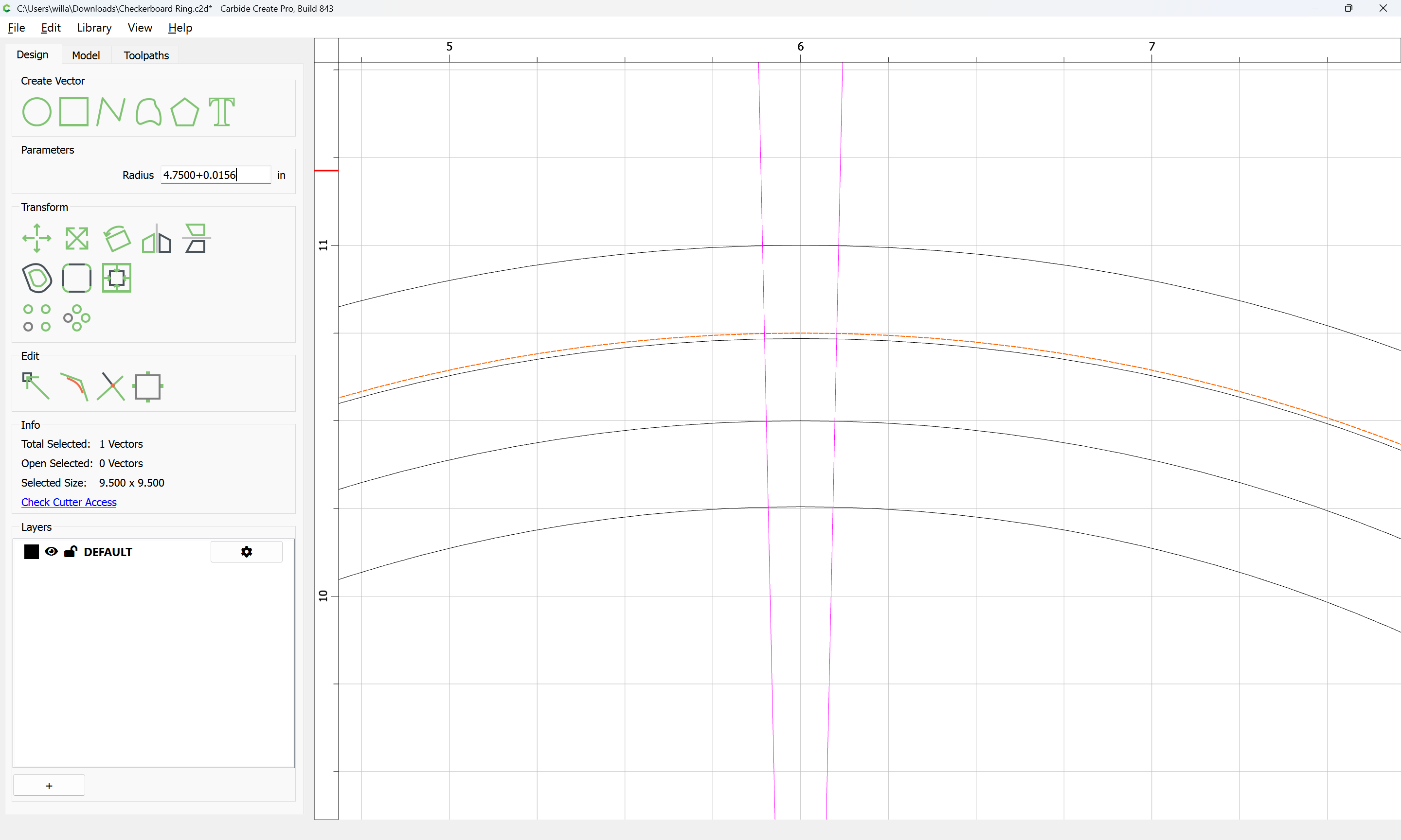

Adjust the interior lines:
and also make additional lines for the interior/exterior:
(remembering to double)

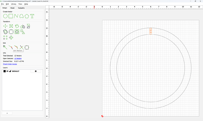

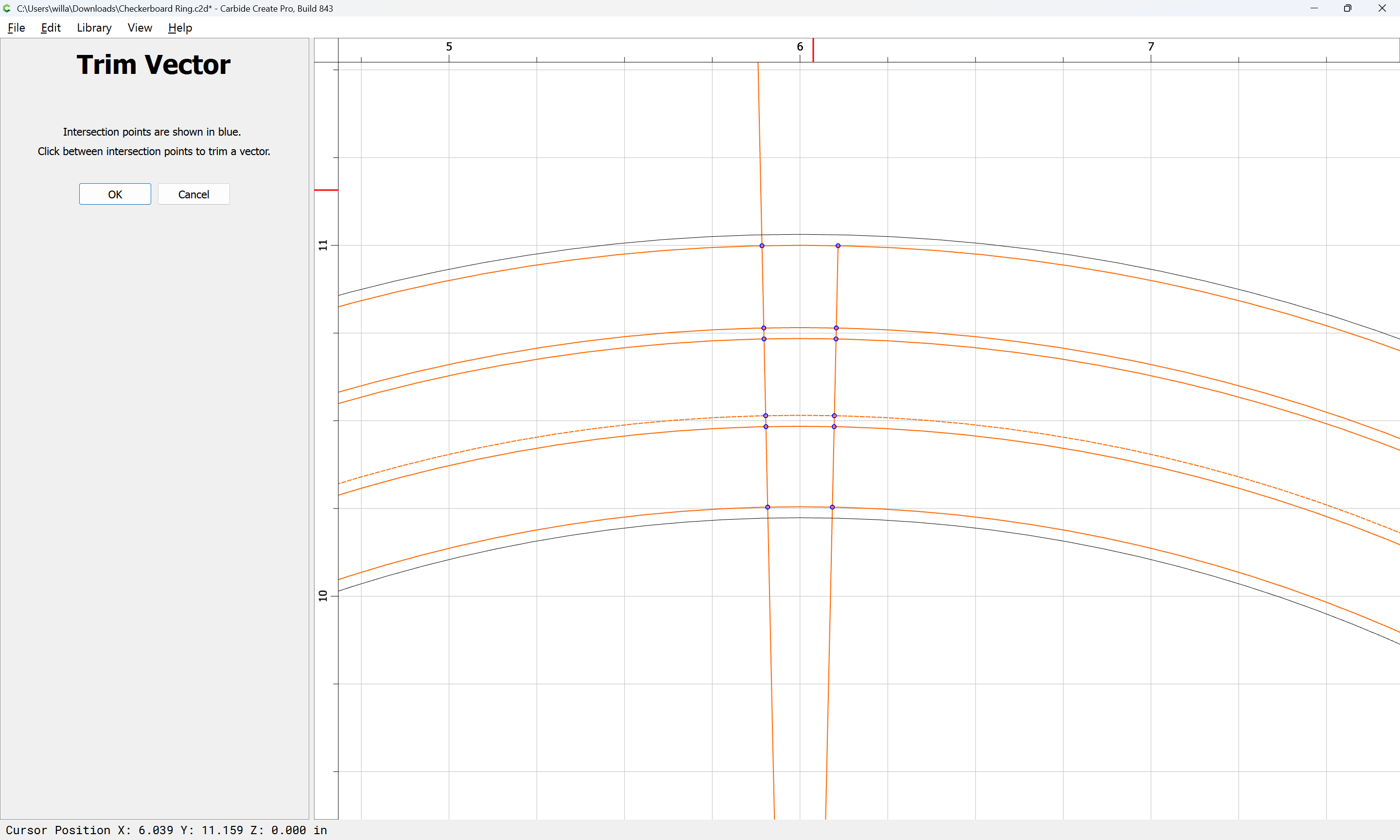

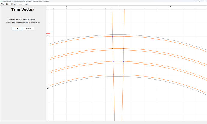

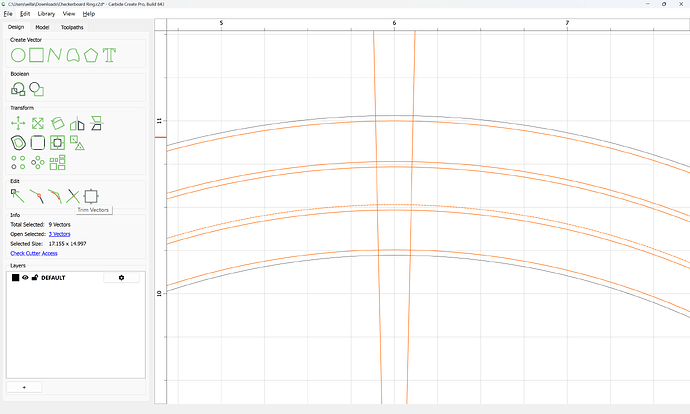

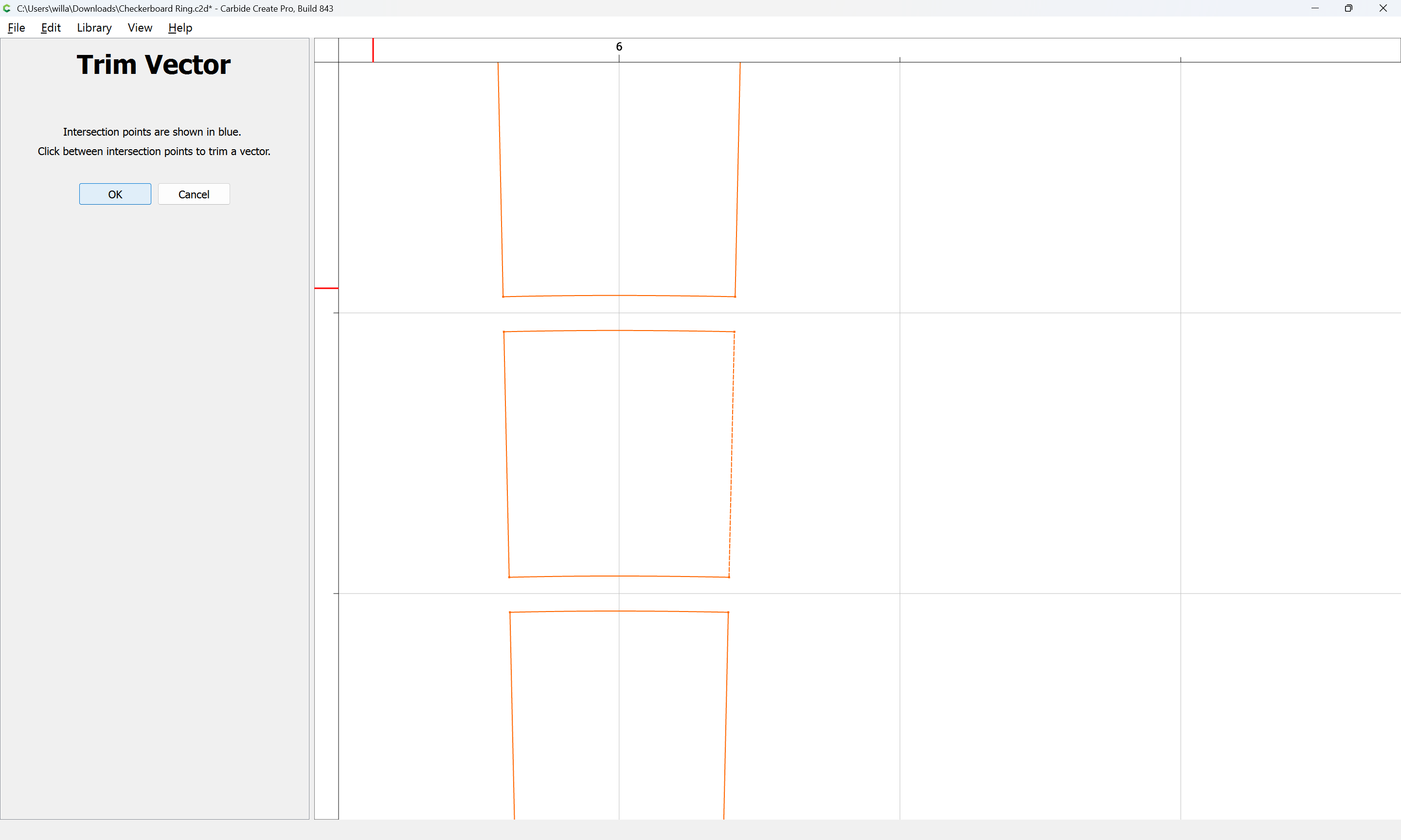

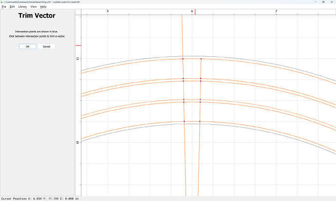

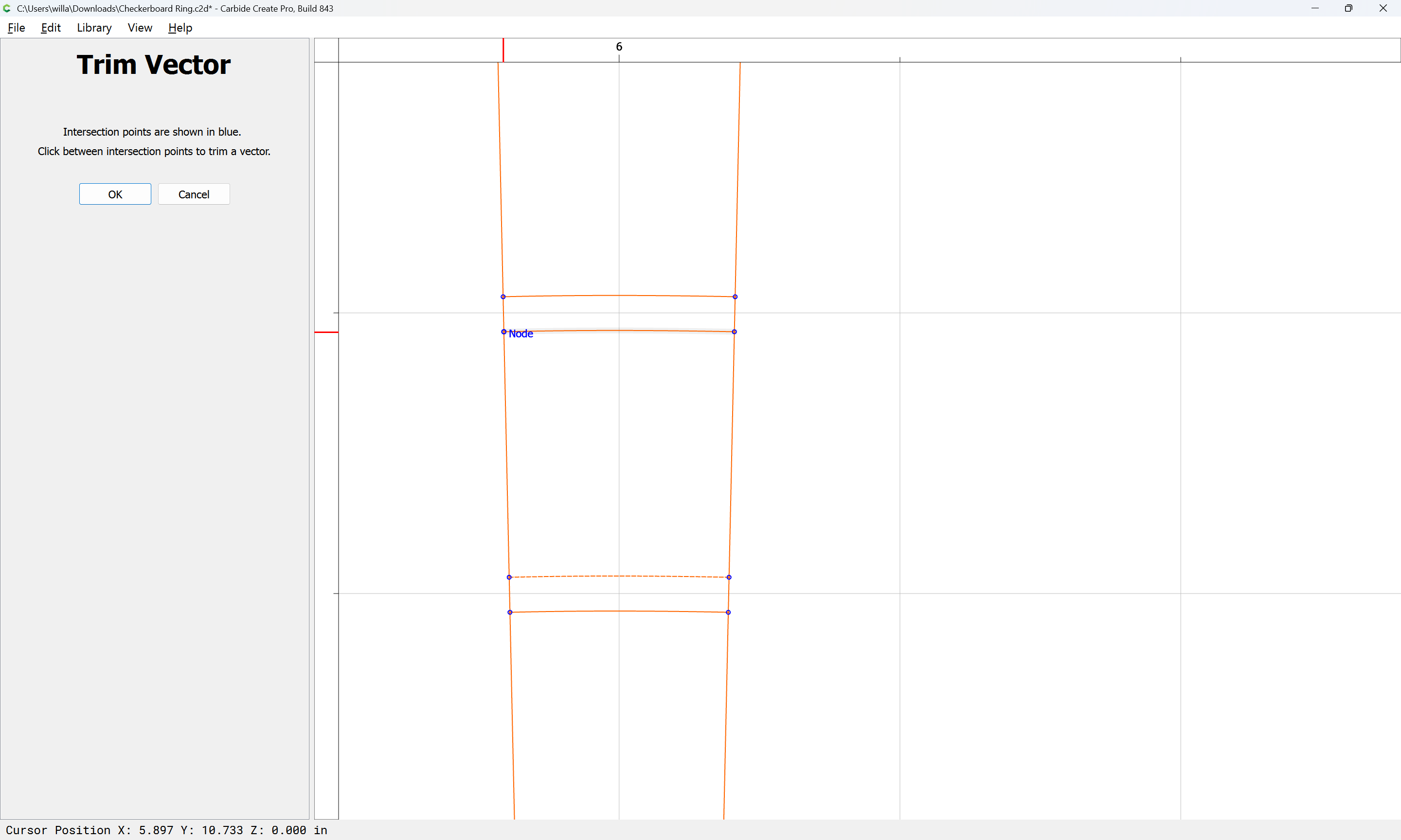

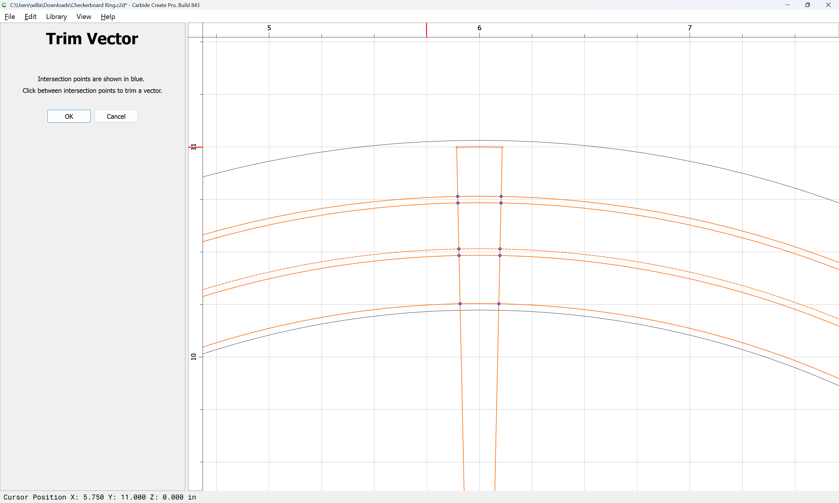

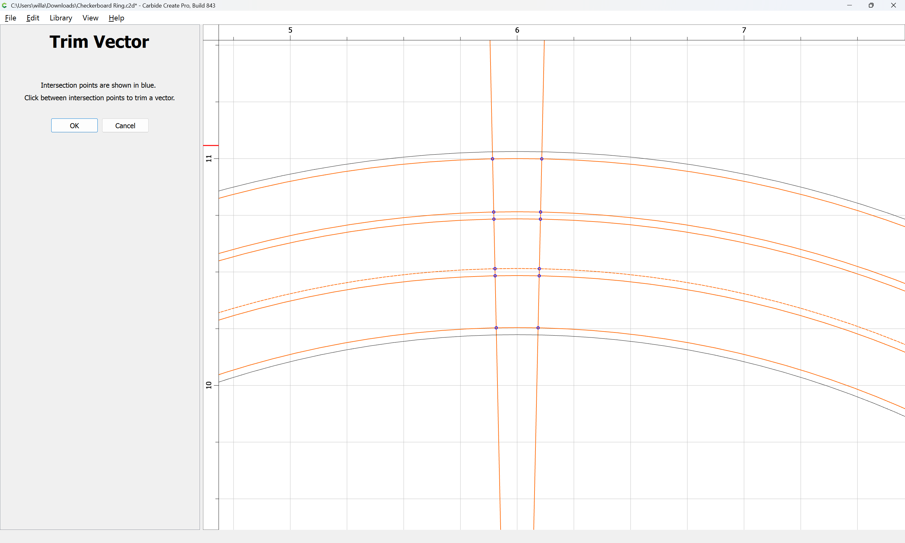

Select everything but the interior and exterior:
Trim Vectors:
Remove what is not wanted:
Until one arrives at:
OK
OK
Join Vectors
Yes

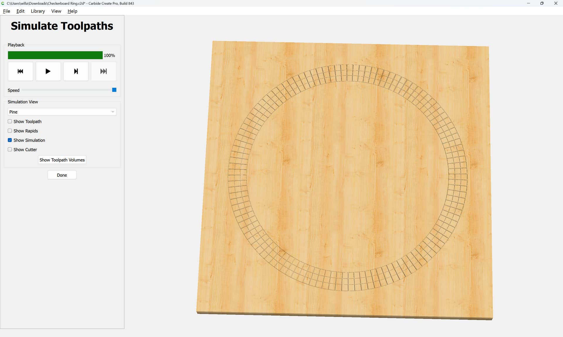

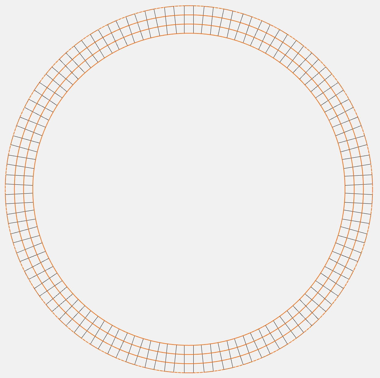

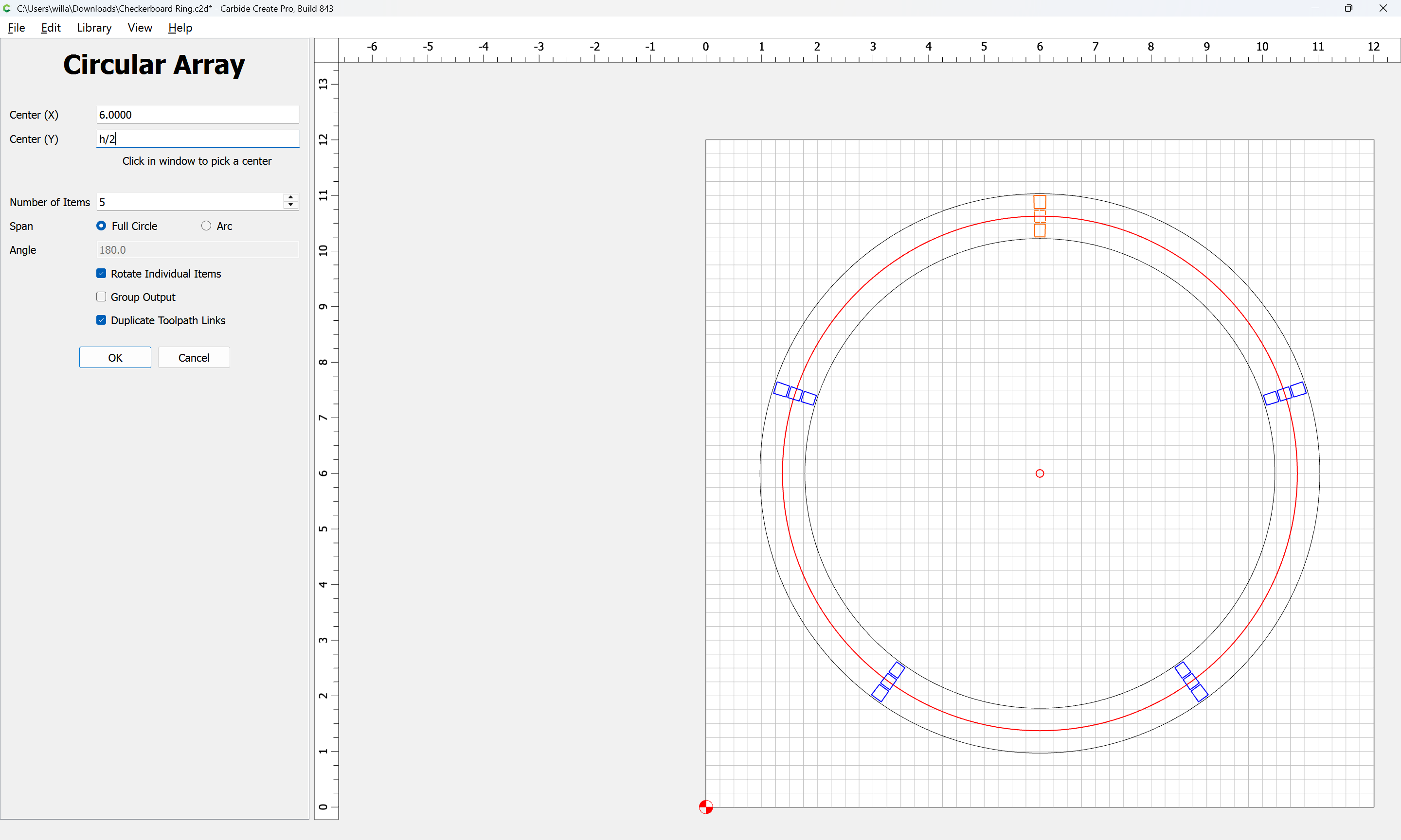

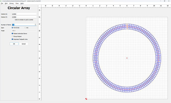

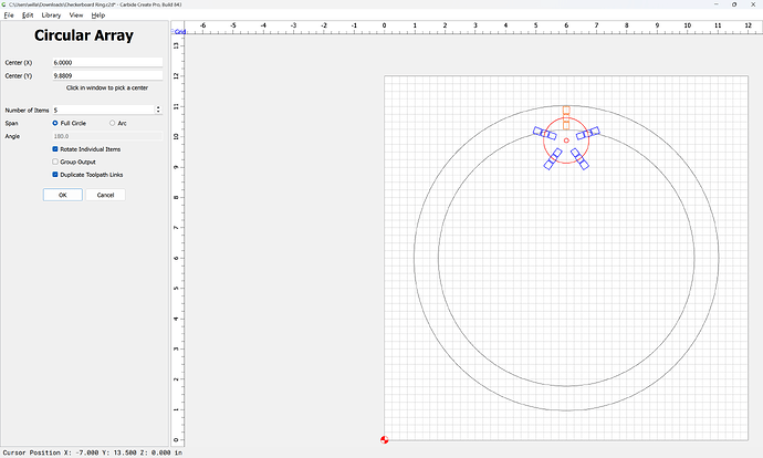

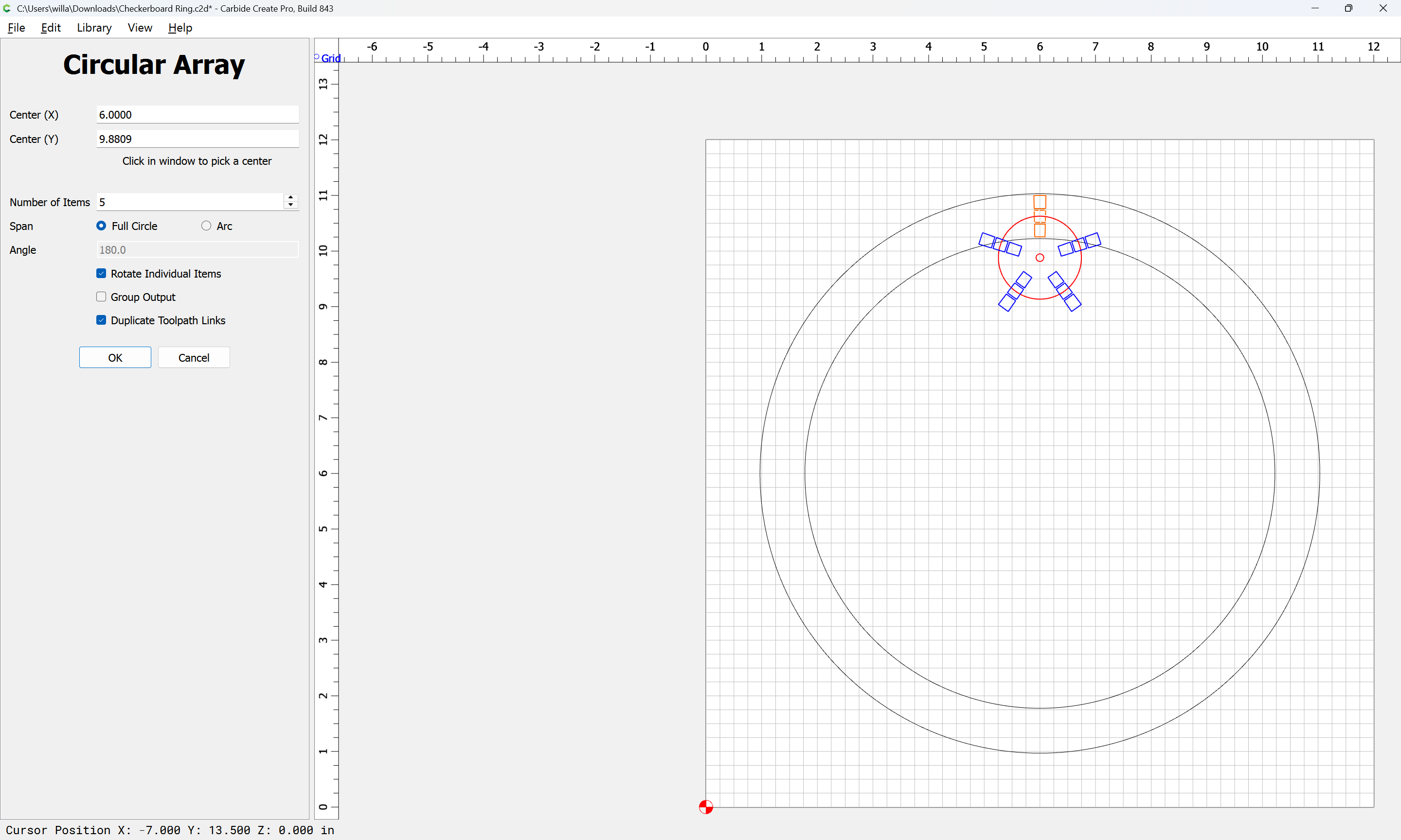

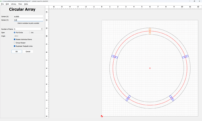

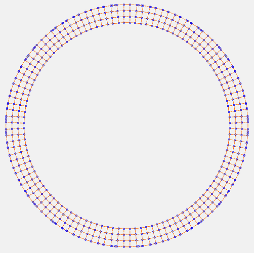

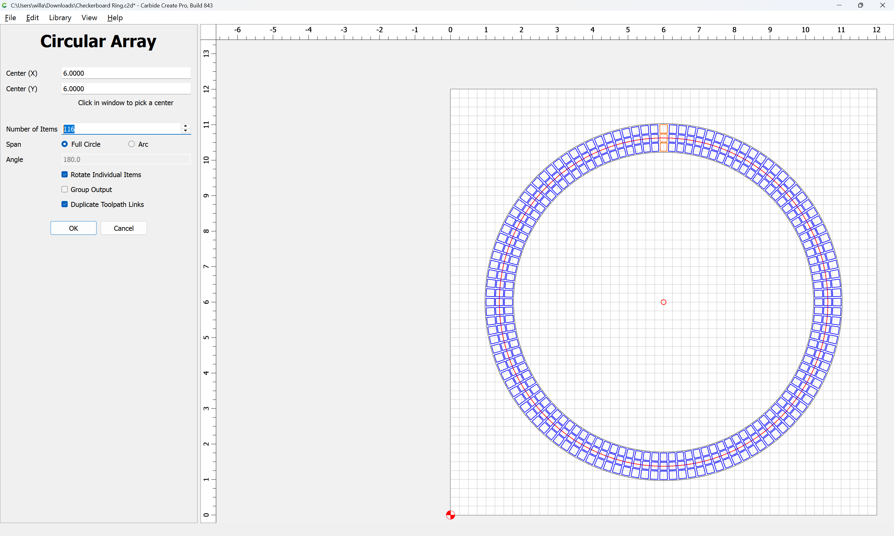

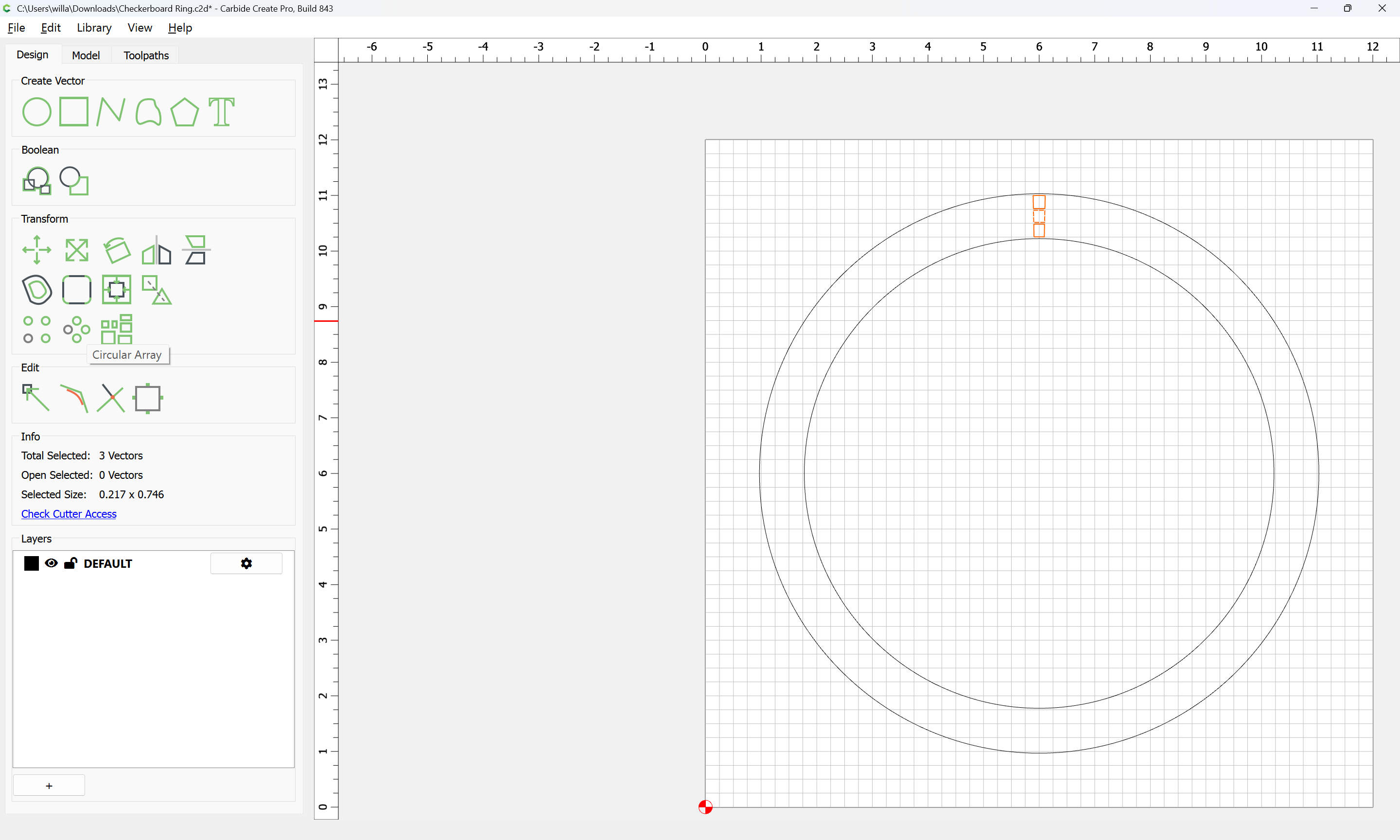

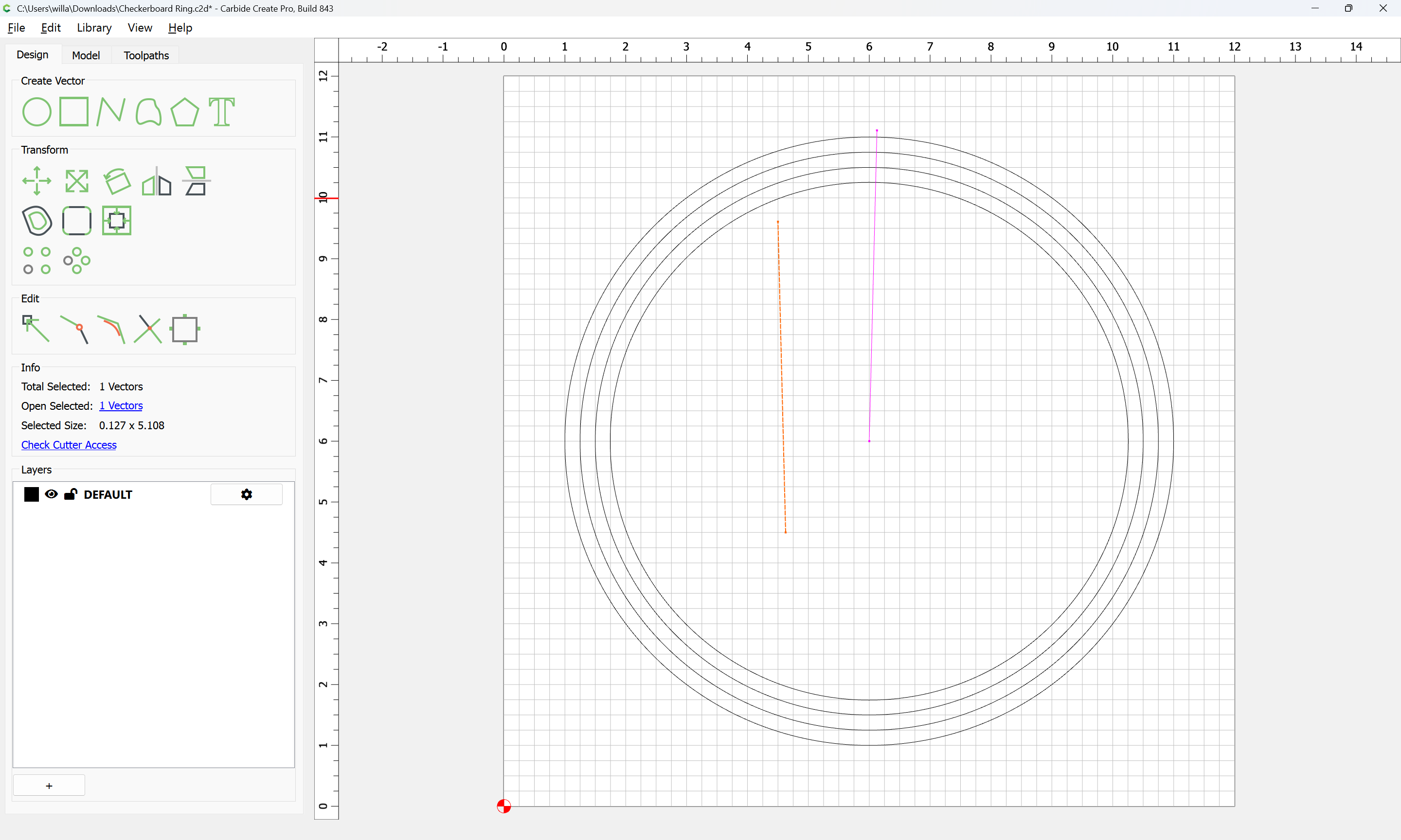

Use Circular Array:
m
to make the desired copies:

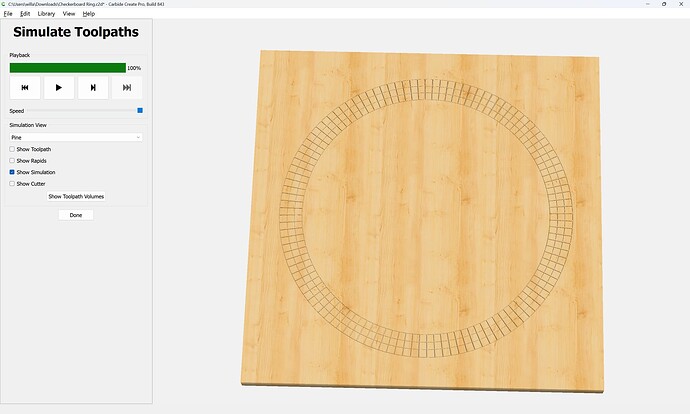

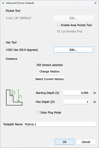

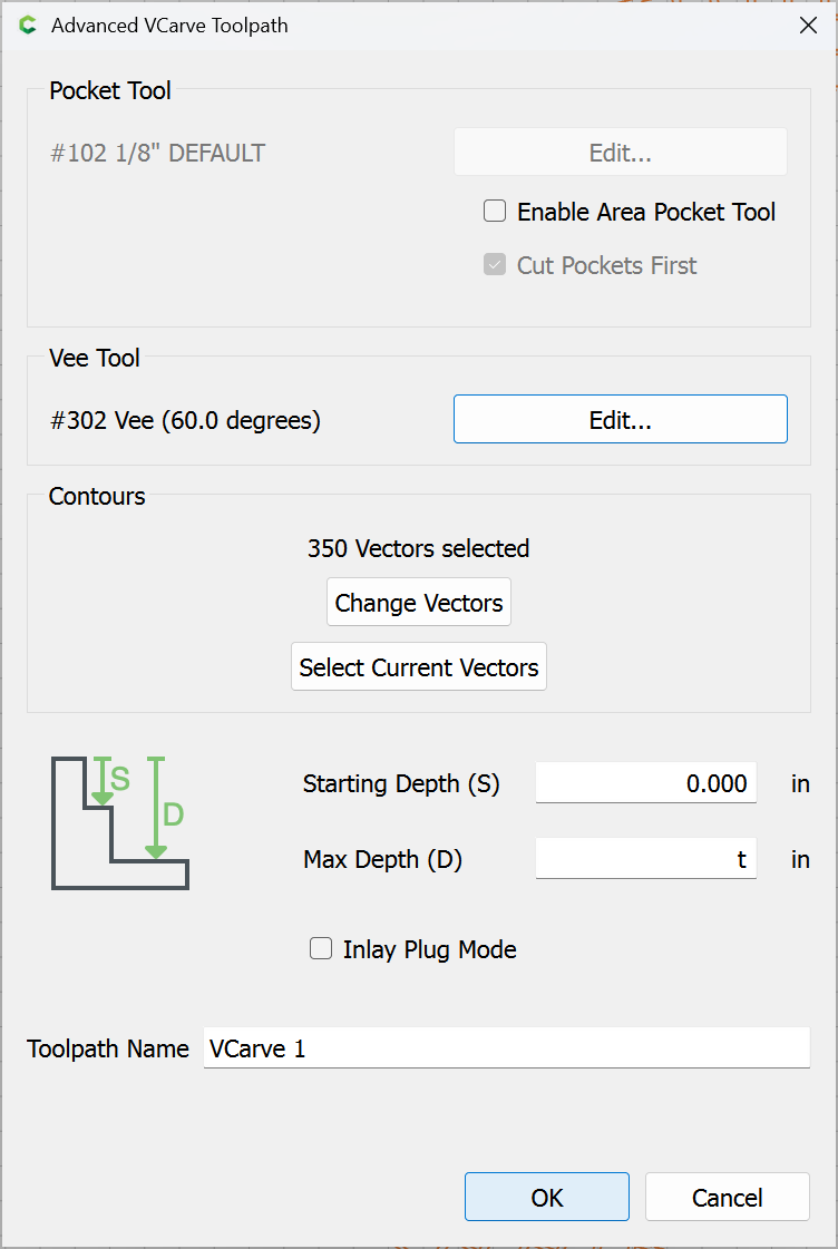

which then allows V-carving as expected:
Attached as a v8 file.
Checkerboard Ring_v8.c2d (464 KB)

The cut I was going for was slightly different than the one you created, but I used some of your techniques to accomplish it. Ended up being much quicker and precise than my previous approach. Thank you again for all of your help with this.
