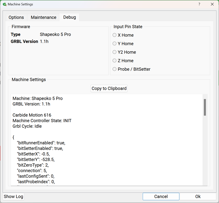

For the BitSetter, check it by powering up, connecting, then going to Settings | Debug and checking to see if it lights/indicates as expected when the button is pushed.
Note that the BitSetter and BitZero share the same probe input, so make sure that the ground lead isn’t touching the BitZero causing a false positive.

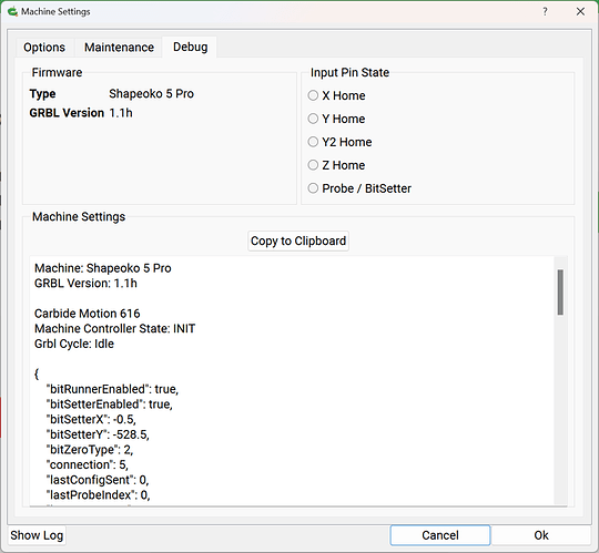

Power on the machine and connect but do not initialize. Go to the debug and you can test each sensor on the machine and see if they change state. Each homing switch, BitSetter, BitZero are all testable and you will see the state change. If the state does not change check connections first. The BitSetter and BitZero are interconnected. Make sure the magnet/clip on the BitZero is not grounded because if it is the BitSetter will malfunction.
If the BitSetter signal is not received the system will eventually time out. In the mean time the stepper motor will try to keep driving the Z down. Same for all the homing switches. If they do not activate they will time out and you get a homing error.
isn’t turning red when depressed. How do I move the Gantry in Debug. The Input Pin State radio buttons don’t appear to be clickable.

You cannot move the gantry from the debug screen, only from the Jog screen when connected to Carbide Motion. The radio buttons are just indicators as to the state of the switches they monitor.
Debug doesn’t allow for motion.
The Input Pin widgets are State indicators not pressable buttons.

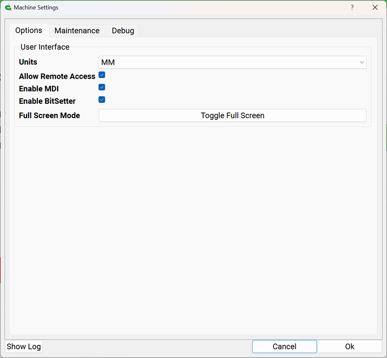

If you want to test the rest of the machine you can disable the bit setter in carbide motion.

I have disabled the bitsetter because I was attempting to manually move the spindle over the bitsetter to test the table squareness. My bit doesn’t fully center on the plunger.

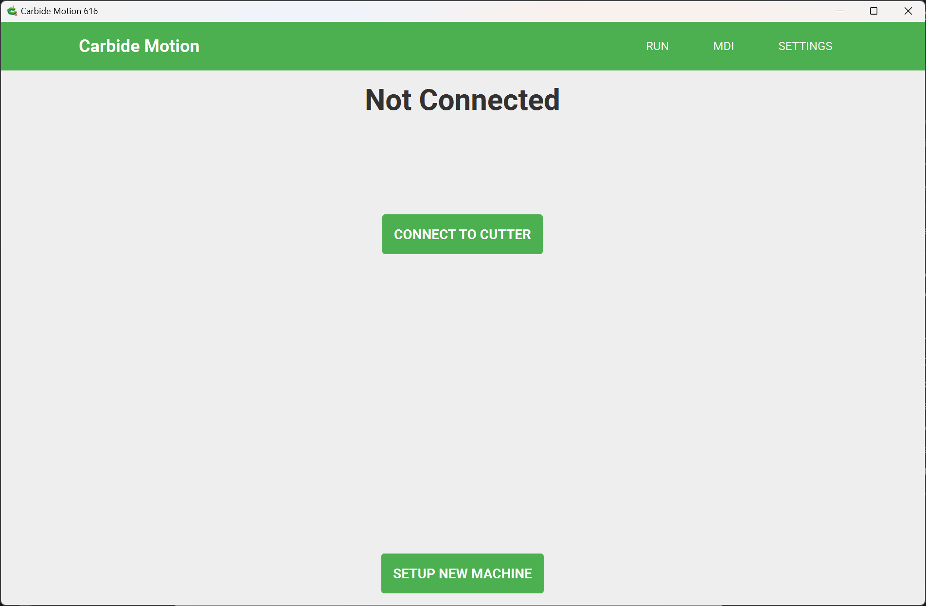

I will grab screenshots if this forum allows them. I’m only seeing “Run” and “Settings” in the upper right-hand corner of Carbide Motion. I’m going to order the switch you mentioned, even if it doesn’t turn out the be the issue, at this price, it’ll be good to have it on hand.
click on “Debug”
