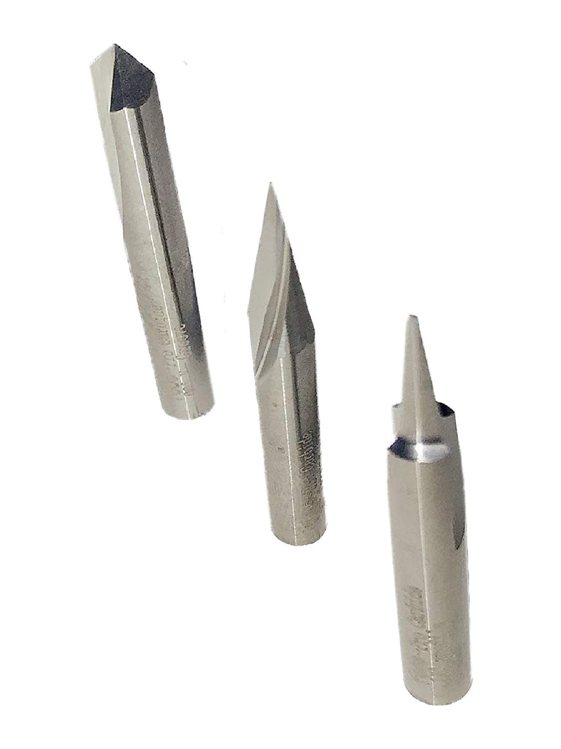

The customer has a ‘less is more’ mindset on these. Think subtle beauty. Her logo on the inside is shallow and not filled or painted. The outer engraving is also shallow (0.025") and both are done with a very small engraving bit. These are not 0.5" deep V-Carves. The bits I use are less than $20 on Amazon. Sometimes I have to fatten up the lettering in Carbide Create (offset command). I also provide one photo stand with each box. See attached pic.
I will provide all the digital files I have: Fusion 360 parametric drawing, Carbide Create file for photo stand, Carbide Create file to do the rabbet on the lid with the CNC, engraving examples and bits I use.

I wish I had the talent you do. Tell us more about these small (cheap?) bits you like!
Sure! I’ve had success with the bits below. They are not in the standard bit library in CC so you’ll have to add those but that is easy enough. For engravings I do a pocket tool path at a depth of 0.025 inch. Then I spray it with flat black spray paint, sand off the overspray and finish with a coupe coats of spray lacquer. Hope this helps!
