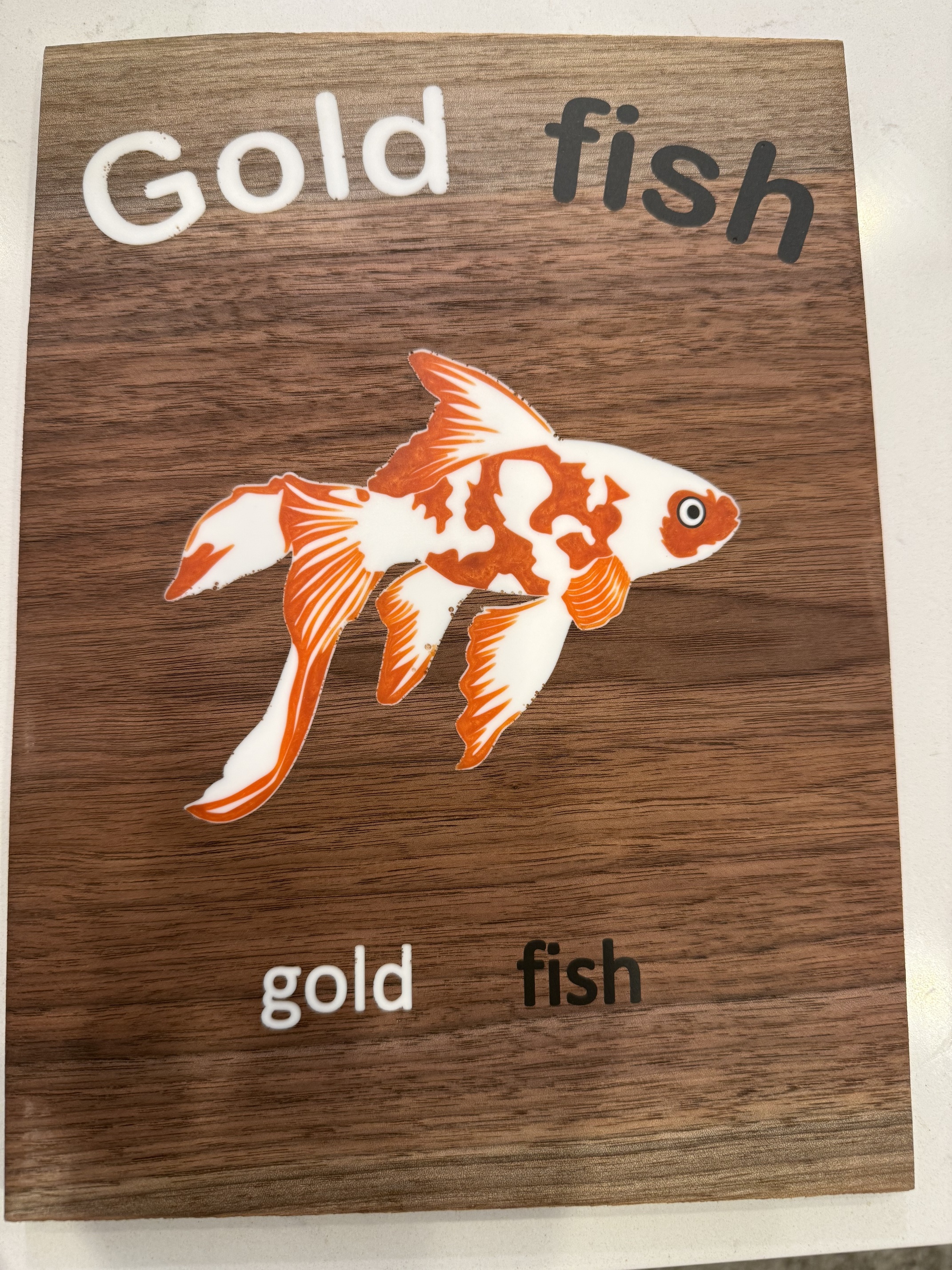

This is my first time dipping my toes into the epoxy world. I have done a few practice pieces on plywood that turned out good and then I did a practice piece on walnut which will be the wood for this project. But I got a lot of micro bubbles around the edges in the white (and not any other colors). Looking for advice on what might be the root cause so I can fix in on the final project.
Other useful info:
-I sealed all the engraving with spray varnish so I am not getting any bleeding.
-Using table top epoxy.
-I used a heat gun to pop visible bubbles. (the bubbles in the pics are appeared after surfacing and sanding.
-waited 24 hours after each pour to do a different color (white was the first color poured.)
Thanks in advance for your help

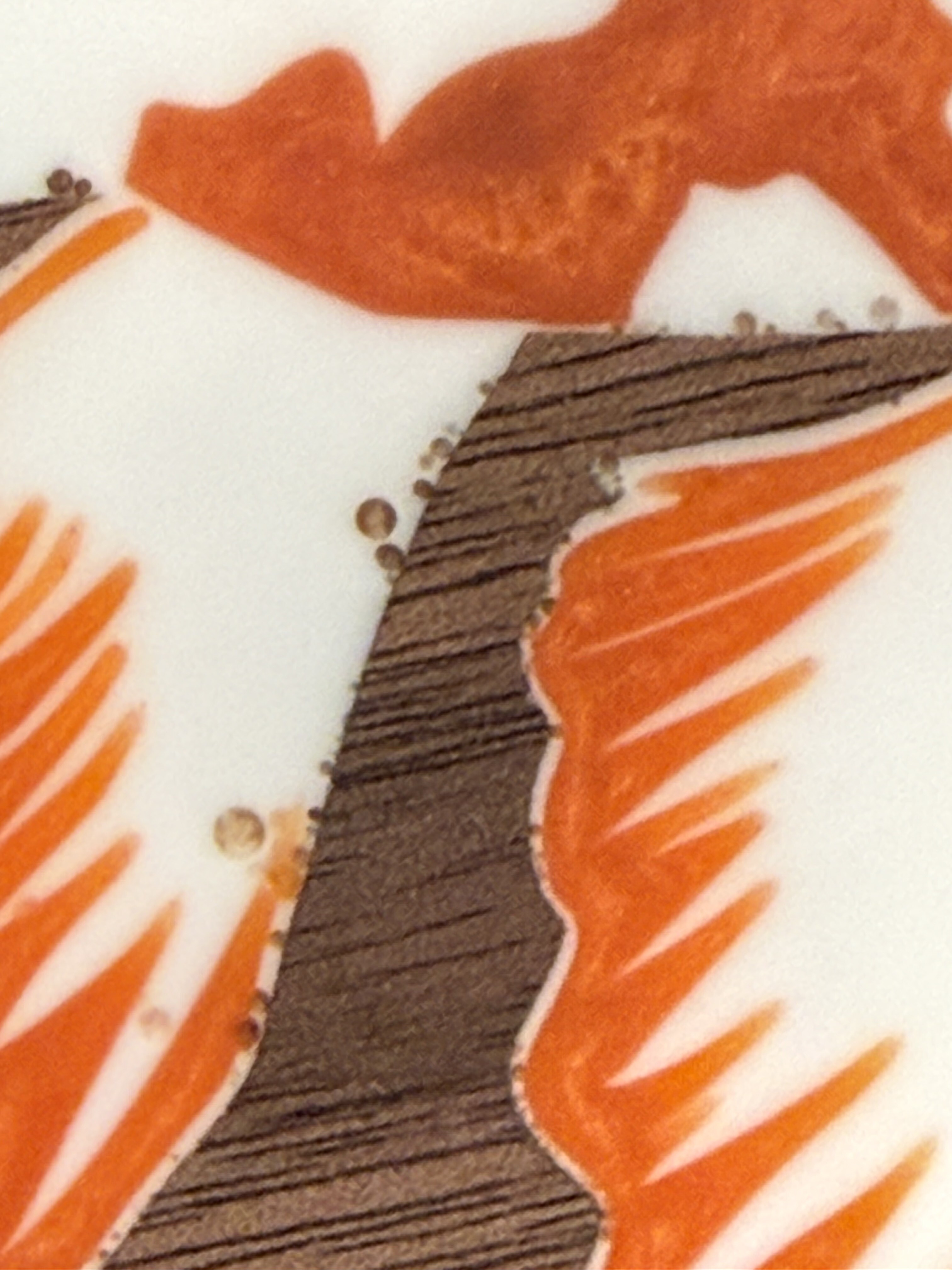

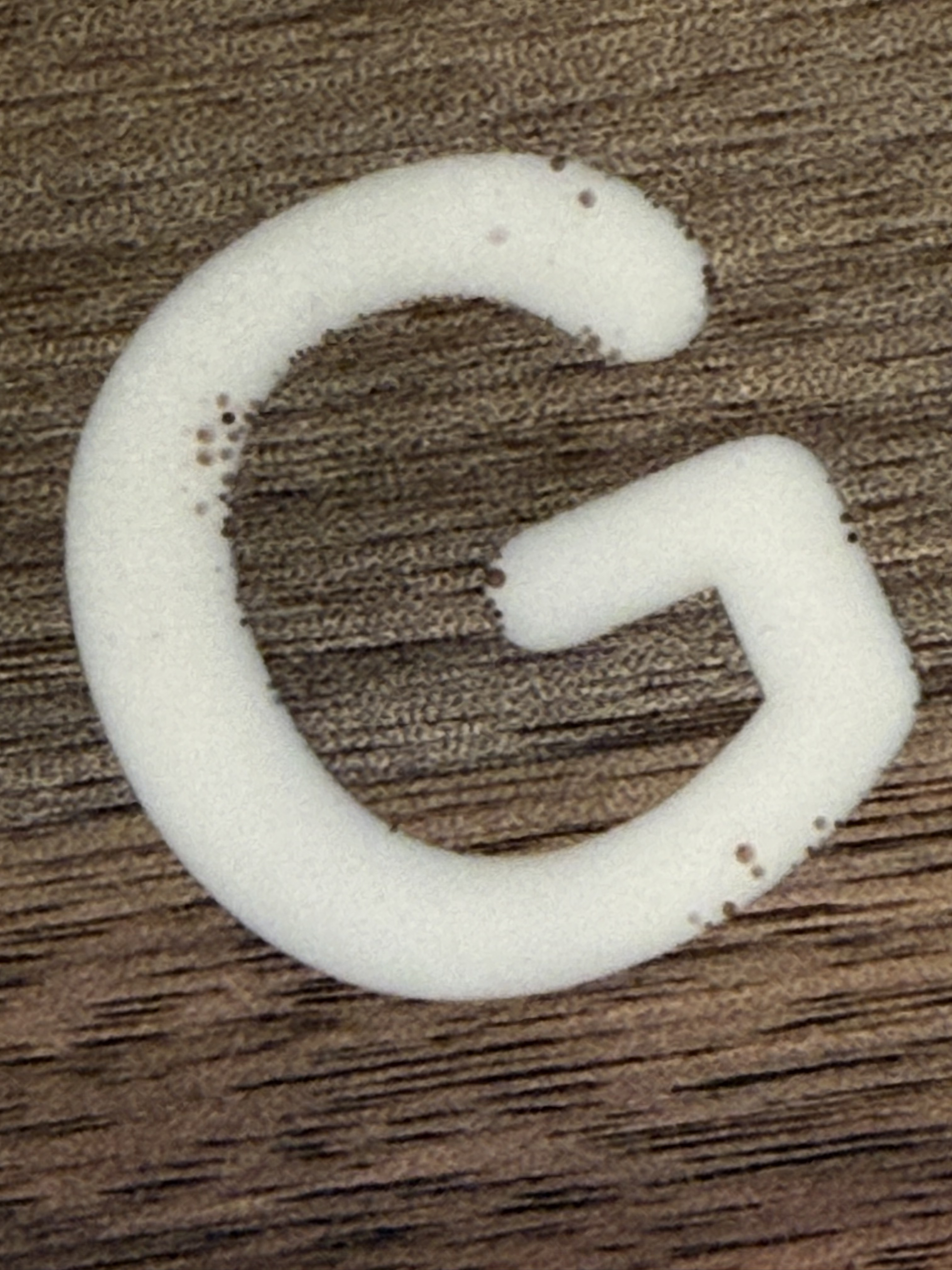

Given the location of the bubbles, this is almost certainly not bubbles in the epoxy from mixing and pouring. If they were, they would be evenly distributed, and in fact should be concentrated more to the center of the epoxy where it is deepest.
This is almost certainly air coming out of the pores of the wood where the endgrain has been exposed.
I expect that the only good solution is a proper seal coat of epoxy before the colored fill.
Thanks @mhotchin, that is what I have been leaning toward, since as you pointed out, they are almost exclusively along the edges, it just puzzled me that it didn’t happen to the black letters and they were treated the same as the white. I was experimenting with the white and black to see which I liked better for my application. Wife and I like the white best, so now I need to get this bubble issue resolved. I will work on a better sealing method as recommended.

Thanks for all the responses. I decided to switch to the Zinsser Sealcoat shellac instead of the varnish I used on the practice pieces to pre-seal the wood. And I am going to use two coats instead of just one. Will see if that solves my bubble problem as I feel that the issue was bubbles developing from the wood, not the epoxy itself. I used the same epoxy brand for all pours and treated each section the same after the pours, so based on the response here, AI responses and YouTube watching, I (hopefully) have narrowed the source of the issue. Will report back once completed. Keeping fingers crossed.
