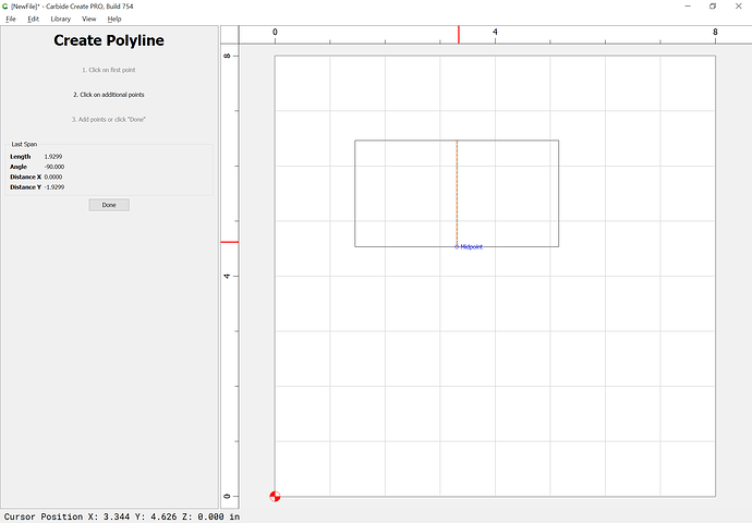

  2. Is there the ability to snap anything other than the grid or another node. When drawing polyline it would be helpful to be able to snap to the endpoint or midpoint of another line.

  2. You can only snap to the Midpoint of rectangles:
and regular polygons:
which have been created w/ the native Carbide Create tools.
