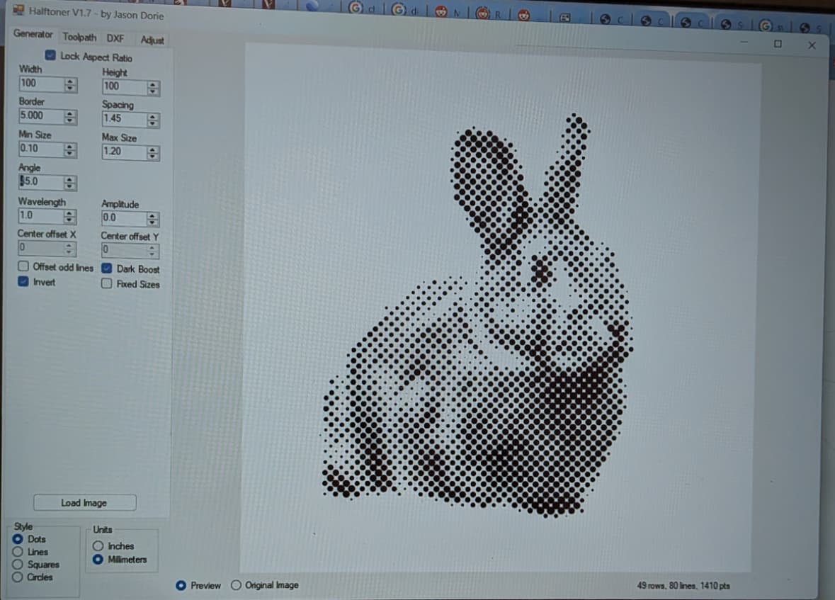

Another choice is to use a halftone generator. I’ve been trying a couple of them, including the free older Halftone 1.7 which can be downloaded through github. The developer originally had a domain that he used for halftoners, but let the payments lapse and it’s become a malware site. The link is what I’ve been using for a while, but of course always do a virus scan on downloads like this. There is no spindle control in the gcode, you need to use manual control to turn on your spindle. However the generated gcode is very efficient and makes good use of G0 rapid moves. The only feed rate moves are a short plunge to make the dots.
Expect to spend some time practicing and learning what the settings do. Watch out for the border size, it comes off the photo and clipped this pic a bit. Here’s a screen photo (sorry, I usually do screen snips but didn’t this time) of a recent project, I wasn’t all that happy with the results (at that size a 0.75mm dot spacing worked better) but it’s what I captured. There’s also a tool path tab that’s pretty self explanatory.
Thanks for the link & info! I’ll check it out. I definitely need some practice with this but I’m beginning to get the gist I think.
