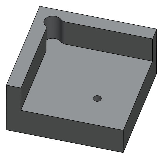

Mill a block of material with a right angle to mate with the corner and a hole guide where the drilling goes. The hole guide has an upper and lower so the pointing is square to the board.
mark
P.S.
To be really accurate, the spoiler board would need to be machined flat on both sides. Mill the top and bottom of the block flat. Now cut out a right angle guide for the corner and plunge a hole through it for the drill guide. I would recommend pick drilling so as to clear the hole of material.
As I recall, the corner holes are 1/2" recessed. A block 1" square and 3/4" or 1" thick would work.
Since you’re in production mode, I would mill it out of steel but on a Nomad, 6061 or 6075. I would make a prototype out of HDPE or PVC to try it out first.
The corner of the right angle will need to be CADed with “dog biscuit” so the corner doesn’t have a 1/2 D curve in it. If you’re not familiar with “dog biscuit” I can explain.

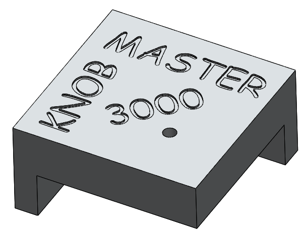

I made a similar drilling jig for a co-worker last spring. He needed to drill knob holes in a bunch of existing kitchen cabinet doors. I machined the jig from a 2"-square piece of 1" thick PVC.
The majority of work was actually doing the logo. :smile:

Great stuff, as always, @Randy. Just curious, do you use the Knob Master 3000 to make holes with the Nomad? Or is it meant for use with a hand held drill? If hand held, how do you make sure the drill is level? Or is it not really an issue?
@Darren my thinking was that this sounds like a job for a small drill press, especially if you’re in production mode. I don’t know if that would be possible for you, but it would certainly make things easier. You can get ok quality machines pretty cheaply at Home Depot (or similar), and for what you need at present it seems like anything fancy is really not necessary.
@MrHume, my co-worker used the jig on cabinet doors that were in place on the cabinets. He clamped the fixture on the door and used it to guide the drill bit in a cordless drill. With a .14" diameter bit and .50" thickness of the jig, there was plenty of engagement to guide the bit straight.

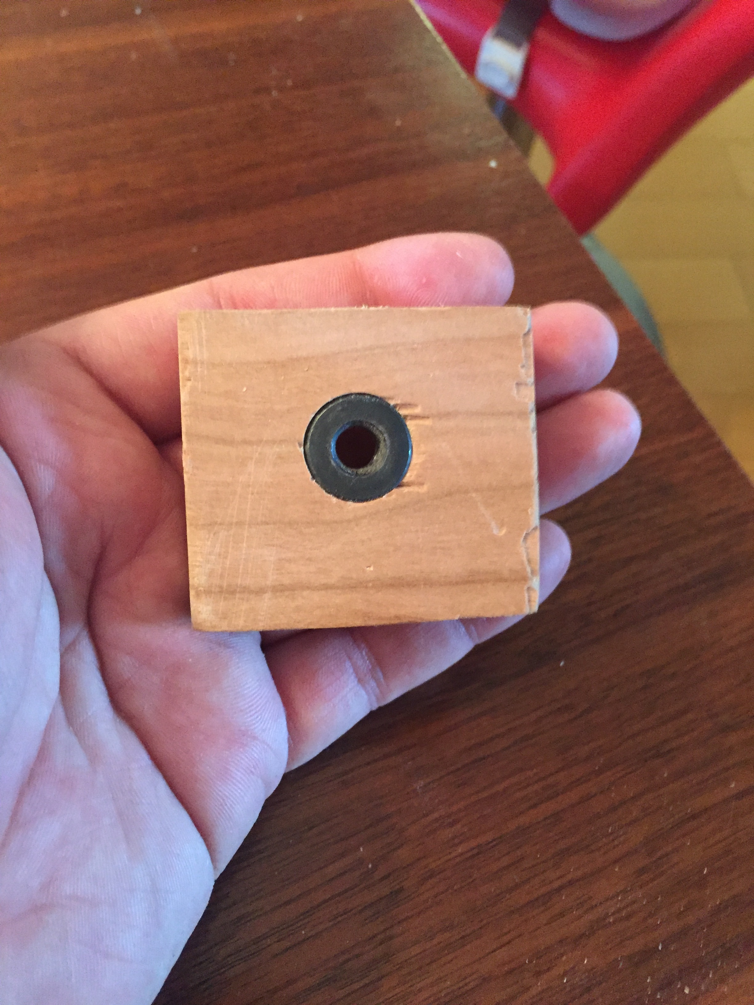

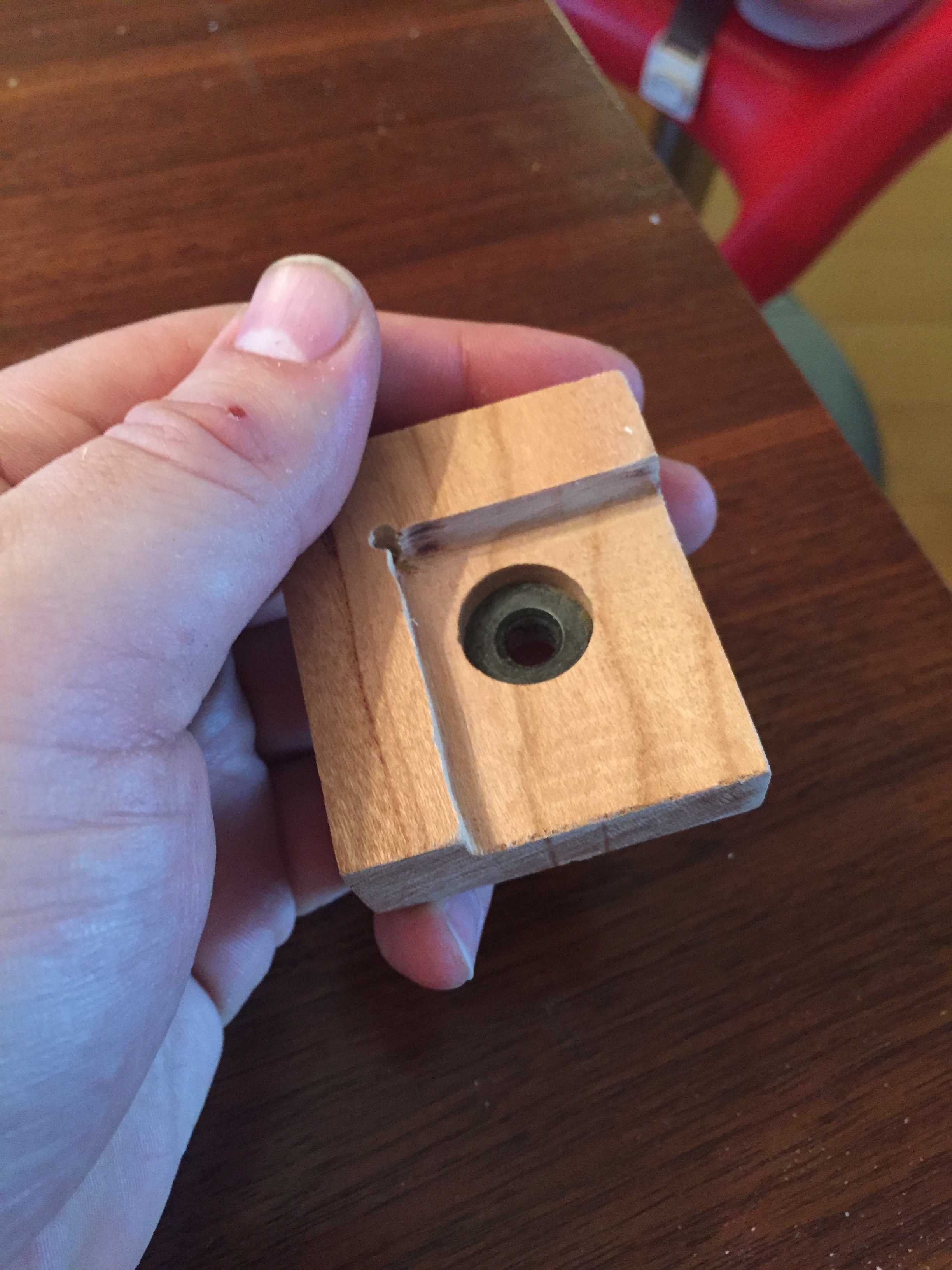

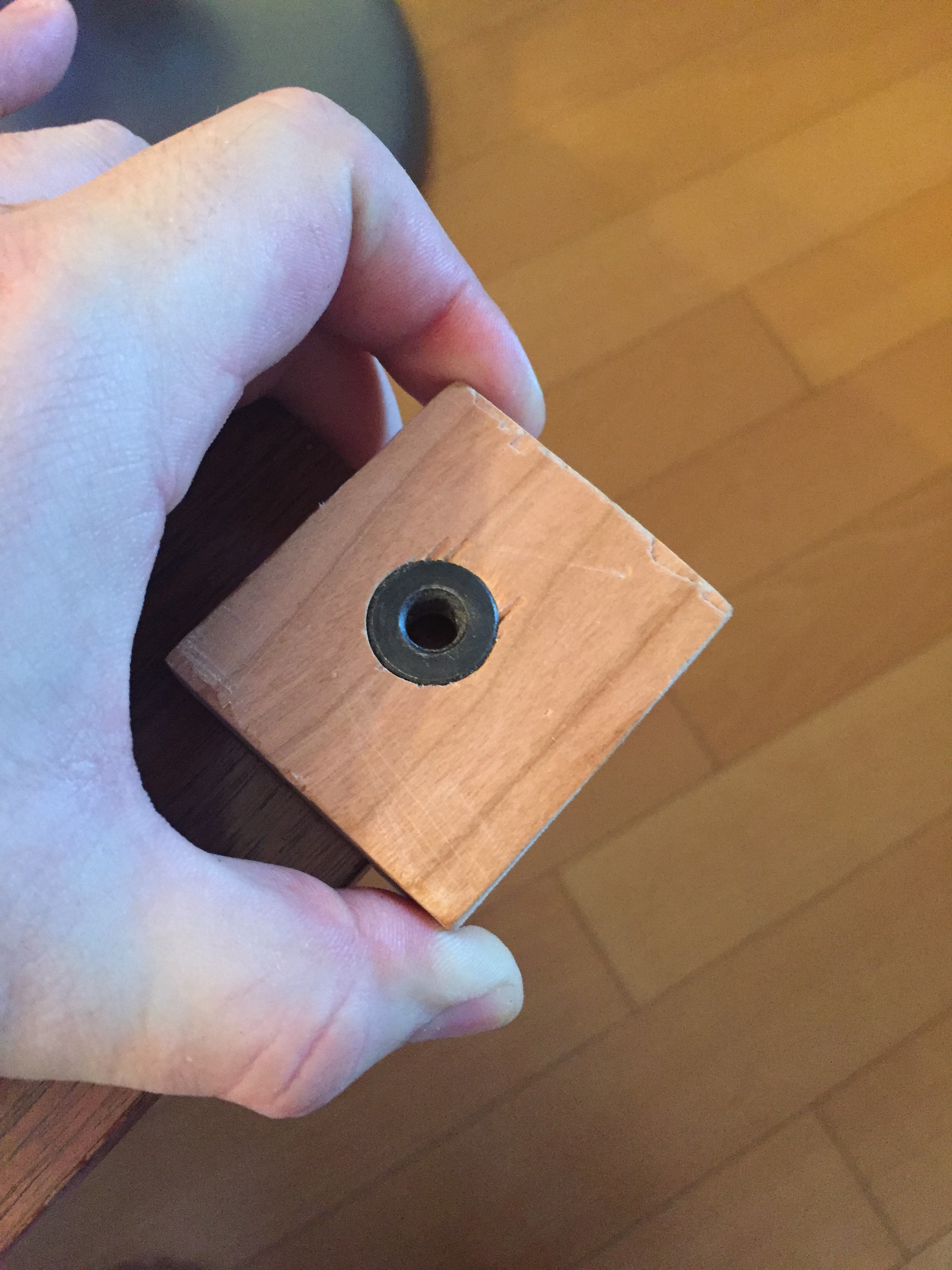

I finally had some time to figure this out. I used the idea above and came up with this
I machined a hole for a 1/4" drill bit collar and pressed one in there. It works well to keep the bit centered when I’m drilling.
I also had to massage the underside a little - maybe the wood blanks I have are not exactly 8" squared… But either way, it works and it’s repeatable!!
For v2, I’ll add some engraving - “HoleMad 883” :smile:
