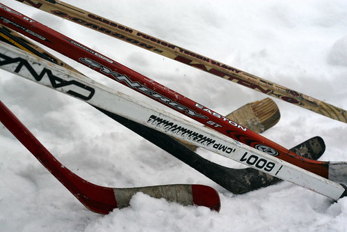

I have had a request to make a hockey stick for a sledge hockey goalie. The current ones are wood and fiberglass. They are pretty light but not all that strong. I don’t really work with much other than wood so I am not sure it there is a material I can use that will fit this request. I thought about using a strong plastic similar to what I used for the skate blades he asked for but I feel like that would be pretty heavy. Anyone have any thoughts on a material that may fit the bill here? They are currently spending about $100 per stick and they don’t last more than about a dozen games. There has to be something better. I expect they would be willing to pay more per stick if it lasted longer.

This is really what I had found as well. The big difference here is the player does not need that flexibility since it is for a goalie. Also sledge hockey sticks are far shorter so they can get away with being a little heavier material since the blade and shaft are shorter. He also does not want a curve on the stick. These changes made him think it was something that I might be able to help with.
Yeah it is not something that many people know about. My son has been playing for years so I know a fair bit about the equipment itself. I actually played most of the season myself this year. His team was always short players and I thought I was taking him there anyway so I asked if I could play. It was a great workout and took me a while to get the hang of it. We had a lot of fun playing together this season and now his brother is thinking of playing with both of us next season.
I will need to look into the curve on the stick and see if it is required for goalie sticks as well. It is required for a player who is shooting the puck generally but the goalie really does not need it. I don’t expect that anything I design would give an unfair advantage outside the spirit of the sport. I would also ensure it is safe. If it really became an issue I guess I could offer my sticks on my Etsy site to fit the commercially available section. The problem with this sport is that there are so few suppliers that a lot of the equipment gets really expensive.
