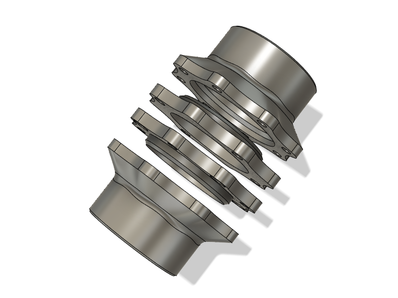

Here is how I handled it on my enclosure. I made a magnetic bulkhead flange for both inside and outside of the cabinet. The inner side uses a short hose from the Sweepy to the inner port, the outer port then has a matching coupler to the hose for the collector. I needed the quick disconnects so I could easily remove the hoses when necessary
What I would do is temp secure the hose at various locations, top, back,… to see what works. You don’t want too much hose inside to get jammed or too short to pull. Might be that you make or use a bulkhead fitting at the spot you choose.

Looks like Cody has a nice design for the bulkhead fitting.
Great, I will pick up a bulkhead fitting tomorrow and try the suggestions.
Thanks again
If you have a 3d printer you can print mine.
I don’t have one, I appreciate the offer.
Let me know if you’d like a set printed, or you can use an online service like shapeways or others.
@DiscoJon Do you just use hose clamps on those fittings or is there something in the design holding the hose on?
Just a good quality zip tie and a slight interference fit with the hose.
