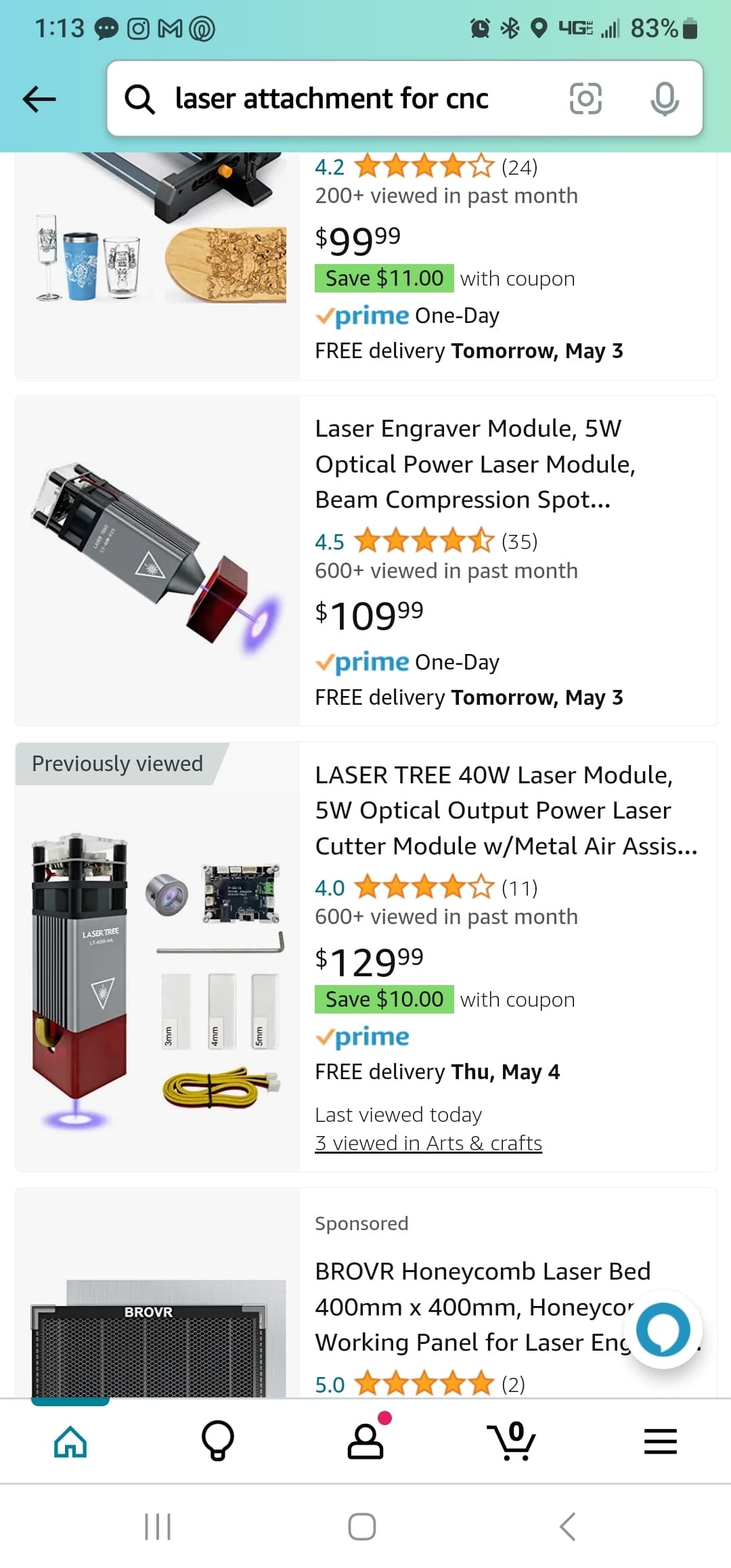

Im also confused looking at the amazon selections at $100ish, would i be on my own for figuring how to mount it into my gantry?

Has anyone ever used the Amazon ones?

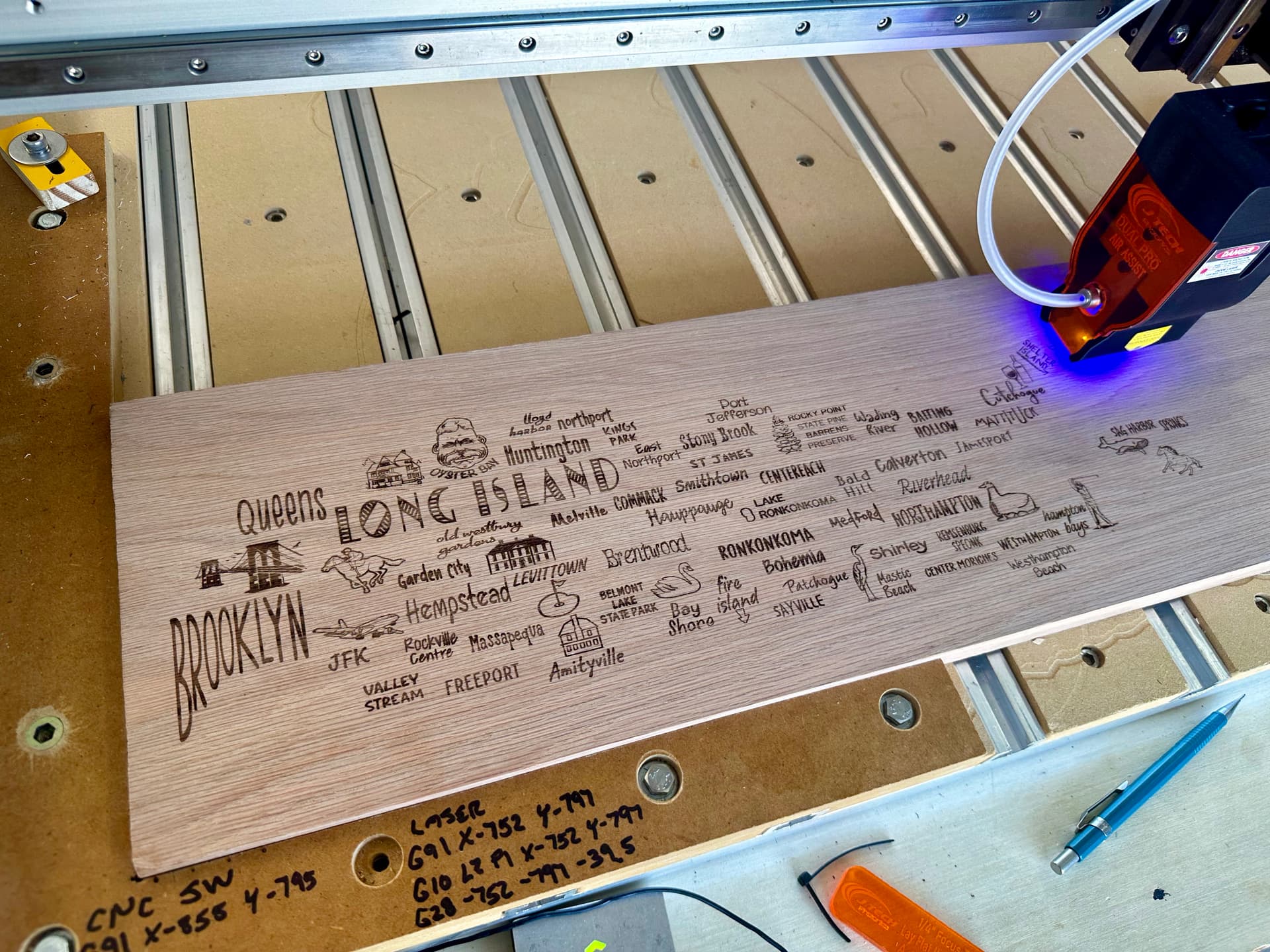

Here’s what I did with my JTech 7W. It comes on / off easily, but I can get it back on very, very close to its XY zero everytime. All I use it for is burning words into wood; big and small. I usually run at 60 to 80% and 20ipm.

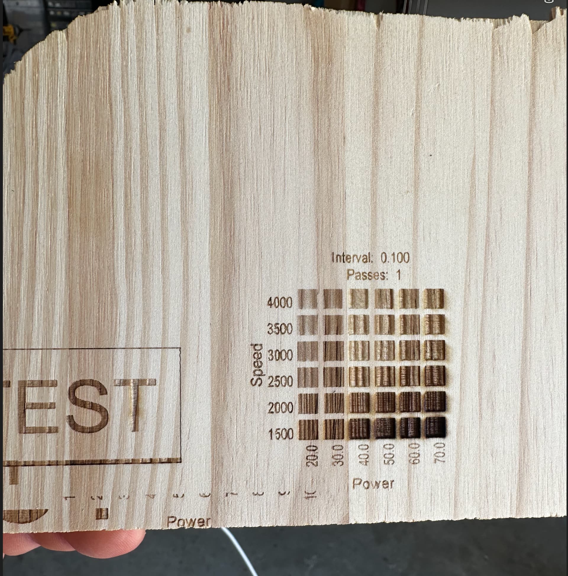

I got the air assist and found it actually made the burns terrible. Maybe the pump is too fast or my feeds/speed are wrong but I ran a few test patterns and the ones with air assist came out terrible. As you can see in “test” last T was with air and rest was without. i don’t know
Just got my JTech dual pro setup and installed and started using it today. Absolutely love fact can laser then switch to cnc and profile cut. I have a jig setup in SW rapid position for both…and figured out how to zero laser to SW position and use absolute coord. Works great.
The mount is super solid. And very strong magnet. It will not move. I was able to burn a lot today and send to home/same position every time and no issues at all with movement off zero home. it is solid.
care to share the parameters you are using… that look amazing. i have a jtech set up on my shapeoko, however i may be selling it as i dont use it as much because i cant get it configured to how i would like it. would anyone be interested?
I have Shapeoko Pro XXL and use side mount for Jtech laser. The offset for the laser to center of router I found to be 104mm for my laser setup. After I home the machine, I run the command G10 L2 P1 X-752 Y-797 in lightburn. Basically it’s offsetting from CNC back right home position to the SW rapid position…which is X-855 Y-795. So X-752 with the 103mm offset for laser gives me 0,0 at corner of the jig. Then I run G10 L20 P0 X0 Y0 Z0 and that changes it to a positive workspace coordinate system. Now I have an absolute coord system which is the way I use lightburn.
As for laser settings…this is the 14W dual Pro with high resolution lens. I have air assist but found it actually makes my burns look terrible.
The oak/hardwoods I have been using 3250 mm/min at 70%. For softwood 2500 mm/min at 72.5%. I also raise my laser up 1mm after setting the focus height. Found this gives me a little more “darker” burn by bringing it out of focus 1mm.

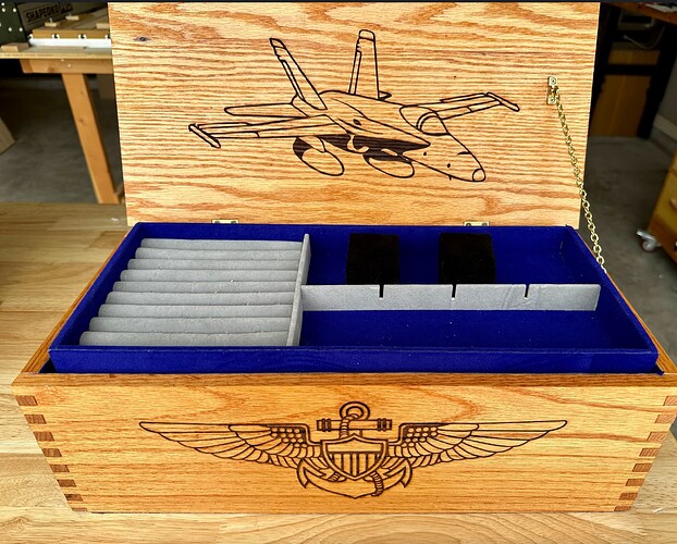

Those settings are bit on high/fast end. I have had good success at 2000 mm/min and around 42.5(hardwood) to 37%(softwood) power too that I used on this jewelry box.

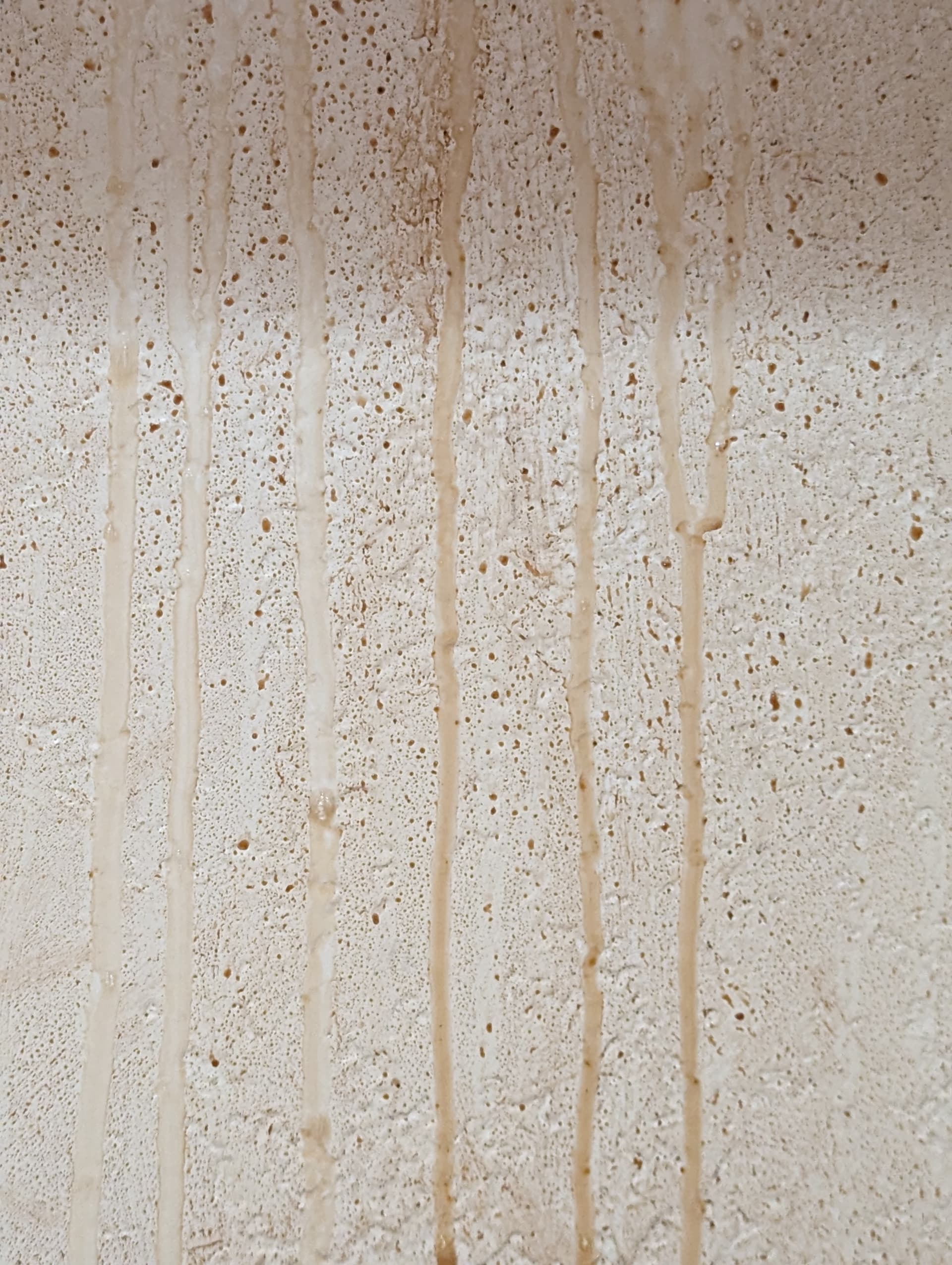

I literally just got back from de-greasing my laser bed after about 30 hours of it running. Not just the honeycomb but the metal bed beneath it.
This is very significant to the topic, because the first thing I realized when i starting running my diode laser was it needed an enclosure and it needed ventilation to the outside. My studio smelled like a campfire within a day or two. That’s all well and good and many CNC owners make enclosures for their tables as well, but for very different reasons.
The residues that end up on my base plate and honeycomb are crazy. I cut sign paint/enamels, and standard acrylic painted wood, as well as stained wood. It’s like cleaning an old brass weed pipe from the 80’s. Goopy, oily resin that ends up everywhere. The walls of my enclosure, my ventilation needs a filter and it still doesn’t stop the oils.
My point is I don’t want to add this sticky, goopy element to my amazing Shapeoko. Any enclosure I build for the purposes of keeping the sound and dust down for its initial purpose does not instantly translate to having a proper enclosure required for a laser.

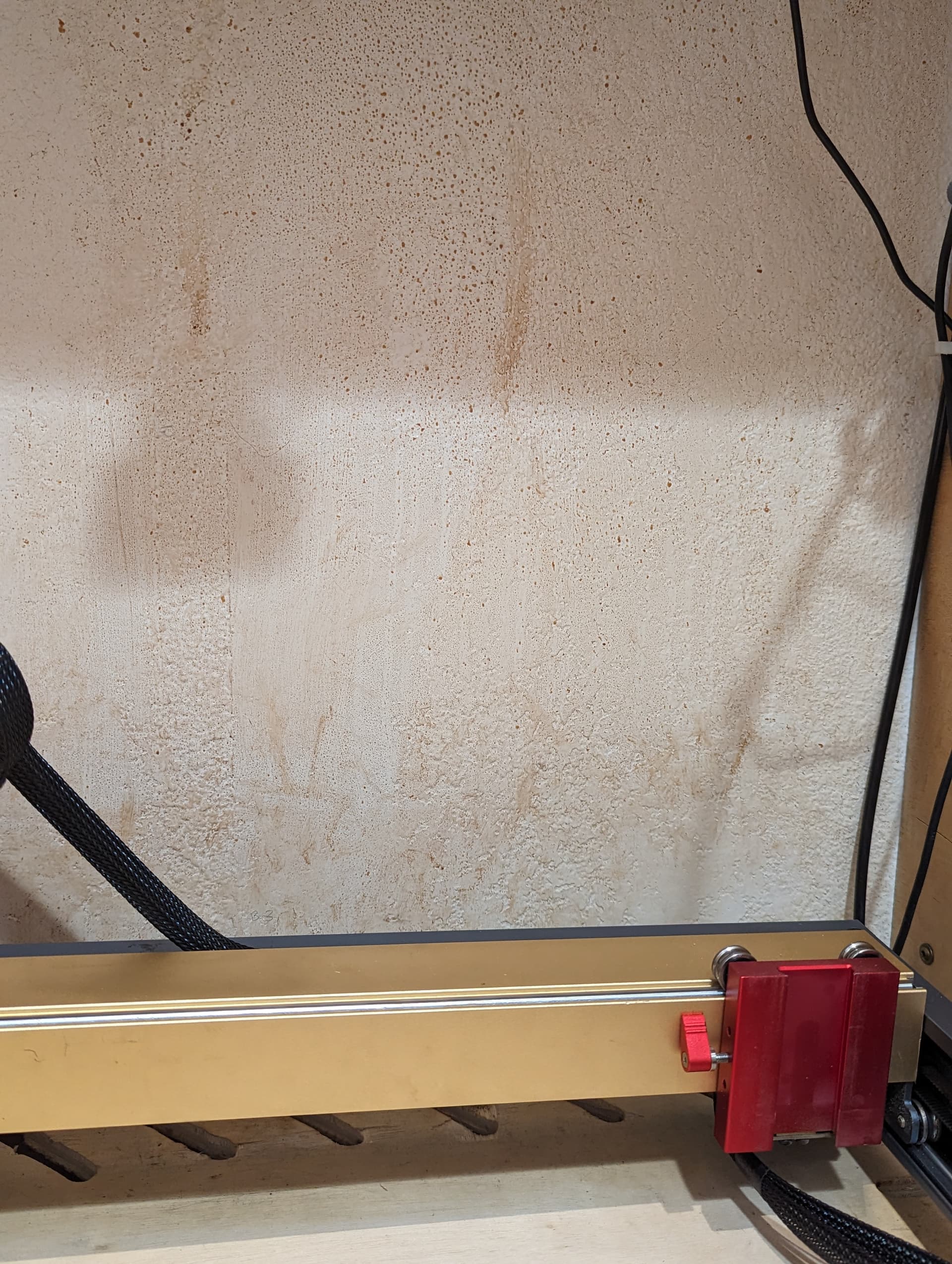

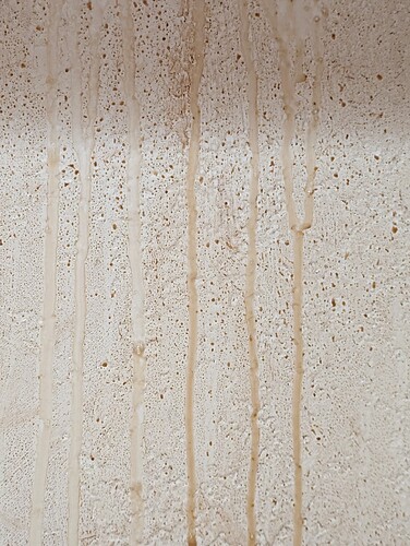

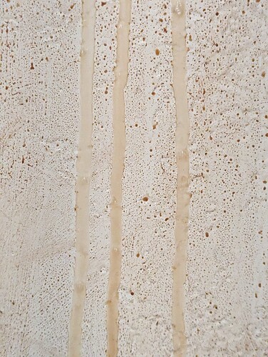

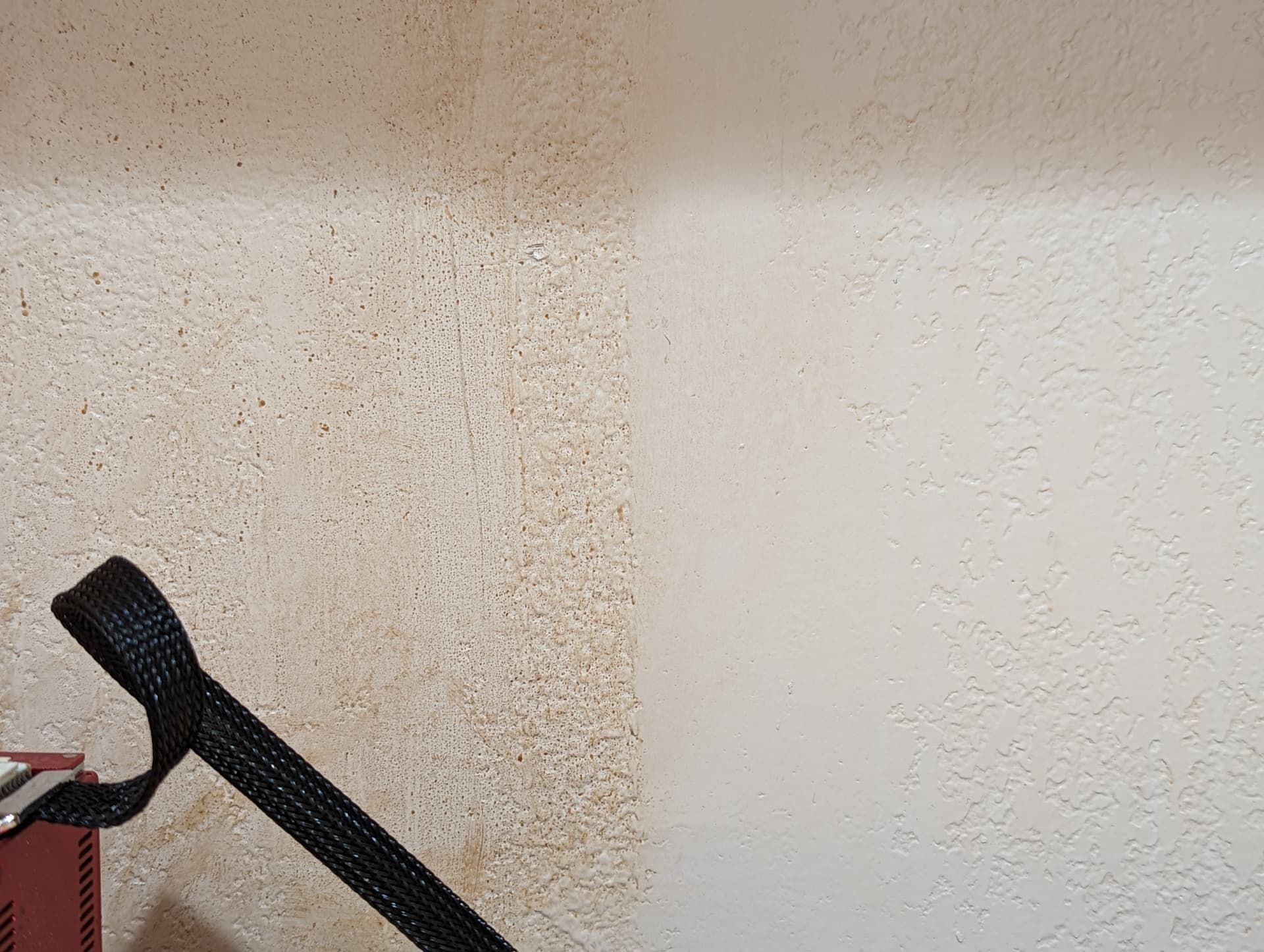

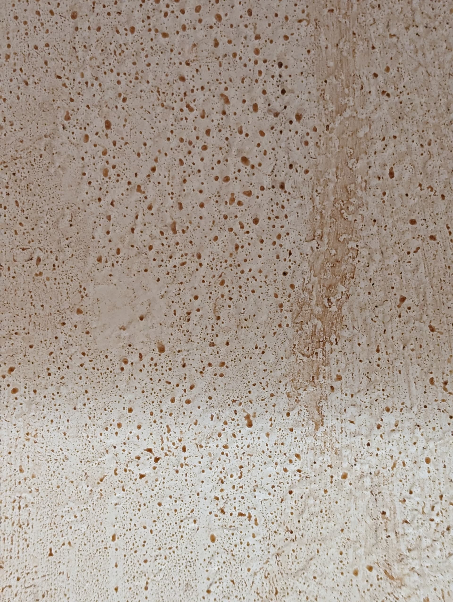

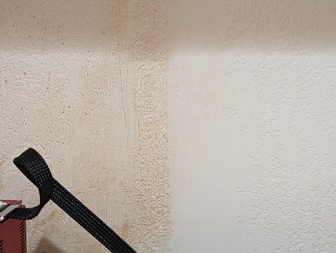

edit : I was literally cleaning my laser cabinet when this thread came across, so I took some before and after photos showing the oils on the wall of my enclosure (all the other sides are cabinet plywood, and not as easy to see the oil but it’s still present). I sprayed a little degreaser and used a shop towel and check out before and after. Unfortunately, the other shot is my toxic dump where I spray as little degreaser on the metal sheet/bed of my laser, let the water evaporate, scrape out the residue and bring it to our hazardous waste at the dump and they look at me like an idiot because most people just toss this stuff. Anyways, please don’t bring a lot of this into your precious CNC when you can run a decent laser for $500 all-in
The oil is on new drywall that is not more than 8 months old, and I constantly clean it. I decided to swap out the 1/2" drywall that the closet came with for 5/8" fire rated drywall. Plus a special fire retardant spray across the entire wall and cabinet. Look at the image where I only cleaned half of the drywall
I’m not saying this residue is a bad thing, but I also am not letting it anywhere near ball screws on my five thousand dollar CNC.
