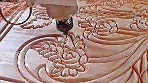

I have a Shapeoko Pro and I’m making a new pantry. I’m looking for designs/ideas to make some nice doors by utilizing the great capabilities that this CNC gives me. I’m also wondering id I would need different bits than the 60, and 90 degree v bits I have. I’ve seen some designs that the bit seams to not just V out the wood but also appears to do a radius at the same time. Open to ideas or suggestions.

You need to define your request a little bit more. Are you going to make the whole door or just put a design on the panels. A 60 or 90 degree vee bit can do a lot but if your design is complicated or rather small detail a 20 or 30 degree might be better.

If you just want to put an arch on the door a router table with templates might be easier than doing the whole thing on a cnc. If you want to carve on the door it will depend on the thickness of the wood under your design. If it is a thin panel then an advanced vcarve would work well because you can define the maximum depth. Just a vcarve without the advanced vcarve will make a cut that will try to cut both sides of a line and could go over the depth of your panel.

I have Carbide Create Pro. I plan on make 1 inch solid wood panels 17x 28 for the CNC. I have access to many different varieties ( Pine, Ash, Elm, Oak ) I’m looking for something that says (Wow what did you use to make those doors)

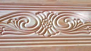

Here are some type of designs
With a 1 inch solid wood panel be sure to not fit the panel tightly. A one inch solid panel will expand and shrink a lot. Even in a modern air conditioned house in the winter heaters tend to dry the air shrinking the panel. In times you open the windows the panel will swell. Then when you turn on the cooling the panel will shrink again. Typical lumber yard lumber is not really dry so buy your lumber ahead of time and let it acclimate.
