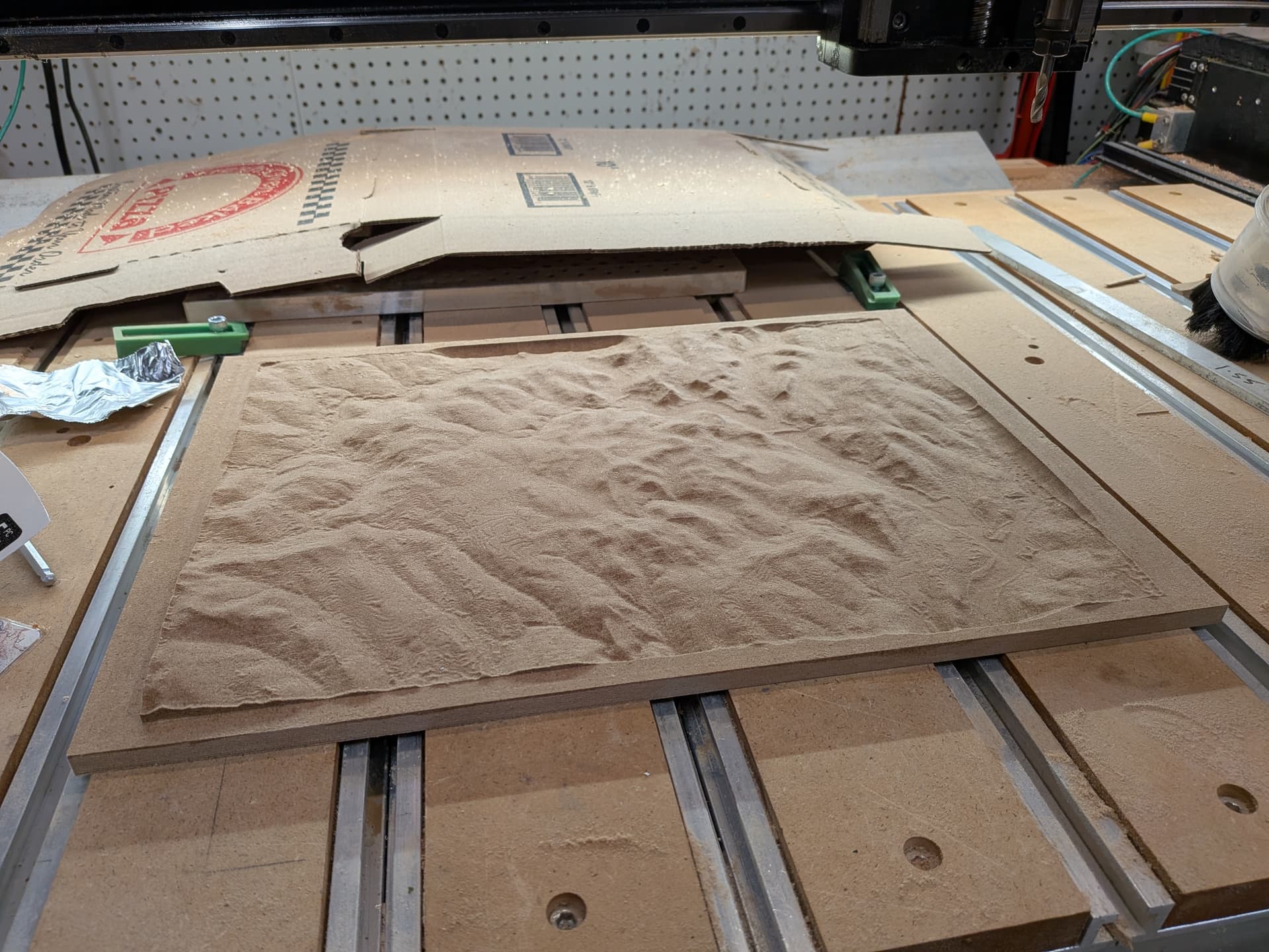

Lookng for a good color for a Topo mill
I made this as a test cut, but it evolved into a Christmas present.
It looks good under a light, but flat when not carefully lit.
What is a good color/finish to use that shows the terrain easily ?
I know you would have to machine another piece but it would be best to test a few different finishes to get the desired shading.
I think your best bet is to increase the contrast between high and low spots.

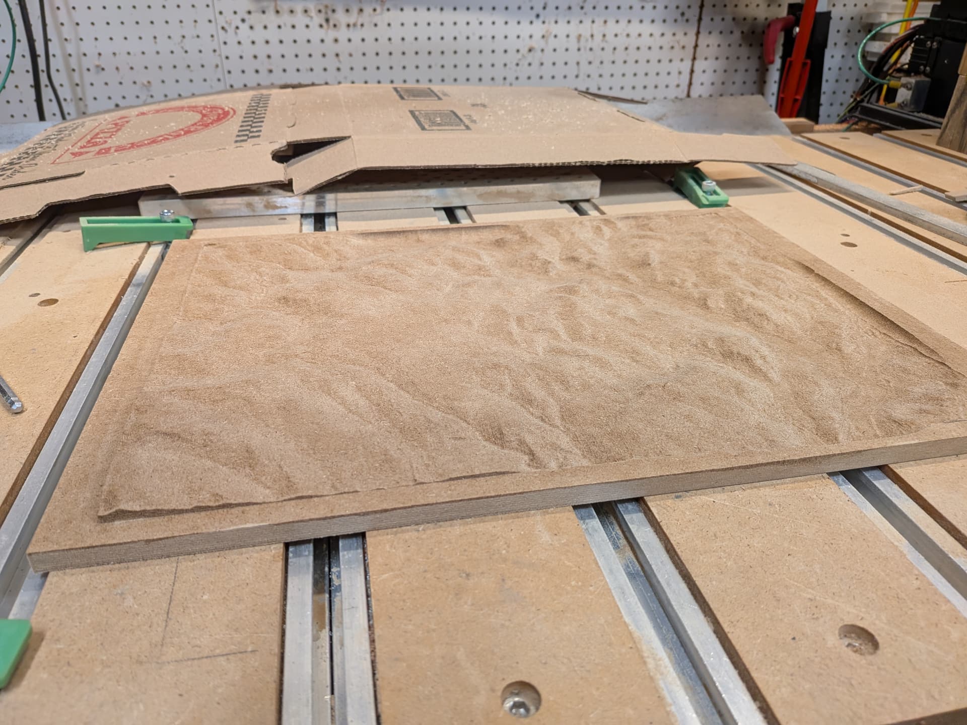

I am going to cut a few more, and this piece has risen from the ashes ( pre firewood status ).
Contrast is the key. I like the pooling idea ( I am lazy ). I have sanding sealer on it now.

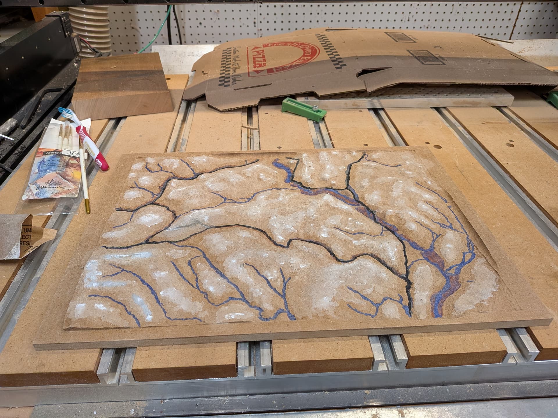

I was playing with different colors and found a glossy color showed edges better than a matte finish. I think I am going to try some glossy urethane.
On the fly testing …
