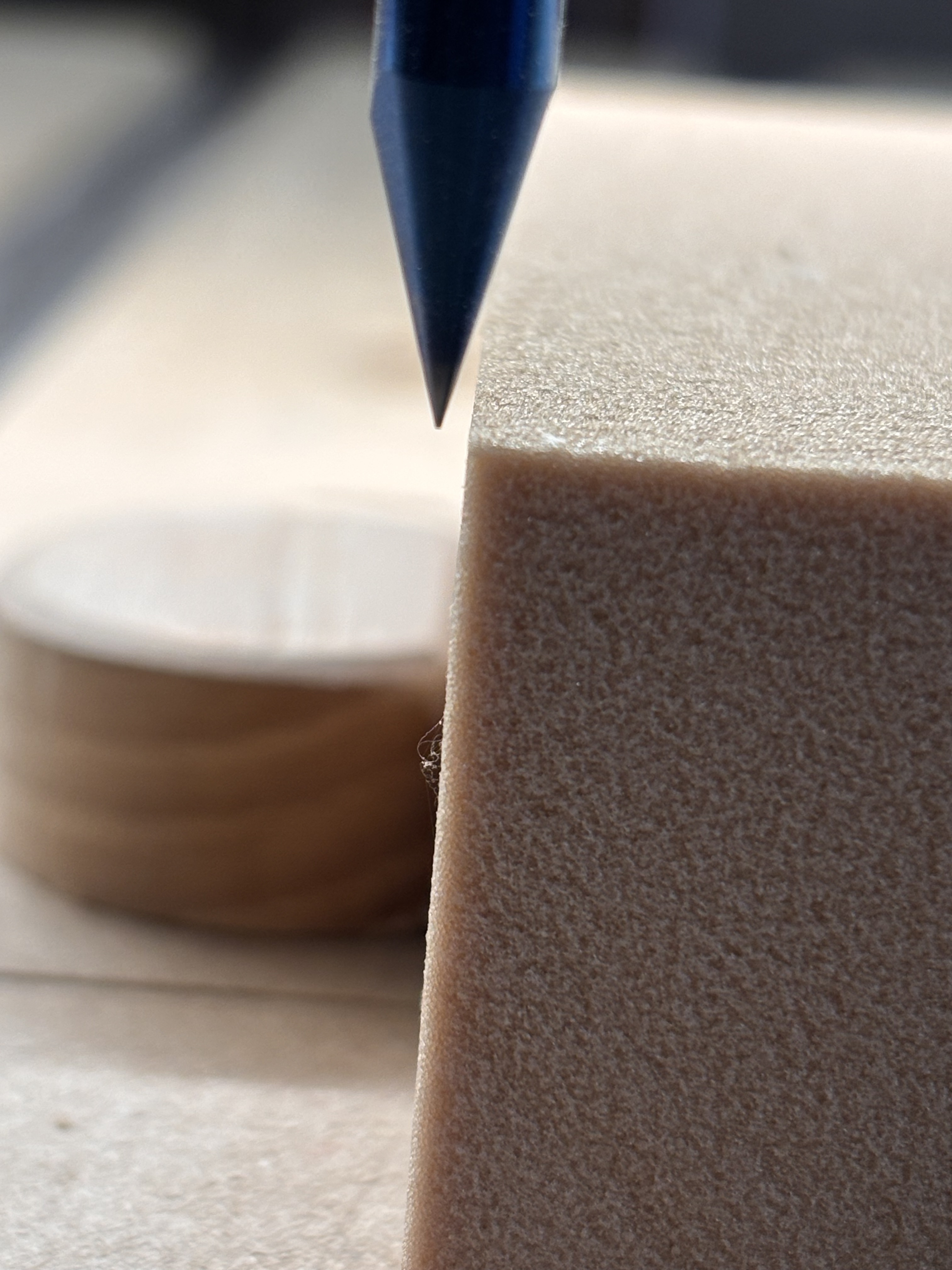

So, since I run the exact same size signs over and over, I would love for my Pro 5 to maintain the same XYZ zeros when I shut it down for the night and come back the next day. This morning I came out to run another sign and thought I would check it and the X zero is off in reality but is showing 0 on my computer. By approximately .75 mm.
Thoughts?

My first question would be is the stock edge 90°? And was the previous stock that you used to set the zero also 90°? You could check real quick by flipping the stock over.
But also check the X zero to the stop block / bench dog.

Yes, most definitely. This I know because I flip the stock for the signs (each is double sided with a 1/2" border around the outside, so they have to be fairly precise). I’m using bench dogs as well which are set into my waste boards, carved in place with the CNC. Those have been accurate since day 1.
The difference, as @jtclose mentions, seems to be when turned off and back on. If I leave it on, it doesn’t lose zero.

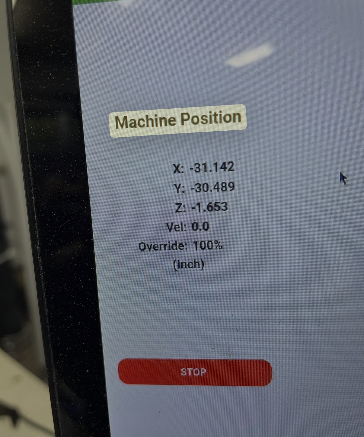

One way to check is to record the machine coordinates after XY is set. Next time you turn the machine on go to your XY 0 and toggle to confirm the machine coordinates match. Or do the same test with the built in direction rapids. Another way is drill holes at open spots in the spoilboard with the #201 then check it lines up the next day.

If you click on the CM screen where it says position it will toggle between job coordinates and machine coordinates. The machine coordinates for your XY zero should always be the same within the tolerances of the homing switches. So you can run the homing cycle repeatedly and see if the numbers are the same.

That doesn’t work for me. The limit switches report differently each power up.

Yes… trying not to garble terms … toggle to Machine Position the way @CullenS showed.
Manually jog the machine to the extreme X right Y back position. It’s X0 Y0. Jogging anywhere on the table from that point, the machine coordinates turn negative.
There’s another easy to repeat way to check if XY0 has changed when you power up. After homing,the machine it always moves to the same tool change spot. Take a screenshot of those coordinates in both modes regular and machine to refer back to.
The Machine Position for the tool change position should always be the same — the machine is open loop/doesn’t have positional sensors beyond using homing switches to find the machine origin — once that position is determined, everything is relative to that, except that:
