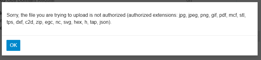

I tried to upload the file but it appears the forum does not allow upload of .gcode files.

You can upload the file now, or change the extension to .nc
File uploaded. Simple raster operation to surface stock. Thank you again. I feel bad that senior people at C3D have to deal with file extension questions, but I do appreciate your help.
Maple Leaf Pocket 1 (1).gcode (2.1 KB)
